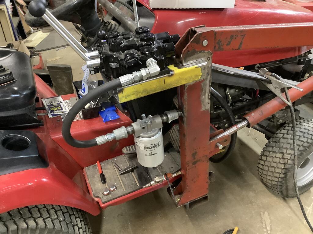

Pullstart 71,366 #14 Posted July 27, 2022 You’ll love having that James, I’m sure of it! Here’s how I did my return filter! 4 Share this post Link to post Share on other sites

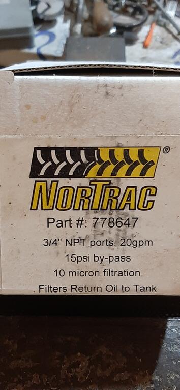

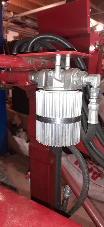

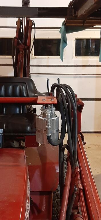

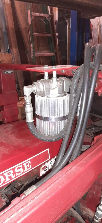

roadapples 6,987 #15 Posted July 27, 2022 And this is the way I did mine. And the kit I used from Northern Tool. 4 Share this post Link to post Share on other sites

Pullstart 71,366 #18 Posted July 27, 2022 @roadapples that’s a sweet heat sink! Was that part of the kit? 1 Share this post Link to post Share on other sites
squonk 48,215 #19 Posted July 27, 2022 Since one hose split I would replace all hoses unless you want an oil bath or want to give something else one! Share this post Link to post Share on other sites
roadapples 6,987 #20 Posted July 27, 2022 4 hours ago, Pullstart said: @roadapples that’s a sweet heat sink! Was that part of the kit? No, I bought it at a car show years ago... 1 Share this post Link to post Share on other sites

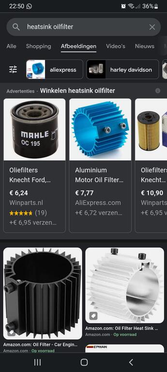

sjoemie himself 3,238 #21 Posted July 27, 2022 (edited) @Pullstart thanks for pointing out that the heatsink is a seperate thing. I thought it was just a funky looking filter. I giggle searched for heatsink oilfilter aaaand... bingo! Think I can use one on my Murray to IH 1568 project Edited July 27, 2022 by sjoemie himself Added info 2 Share this post Link to post Share on other sites
