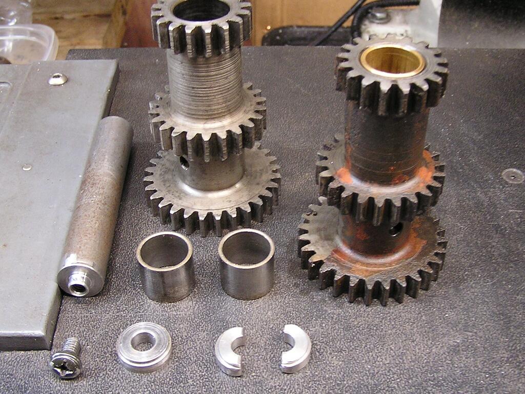

I think the only "yellow" metal in the manual transmissions is the 2 bushings in each end of the cluster gear.  They are not copper...not sure if they are brass or bronze.  In all of the transmissions that I have been in, I have not had to replace those bushings.
   I've been using the 90wt in the gallon jug from Tractor Supply with no issues for about 11 years now.  I do like to add a little Lucas Oil Treatment to these transmissions.  I think it quiets them down a little.  :occasion-xmas:

@ebinmaine - there is a bronze sleeve bushing pressed into both ends of the cluster gear.
  • Like 1
