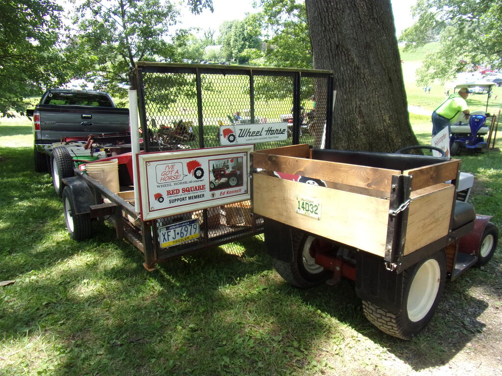

Ed Kennell 47,398 #1 Posted June 26, 2022 Looking at some pictures from the Fawn Grove show, reminded me of an incident that's worth relating to you guys. You see the guy in the green shirt on the right side of this picture. Just as he got to the top of the hill near me, the left front wheel fell off his electric wheel chair. He is handicapped. A quick look and I see a broken off bolt in the end of the axle. I didn't have the proper tools(drills and easy-outs) with me, but found an old wood chisel and a tubeless tire hole cleaner tool. Tapping with these, After about a half hour, I was able to get the bolt to move about a 1/4 turn, but was not having much success getting it out and was near giving up. By this time a small crowd had gathered and a young lad, maybe 12yo, said let me try. He laid down on his side and using the tire awe as a punch and by tapping with skill , he backed the broken bolt out in about 15 minutes. The bolt was a 7mm that is not common in my tool box, but we found the basket on the back of his buggy was attached with two plastic knobbed 7mm bolts. A few 5/16 washers for spacers and the wheel was securely back in place. The old gentleman looked at me and was reaching for his wallet. I pointed to the lad and he was rewarded. There is hope for this world........teach those kids to pull wrenches and be self sufficient. 7 5 1 19 Share this post Link to post Share on other sites

Pullstart 71,291 #5 Posted June 27, 2022 I see the tire missing Ed, great work guiding and trusting in the young’n to work that tiny thing out! 3 1 Share this post Link to post Share on other sites
