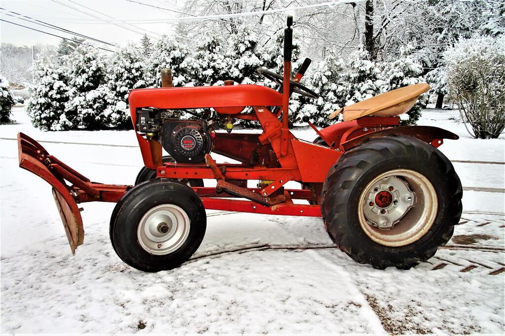

Snoopy11 5,731 #101 Posted June 15, 2022 @Jim Demery... 633 with Predator 212 On 9/7/2017 at 11:05 AM, Jim Demery said: 1 2 Share this post Link to post Share on other sites
Snoopy11 5,731 #102 Posted June 15, 2022 @Lee1977... C-120 with a 18 Vanguard... 1 3 Share this post Link to post Share on other sites

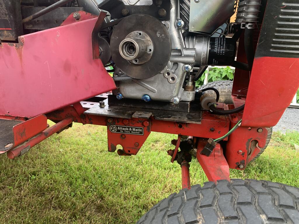

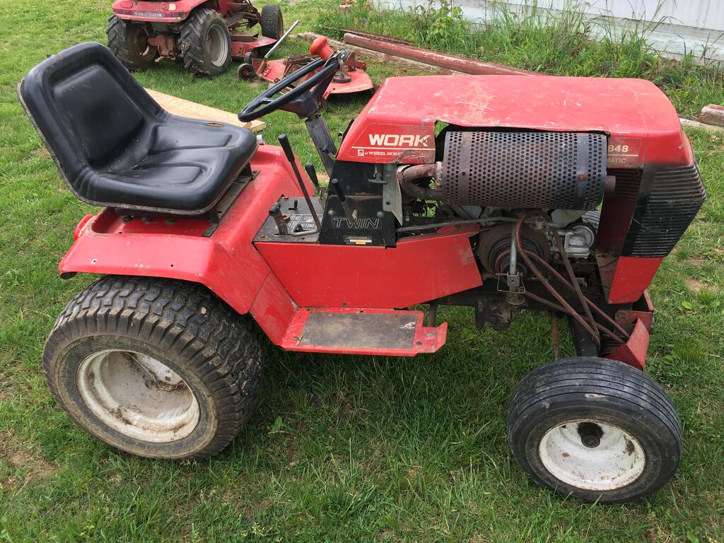

Aldon 4,834 #103 Posted June 16, 2022 On 6/15/2022 at 12:14 PM, Snoopy11 said: @Aldon... Gt22-8 with Predator 670 v-twin... This did require sliding engine over to the non PTO side to align PTO. Also needed a sleeve to convert diameter to wheel horse standard. Note that with the Predator engines, you cant use the manual PTO. You have to use an electric PTO. 1 1 Share this post Link to post Share on other sites
Snoopy11 5,731 #104 Posted June 16, 2022 1 minute ago, Aldon said: This did require sliding engine over to the non PTO side to align PTO Yep, that sound about right! Even just for applications without PTO... the engine has to move over to the non-PTO side... Don 1 Share this post Link to post Share on other sites

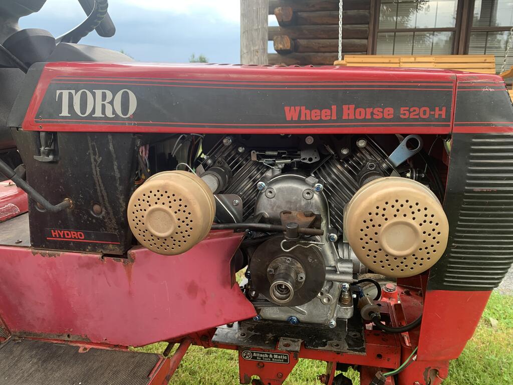

fast88pu 3,399 #105 Posted June 16, 2022 My 522HO with a built predator 670 4 Share this post Link to post Share on other sites

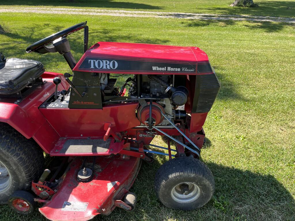

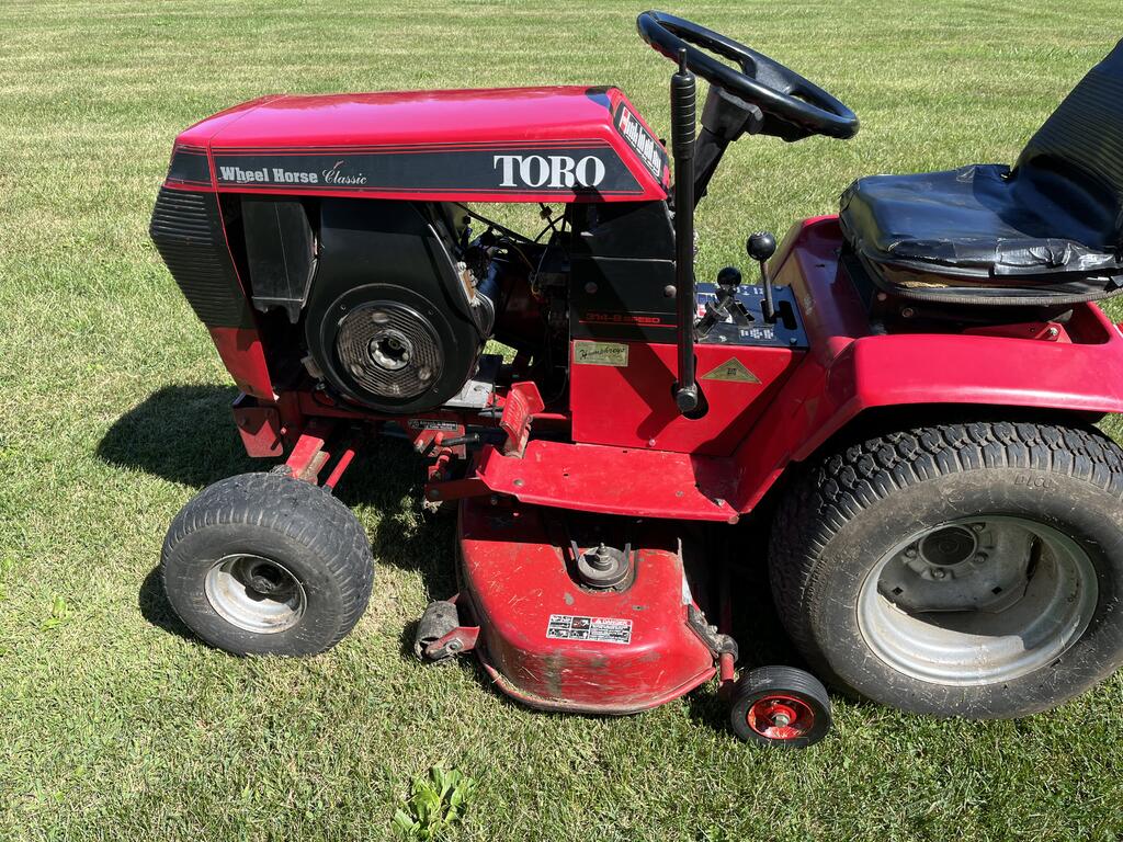

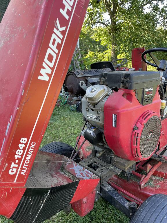

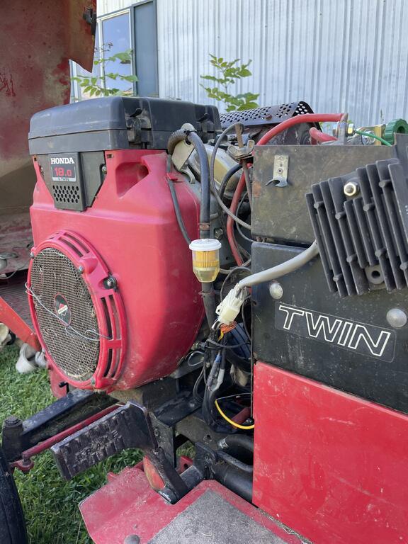

davem1111 2,432 #106 Posted June 20, 2022 (edited) @Snoopy11 asked me to post in this thread about the GT-1848 Work Horse I bought not long ago that had been repowered with a Honda GX610, so here ya go. Please don't direct your mirth at me when you see the pressure-treated 2x4's used to lift the engine to the proper (or at least, close to proper) height. I had nothing to do with that, and will be fabricating some metal mounts when I get a chance, probably a winter project. The engine seems to be a bit finicky but it may be either fuel supply or electrical. Engine runs great most of the time and drives a 48" deck nicely. Yeah, I want to replace the B&S screen side cover too, but the only thing I've found so far is a cover with a pull start. I guess that could come in handy though.... Edit to add: oh yeah, and I picked up an old twin muffler that I'm hoping the header flanges will fit - hoping to cut those off, put them on here and either put 2 stacks or a 2-into-1 and single stack on it, and repair or replace the hood that the fools cut into. Any thoughts on that? Edited June 20, 2022 by davem1111 4 1 1 Share this post Link to post Share on other sites
Jeff-C175 7,211 #107 Posted June 20, 2022 43 minutes ago, davem1111 said: GT-1848 Dave, I believe the mower drive belt should be on the inner groove of the PTO 2 3 1 Share this post Link to post Share on other sites
Snoopy11 5,731 #108 Posted June 20, 2022 1 minute ago, Jeff-C175 said: Dave, I believe the mower drive belt should be on the inner groove of the PTO Good eye... I totally missed that... Don 2 Share this post Link to post Share on other sites
davem1111 2,432 #109 Posted June 21, 2022 2 hours ago, Jeff-C175 said: Dave, I believe the mower drive belt should be on the inner groove of the PTO Wow - nice catch - thanks! 1 Share this post Link to post Share on other sites

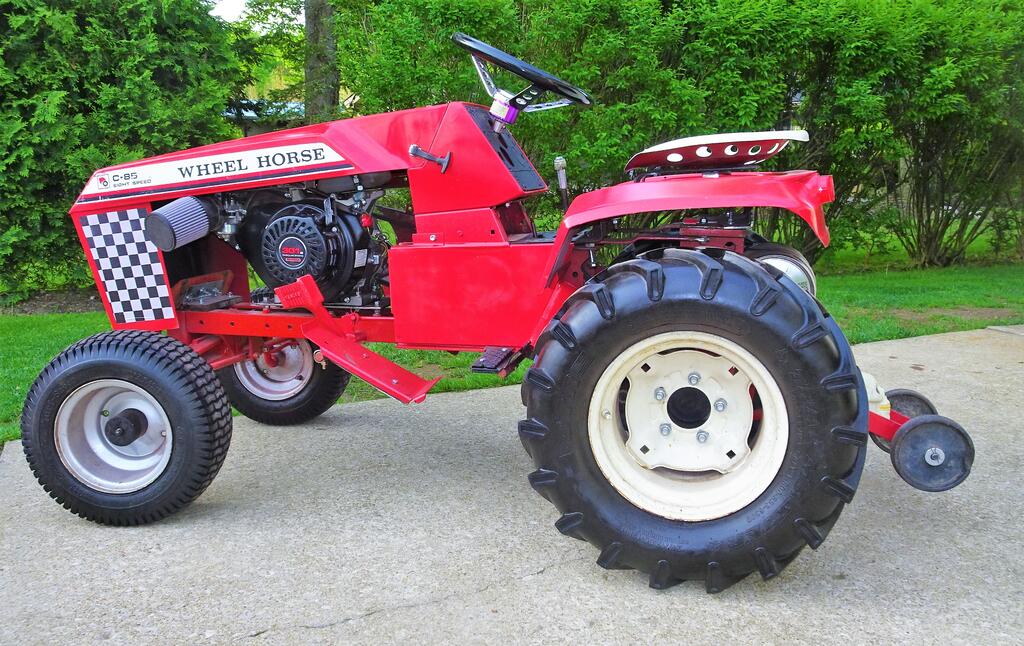

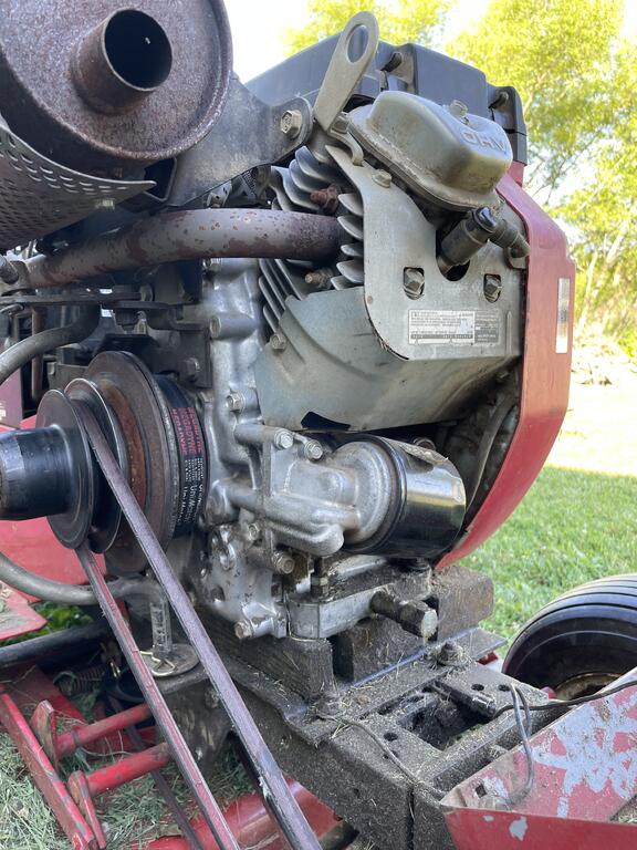

giddyap 1,574 #112 Posted June 22, 2022 @Snoopy11Thanks for posting my checkerboard C-85 with the 301. This 8hp Predator required a completely different throttle control from the 212. And as you predicted I shared your experience, but I believe it is only a blown gasket since it was still running when I shut it off. For the obvious reasons I prefer the 212. It simply dropped in a 704 I used one winter to push snow and it did not disappoint. 3 Share this post Link to post Share on other sites

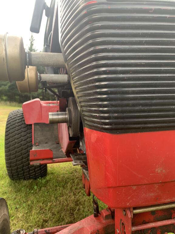

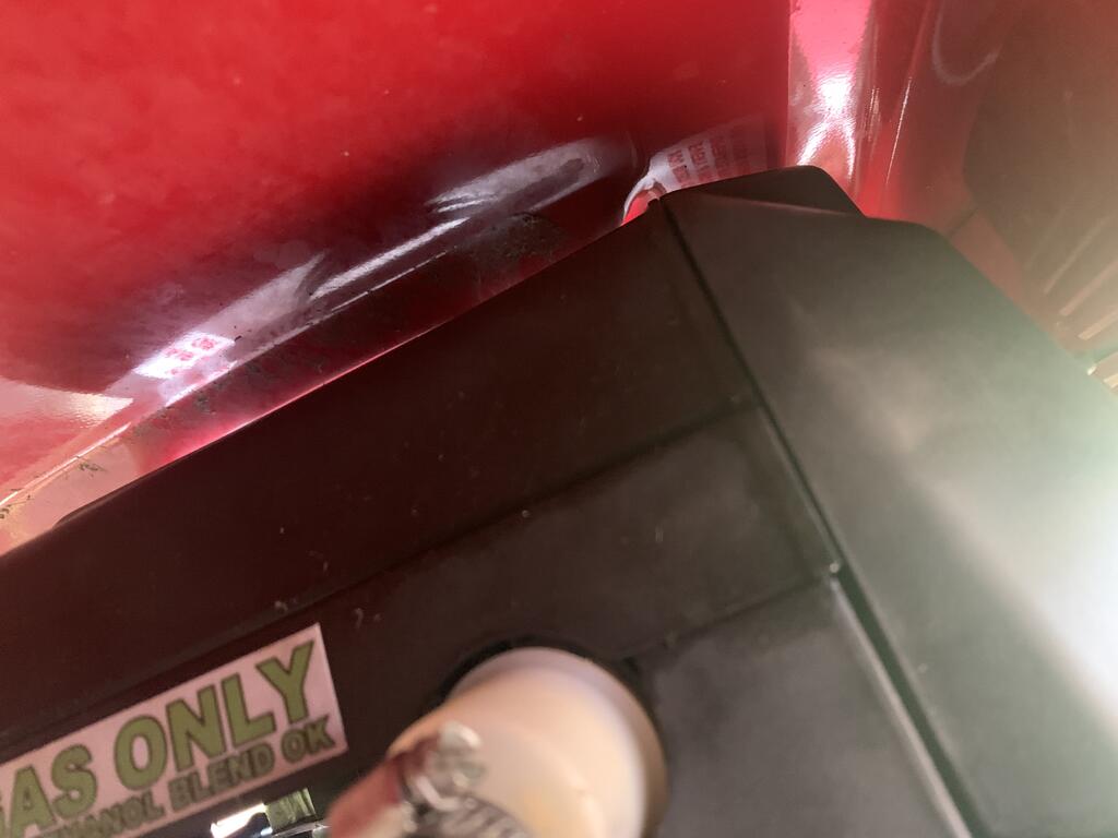

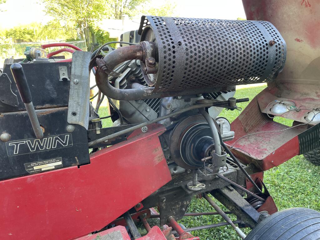

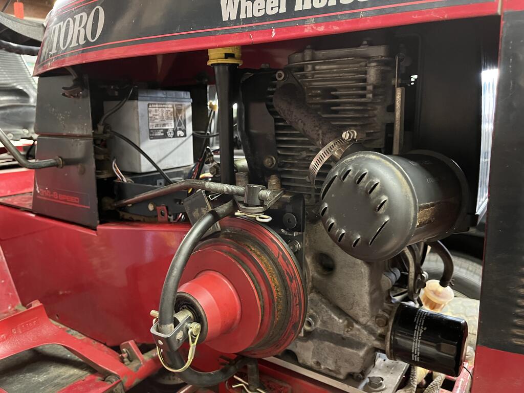

mhlmeader 689 #124 Posted August 23, 2022 Suburban with 4hp diesel. Used 1 1/2" wide x 1/4" thick steel stock to set engine on and bottom clamping bracket. Had to Redrill one side of frame, it had already been drilled out quit abit. Gas tank got in way of shifter, didn't have much room under hood, so I made a bracket to mount behind seat. 1 5 Share this post Link to post Share on other sites

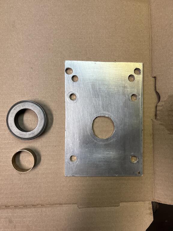

Evguy 567 #125 Posted September 1, 2022 Wheelhorse 314-8 with Onan Elite 140 First item was engine plate that was drilled for frame holes and raised with spacers for approximately 1 inch off frame. I needed to add a sleeve to go from 1 inch to 1 1/8 shaft size. I made a bushing to install a thrust bearing between pulley and engine. Engine face plate was made to support thrust bearing and mount PTO bracket. Engine holes tapped for engine face plate. Engine was aligned and bolted to new mounting plate. A relay was added to allow oil light to work, disabled low oil starter relay ( remove negative from relay plug) Wiring changes as needed. Cut exhaust pipe from cub cadet and installed 8N muffler. Shorter choke cable needed, used a old gt1800 cable. Still waiting on regulator and muffler clamp, but mowed a bit today and it works well. 5 Share this post Link to post Share on other sites
