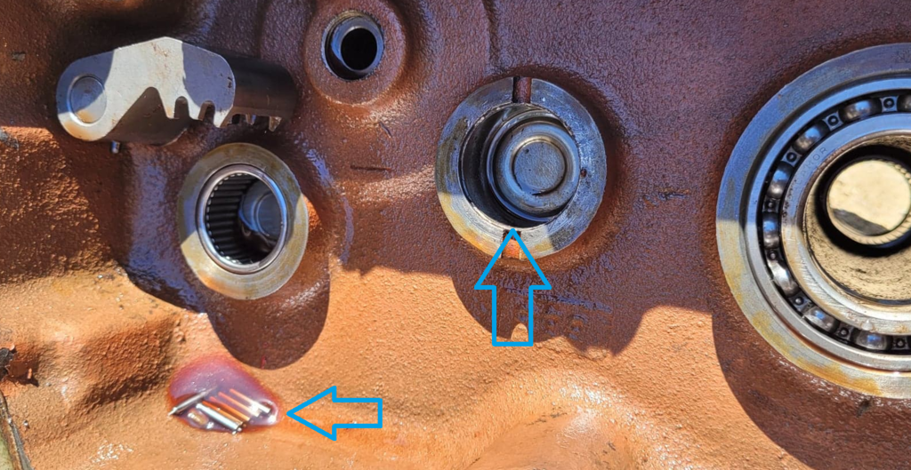

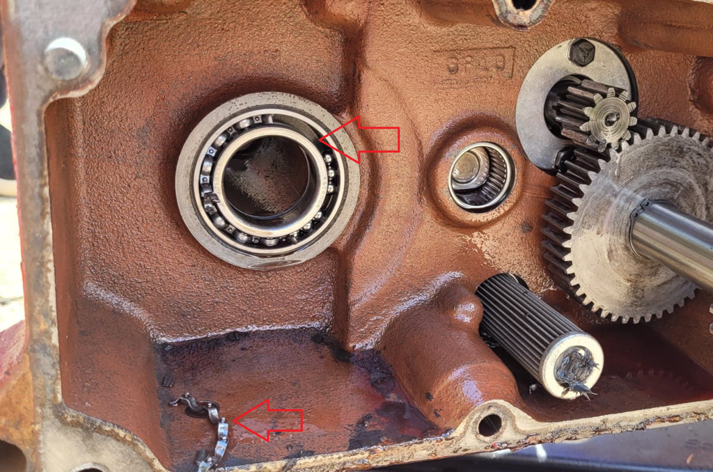

Mike C160 251 #71 Posted June 11, 2022 20 minutes ago, pfrederi said: No matter how long/carefully you drained it as you disassemble it will puke oil on the ground.... Yep, I put a pan under it before i split it. I could not get the hydro / motor off the case. All 4 bolts undone and a few gentle love taps with a knock-ometer and it did not wish to split. So I left well enough alone and left it on. Split the case while in the frame. Failures now known. Pictures and report to follow. 2 Share this post Link to post Share on other sites

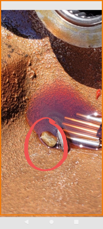

Mike C160 251 #72 Posted June 11, 2022 Ok :: Damage report. So i got off very lucky. The case, the diff and the mushroom gears are not damaged at all. No serious part failures. Failures - 2 bearings. 1) Left side inner axle bearing 1533 Partial failure / full on failure in progress. 2) Right side mushroom gear needle bearing. 7 Share this post Link to post Share on other sites

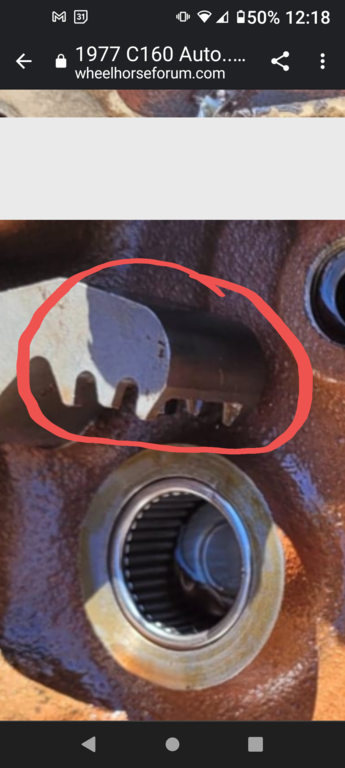

ebinmaine 75,716 #74 Posted June 11, 2022 Mike while you've got that thing apart, disassemble the differential to confirm that there are no spare parts, so to speak, in there. Shavings. Pieces of gears. Whatever. Can anybody confirm or deny that this brake pawl is whole or broken? Is this actually a rock? 1 Share this post Link to post Share on other sites
