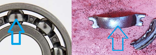

Mike C160 251 #1 Posted June 3, 2022 Greetings, I decided today i would change the oil and filter in the hydro unit. However upon draining the unit, these pieces fell out. Looks like bearing cages. Can anyone tell me where these piece might have come from and if this is a serious failure? The tractor moves forwards, backward just fine without any odd noise or leaks. Thanks and Cheers! 1 Share this post Link to post Share on other sites
WHX?? 56,397 #2 Posted June 3, 2022 I have no idea Mike but chiming in to see how those came out the drain plug hole. Filter pieces perhaps? 1 Share this post Link to post Share on other sites
Mike C160 251 #3 Posted June 3, 2022 (edited) 2 minutes ago, WHX?? said: I have no idea Mike but chiming in to see how those came out the drain plug hole. Filter pieces perhaps? The second I took the plug out, they fell into the drain pan. So they were right there at the plug. The one piece most certainly is a bearing cage, but from where? Edited June 3, 2022 by Mike C160 1 Share this post Link to post Share on other sites

Mike C160 251 #7 Posted June 4, 2022 36 minutes ago, cafoose said: Download these manuals: Could it be the cage from the dreaded 1533 axle bearing? The pump seems to have great pressure... 1 Share this post Link to post Share on other sites

stevasaurus 23,675 #11 Posted June 4, 2022 I have not seen anything like that clamp part in a transmission. I wonder if it has something to do with holding the dip stick tube?? It is hard to tell about the other piece, but I don't think it is a bearing race. You would know if it was...bearings would have come out also (needles or ball) and they would have been shooting around inside jamming gears and popping inside. I'm not sure, but I would think that pieces like that would not be able to get into the transaxle from the pump. One thing is for sure...you have more pieces floating around in the transaxle. It should be opened and checked before more or any damage is done. I'm curious to see what @daveoman1966 has to say. He is the Hydro-King. 3 Share this post Link to post Share on other sites

pacer 3,179 #13 Posted June 4, 2022 Well, one thing is for sure..... and that is that tranny is gonna HAVE to come out and find what those pieces are (which nobody has yet to identify!) Those pieces being in there cannot in any way be good and are screaming to 'find out what I am!!' we 1 Share this post Link to post Share on other sites

8ntruck 8,821 #16 Posted June 4, 2022 You beat me to it. I was just going to post that piece looks like a piece of bearing cage. If enough of that bearing cage has failed, you eventually will have loose ball bearings in the transmission. If it were mine, I'd open it up to see what is going on before it goes crunch/bang. 2 Share this post Link to post Share on other sites

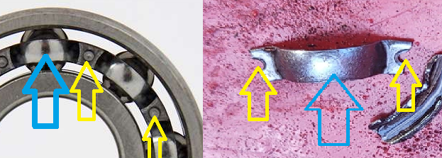

oliver2-44 11,455 #20 Posted June 4, 2022 I'll speculate that second piece is also part of a bearing cage. In its center length it looks like a bearing ball path, and it is about the same width. I think it has just been bent up by the differential gears. 3 Share this post Link to post Share on other sites
