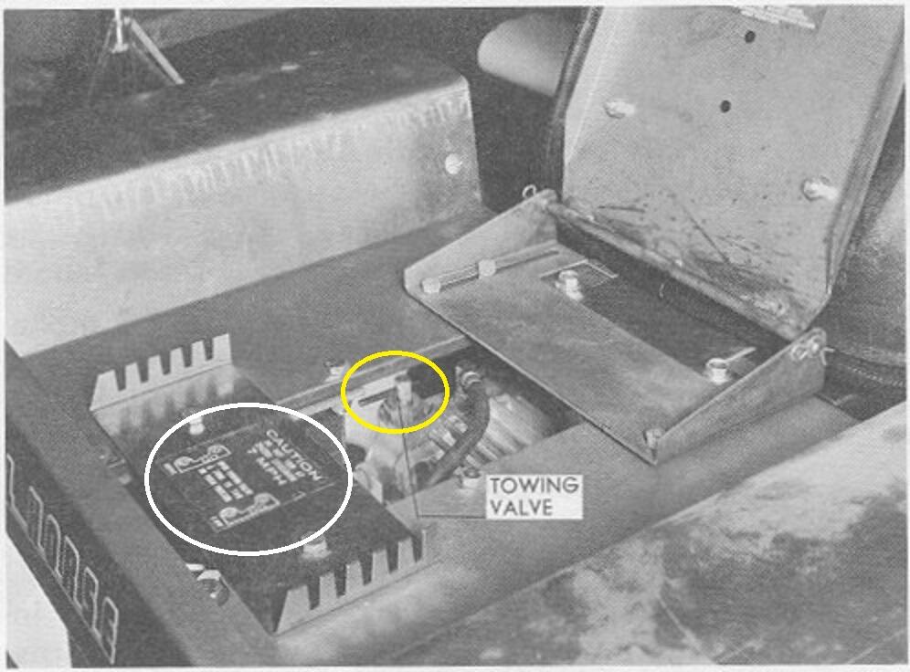

Horse Newbie 7,405 #57 Posted June 12, 2022 On 6/3/2022 at 5:09 PM, Pullstart said: the tow valve Where is the tow valve ? Share this post Link to post Share on other sites
Pullstart 71,358 #58 Posted June 13, 2022 2 hours ago, Horse Newbie said: Where is the tow valve ? Under the left panel here on top of the hydro unit, all eager beavered up with a drill bit, torch and a dull hacksaw 2 Share this post Link to post Share on other sites
ztnoo 2,302 #59 Posted June 13, 2022 Tow valve - Yellow circle Instructions - White circle 2 1 Share this post Link to post Share on other sites
Pullstart 71,358 #60 Posted June 13, 2022 @Sparky the picture above that @ztnoo posted shows the seat adjustment too. The seat bracket is on sliders, the back falls into the various adjustment slots. 2 1 Share this post Link to post Share on other sites

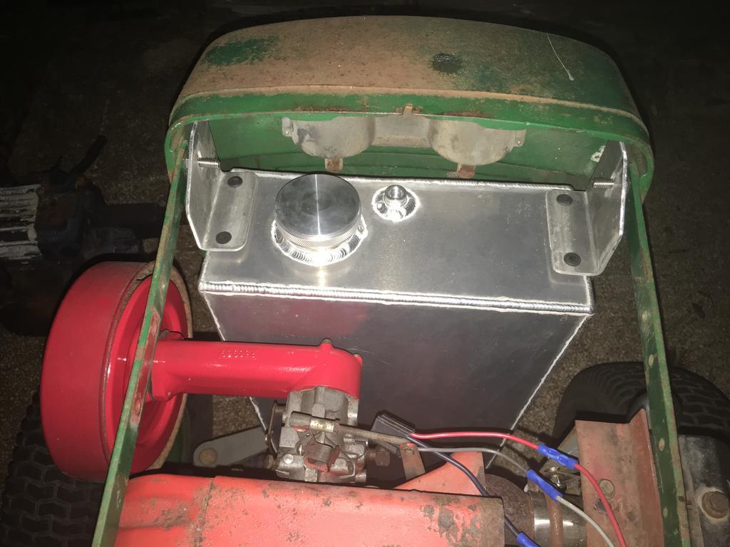

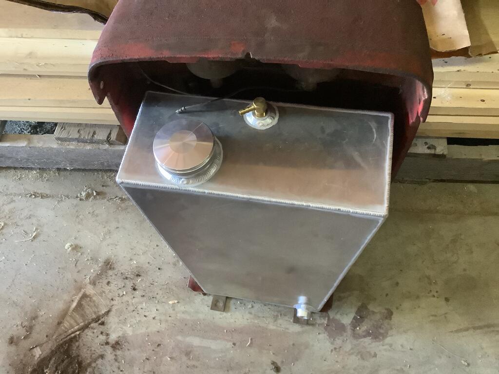

Pullstart 71,358 #61 Posted October 29, 2022 I’m waiting on some hydraulic stuff for the 520Xi loader project, so I decided to take a look at this aluminum work of art. Richie’s Skittles build for reference… 1 Share this post Link to post Share on other sites
Pullstart 71,358 #62 Posted October 29, 2022 Images from Richie’s thread 1 Share this post Link to post Share on other sites

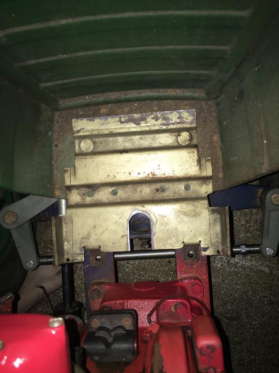

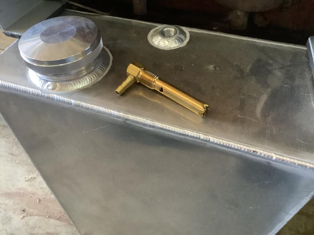

Pullstart 71,358 #63 Posted October 29, 2022 Tells me I can trim the “back” tab off the stock mounting plate. *note* I’m not sure if y’all realize this, but the brass elbow is not just an elbow for a vent. It’s a full blown vent system! 3 Share this post Link to post Share on other sites

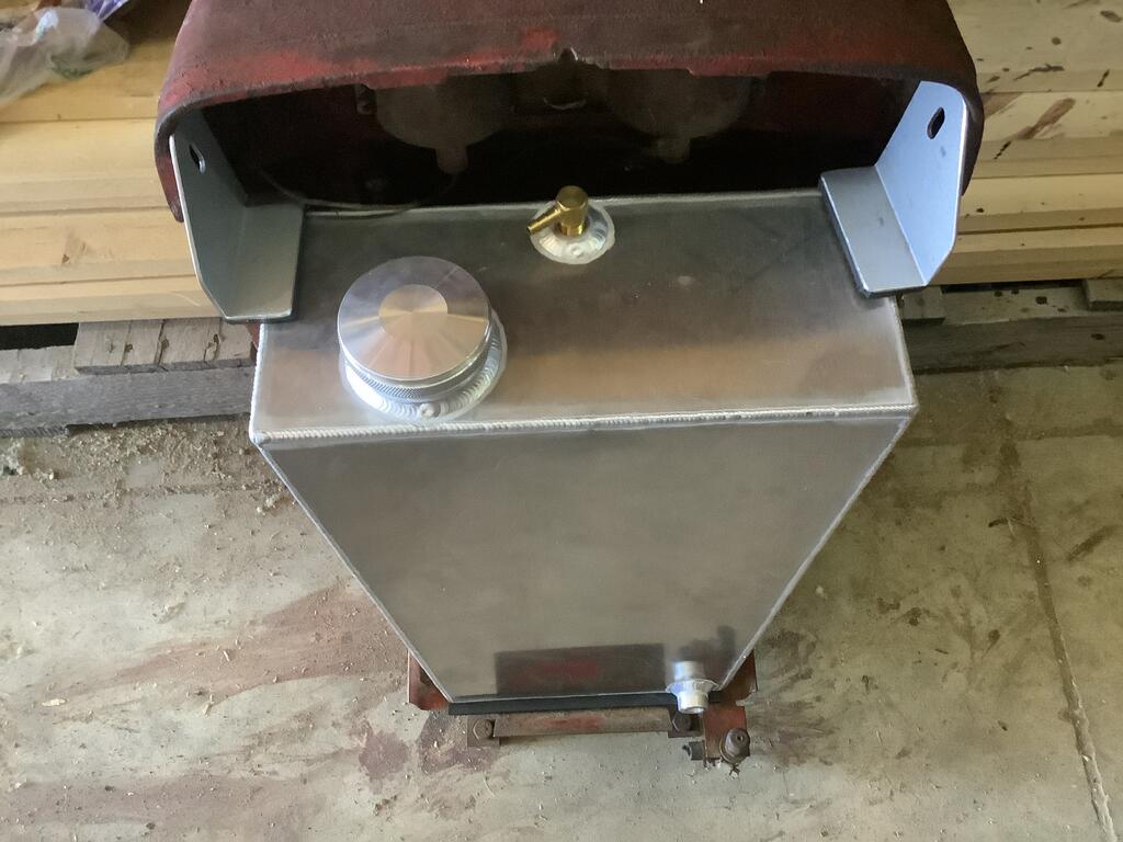

Pullstart 71,358 #64 Posted October 29, 2022 This seems to be better with no tabs in the way… 2 Share this post Link to post Share on other sites
Pullstart 71,358 #65 Posted October 29, 2022 That’s really good. 2 Share this post Link to post Share on other sites
sjoemie himself 3,238 #66 Posted October 29, 2022 Nice welding on that tank. Does the breather have a ball/spring system in it? Share this post Link to post Share on other sites
Pullstart 71,358 #67 Posted October 29, 2022 2 hours ago, sjoemie himself said: Nice welding on that tank. Does the breather have a ball/spring system in it? It’s a creation of @19richie66 and his son. I believe the breather does have a ball/spring/check of some sort. 1 Share this post Link to post Share on other sites
19richie66 17,937 #68 Posted October 29, 2022 (edited) 15 minutes ago, Pullstart said: It’s a creation of @19richie66 and his son. I believe the breather does have a ball/spring/check of some sort. It’s a rollover valve. Vents when installed as shown and if the “vehicle” rolled over, it shuts off preventing fuel spill. That’s how I read it anyways When I made my tank, I put the outlet in the bottom center hence the U shaped cut out in the mounting plate. Not sure why I did it that way. When people started wanting tanks, I wanted them to be able to fit a stock setup without someone having to really modify anything. That’s why we put the outlet in the lower corner. They worked good. Edited October 29, 2022 by 19richie66 3 Share this post Link to post Share on other sites

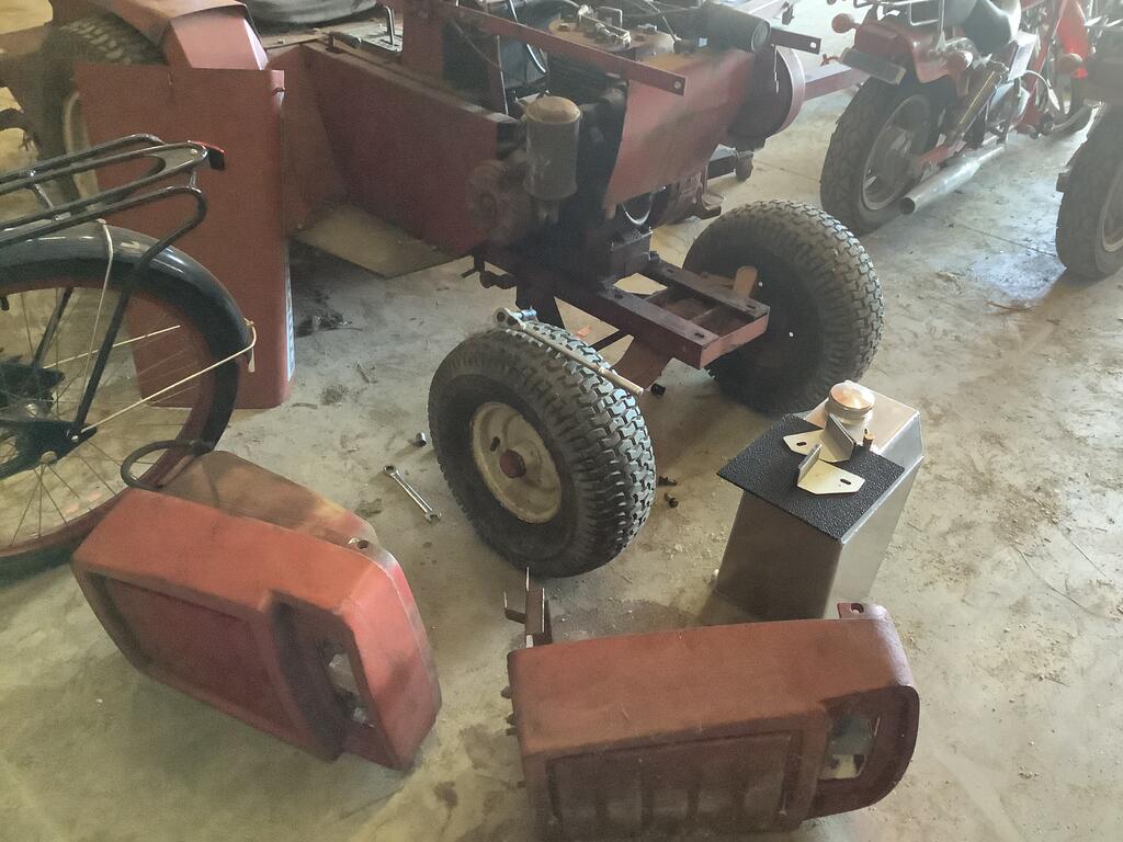

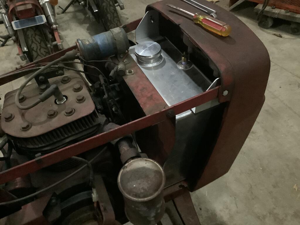

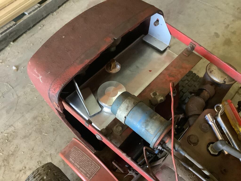

Pullstart 71,358 #69 Posted October 31, 2022 Richie’s creation fits like a glove! I opted to keep the heat shield for now. If anything, it is a great mount for the coil and condenser. This engine has a low run time since rebuild, so I re-torqued the head bolts as well. True Bear style @ebinmaine I just snugged them until they felt right. 1 1 Share this post Link to post Share on other sites
Pullstart 71,358 #70 Posted October 31, 2022 Colt’s alive! 2 1 1 Share this post Link to post Share on other sites
ebinmaine 80,904 #71 Posted October 31, 2022 29 minutes ago, Pullstart said: snugged them until they felt right. Niiiiice. You got to get them about halfway between yay tight and so tight but not as tight as wicked tight. Wicked tight is too tight. Share this post Link to post Share on other sites
Pullstart 71,358 #72 Posted October 31, 2022 4 minutes ago, ebinmaine said: Niiiiice. You got to get them about halfway between yay tight and so tight but not as tight as wicked tight. Wicked tight is too tight. Normally I crank ‘em til they snap, then back ‘em off 1/4 turn. Grade 5 gets 1/2 turn. 1 Share this post Link to post Share on other sites
Pullstart 71,358 #73 Posted October 31, 2022 Did a little run time, to get some shakes and jolts through the new system. I have to test out this funny hose barb fitting… 2 1 Share this post Link to post Share on other sites

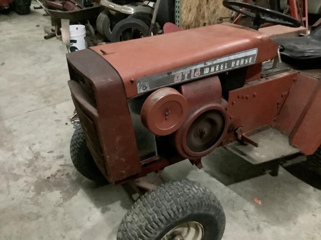

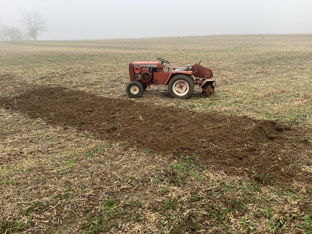

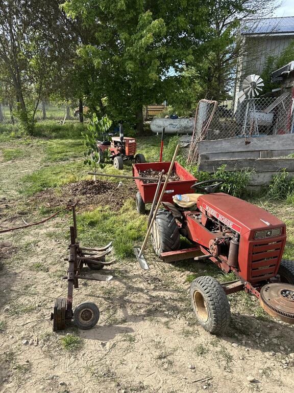

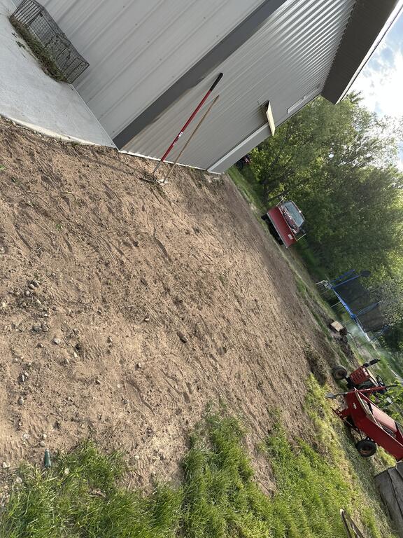

Pullstart 71,358 #74 Posted May 18 It’s been a while since Colt moved under his own power! I blew a hydraulic cylinder line back in the day, probably late 2022, or maybe spring time 2023, I pulled it apart, bought the hose kit from Lowell, and it’s been sitting ever since. We’re doing lots of work around the pool project, and a friend needed to dump two loads of fill that could be good top soil with some clean up work. Aaron has been camping in my driveway all weekend and has been a big help with the projects to be done. Between the cultivator, grader blade, tilller my plow truck, and quite a bit of hand manipulation too, we got the soil cleaned up and smoothed out! 2 4 Share this post Link to post Share on other sites
953 nut 69,787 #75 Posted May 18 That GT-14 is too big to hang from the rafters in the shop, guess you need to fix it. 1 3 Share this post Link to post Share on other sites
