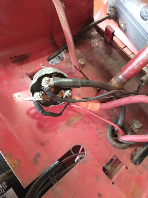

squonk 48,152 #26 Posted April 23, 2022 New HD Cole Hersee switch and larger wire on my 1075 2 1 Share this post Link to post Share on other sites
WHX?? 58,214 #27 Posted April 23, 2022 (edited) Lol the PO musta been a smoker the lighter is where the start button should be! Tell ya what I would do Dino is ditch the lighter. You don't gag anyway. Go back to an orginal start button. It will bolt right in ther & we can whip you up some new cables toot sweet if needed. I got rolls of fine strand trolling motor cable that is the cats meow for making them. Better than butchering up jumper cables and all copper. Dan and I solder the terms on and shrink wrap them. Then you can use an orginal style two prong switch as intended which would be correct for a 702. The whole thing is sailor proof and works. My 753 with the relocated panel just has a toggle switch. Tuna you need cables too say the word we like you alot more than Squonky! Edited April 23, 2022 by WHX?? 2 Share this post Link to post Share on other sites

stevasaurus 23,857 #29 Posted April 24, 2022 As I was taking pictures yesterday, I was checking the connections and wiggling the wires. Where the battery cable goes to the ignition switch is loose in the switch. I wiggled it a few times, checked the oil, and gave here a crank (like for 10 seconds)...no smoke. So I pulled the spark plug, cleaned and checked the gap. I put the plug back in and gave a squirt of penetrating oil in the carb. She popped right off and ran great...took her for a ride. I'll have to think about going back to starter button and switch, but I do want to replace those battery cables. I'll measure them and let you know. I appreciate the offer @Achto & @WHX??. 2 1 Share this post Link to post Share on other sites

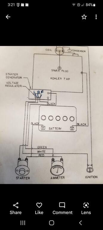

Elliot Garfinkel 166 #31 Posted April 24, 2022 Hi I'm sure you already have this.but just in case you might even be done by now but this is what I used on my 702 I don't have any hydraulics it looks like with pumps and hoses it might make it tougher routing wires 1 1 Share this post Link to post Share on other sites
stevasaurus 23,857 #32 Posted April 25, 2022 @Elliot Garfinkel Yes, that is the schematic I have. My wiring is a little different because I have a 3 prong ignition switch. I should draw up what I have so to post it for those that have the different ignition. 2 Share this post Link to post Share on other sites

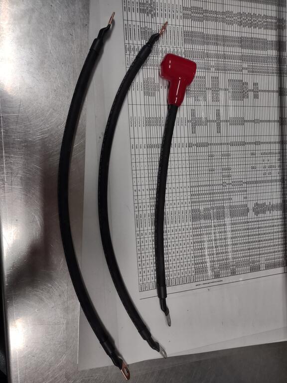

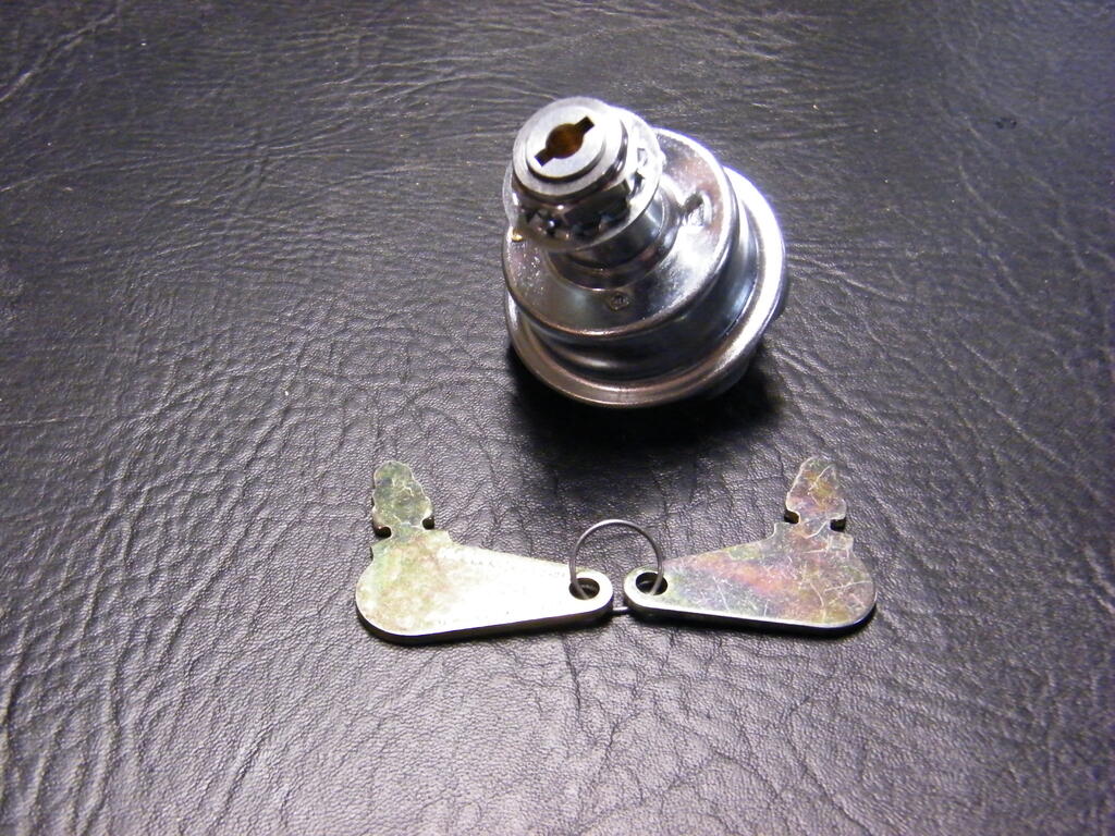

stevasaurus 23,857 #34 Posted April 25, 2022 OK...I have contacted a source for making my 6 gage cables. I have also ordered the Cole Hersee #95521-B-BX ignition switch. $44.89 shipped from dbelectric.com. I decided that I did not want to go with the push button / on off switch that came with the 702. I also want to keep the cigarette lighter because...1. it was my Dad's, 2. I just might want to have a cigar again with @stevebo at the Big Show and share some Rock & Rye. 3. @WHX?? may need a light. 4 1 Share this post Link to post Share on other sites

squonk 48,152 #36 Posted April 25, 2022 Steve, Napa 25-7320 is the belt I use on the small block genny engines (Motors) Rubber edged cogged belt. Gets me right in the middle of the adjustment slot and enough room for the regulator. If you take the wires off the regulator you can slide some heat shrink on the wire re attach and then insulate the terminals with the shrink. 25-7320 Belt Angle: 36 Deg Belt Construction: Notched Belt Material: Ethylene (EPDM) Brand: NAPA Cord Material: Polyester Cross Section Designation of Belt: HC41 Effective Length: 32 in Manufacturer: Gates Notched Belt: Yes Number of Strands: 1 Outside Circumference: 32.82 in SDS Required: No Top Width: .41 UNSPSC: 26111801 V-Belt Type: V-Belt VMRS Code: 065-005-003 Weight: 0.16 3 Share this post Link to post Share on other sites

stevasaurus 23,857 #38 Posted April 26, 2022 The 6 ga wires are ready to be mailed. I ordered the Cloe-Hersee 95521-B-BX $44.89 from D B Electrical yesterday afternoon. Guess what?? It got delivered this morning...not even a day later. UPS 1 4 Share this post Link to post Share on other sites

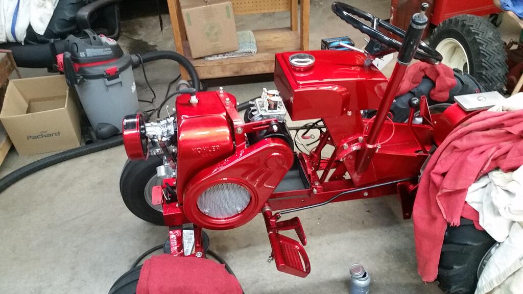

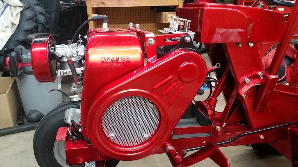

stevasaurus 23,857 #41 Posted April 26, 2022 Dang Jim, that Candy Apple Red sure is incredible. Makes me wonder if the Ponds saw that, they would have used it. 1 Share this post Link to post Share on other sites
