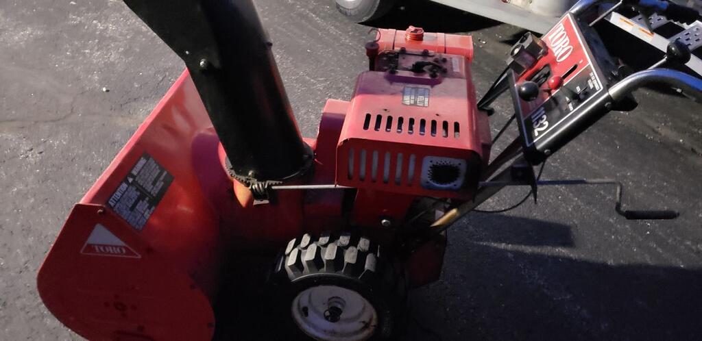

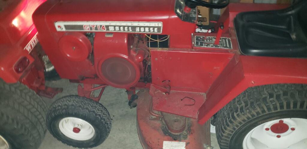

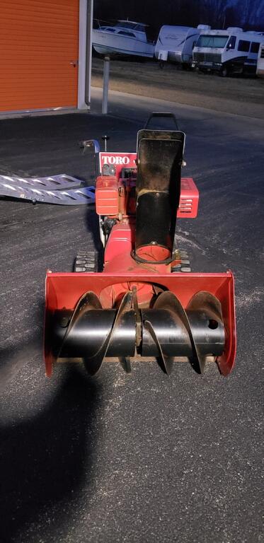

BPEisenhower 553 #1 Posted March 7, 2022 Hello all! I had the privilege of going to Greenfield and Waupun Wisconsin this weekend and picked up a few more toys! GT 14 hasn't been outside since 1982 but didn't mind fresh fuel and a battery. Will need all fluids changed and hopefully figure out what hydraulic fluid is correct. And the 1132 Toro snowblower has sat 5 years but started with no trouble with the fuel that was in it. A 75 year old woman owned it and swore by buying the best fuel with no ethanol! Going to service and then spray with Fluid Film to preserve. Thank you all and be blessed! 6 8 Share this post Link to post Share on other sites
ebinmaine 77,305 #2 Posted March 7, 2022 6 hours ago, BPEisenhower said: Will need all fluids changed and hopefully figure out what hydraulic fluid is correct Nice find! Likely @953 nut or @19richie66 could help you out with the fluid type. 1 1 Share this post Link to post Share on other sites
Achto 30,961 #3 Posted March 7, 2022 7 hours ago, BPEisenhower said: Hello all! I had the privilege of going to Greenfield and Waupun Wisconsin this weekend Sweet haul!! Should've given me a heads up, could've met up for lunch or something. Waupun is not too far from me. 4 Share this post Link to post Share on other sites
953 nut 64,084 #4 Posted March 7, 2022 8 hours ago, BPEisenhower said: Will need all fluids changed and hopefully figure out what hydraulic fluid is correct. Pull the transmission dip stick and lay it on a clean white paper towel, if it is amber color use 10 W 30 and if it is pink use Dex/merc ATF. The filter is a NAPA 1410 or Wix 51410, either one will do the job. 3 1 Share this post Link to post Share on other sites
Pullstart 68,858 #5 Posted March 7, 2022 Sweet finds! That auger on the blower looks well made. I think I like those drum styles more than the individual blades! 2 1 Share this post Link to post Share on other sites

BPEisenhower 553 #10 Posted March 7, 2022 10 hours ago, Pullstart said: Sweet finds! That auger on the blower looks well made. I think I like those drum styles more than the individual blades! I had no idea Toro made that size of blower and there's a 12hp version 2 Share this post Link to post Share on other sites
BPEisenhower 553 #11 Posted March 7, 2022 10 hours ago, 953 nut said: Pull the transmission dip stick and lay it on a clean white paper towel, if it is amber color use 10 W 30 and if it is pink use Dex/merc ATF. The filter is a NAPA 1410 or Wix 51410, either one will do the job. Thank you for the help! Definitely going to follow the advice and hopefully use it occasionally. Have to put 3 pt on and see how it does with a plow or tiller 3 Share this post Link to post Share on other sites
BPEisenhower 553 #12 Posted March 7, 2022 13 hours ago, ebinmaine said: Nice find! Likely @953 nut or @19richie66 could help you out with the fluid type. I'm hoping it's fluid/filter related problem! Slow in reverse and jumpy/ cavitation in forward travel. I believe it's original filter and fluid 3 Share this post Link to post Share on other sites

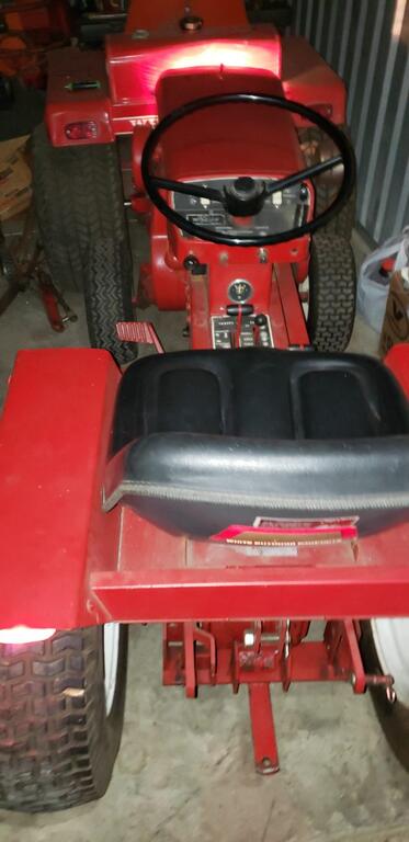

19richie66 17,803 #13 Posted March 7, 2022 So did you get the three point hitch with it? I see it has the upper lift bracket and lower mount. I believe I see the lower arms and lift links in the first picture by the D series rear tire. That would be a nice bonus! 2 Share this post Link to post Share on other sites

BPEisenhower 553 #17 Posted March 8, 2022 On 3/7/2022 at 5:07 PM, 19richie66 said: So did you get the three point hitch with it? I see it has the upper lift bracket and lower mount. I believe I see the lower arms and lift links in the first picture by the D series rear tire. That would be a nice bonus! I did get the 3 pt with it! However, I kept banging my shins in to it so to keep cursing at a minimum, I pulled the pins. LoL 🤣 The tractor in front of it is my Automatic 18 that has a 3 pt too but was never installed. Still in the box 2 1 1 Share this post Link to post Share on other sites

19richie66 17,803 #20 Posted March 8, 2022 13 minutes ago, BPEisenhower said: I did get the 3 pt with it! However, I kept banging my shins in to it so to keep cursing at a minimum, I pulled the pins. LoL 🤣 The tractor in front of it is my Automatic 18 that has a 3 pt too but was never installed. Still in the box Thats great. I was thinking that is when you picked it up. That D with the GT makes for a nice heavy duty combo. 1 Share this post Link to post Share on other sites
BPEisenhower 553 #21 Posted March 8, 2022 On 3/7/2022 at 4:52 PM, BPEisenhower said: Thank you for the help! Definitely going to follow the advice and hopefully use it occasionally. Have to put 3 pt on and see how it does with a plow or tiller It's red!!! Like a dummy, there's a sticker underneath the seat that says use ATF... need to look at these handy decals more closely. Filter is stuck and I think it's the original... 1 1 Share this post Link to post Share on other sites
