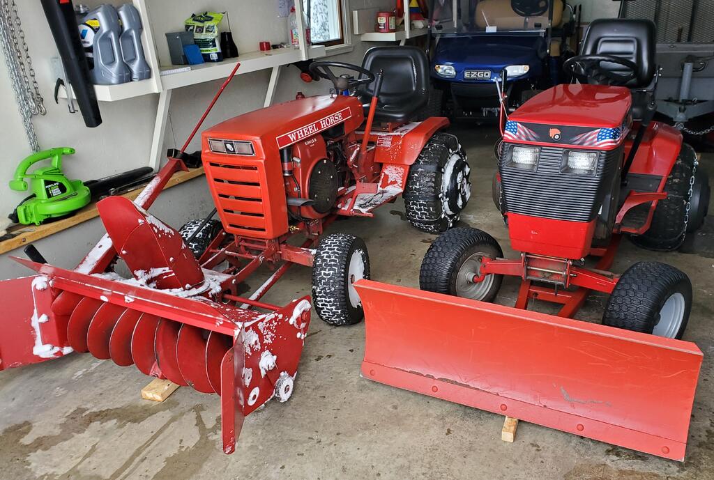

WHX?? 55,260 #27 Posted March 1, 2022 13 hours ago, Cee245 said: I actually like my tall chute more than my 2 stage. Hate to admit it what with the time & money I got in a deuce but the single is my go to. Mainly the weight but @dclarke put electrics on the chute and that is the cat's meow. Deuce is set up more for off the driveway business. Skids set up higher. 59 minutes ago, Ed Kennell said: I run my P220 at 3200 Same here when the throttle creeps so i just let it run at that. Little better on fuel too. Did you mention what tractor this is going on Bob? 1 Share this post Link to post Share on other sites

Racinbob 12,812 #32 Posted March 1, 2022 34 minutes ago, WHX?? said: Hate to admit it what with the time & money I got in a deuce but the single is my go to. Mainly the weight but @dclarke put electrics on the chute and that is the cat's meow. Deuce is set up more for off the driveway business. Skids set up higher. Same here when the throttle creeps so i just let it run at that. Little better on fuel too. Did you mention what tractor this is going on Bob? It's replacing the old short chute on the 76. I run the blade on the 05. I usually use it cuz it's more fun. This was a week or two ago and obviously I just got done using it. 1 1 Share this post Link to post Share on other sites

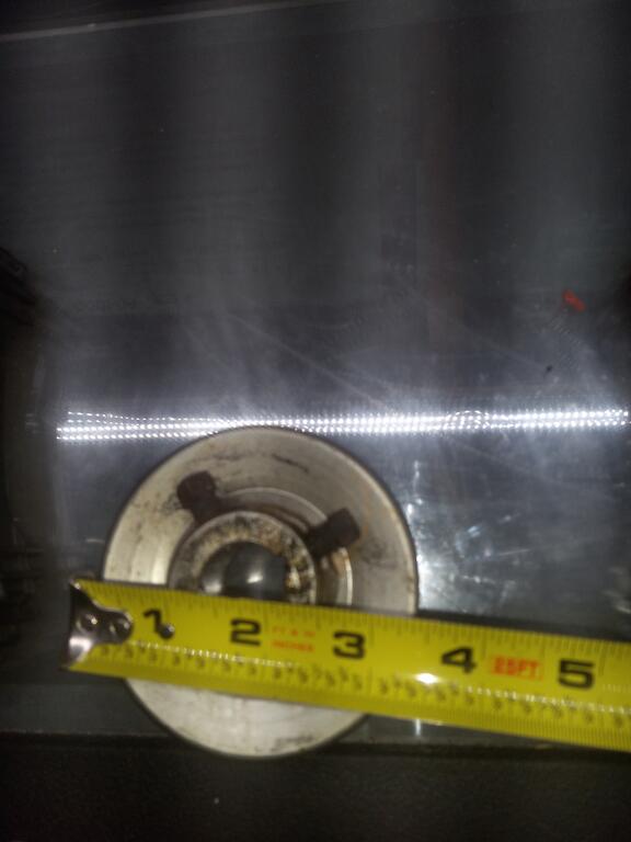

Cee245 852 #37 Posted March 2, 2022 On 3/1/2022 at 8:09 AM, Ed Kennell said: I don't have the blower to check Bob, @Cee245 owns it, but I think the factory is 5" and I went to 4.5". My main reasons were one, to gain enough clearance to the housing to change the belt without looseninjg the jack shaft bearings. And two, I run my P220 at 3200 because it just sounds so much better than at 3600. So my smaller blower drive pulley simply brings the auger back up to factory design speed. I don't have any evidence, but higher auger RPM should increase the performance of a single stage blower as it would for any centrifigal pump. @Ed Kennell I changed the pulley back to what i think is factory size. I still have the one you had on there. I'll try to check the sizes tonight and reply back. 2 Share this post Link to post Share on other sites

Cee245 852 #41 Posted March 3, 2022 (edited) Close Ed... The one you had is 3.5". I put one on that is 4.5" but mine is too narrow. I think I may change in back so i don't ruin the belt. It works well though. The only reason I changed that smaller pulley is I had thought it may spin the auger too fast and hurt it in the long term. Does anyone have a recomendation on WHERE to order the correct size pulley? Edited March 3, 2022 by Cee245 Share this post Link to post Share on other sites
wallfish 19,387 #42 Posted March 3, 2022 5 hours ago, Cee245 said: Does anyone have a recomendation on WHERE to order the correct size pulley? https://www.surpluscenter.com/Pulleys-V-Belts/Finished-Bore-Pulleys/?page_no=1&fq=ATR_Grooves:1 Might be able to find'm cheaper elsewhere online but these cast pulleys are tough. A steel pulley will work too but just don't use any pot metal pulleys Share this post Link to post Share on other sites
peter lena 9,782 #43 Posted March 3, 2022 @WHX?? read your responses , my take looking at every intended function on a horse , is to make it easier , smoother , quieter . pulleys and belt set ups , usually packed in rust , think if you like it that way , don, t change a thing . ideas , are to be challenged called out and laughed at , about done , pete 1 Share this post Link to post Share on other sites
Ed Kennell 45,044 #44 Posted March 3, 2022 9 hours ago, Cee245 said: WHERE to order the correct size pulley? I bought that one at TSC. Share this post Link to post Share on other sites
