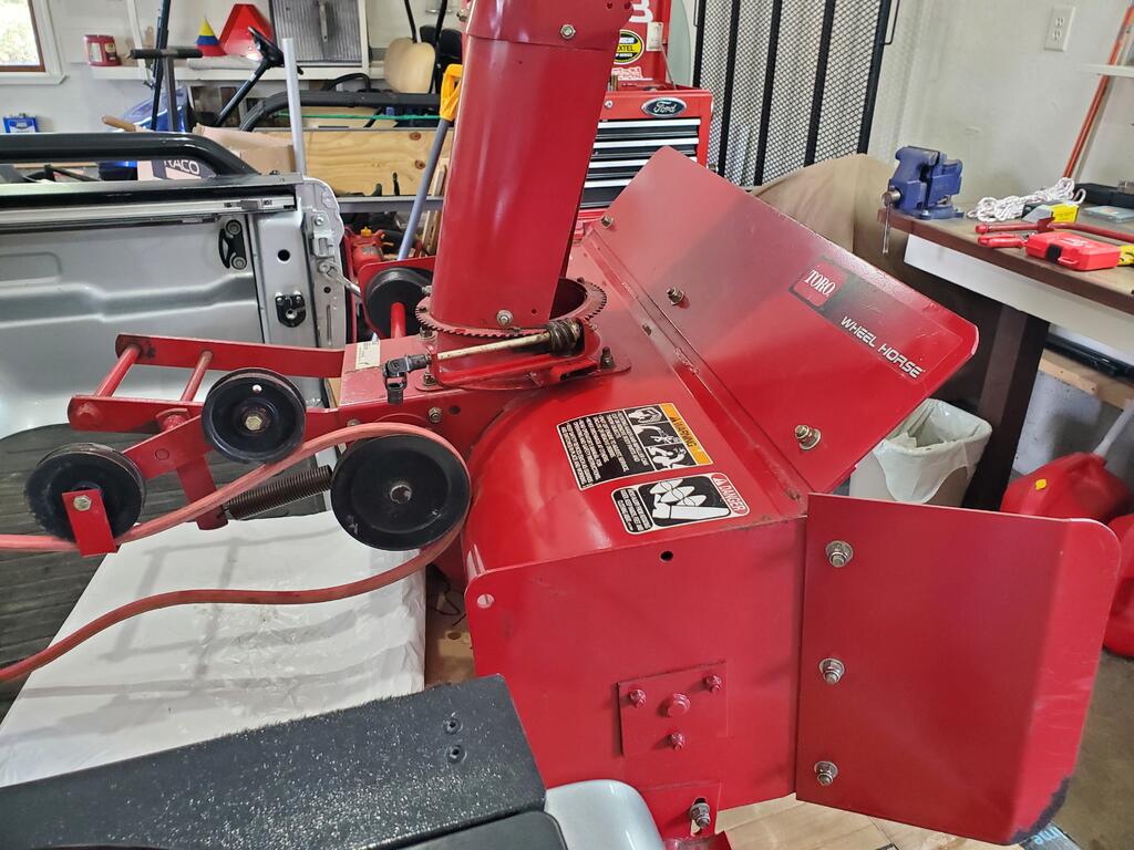

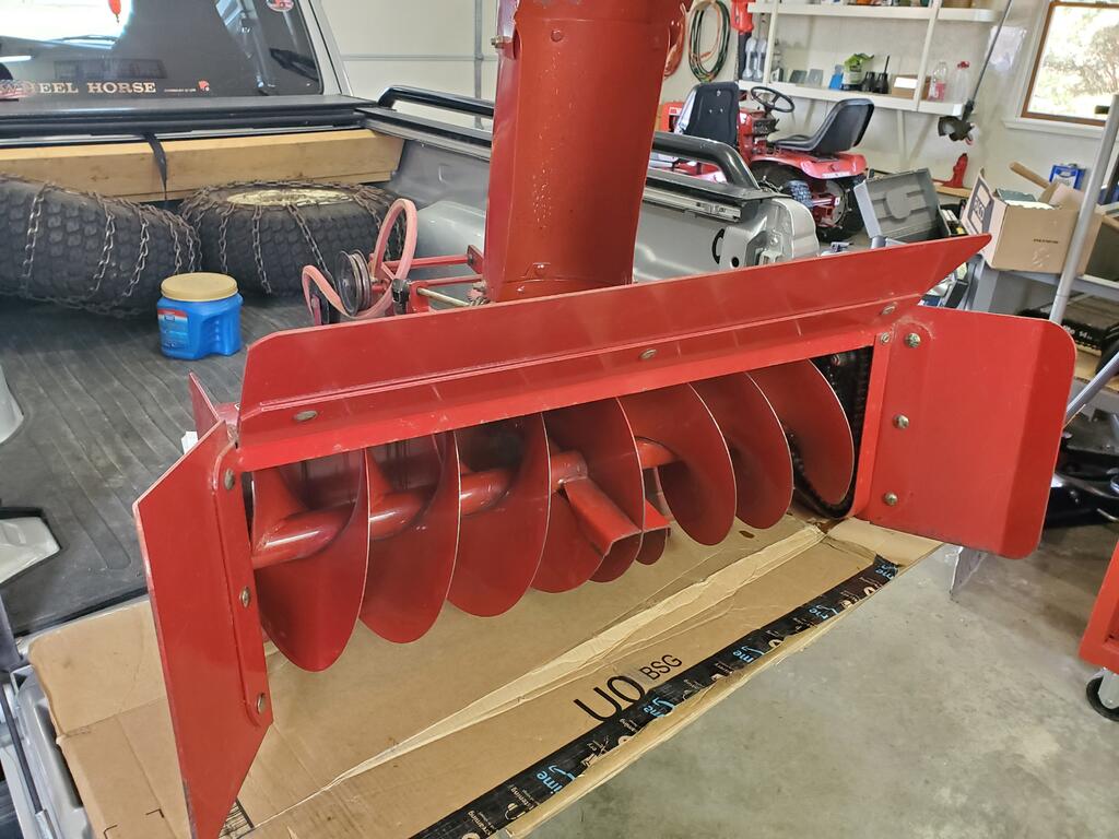

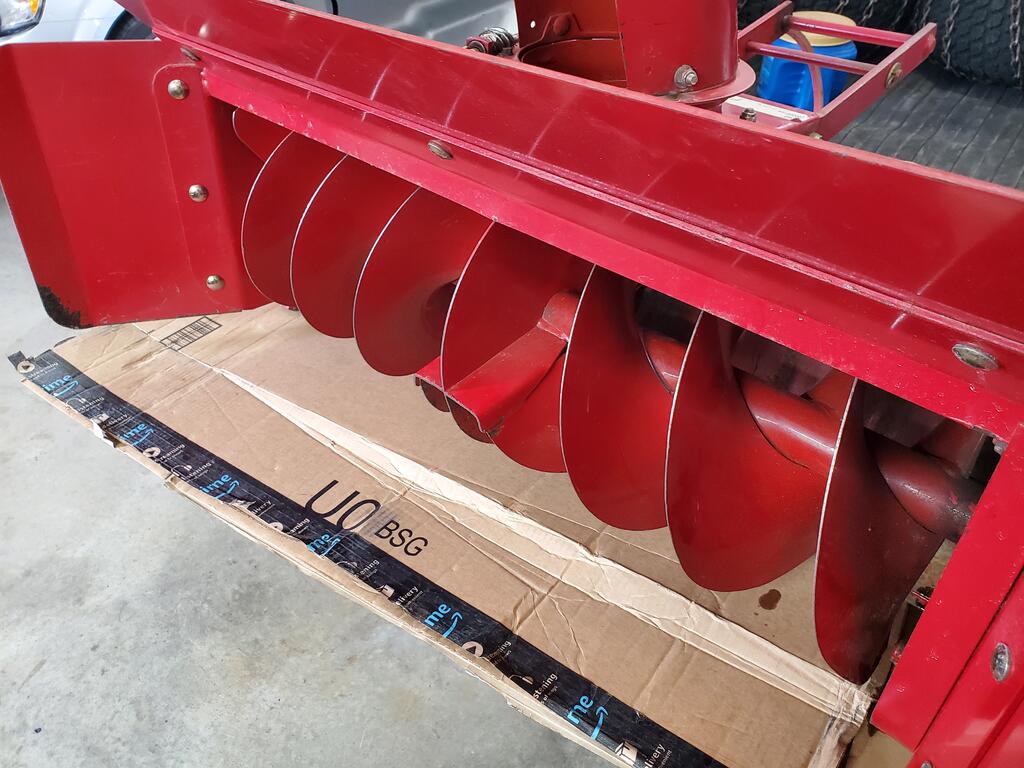

Racinbob 13,213 #1 Posted February 28, 2022 You saw it from the mirror of my truck first. Here it is in the bed. From the paperwork this looks to be a 2000 or 2001. I've been looking for a tall chute but I just couldn't find anything around here. This one was further away than I intended to drive but you rarely see these is this condition anymore. So I made the road trip to, of all places, Chambersburg, PA, and had the pleasure of meeting another member. @"Manic-Mechanic" Dave's a great guy and as you'd figure, frequently attends the big show. I would have liked to have had more time to chat as he's got some other cool toys. I got back yesterday afternoon and just left it in the truck knowing that I wanted to do the usual routine service on it. There really isn't anything else it needs. I oiled up the chain and chute rotator and greased the two flange bearings. I also removed the pulley on the drive shaft, cleaned it up and reassembled with anti-seize. It wasn't util I loaded these pics on my puter that I noticed something that made me chuckle. I won't even tell you which pic. You tell me. Question for you guys. I often see these tall chutes with a deflector shield rising up about 6" from the bottom. Does this shield do much of anything? Obviously it would be a simple fabrication. 3 6 Share this post Link to post Share on other sites
WHX?? 58,303 #2 Posted February 28, 2022 Belt on wrong 1st pic. 1 Share this post Link to post Share on other sites
Racinbob 13,213 #3 Posted February 28, 2022 It doesn't surprise me that it didn't take long. It's actually more obviously in the second picture. The belt is tied up in the first pic. I chuckled because all the time I was working on it I never noticed it. 1 Share this post Link to post Share on other sites

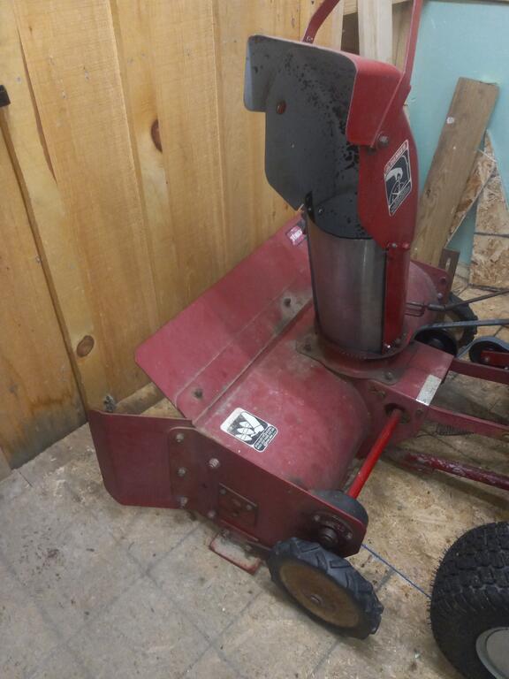

Ed Kennell 47,597 #4 Posted February 28, 2022 13 minutes ago, Racinbob said: I made the road trip to, of all places, Chambersburg, PA, Well now, I never thought I would see the day when @Racinbob would resort to the tatics of some of his horse thiefing mid western mafia neighbors. But, that is a good looking chucker and we really don't need them anymore here in the PeeAaa. I did enclose the front of my tall chute and it did help to keept some snow from spilling out the front especially in light skimpy snows. I don't think it increased the distance it could chuck it and it didn't do much anything when blowing good heavy snow when the blower was kept full and working hard. I did remove the wire guard in the chute. 1 1 Share this post Link to post Share on other sites
peter lena 10,090 #5 Posted February 28, 2022 @Racinbob looks good to me , a real rarity today , given its age . just something I would add is the lubrication to that idler pulley frame , often neglected , but chassis grease in that solid rod to hole in frame spot , lets that work easier and helps belt spin up . also recommend lubriplate chain and cable lubricant on that auger chain . never let mine dry out , spray before and after use . chassis grease on the chute rotation gear , good luck with it , pete 2 Share this post Link to post Share on other sites

Ed Kennell 47,597 #9 Posted February 28, 2022 1 hour ago, Racinbob said: I noticed something that made me chuckle I find only about half of the blowers have the belt routed incorrectly. But you have one of the rare blowers. Around 95% of them have the side wings on up side down. 2 Share this post Link to post Share on other sites

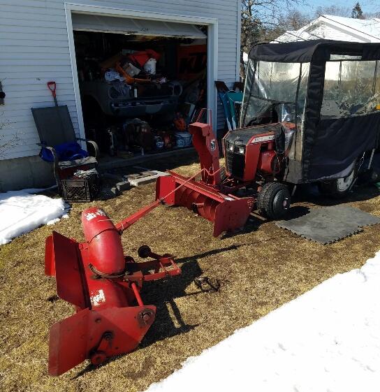

midpack 1,148 #15 Posted February 28, 2022 Must be tall chute week! I just got this last Saturday. Only had to drive 10 miles though. 3 Share this post Link to post Share on other sites
rjg854 13,404 #16 Posted February 28, 2022 The only thing I noticed was the deflector plates are put on the back side of the framework instead of in front. Share this post Link to post Share on other sites
Racinbob 13,213 #17 Posted February 28, 2022 51 minutes ago, rjg854 said: The only thing I noticed was the deflector plates are put on the back side of the framework instead of in front. Nah, Jim got it in post #2. The plates are supposed to be mounted on the outside per Toro/Wheelhorse. I don't see why it really matters though. 1 Share this post Link to post Share on other sites
WHX?? 58,303 #18 Posted February 28, 2022 (edited) 2 hours ago, rjg854 said: The only thing I noticed was the deflector plates are put on the back side of the framework instead of in front. 1 hour ago, Racinbob said: Nah, Jim got it in post #2. RJG Gotta tell ya tho Bob after further review looks like you got a real nice one. Paint not even worn off... very little if any rust and auger has no dings and looks to be very good shape. Guessing you checked the idler sprockets and the chain. That's the wear points on these. Seems the small drive sprocket on the topside likes to contract hook teeth syndrome more so than the idlers or the auger sprocket so keep an eye on that. Most of mine have the plastic cover busted off so no a problem. Petes got you covered on lubing. Edited March 1, 2022 by WHX?? 1 2 Share this post Link to post Share on other sites
Cee245 861 #19 Posted March 1, 2022 6 hours ago, Ed Kennell said: I did enclose the front of my tall chute and it did help to keept some snow from spilling out the front especially in light skimpy snows. Yes he did. Here is a pic of it... Lol I actually like my tall chute more than my 2 stage. It's mostly because of the extra weight of the 2 stage. The tall chute is easier to control and does well. 5 1 Share this post Link to post Share on other sites

rjg854 13,404 #25 Posted March 1, 2022 14 hours ago, Racinbob said: The plates are supposed to be mounted on the outside per Toro/Wheelhorse. I don't see why it really matters though. I was told that not to long ago here on the forum, guess you can't believe everything you hear. 2 Share this post Link to post Share on other sites
