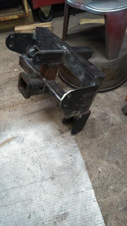

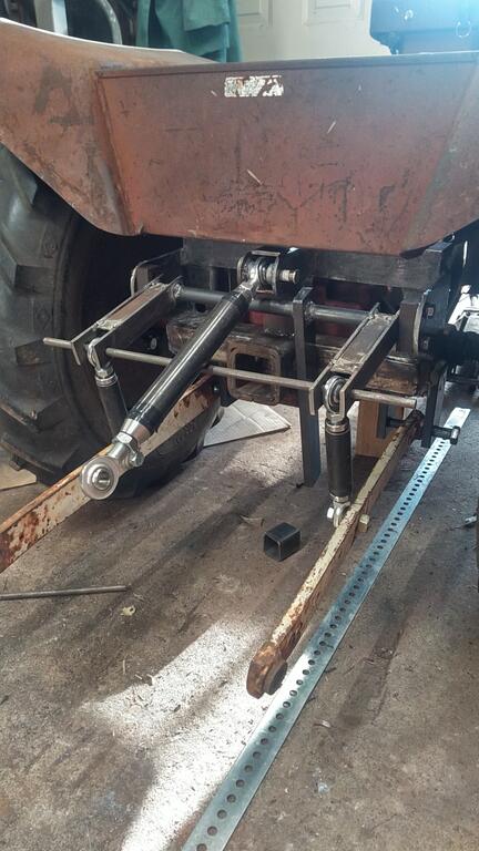

JPWH 6,544 #36 Posted March 25, 2022 The last two pieces tacked up and fitted. Even tried the top center link to get an idea for the height of the 3 point to sleeve adapter. Now to make some more bushings and pins and final welding. 3 7 Share this post Link to post Share on other sites

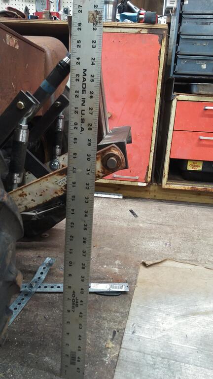

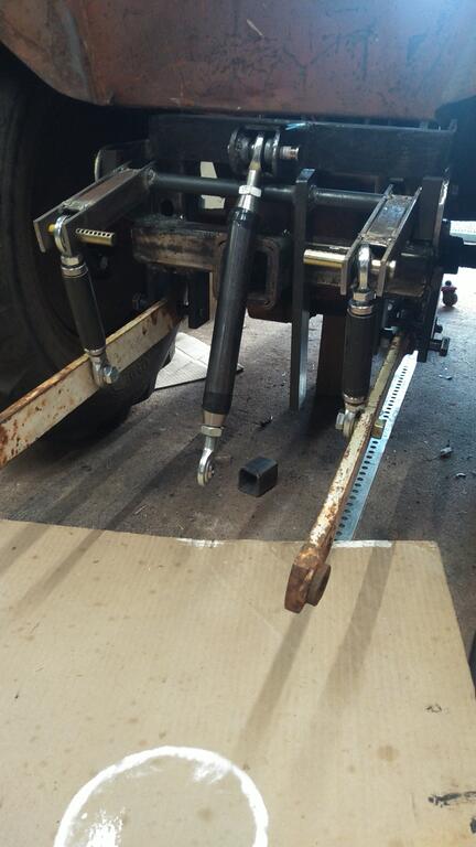

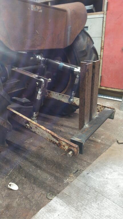

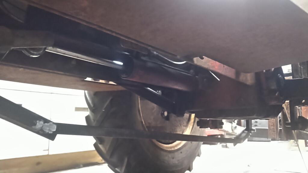

JPWH 6,544 #39 Posted March 27, 2022 (edited) Made some progress today. I installed the modified rock shaft and tacked up the link from the hydraulic cylinder to the lift. I also tacked the frame together for the sleeve hitch to see what adjustments might be needed. I have a few adjustments to make but it is working. Still a couple hours of final welding to do. Edited March 27, 2022 by JPWH 5 7 Share this post Link to post Share on other sites

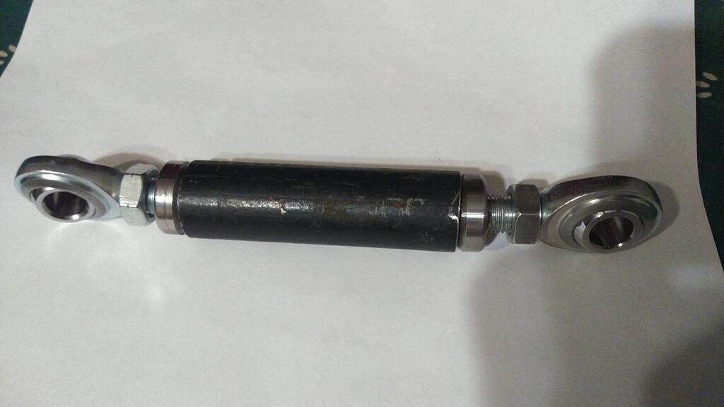

JPWH 6,544 #41 Posted March 28, 2022 What would you do? While I was working on the pins and bushings and sort of making up a completion list I realized I had not built in a float mechanism. I think I have an idea but I want to hear your ideas. Jay 1 Share this post Link to post Share on other sites

Handy Don 17,486 #44 Posted March 29, 2022 This one made me curious so I went to the 'web to do some research! Seems that down pressure is very rare in 3-points and that most use a linkage between the (upper) lift arm and the (lower) drag arm that allows the drag arm to move independently by anywhere from a couple inches (using a slotted link bar or nested pipes/tubes) to a lot (using chains). The discussion was that most rear implements find their own level (plows, harrows, cultivators, moldboards, etc.) and that don't have an operator-controlled "bottom" (trailers being the most commonly cited example). Seems there is also variation on whether the drag arms are interconnected, and by what means, to keep an implement "level" within a set range. Some JDs (and others?) have a rate control that, as near as I can tell, throttles the speed of the lift/drop separately from tryin to feather the control lever. So bottom line to you, @JPWH, seems that you would change the lift-to-drag arm linkage mechanism to suit how you want the attached implement to behave. 1 1 Share this post Link to post Share on other sites
JPWH 6,544 #45 Posted March 29, 2022 Thanks for that suggestion about the pipes @Handy Don. That is better than my idea and I think I have a plan to make it work. Jay 1 Share this post Link to post Share on other sites

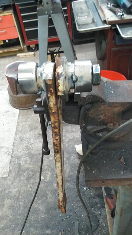

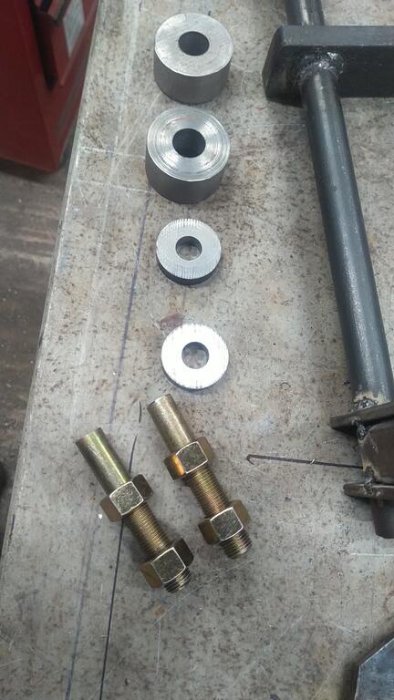

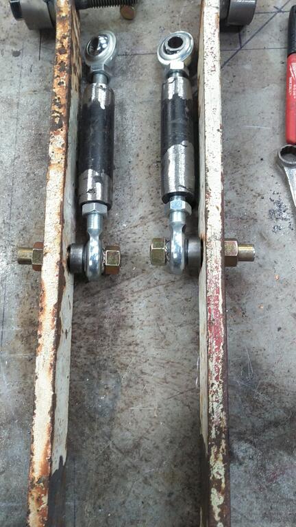

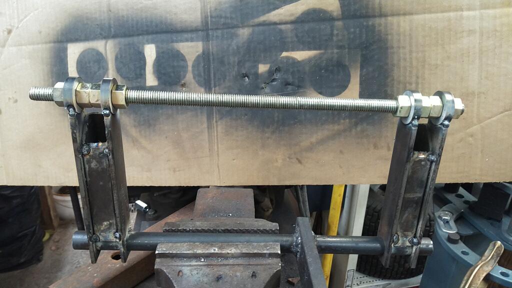

JPWH 6,544 #47 Posted April 5, 2022 (edited) I made some bushings and pins. Jigged these up to keep them aligned and tacked them in place. Aligned the bushings and pins and tacked the bushings in place. Main hitch frame. Edited April 7, 2022 by JPWH 7 2 Share this post Link to post Share on other sites
JPWH 6,544 #48 Posted April 7, 2022 Bottom picture in post #47 shows the frame that bolts to the transmission. Was showing two pictures before editing. Jay 1 Share this post Link to post Share on other sites
