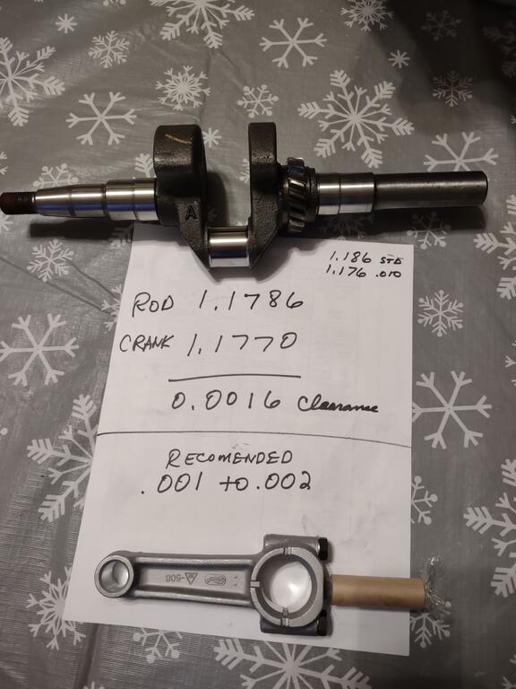

Achto 32,891 #130 Posted March 9, 2022 I got my crank shaft back from the machine shop today. Price was reasonable as well. When I dropped off my crank I also took my new rod and a copy of the spec sheet from the Kohler manual. If you look over the measurements that the machinist wrote down you will see why it is very important to have your new part with you when you drop parts off for machining. The two numbers in the right hand corner are the STD. and .010 under crank measurements according to the manual. My new rod was more on the lines of .009 under than .010 under so he compensated for this discrepancy. 3 11 1 Share this post Link to post Share on other sites

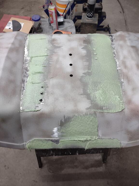

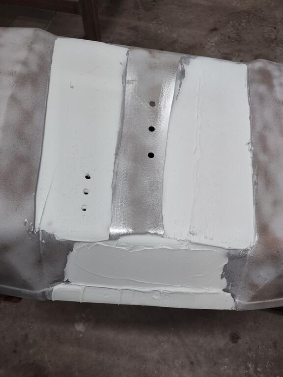

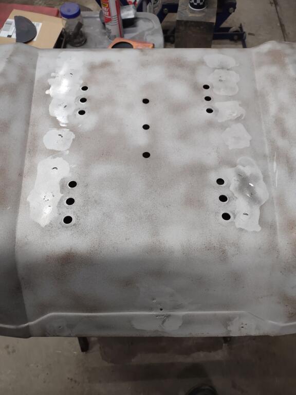

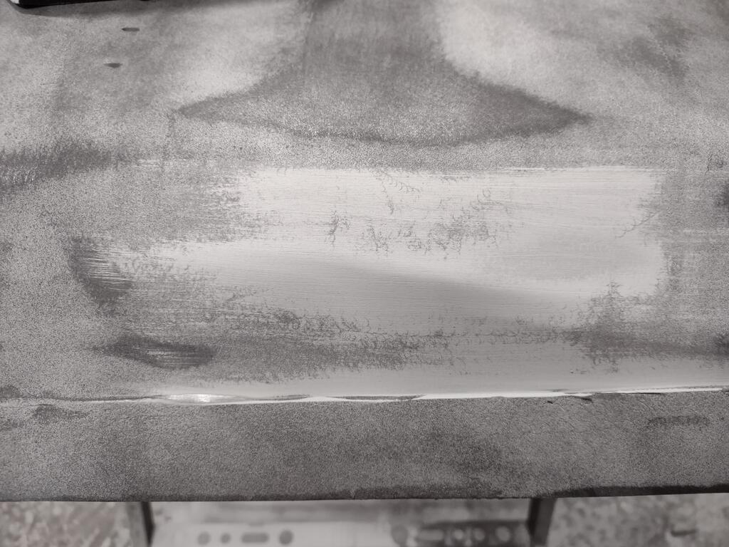

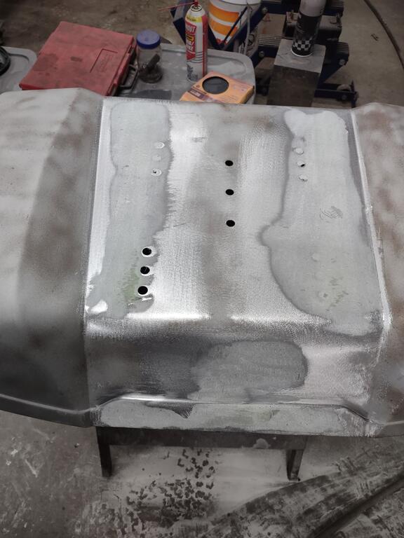

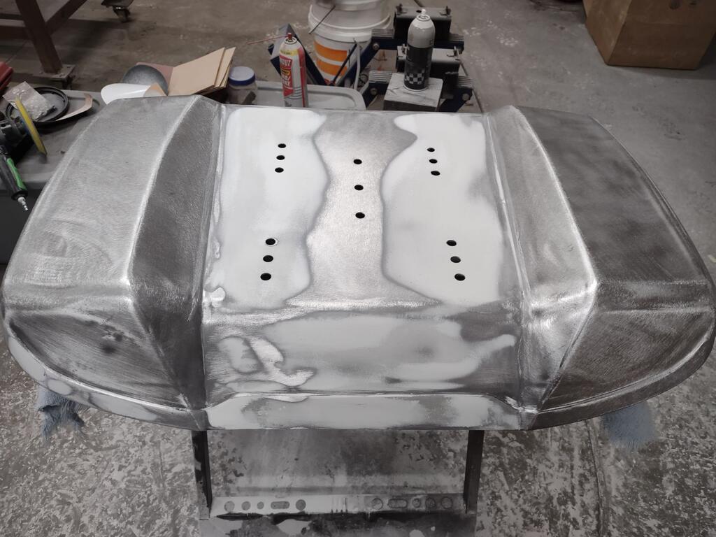

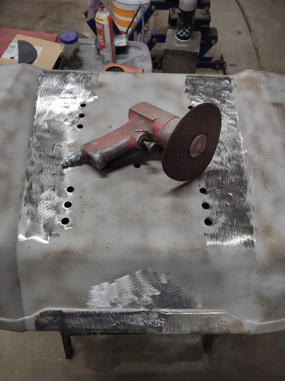

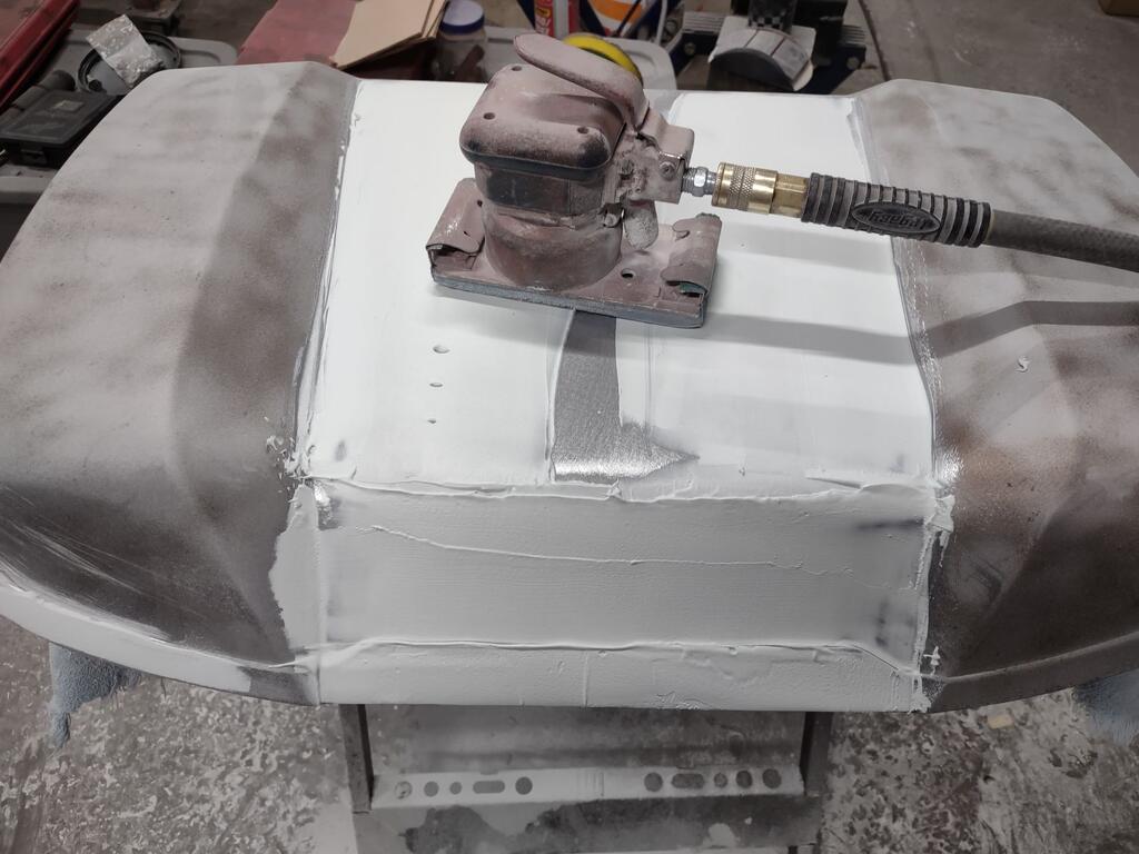

Achto 32,891 #139 Posted March 14, 2022 (edited) Spent the day on Sat. getting the body work done on the sheet metal. @ebinmaine and @giddyap were asking questions about body filler so I thought that I would share a tutorial on my process. First and foremost, fiberglass and polyester filler should only be applied over solid bare metal with a good mechanical scratch in it. It does not adhere well to paint or primer. Our victim for this is my rear fender pan. To get a good mechanical scratch I use a grinder with 24grit paper on it, Because I had some spots that were welded on the rear pan, I used a fiberglass reinforced filler first. The fiberglass reinforced filler is very strong and works well to seal any pin holes that may be left behind after welding and grinding. If you are not filling in over welds this step is not necessary. After the filler hardens then it is sanded down to smooth it out. We are not looking for a finished product with this filler. It is sanded down with 36 grit paper. After blowing the part off so that it is dust free, a coat of polyester filler is applied. Again I use 36 grit paper to sand this down after it hardens. With this coat I am looking to get every thing as smooth & strait as possible. If I should notice any minor imperfections after I have sanded the filler down then I will add a light coat of a filler called Icing. Icing is a thin very smooth polyester filler used for fine imperfection. Again make sure the part is dust free before applying filler. Once this filler is sanded down to near perfection with 36 grit then I spray a guide coat of contrasting color over the filler. In this case I used a flat black out of a spray can. After the guide coat dries then I use 80 grit paper on a sanding block to sand the filler until the guide coat is gone. After a few swipes with the 80 grit. The pic below shows how the guide coat allows you to easily see the imperfection and 36 grit scratches that need to be sanded out. After the part has been block sanded with 80grit until the guide coat is gone, then a light block sanding with 180 grit is the final step to make your part ready for primer. 80 grit paper is fine enough for any bare metal before priming. Fender pan strait smooth & ready for primer. Hope to prime next Sat, then wet sand & paint on Sun. Edited March 14, 2022 by Achto 2 11 2 Share this post Link to post Share on other sites
WHX?? 58,324 #140 Posted March 14, 2022 (edited) Holy crap Dan I'd had bondo in my crack at at the first pic and been bound up for a month of Sundays! Remember guys this is just under the seat that might not never be seen. Now you know how particular he is. Got a 701 hood ready for the same treatment if yer up for Dan. Pays lousy but bennies are good! Edited March 14, 2022 by WHX?? speeling 7 Share this post Link to post Share on other sites
ebinmaine 81,047 #141 Posted March 14, 2022 8 hours ago, Achto said: share a tutorial on my process. Excellent Dan!! Thank you for taking the time to post. I've saved the link in my "417A" notes. @WHX?? 2 Share this post Link to post Share on other sites

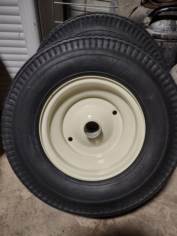

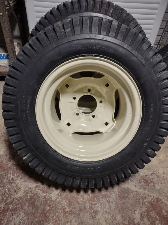

Achto 32,891 #142 Posted March 16, 2022 Mounted the tires on the rims today. Normally I would mount a set of brand new tires on my resto's. This one on the other hand will be getting a set of 55yr old original Wheel Horse tires. They are not perfect but they are in good condition for their age. 7 6 1 Share this post Link to post Share on other sites

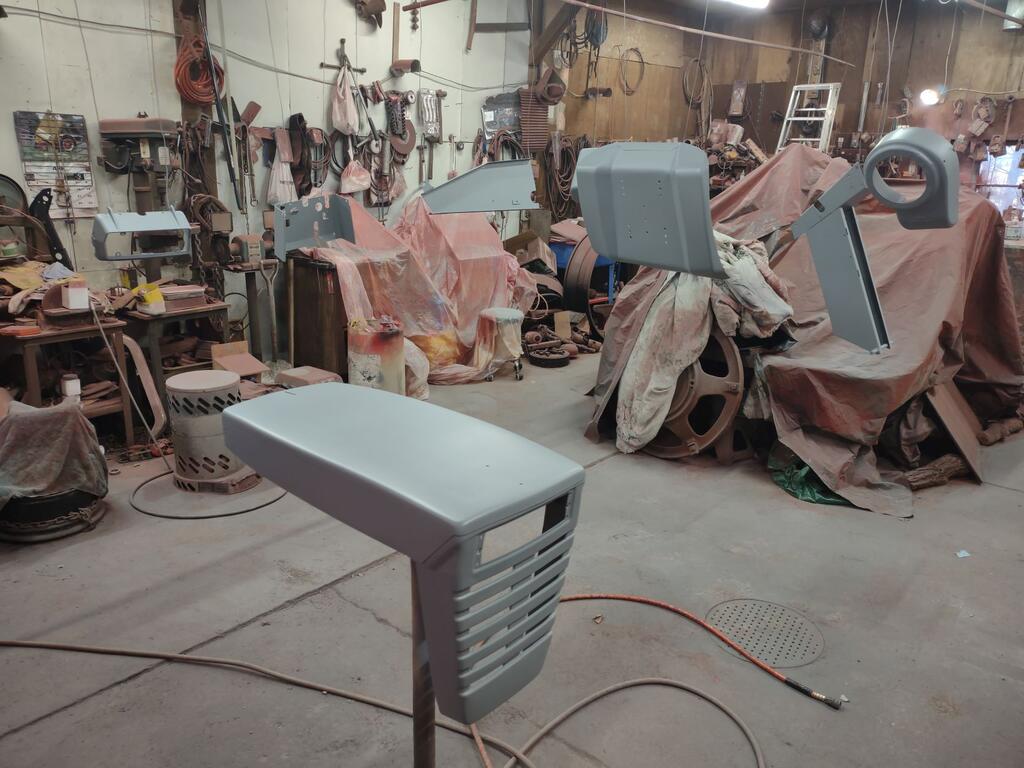

Achto 32,891 #145 Posted March 17, 2022 (edited) Twas a nice warm day today, warm enough that I wouldn't have to heat the shop up in order to spray. I took advantage of this and sprayed primer on my sheet metal parts after I was done with work. 3 coats of urethane primer should provide enough filler to sand out any imperfections that may be left in the sheet metal. Edited March 17, 2022 by Achto 5 7 Share this post Link to post Share on other sites
