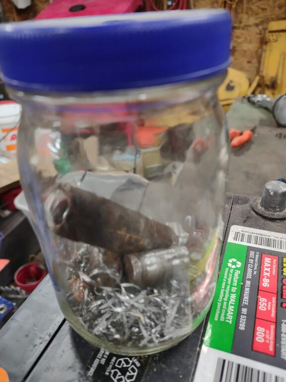

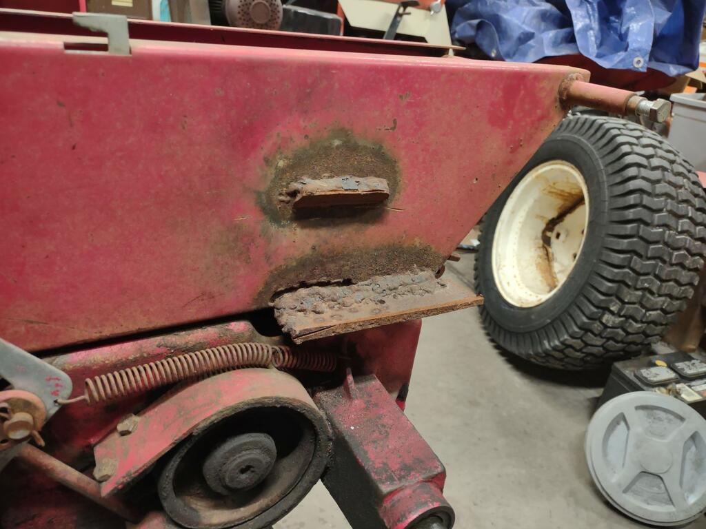

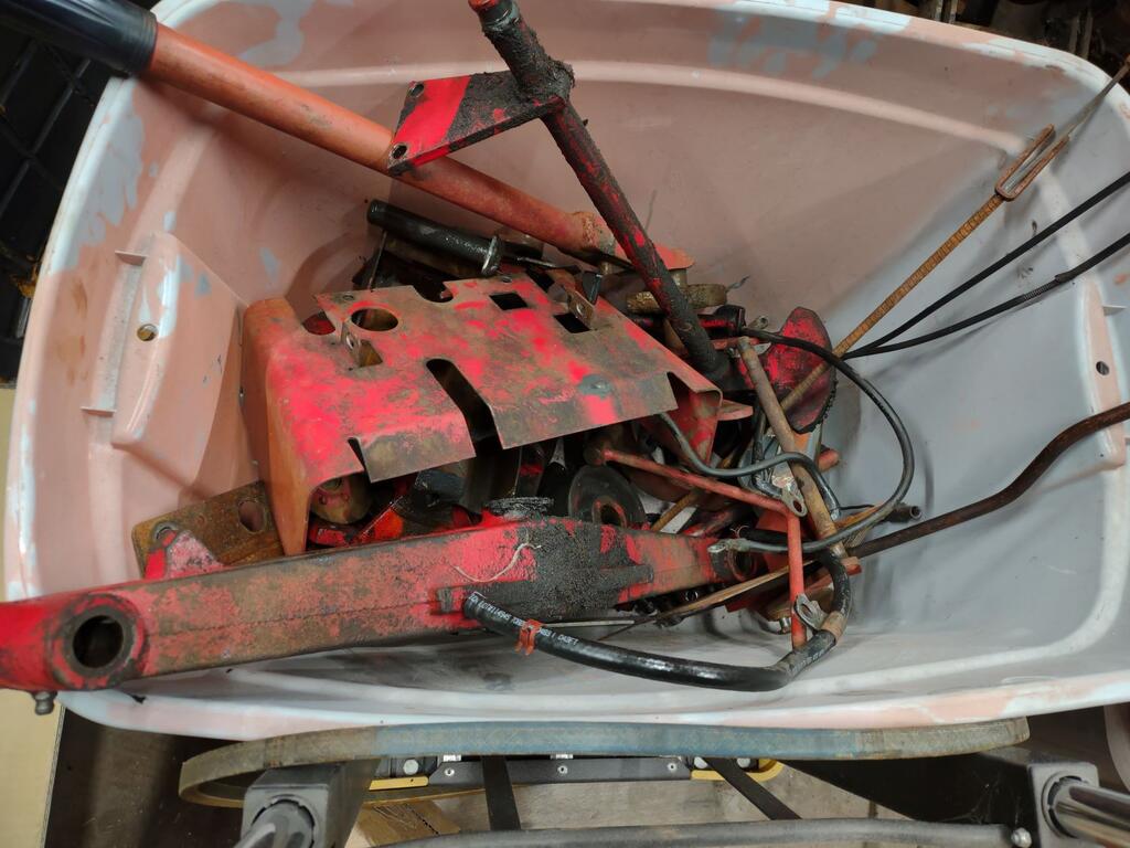

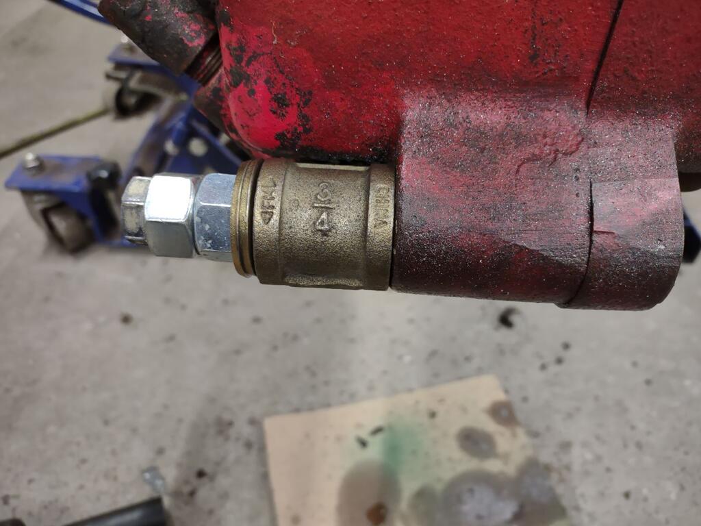

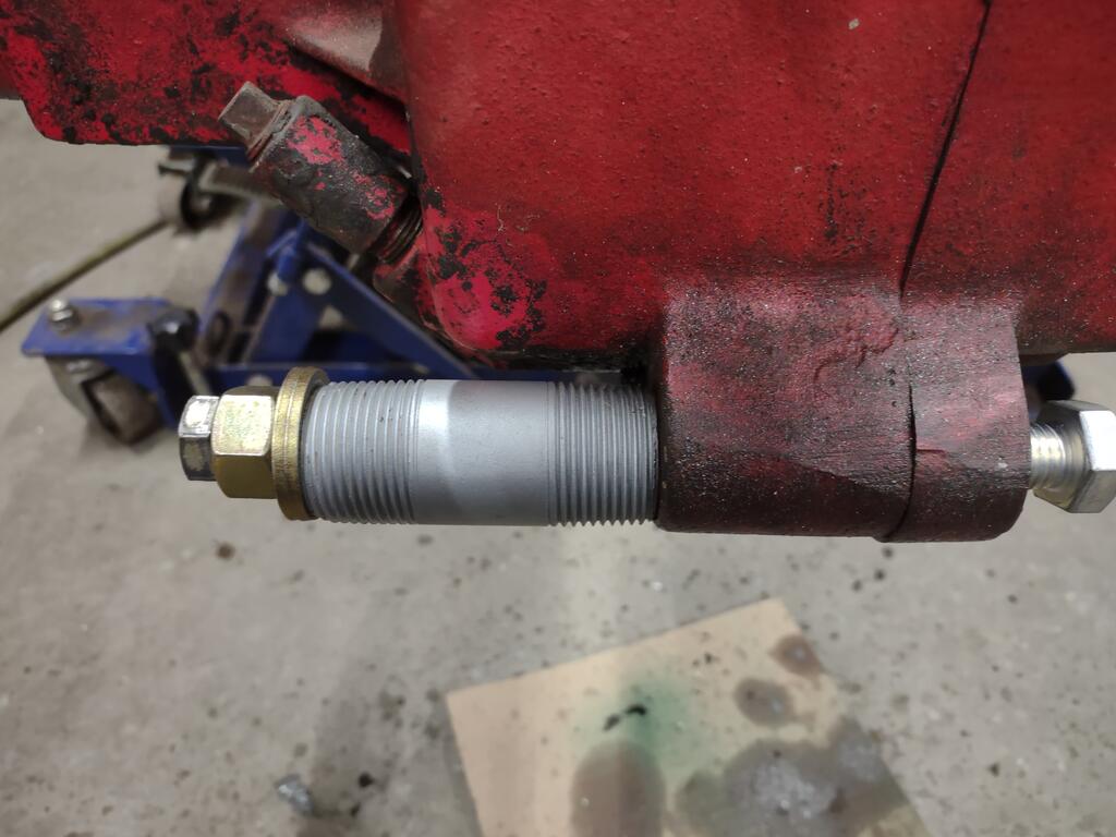

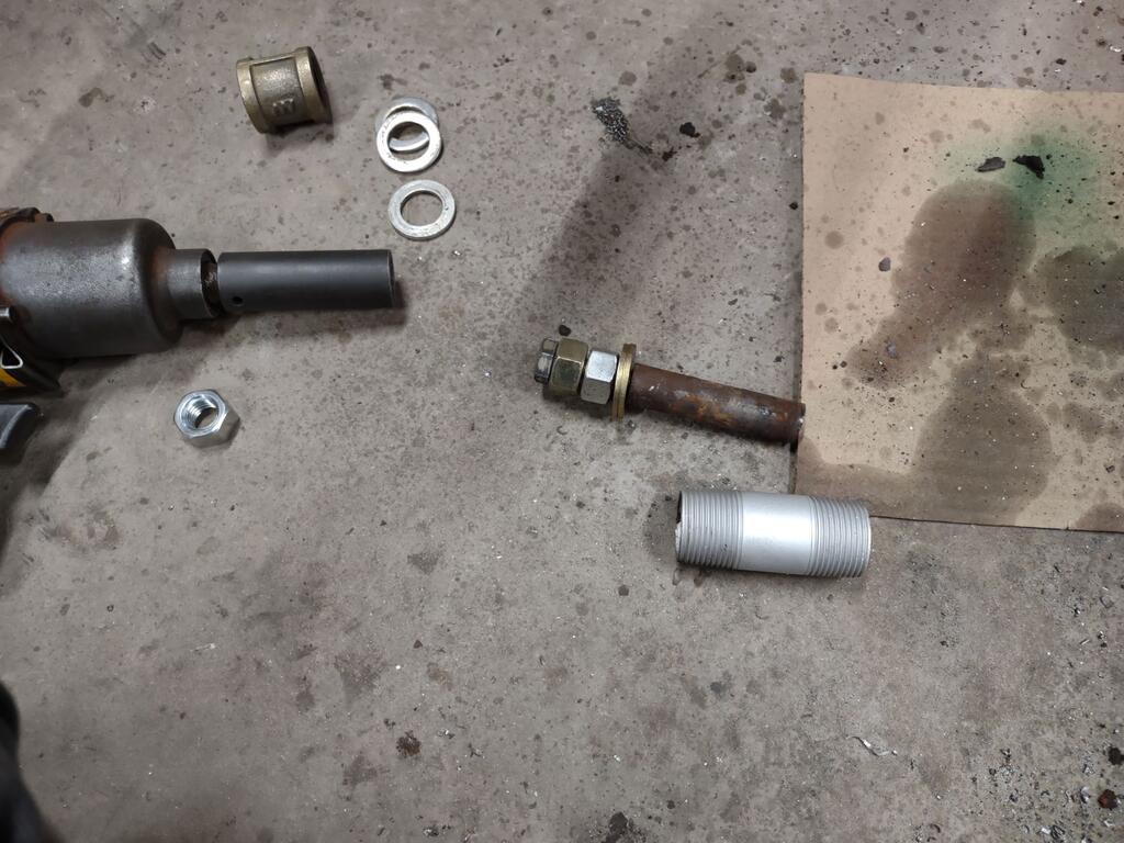

Achto 32,890 #1 Posted February 13, 2022 (edited) Started on this years winter project. Thought that some of you might like to come along for the ride. I'll start with some ground zero pictures. Ain't that seat purty? I knew that the hitch pin on this tractor was going to be big a challenge. It was brown welded like nobodies business. This is where I decided to start my adventure. First I used a Sawzall to cut the pin on each side to remove the hitch. Then I drilled a hole into the pin and tapped it to 1/2" 13 threads. With internal threads in the pin I was able to use a make shift puller to draw the pin out. Tighten the bolt, hit the pin with a drift on the opposite side, get another 1/4 turn on the bolt, hit with a hammer, repeat..... More progress. Closer. And finally a WIN!! This took up my first 2.5hrs of the day. Edited February 13, 2022 by Achto 8 14 1 Share this post Link to post Share on other sites
Achto 32,890 #2 Posted February 13, 2022 We all know how upset @WHX?? gets about people drilling holes in 50+ year old metal. To make him feel better I saved the drill shavings and the old hitch pin for him. 22 Share this post Link to post Share on other sites

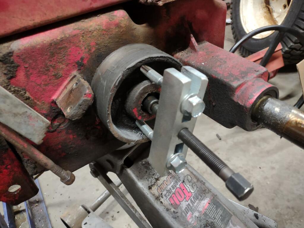

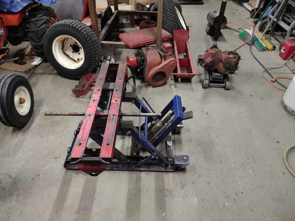

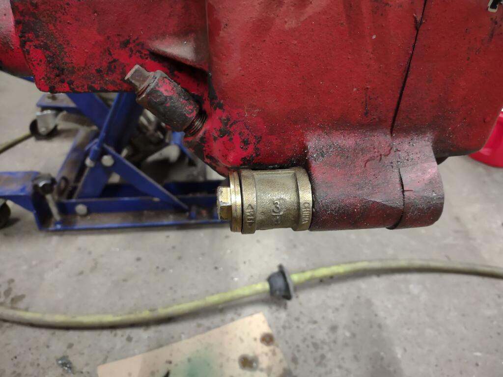

Achto 32,890 #4 Posted February 13, 2022 (edited) With the pin removed from the tranny I was finally able to move on. When I went to pull this tractor out of storage the rear end was locked up. A little time with a heater pointed at it and it was able to move, Wonder if this had any thing to do with it?? Not sure why this was not done at the factory. I drilled & tapped two holes in the brake hub so that a puller could be used to remove it. I did the same thing for the pulley on the input shaft. Found some PO um "customizing" to clean up. After a few trials and tribulations, I was still able to get the tractor broken down by the end of my day. Here's a familiar pitch. "Ran when parked" Edited February 13, 2022 by Achto 7 6 7 1 Share this post Link to post Share on other sites
