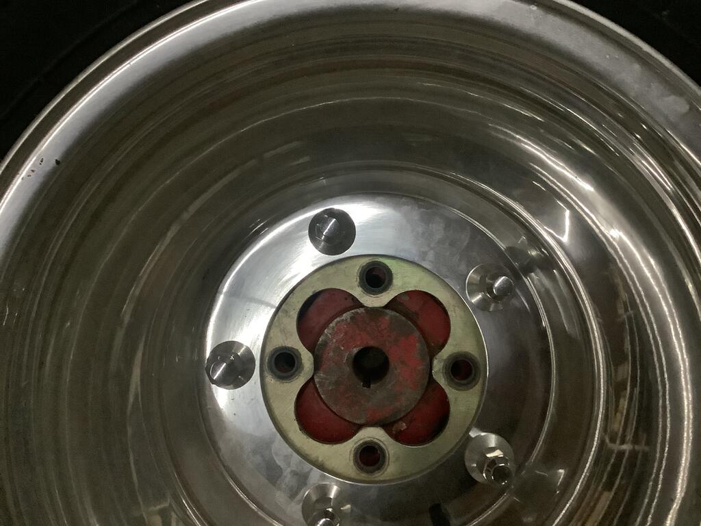

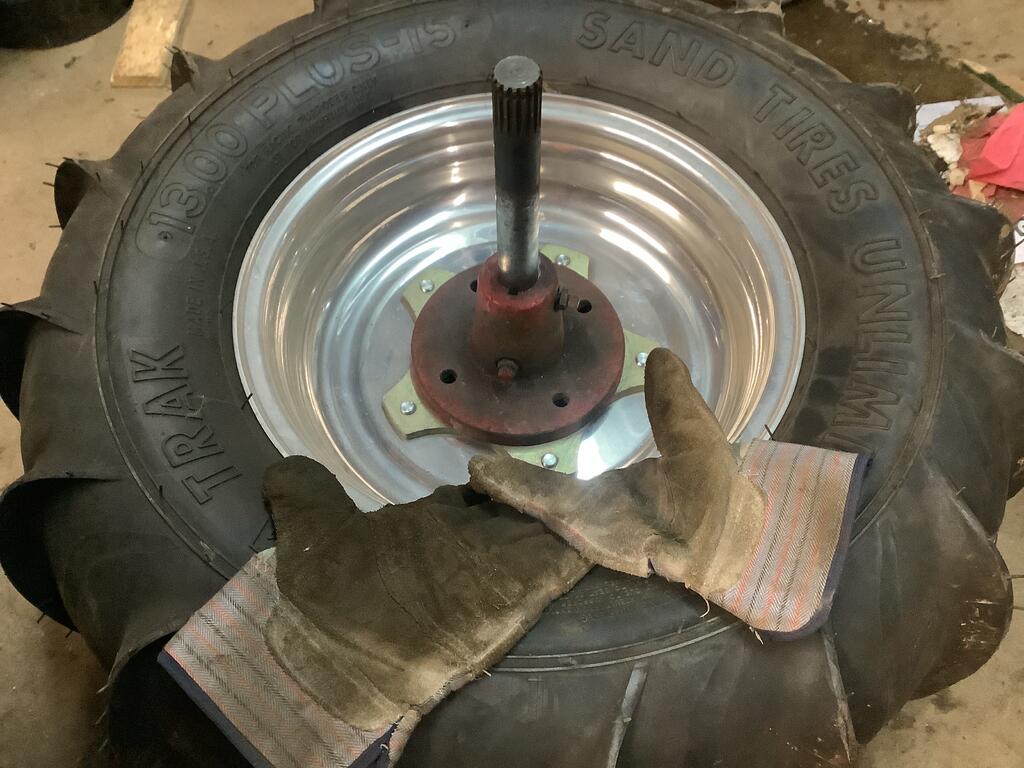

I have a collection of 953/1954/GT14 hubs growing it seems.  The hub center needs to be turned down, but eyeballing the holes tells me this might work very well!

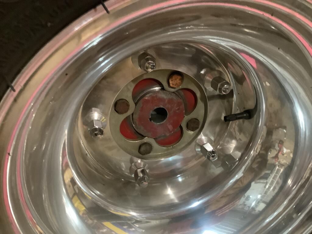

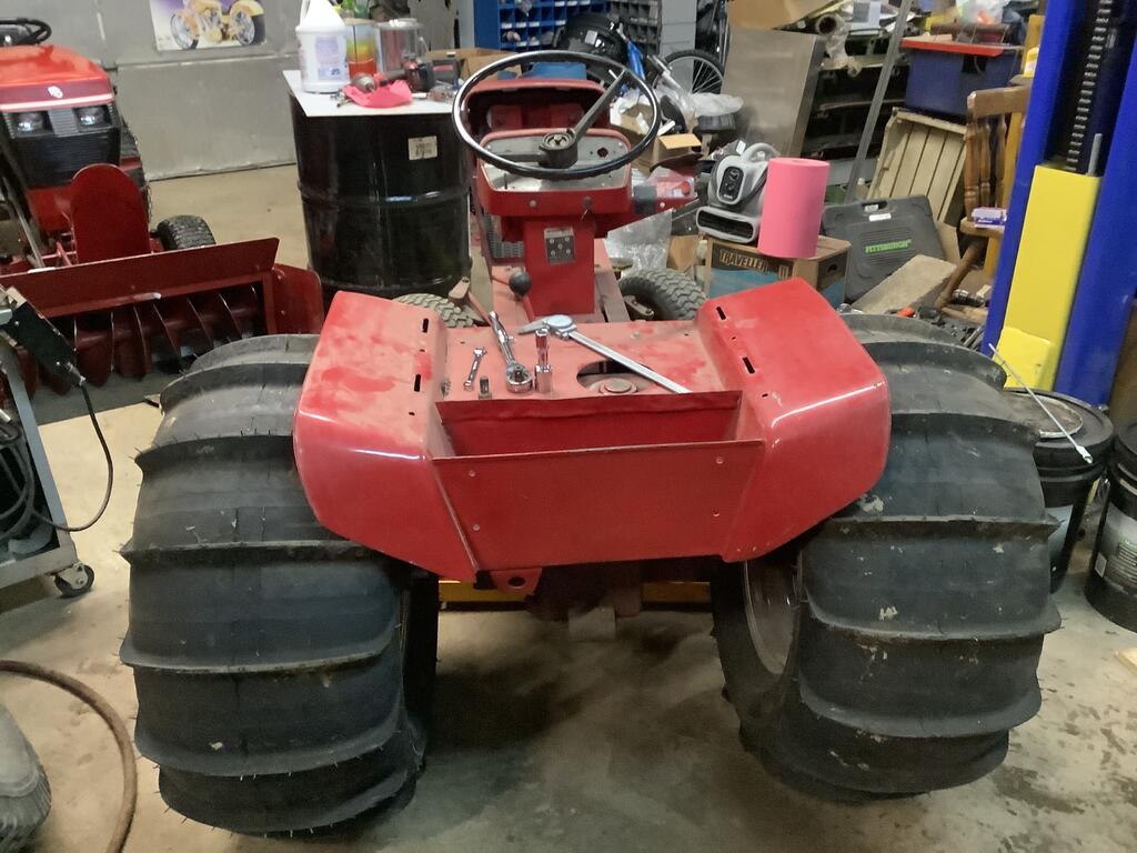

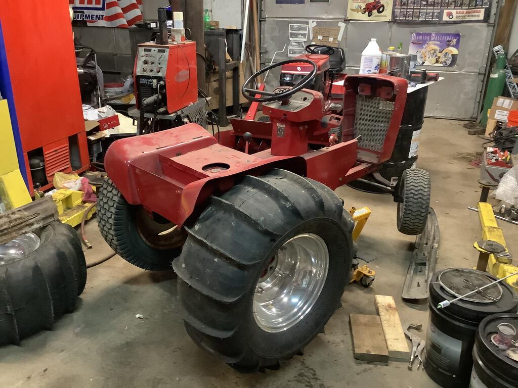

One hub turned, wheel adapter reamed, everything mounted and it clears!
  • Excellent 4

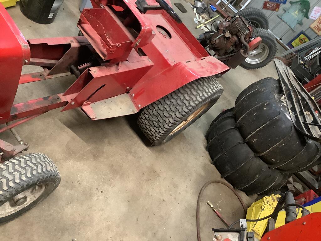

It’s good to have options…
That hot rod steering wheel in the third picture would look good on your build.  Any pictures of the hub adapter for it?
It’s quite hacked.  The hub is an aluminum slug, the wheel is screwed on with what look like a handful of self tappers, it’s bad.

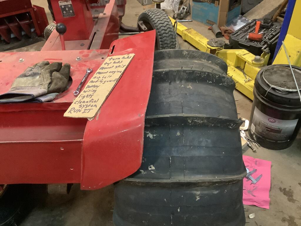

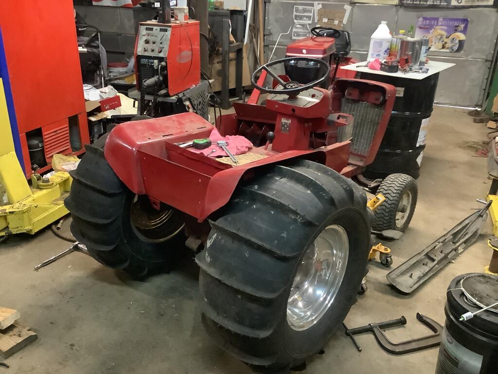

We’re officially off the jack!  I’d like to replace the lug bolts with grade 8 standard bolts and washers, along with backer nuts behind the hubs.
Official width is 49-1/4”!
