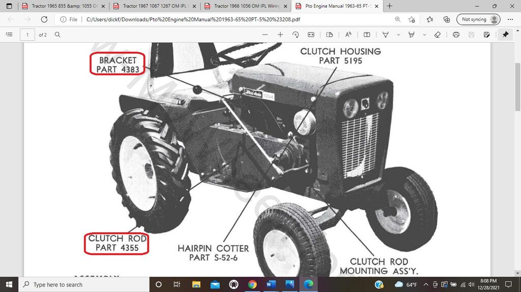

953 nut 69,159 #4 Posted December 29, 2021 The PTO on the 953 and 1054 are unique to these two models only. If you have one the best bet is to rebuild what you have. Looks like all you need is the clutch rod and bracket and they are common to most Wheel Horse models from 1964 to 1972. Place a Wanted ad with the picture below and someone will be able to help you out. Be sure to mention that this is the same rod and bracket found on many models and not just the 1054. Click on this link to place your ad, https://www.wheelhorseforum.com/classifieds/wanted/?do=form&d=2 1 1 1 Share this post Link to post Share on other sites

Pullstart 71,215 #7 Posted December 29, 2021 I do believe I have some spares, as long as @953 nut is correct which I believe… I just parted a couple mid-late 60’s machines with this style PTO. 1 Share this post Link to post Share on other sites
Tinman1962 15 #8 Posted January 12, 2022 On 12/28/2021 at 7:15 PM, 953 nut said: The PTO on the 953 and 1054 are unique to these two models only. If you have one the best bet is to rebuild what you have. Looks like all you need is the clutch rod and bracket and they are common to most Wheel Horse models from 1964 to 1972. Place a Wanted ad with the picture below and someone will be able to help you out. Be sure to mention that this is the same rod and bracket found on many models and not just the 1054. Click on this link to place your ad, https://www.wheelhorseforum.com/classifieds/wanted/?do=form&d=2 Very very helpful thank you all 1 Share this post Link to post Share on other sites
