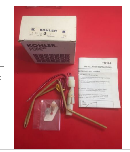

Now that I've got my foot in the door with all you :wh: heads, I've look high and low an I can't seem to be able to fine an oil switch, so if anyone can help me I'll dance at your next wedding!

@ebinmaine you might be, or if your not i know you can point me in the in the right direction to find and oil switch for my tractor. Some dummy yanked the wires out of it when they was cleaning it up, when i find that dummy ima whip um! :scared-shocked:

Someone correct me if I am wrong. Part # KH10138 float switch is NLA through Toro.

You have made a neglected old nag into a prize thoroughbred!         :text-coolphotos:       I doubt that you are likely to neglect your oil level so wouldn't loose any sleep over the oil sentry switch.   I had a couple of them for sale a few years back but they sold out. You could probably find a NOS switch on :techie-ebay: for $ 50.00 or more, that is what I was selling them for.

@953 nut No i will not be neglecting the oil, but i may be wrong here but doesn't the oil switch run the the hour meter?
Í don't know but that can be modified easy enough.

@ebinmaine how di i modify it?

I'm confused, and a little ignorant on the subject of oil switches. Does this K321 have an oil switch?

@953 nut might be the better one to answer that. I'm thinking just run the wire to a place that has power "key on".

Put "Kohler oil switch" into ebay search box, a lot of switches come up. I :confusion-shrug:  if any of them will do you any good.

I just rebuilt an M10 off a 312-8 and decided to not reinstall the oil switch.  Reasoning - it is not needed if you religiously check the oil before each start which I do.  Installation is tricky and if done wrong can cause interferrence and engine damage.  There is no connection between the oil switch and the hour meter.
@Gregor i know mine does, at the back side down at the bottom
@biged77 By no means am I saying you are wrong, but my meter was working until i messed the wires to the oil switch up. Maybe it is a complete coincides that much i really dont know, i just got to get it back working and im down for any advice or help. Thank you @biged77 i love this place, i fill like i knew everyone before i ever talked to any of you!

I have (1) K341, (3) K321, (1) K301, (2) K181, (1) K161, (1) MV16, and have never seen an oil cut out switch. Whooda thunk?

@Gregor im pretty sure that is a oil switch, blue with 2 white wires coming out of it? Screwed in the the bottom side facing the steering wheel.

861992792_Screenshot2021-11-29at11-55-47GENUINEKOHLEROILSENTRYFLOATSWITCH25-704-0103FITSM8-M16MOTORSNEW-B62eBay.png.91539d535dcc5e15790960a9f675424d.png
I am sure it is. I will run across one some day.

@Gregor so why do you think my meter stoped working, i thought it was because of the oil switch because i saw a right up about a guy having the same situation and he was told it was because his oil switch was bad?
