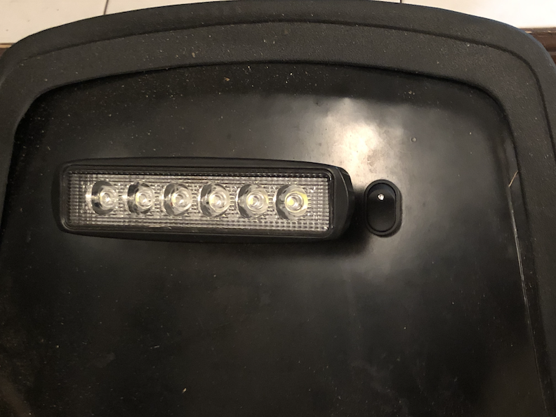

Wiring harness for the rear lights.  Still need to put the connectors on the two wires.
You can really see the rust craters on the bottom!  Thankfully the top is not nearly as bad as this!
The 'money shot':
@Snoopy11 Don, here they are lit up. Each tail light draws about 50 milliamps.  The backup lamp draws about 400 milliamps.
With the lights in the shop off, looks like some evil "Transformer" !
Oh yeah, and the toggle switch for the BU lamp IS in fact too tall.  I've decided to cut the toggle handle down rather than relocate it, or drill a hole for clearance in the seat bracket.  I'll still be able to work it, but with a little more effort is all.  Not a problem, arthritis ain't that bad yet!

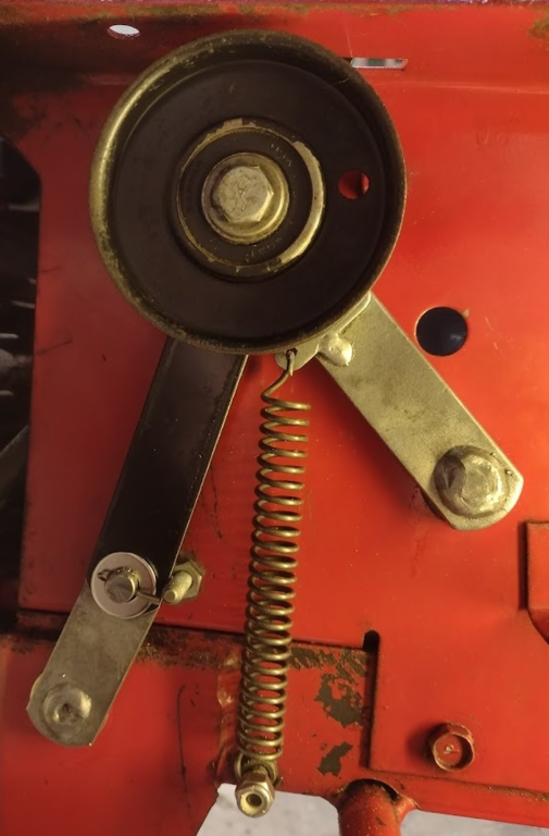

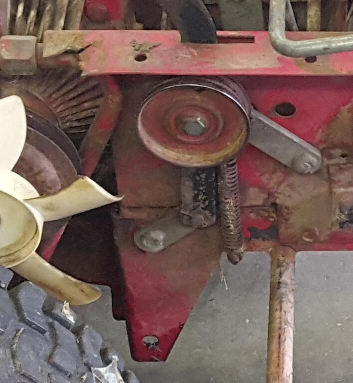

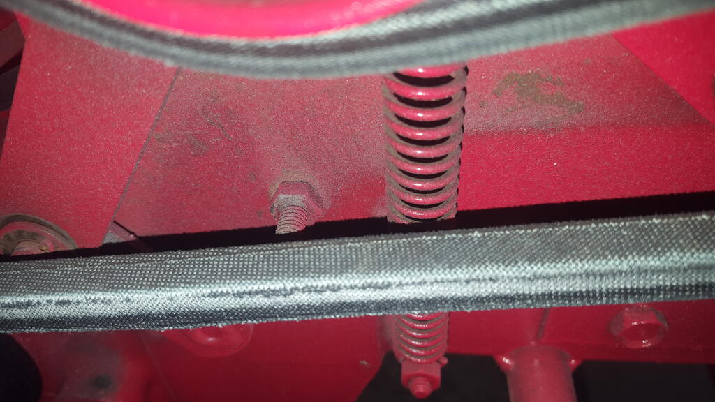

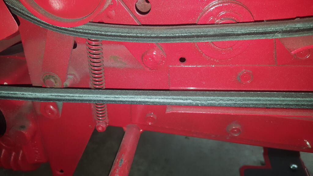

Here is the linkage from my 141 compared to your 175. Mine has a lot more bend in it. My 175 is pretty buried, or I would take a pic of it.20201031_071449.jpg.be52427e3280024d077a0eeddd47ac2c.jpg1316712229_jeef175.png.e5726ae175bda70f7d82dd122dec8f62.png
Jeff-C175
Thanks Greg.  That pic is actually my 'new to me' 125 that I'm getting ready for plow duty.
I haven't taken the cover off the 175 to see what the difference is, but yeah, that's pretty extreme on your machine!
Is the 'stop bolt' missing perhaps?  That's another though... take the bolt out completely as long as it doesn't cause other issues.

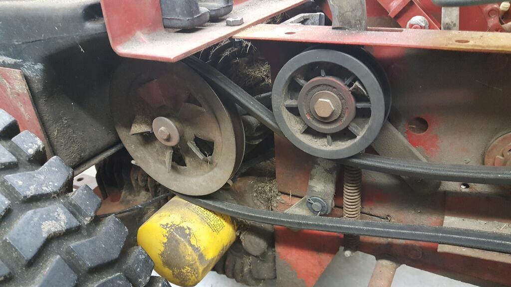

Is your pulley 'self destructing' ?  Is it plastic?
Edited by Jeff-C175
Gregor
Never thought to look at pics from my 125. I don't think I have a stop bolt. I'll have to investigate further.1613853159_20210503_112304(2).jpg.b78c7eb170555042d484bfc856779b87.jpg
Gregor
I think that is actually just caked dirt falling out. These pics were taken during tear down.

Curiosity got to me. It always does. I dug the 125 out and brought it up to the garage. Mine does not have a stop bolt, but there is a hole. I stuck a 1/4" rod in it for a second, the lever would not begin to stay up when pulled. When the lever is pulled, there is no tension on the belt, the tractor is on suppose to be moving. I can't see a problem with omitting the bolt, even though the parts book shows it there.
I decided that fender mount was an invitation to damage and didn't give high & wide illumination over a rear-mounted implement. Since the soft rubber seat cover comes off easily and there was a gap in the foam at this position, I mounted the light high up on the seat shell. Inside I ground off the screws flush with the nuts. Switch is low profile--less than ¼" inside the seat with side-connected terminals. With the deep foam, the nuts and wires are undetectable to a seated operator.
I wired a pair of 2-conductor connectors to the headlight circuit under the fender--one for the taillights and one for this back light--so that it goes together easily.
Like you, Jeff, I ran direct grounds (I added a wired ground from the front to the rear and used that for the lights, the transaxle temperature sensor, and the fuel sensor.)

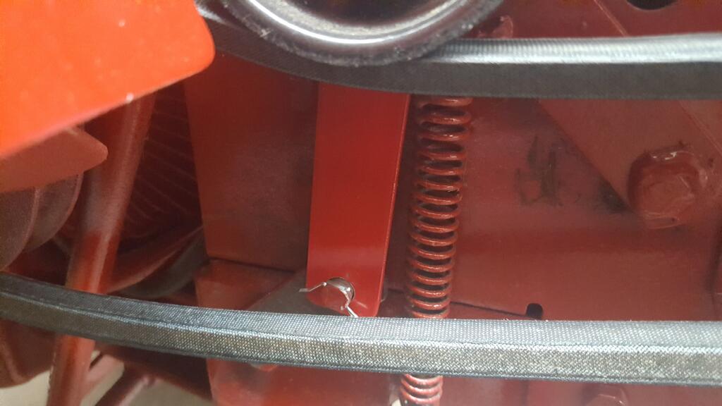

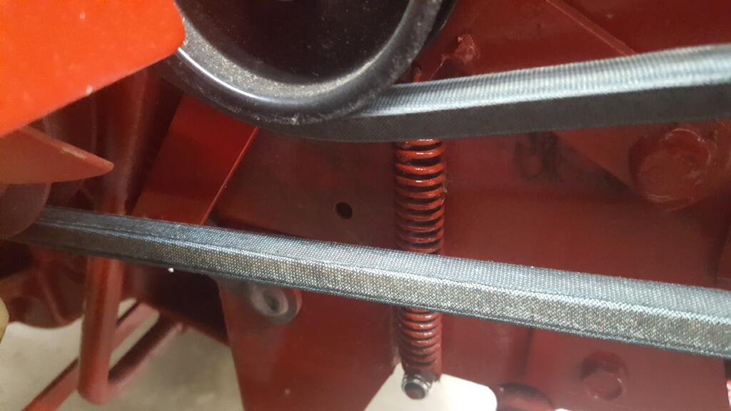

Greg, I don't understand what you wrote.
Did you mean to say "the tractor is NOT SUPPOSED to be moving"?
Now I have to drop the cover on my 175 because it travels just fine with the clutch pulled up.  I've accidentally mowed the entire yard with the clutch pulled up, and the belt wasn't burnt!
Seems to me that when the clutch goes "over center" the idler starts back down putting tension back on the belt again.

I have a suspicion that removing the stop bolt lets the tension back onto the belt.
Tomorrow I'm pulling the cover on my 175.

The belt on my 125 is quite lose with the lever up, and no stop bolt.

Just noticed something.  The lever 'stop' becomes the slot in the chassis with the bolt missing.  No big deal I'm sure,  just noticed it looking at the pics and pondering.
Whereas on mine with the bolt, the lever stops a good half inch or a little more from the end of the slot.  (pic is a little dark so I added the yaller arrows)
I hope to get to the 175 tomorrow (oops!  that's TODAY now! ) to see what's going on with that.

I brought my 175 up to the garage. It has a Sundstrand. Notice there isn't much angle in the links with the lever up, but it does stay up.20211201_144700.jpg.836000d64fd483ba599dfb2faeb2ca49.jpg
The stop bolt is still in this tractor. Lever up or down doesn't matter. Unless you open the tow valve, it's almost impossible to push, and it's almost impossible to get a wrench on that tow valve.
Thanks Greg.  I see the stop bolt is there.
