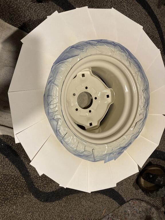

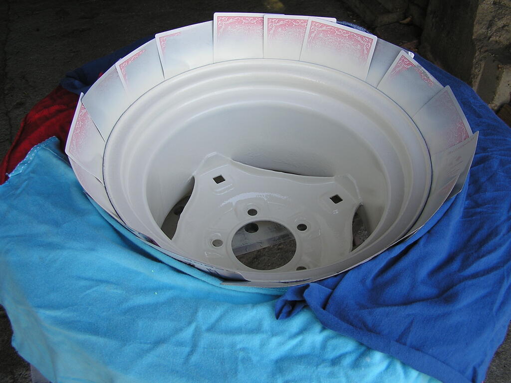

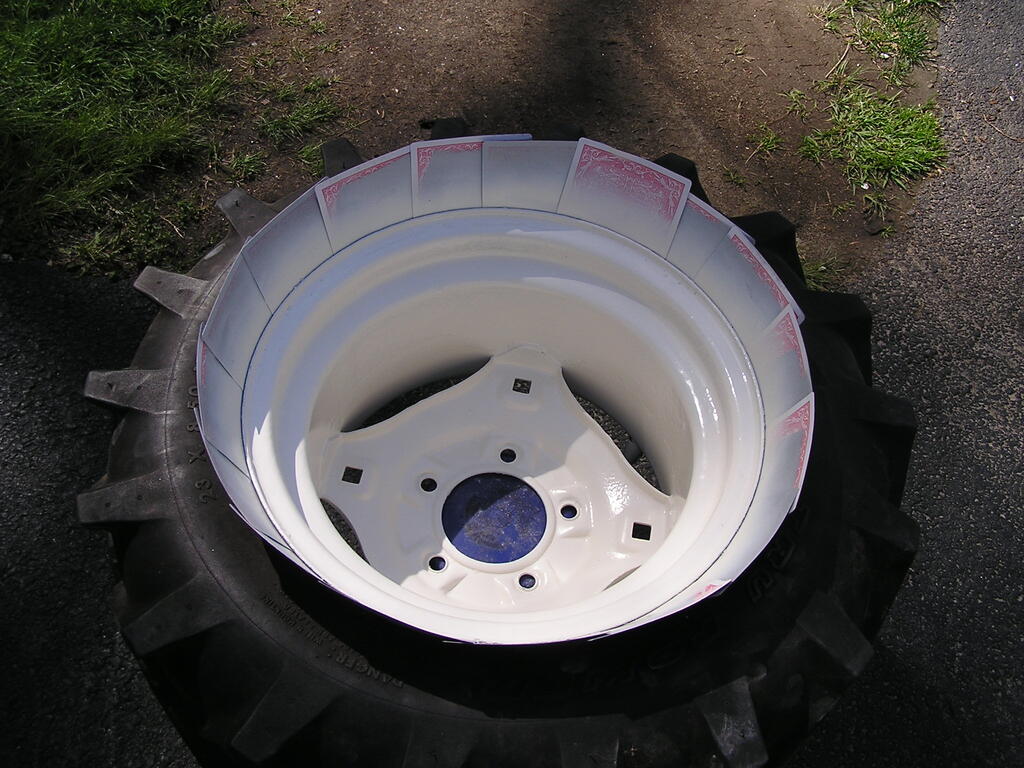

EB-80/8inPA 2,133 #3 Posted July 9 (edited) I had a set of rusty old wheels I picked up a while back that need pressed into service now that I need to re-shoe the B-80. Decided to prep, paint, mount them, and then simply swap out the old ones. Although I do have a wire brush attachment that fits the weed wacker (and it does do some really mean grinding work), I opted to get the set of four sandblasted locally for $40 and forego the mess. I’ll use my lazy susan painting thingy to spin and spray them (once the humidity drops). Many here swear by inserting playing cards around the rim after mounting the tires and before a final spray to leave a nice clean finish unmarred by tools. I will be trying that or some similar masking technique. I hope to need nothing other than a set of tire spoons to mount the rims and will install tubes from the get go. Will post pics once done (could be a while but I do anticipate finishing up before @ebinmaine completes his Colossus project). For paint color, all I can say is: Good luck and have fun! Edited July 9 by EB-80/8inPA 4 Share this post Link to post Share on other sites
Ed Kennell 47,878 #4 Posted July 9 1 hour ago, EB-80/8inPA said: Many here swear by inserting playing cards around the rim The playng cards work for me. 2 Share this post Link to post Share on other sites

ri702bill 13,357 #6 Posted July 9 For any really really rusted surfaces - that are thick enough to withstand the process - I highly recommend using a needle scaler. Works great on WH rims and the outer side of truck brake drums. A bonus - it leaves a mildly rough clean surface that cleans up with acetone and provides great adhesion for the primer. Mount the tire after prep but before any painting. Yes, the plastic coated playing cards work great. 1 2 Share this post Link to post Share on other sites

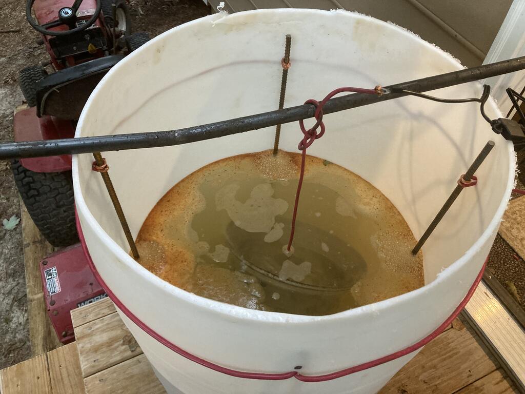

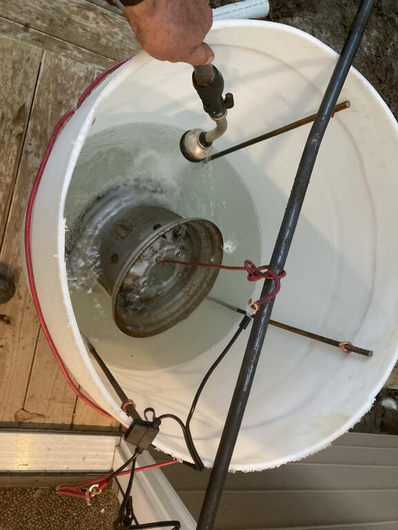

ineedanother 2,885 #23 Posted July 9 I prefer an e-tank over all of the others because those remove viable steel while a tank does not. You have to be a patient person to go this route though... 3 Share this post Link to post Share on other sites
Handy Don 17,721 #24 Posted July 9 17 minutes ago, ineedanother said: You have to be a patient person to go this route though.. Also need a big pail and care to position the electrodes so they can “see” the places on the parts needing de-rusting. I’ve got and use an etank for a lot of smaller parts. 1 Share this post Link to post Share on other sites
ineedanother 2,885 #25 Posted July 9 1 minute ago, Handy Don said: Also need a big pail and care to position the electrodes so they can “see” the places on the parts needing de-rusting. I’ve got and use an etank for a lot of smaller parts. Yep. I use a 55 gallon "e-drum." Share this post Link to post Share on other sites
