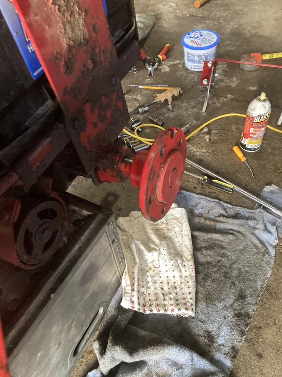

SylvanLakeWH 32,722 #78 Posted March 17, 2022 Success! Old axle seal popped right out and new one went right on smooth… so far no leaks… I did not use the patented @WHX?? /@Achto Wisconsin cheese curd axle seal extraction / insertion technique, so that might be why it went smoothly…? Thanks @ebinmaine, as usual your advice was spot on… 2 Share this post Link to post Share on other sites
ebinmaine 80,999 #79 Posted March 17, 2022 I really can't take credit. Just things I've learned (mostly) from this site and others. Happy to be able to help... 3 Share this post Link to post Share on other sites

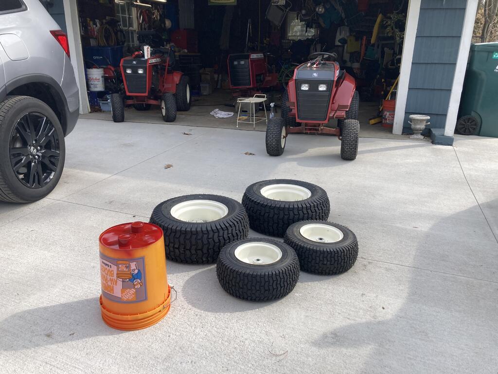

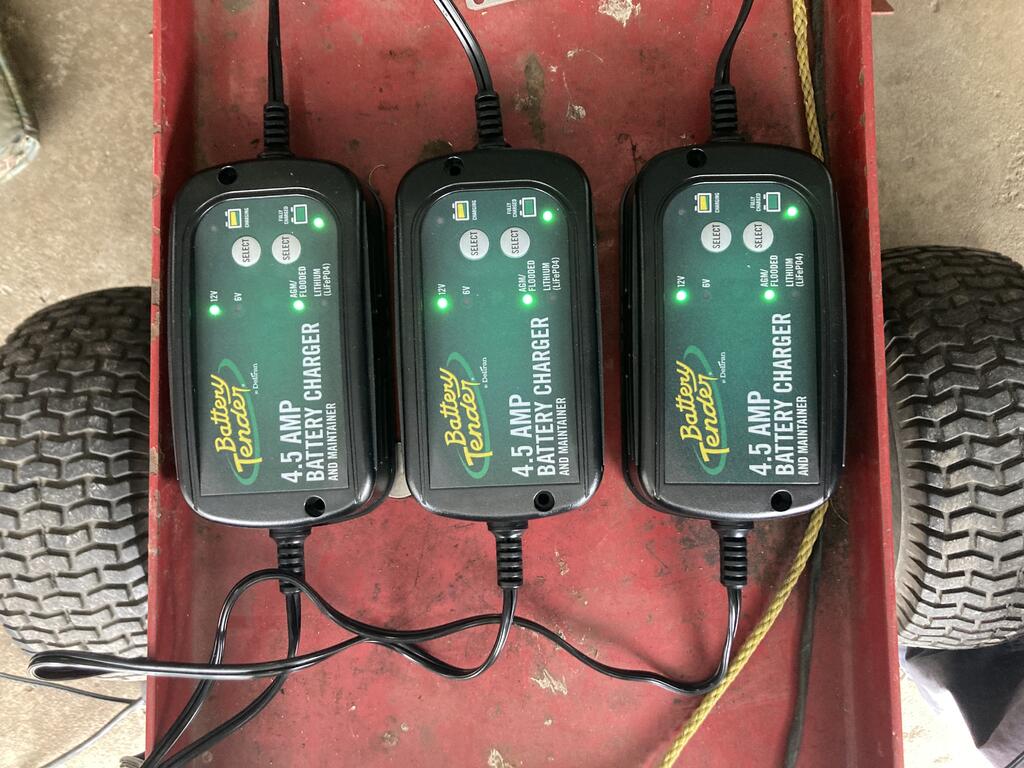

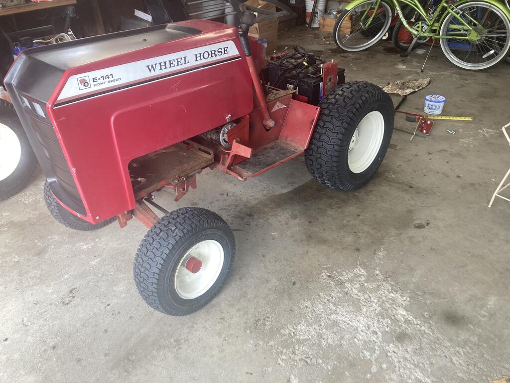

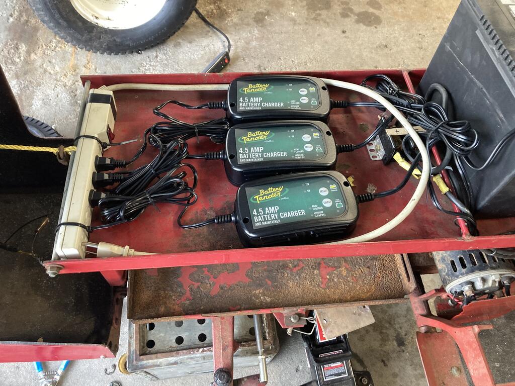

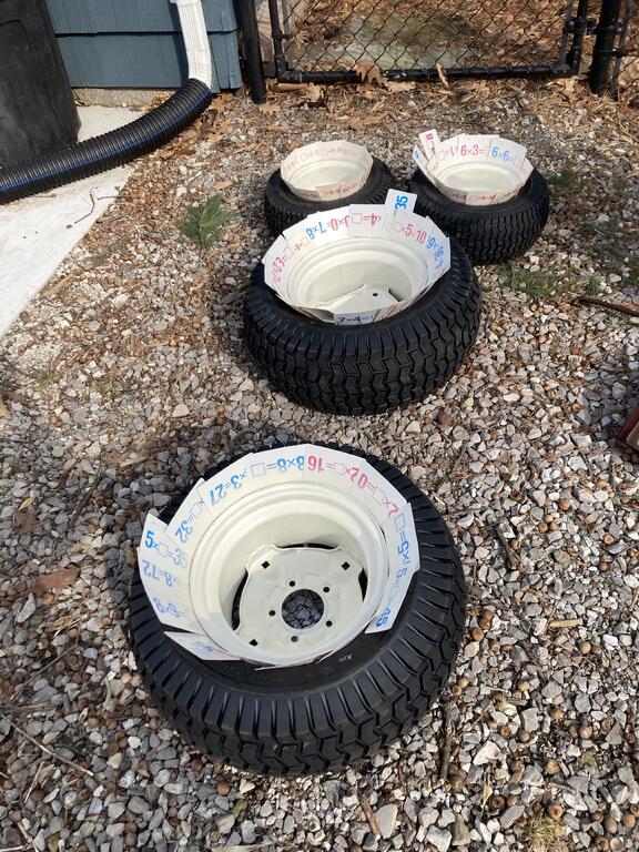

SylvanLakeWH 32,722 #80 Posted March 18, 2022 (edited) Lots of progress today… Snaked all the wires for the chargers. Zip ties for cords… Things fit pretty good… Painted wheels - Rustoleum Canvas White. Hubs and front caps - Regal Red. Finally found a use for math flash cards… I hate math so painting over the equations was quite therapeutic… Did the full @peter lena and lubed everything with Lucas Red… Getting there… Edited March 21, 2022 by SylvanLakeWH 5 Share this post Link to post Share on other sites
ebinmaine 80,999 #81 Posted March 18, 2022 Excellent work Sir 👍 Something nice about fresh wheels. 4 minutes ago, SylvanLakeWH said: I hate math so painting over the equations was quite therapeutic 1 1 Share this post Link to post Share on other sites
WHX?? 58,308 #82 Posted March 18, 2022 Looks like decent weather there too. Way too cold to paint here. Amazing the things get done with nice weather. 2 Share this post Link to post Share on other sites
peter lena 10,095 #83 Posted March 19, 2022 @SylvanLakeWH glad for you on your progress , been using battery tenders for years , have mine weird in so its an easy plug in. have the wire on my choke cable, so its an easy / quick plug in . glad you are using the lucas red . its good stuff , and stays with the trouble / wear spot. did my wheels years ago using , NAVAJO WHITE . bout time for a fresh coat . thanks for the update , pete 2 Share this post Link to post Share on other sites

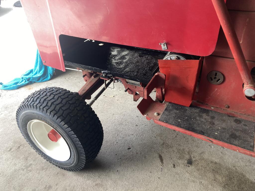

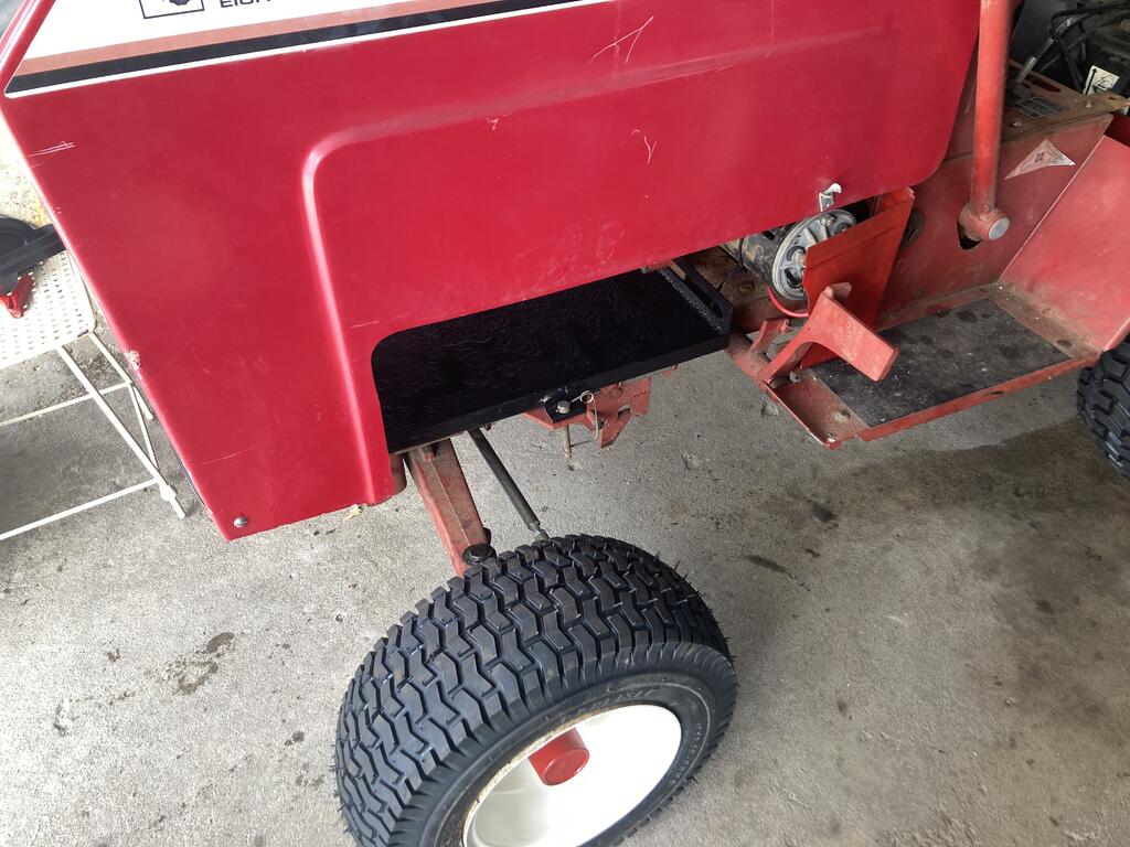

SylvanLakeWH 32,722 #84 Posted March 21, 2022 Painted the lower battery tray on the E-141. Badly pitted from rust / acid. Just laid on the primer and paint to get it sealed. Not going trailer queen - this one’s going to work pulling the SL&WHN train… Since I plan to only run 3 batteries for movement, this battery tray will be available for another use. Thinking tool box, weights and/or one dedicated 12 v battery isolated and used solely for lights, train whistle/horn/bell… not sure yet… 2 1 Share this post Link to post Share on other sites

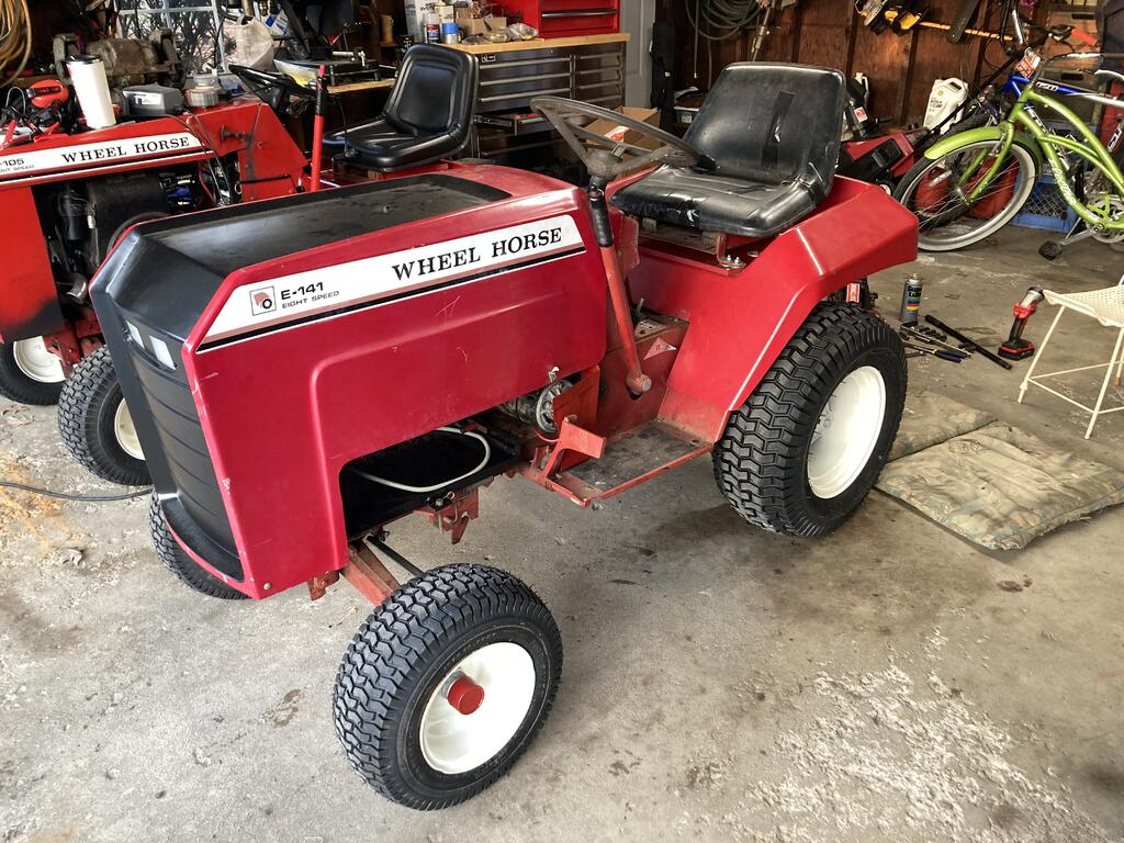

SylvanLakeWH 32,722 #86 Posted March 21, 2022 Got my shift cover from Lowell - wheelhorsepartsandmore - yeah!!! Put it on, mounted the fender / seat, and started wearing those nubbies off the new tires!!! Ran great!!! Lots of little things to tidy up but I am very pleased with how it runs. Very smooth and quiet. IMG_1405.MOV 2 4 Share this post Link to post Share on other sites

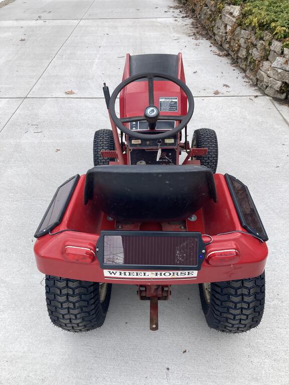

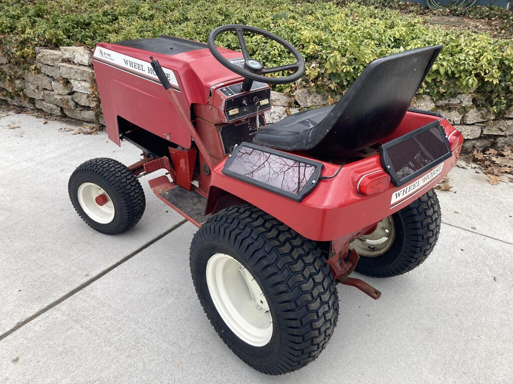

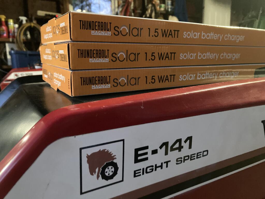

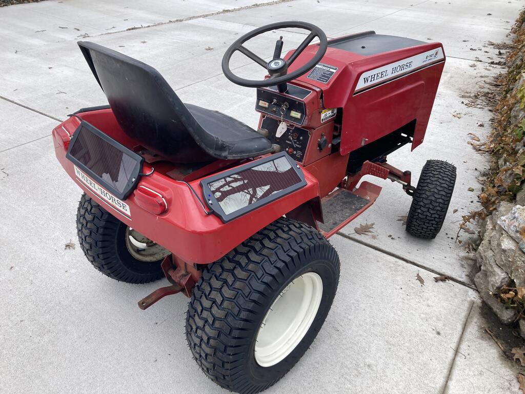

SylvanLakeWH 32,722 #87 Posted March 29, 2022 (edited) Been toying with solar panel options. Decided to go trickle charge for space reasons… one per battery. Three on fender pan… quick connect to each battery. Picked up at Harbor Freight today. I used these for years on my boat and they do the job as far as trickle chargers go… Looks like the SL&WHN RR has a new locomotive - The Solar Express… Gotta get with @Vinylguy about some graphics for the side of the Black Hood. Edited April 13, 2022 by SylvanLakeWH 5 1 Share this post Link to post Share on other sites

SylvanLakeWH 32,722 #92 Posted April 3, 2022 Solar panels mounted, hooked up and tested. One per battery. They work!!! Also put a pin in the hood to hold the hood down. Works perfect. 8 3 Share this post Link to post Share on other sites
Pullstart 71,413 #93 Posted April 6, 2022 How long would it take at 1.5 watts to recover from a train ride around the ‘hood with your family loaded up? 2 Share this post Link to post Share on other sites
SylvanLakeWH 32,722 #94 Posted April 6, 2022 6 minutes ago, Pullstart said: How long would it take at 1.5 watts to recover from a train ride around the ‘hood with your family loaded up? A long time… 1.5 watts = .125 amp chargers… These are what I keep it hooked up to in the garage. They take a couple hours to charge back up after I’ve cruised around… I put the small solars on primarily to educate the kids who ride the train and to learn for myself. Show them how batteries are charged, wired, pros / cons of gas vs batteries… I’m looking at larger panels (100+ watt) that would actually produce about twice the amps as my 120 v tenders do now… thinking solar canopy over the tractor and main passenger car… we’ll see… 4 1 Share this post Link to post Share on other sites

SylvanLakeWH 32,722 #97 Posted April 6, 2022 1 minute ago, ebinmaine said: Interesting idea 💡 🌞 Thanks but not original. As @Pullstart notes, there are pics on here of one with a solar canopy… my thinking is to extend to include trailer(s)… we’ll see. Wiring etc becomes interesting… 3 Share this post Link to post Share on other sites
Handy Don 17,591 #98 Posted April 6, 2022 2 hours ago, Pullstart said: It’s been done…they cruise the big show quite a bit with it! I spoke to the owner of that "surrey with the panel on top" about range. It is very cool (and also modded into a two-seater like @Achto's newest acquisition). He said the panels give him maybe 15 minutes of low-load driving after four hours of sun. He was seen last year with his buggy plugged in whenever it wasn't in use! Likely newer, more efficient panels would make a difference. 5 Share this post Link to post Share on other sites
ebinmaine 80,999 #99 Posted April 6, 2022 8 minutes ago, Handy Don said: Likely newer, more efficient panels would make a difference. I read a very quick article a few days ago about some sort of newly designed panel that has microscopic hexagons that are not flush to each other at the top face. Because some of them stick up higher or lower than others the upper face can actually reflect on to the sides of the hexagons and vice versa. The efficiency level was stated to be quite High because of the extra reflections. It's not likely this type of technology would be in the hands of general consumers right away because of extreme cost but it shows what things can be done... 3 1 Share this post Link to post Share on other sites
SylvanLakeWH 32,722 #100 Posted April 6, 2022 49 minutes ago, Handy Don said: I spoke to the owner of that "surrey with the panel on top" about range. It is very cool (and also modded into a two-seater like @Achto's newest acquisition). He said the panels give him maybe 15 minutes of low-load driving after four hours of sun. He was seen last year with his buggy plugged in whenever it wasn't in use! Likely newer, more efficient panels would make a difference. And just FYI - I think he has the full load of six 12 v batteries, if I remember the picture correctly. I only run 3 at the moment... 2 Share this post Link to post Share on other sites
