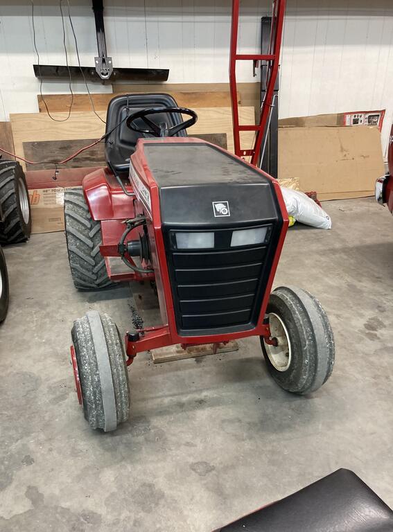

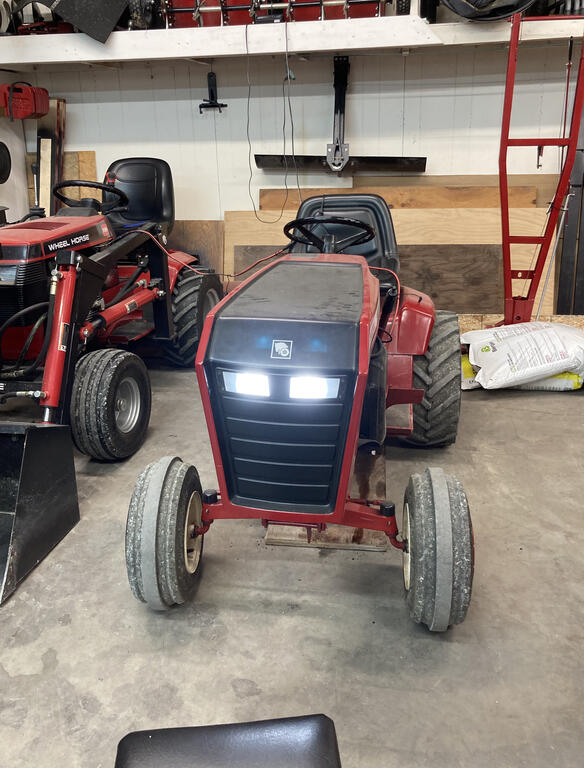

Pullstart 71,413 #12 Posted November 1, 2021 Ok, I’ve gotta ask. Please tell me those headlights are functional!?!?!? The broken lens is trying to trick my mind… is there something behind there other than a hood? Share this post Link to post Share on other sites
SylvanLakeWH 32,722 #13 Posted November 1, 2021 (edited) Yes they work. Cover is broke. Will be looking for replacement. May change bulbs to LED…Maybe the guy who does 3D printing??? @Wheel Horse 3D??? I’ll be posting a lot more pics. The hood covers another tray for 3 more batteries… I’m running it on 3 right now, as that’s how it came… 2 under seat and one under hood… Edited November 2, 2021 by SylvanLakeWH 2 Share this post Link to post Share on other sites

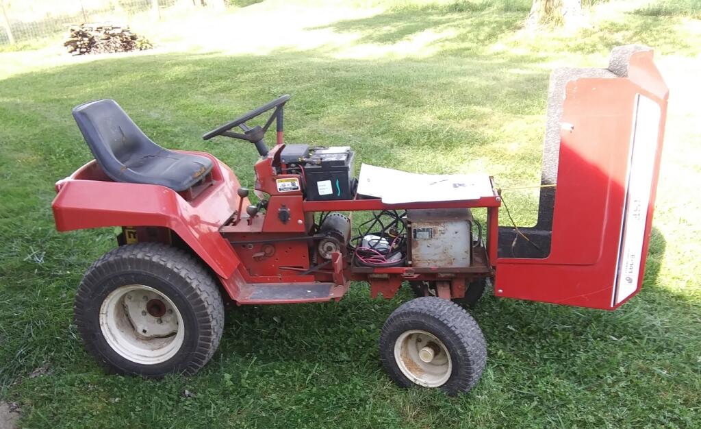

Erv Troyer 16 #14 Posted November 2, 2021 Dave Mercer gave that tractor to me last fall. That tractor spent all summer in my barn, and I spent many hours figuring out the wiring mess, freeing up the motor, attaching the hood, fenders, and seat, making the lights work, etc. I had to do a lot of learning, but I did have all the manuals which was a great help. It did not have a charger, so I added a standard golf cart charger to the setup. See the photo with the hood open. I made several other revisions to make things work. I have several GE Elec-Trak tractors, and mow my lawn with the New Idea version EGT120, so I am familiar with these. However, this Wheel Horse was a totally different design. Basically, they took a C141 gas tractor,and removed the engine and put in an electric motor. When you turn on the key the motor runs at full speed, then you drive it using a clutch pedal and gear shift, same as the gas tractor. It is designed to use 6 12 volt deep-cycle batteries, 2 banks of 3 batteries wired in series, then these banks are connected in parallel at the power disconnect. I'm not sure why Wheel Horse chose that odd system. The Elec-Trak is designed to use six 6V golf cart batteries. Dave will be sending you my contact information, so if you get into some questions you can get in touch with me. Have fun with the tractor. Erv Troyer Lagrange, IN 2 5 4 1 Share this post Link to post Share on other sites

cschannuth 3,821 #16 Posted November 2, 2021 On 11/1/2021 at 8:10 AM, SylvanLakeWH said: Yes they work. Cover is broke. Will be looking for replacement. May change bulbs to LED…Maybe the guy who does 3D printing??? @Wheel Horse 3D??? I’ll be posting a lot more pics. The hood covers another tray for 3 more batteries… I’m running it on 3 right now, as that’s how it came… 2 under seat and one under hood… I have one of the 3-D printed lenses for that style hood and while it doesn’t look exactly like the original I think it looks good on there and it works well. 6 2 2 Share this post Link to post Share on other sites
