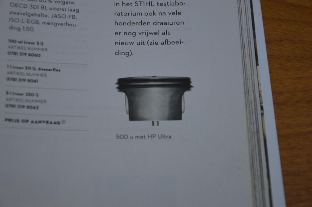

Maxwell-8 4,371 #34 Posted October 27, 2021 3 hours ago, Skipper said: You would think so yes, but I have not seen anything like that at all. The one I use is fully synthetic, and burns clean off. Cant even see it on the plugs. This picture is from the Stihl catalogue. they claim a piston after 500 hours of run time looks when using Stihl 50:1 full synthetic two stroke. I barely see any carbon. quite impressive! Share this post Link to post Share on other sites
