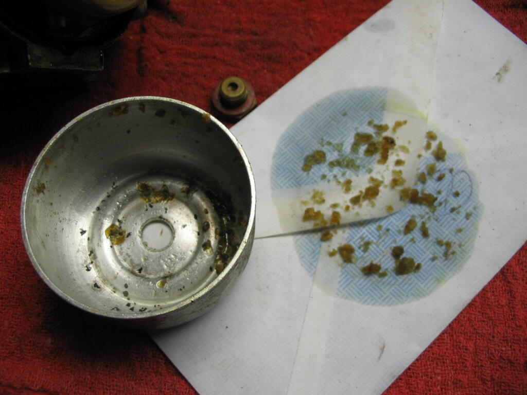

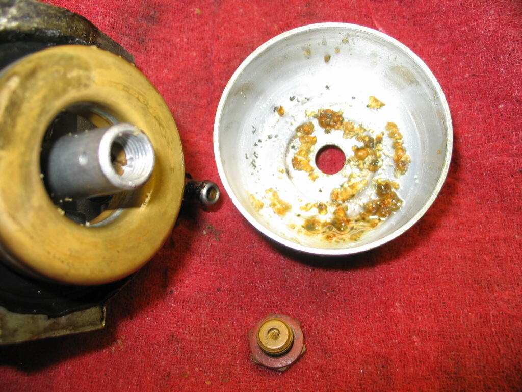

daveoman1966 3,610 #3 Posted October 26, 2021 Sheetz is my gas source...about 20 minutes away. Probablyt near an hour round-trip. My solution: I have three 5-gal gas cans so as to avoid so many trips. REAL gas will last for all summer...or years. I don't recommend any so-called stabilizers. Here's what the product Stabil did to my carb a few years ago...until I got wise. 3 Share this post Link to post Share on other sites

echris 1,425 #6 Posted October 26, 2021 2 minutes ago, daveoman1966 said: Sheetz is my gas source...about 20 minutes away. Probablyt near an hour round-trip. My solution: I have three 5-gal gas cans so as to avoid so many trips. REAL gas will last for all summer...or years. I don't recommend any so-called stabilizers. Here's what the product Stabil did to my carb a few years ago...until I got wise. The original Stabil did work well to keep gas fresher longer, especially 2 cycle. But it doesn't work with E10. There's a newer version of Stabil so you have to make sure you get the right one, but I have no idea if it works with E10 like the original did with actual gas. 1 Share this post Link to post Share on other sites

Achto 26,548 #10 Posted October 27, 2021 31 minutes ago, daveoman1966 said: That looks a lot like ethanol residue. I use Sea Foam religiously with E-free gas, 1oz per gallon in every gas can I fill and have never had a fuel related issue. I do run carburetors dry for long term storage, mainly over the winter. Multiple tractors sat through the winter and fired up without help in the spring last year. 1 Share this post Link to post Share on other sites

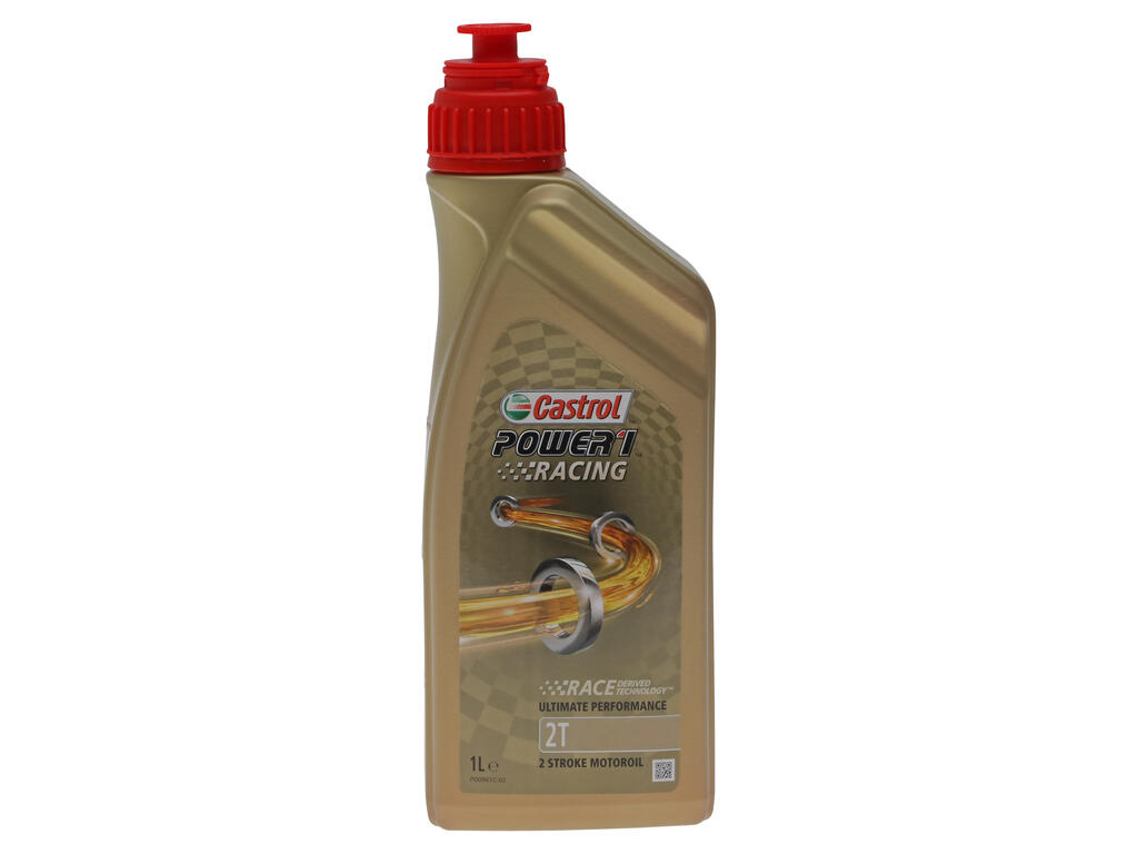

Skipper 1,788 #24 Posted October 27, 2021 (edited) two stroke oil. Just saying. I know some don't believe it, but it does prevent the green snot etc. At least the type I use does over here in EU land. Don't see why it shouldn't work on US gas. Think about it! Have you ever had gunk and fuel related carb issues in any two stroke engine? I haven't. I use Castrol fully synthetic 2 stroke oil in all my own machines, and on all the ones that get into my store in the fall, to be sold in spring/summer. After I started using it, I have not had a single fuel related problem. Is that just a coincident? No, I do not believe so. My chainsaw can sit for years before use, and also no problem at all. Before I tried this, I had all sorts of issues on the 4 strokers. One thing is for sure. This ain't snake oil, and worst case, you just lube your engines internals a little better. Over here we can not get ethanol free gas, except some ridiculously priced stuff in jugs, so there really is no alternative to finding a solution, and this seems to do the trick. I know it's unconventional, but I think it's worth a try Edited October 27, 2021 by Skipper 1 1 Share this post Link to post Share on other sites
