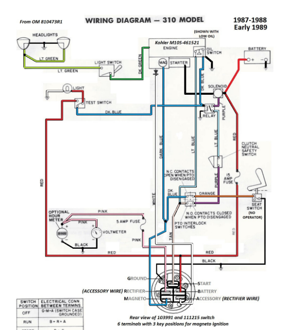

johnnymag3 2,646 #4 Posted October 4, 2021 Jumping the Solenoid should turn the Starter / engine.....not too sure about the power to the Spark plug.....Someone will be along with more input. Did you look at the Wiring diagram? There is one here on Red Square..Good Luck.... I have a complete 310-8 that I will be parting out soon, its complete, runs perfect.....37 inch deck, wheel weights,,,,and I will be selling the magnum engine also. Let me know if you need anything for your Tractor... John Share this post Link to post Share on other sites

Gregor 4,848 #15 Posted October 4, 2021 If I am reading these diagrams correctly. the low oil switch can prevent voltage from going to the starter, but does not effect the ignition. These diagrams also show a "test" switch.?????? Share this post Link to post Share on other sites

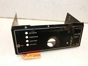

kpinnc 18,977 #17 Posted October 4, 2021 4 hours ago, Gregor said: These diagrams also show a "test" switch.?????? The mid to late 80s machines had a row of LEDs on the dash for different notifications. The test switch just turned them all on at once so the owner knew they all worked. 1 Share this post Link to post Share on other sites

Gregor 4,848 #24 Posted October 4, 2021 (edited) 21 hours ago, echris said: I then disconnected the 5 pin connector going to the engine and jumped the starter, it cranked but still no spark. I swapped plugs and verified the coil gap as well. You disconnected the wires coming from the motor, and jumped the starter, and where does the blue wire from the magneto go now? I believe the white wire comes from the stator. As said above, the stator has nothing to do with ignition. If there is a short to gnd in the blue wire, I think you have a problem. Edited October 4, 2021 by Gregor Share this post Link to post Share on other sites

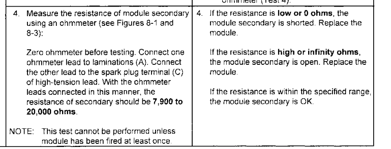

Gregor 4,848 #25 Posted October 4, 2021 (edited) 22 hours ago, echris said: I found the part number 4758403S but they're pricey! I'd like to confirm before ordering. That looks to be correct. They are on ebay for less than $20. Buying coils on ebay is kind-of a crap shoot. Might get a good one, might not. From Kohler manual 9700 ohms seems to be within spec The kill wire, (whatever color it is) could be grounded under the flywheel, or some where else on the motor, before it ever reaches that 5 pin plug. Edited October 4, 2021 by Gregor Share this post Link to post Share on other sites
