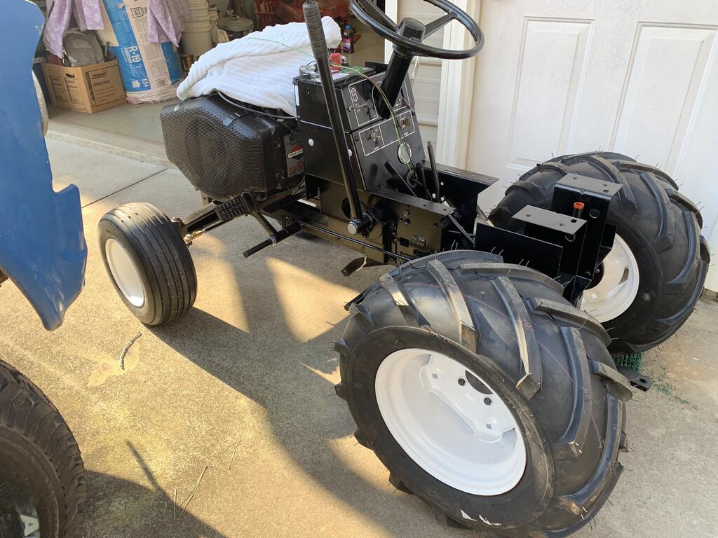

Horse Newbie 7,405 #808 Posted February 12, 2022 She’s a roller ! 1 7 Share this post Link to post Share on other sites

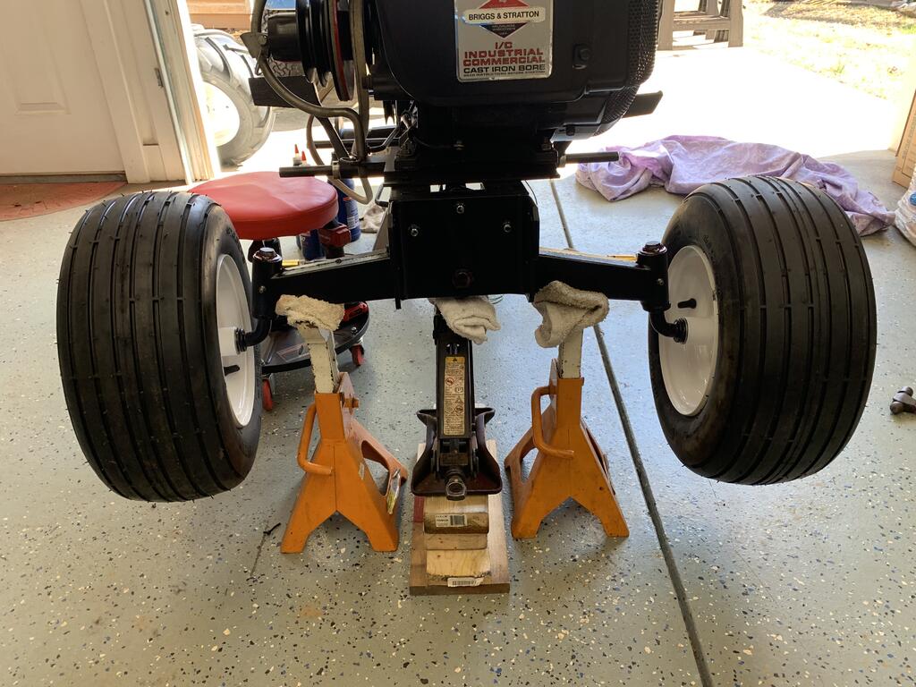

Horse Newbie 7,405 #809 Posted February 12, 2022 Had my tires put on my rims… a little disturbed that they scratched my wheels a little… the man warned me that they may get scratched. Oh well it’s a tractor, not a trailer queen… Not gonna try to touch them up… that would probably look worse… On the fronts… are those black plastic spindle caps supposed to just snap on the large washer, or slide down on the wheel hub a little ? 3 1 Share this post Link to post Share on other sites

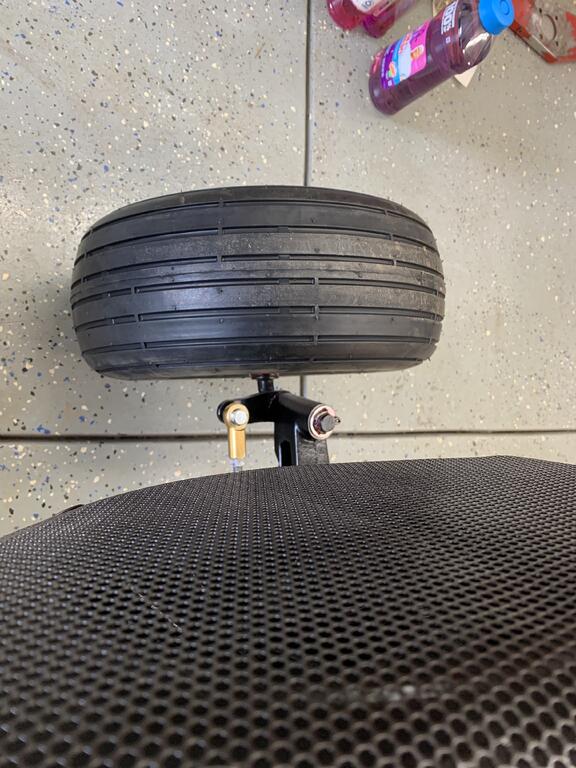

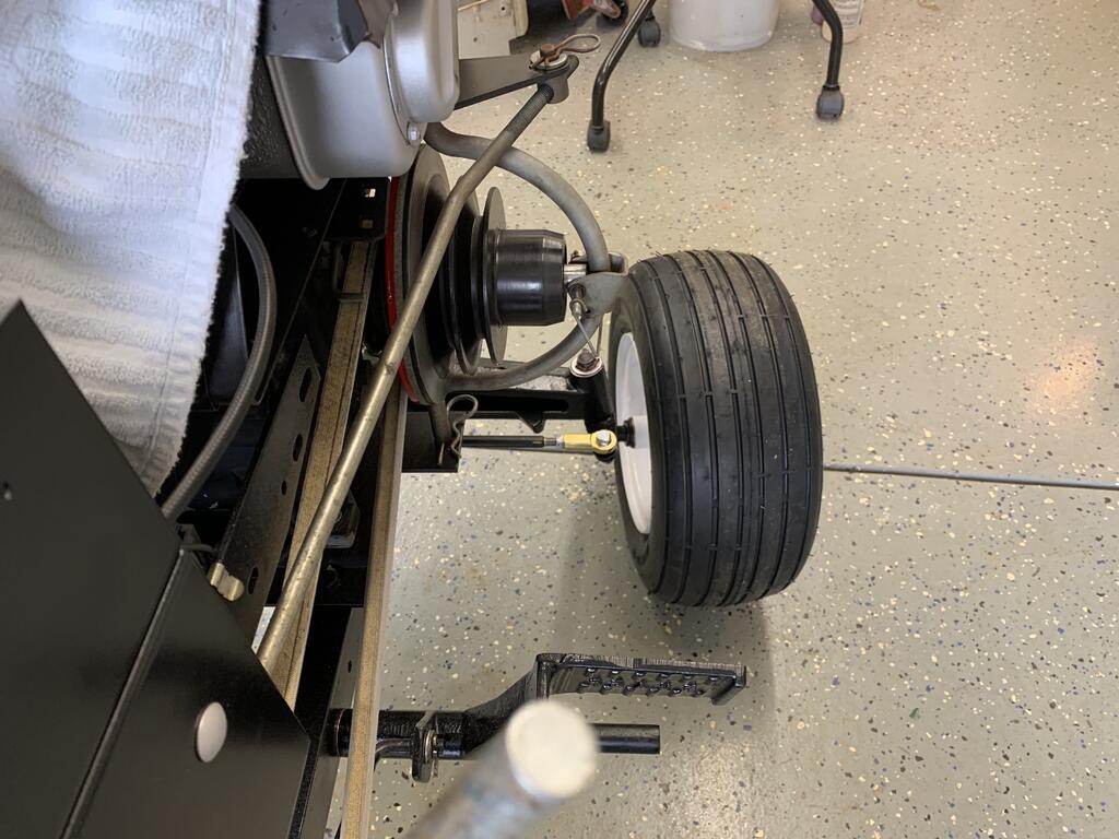

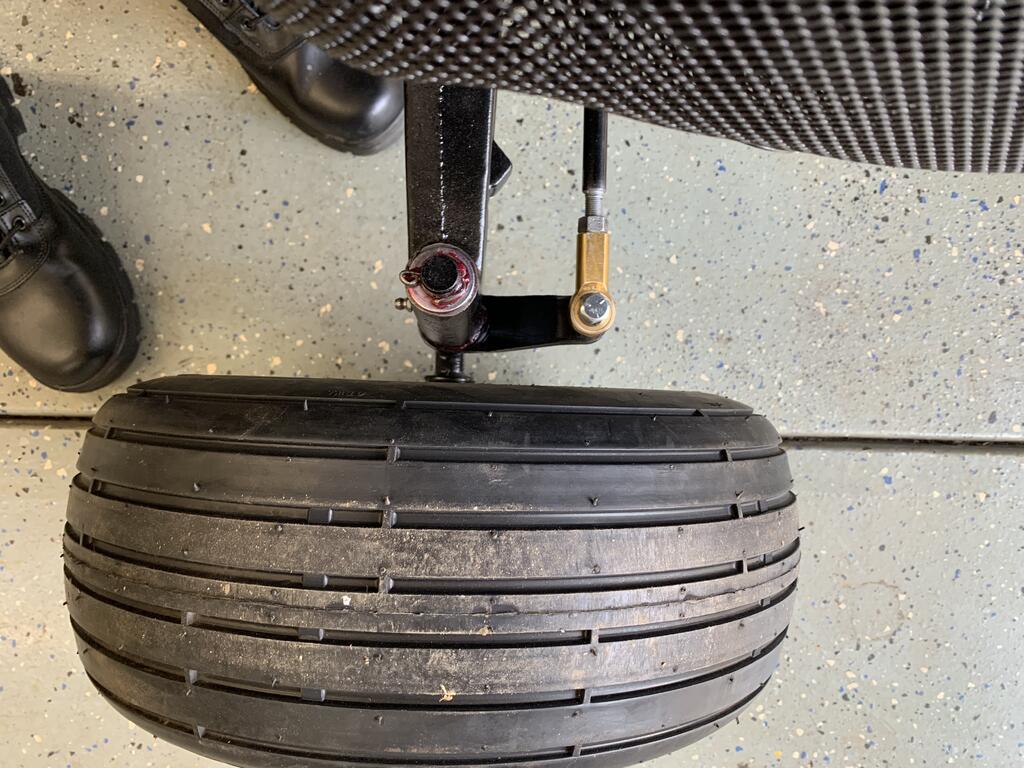

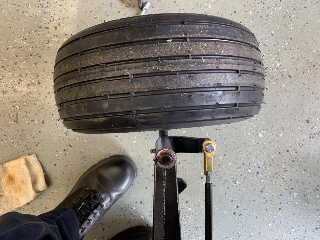

Horse Newbie 7,405 #810 Posted February 12, 2022 May have a little too much toe-in… take a look at these pics… What do you think @ebinmaine, @kpinnc, @Lee1977, @squonk, @WHX??, @Pullstart ? When I push it across the Hot Rod & Custom Restorations Shop floor, it sounds like a new pair of basketball shoes on a basketball court … 1 Share this post Link to post Share on other sites
squonk 48,429 #811 Posted February 12, 2022 that RH side needs to be toed out some 2 Share this post Link to post Share on other sites
SylvanLakeWH 32,921 #812 Posted February 12, 2022 37 minutes ago, Horse Newbie said: On the fronts… are those black plastic spindle caps supposed to just snap on the large washer, or slide down on the wheel hub a little ? Mine touch the wheel… 1 Share this post Link to post Share on other sites
Lee1977 7,813 #813 Posted February 12, 2022 (edited) The tires should toe in 1/8" to max 1/4". The new tires with sharp edges are going to make noise on that slick floor until they get worn a little. Doesn't look that far off is the steering wheel centered. That's usually the hard part of getting the toe in right. Edited February 13, 2022 by Lee1977 2 Share this post Link to post Share on other sites
Horse Newbie 7,405 #814 Posted February 13, 2022 3 hours ago, squonk said: that RH side needs to be toed out some I’m thinking adjust both sides so that I sorta do both, instead of a “big” adjustment on one side only. 1 Share this post Link to post Share on other sites
ebinmaine 81,283 #815 Posted February 13, 2022 Just now, Horse Newbie said: I’m thinking adjust both sides so that I sorta do both, instead of a “big” adjustment on one side only. Center the steering wheel and the underside flag of the steering system. Then adjust each side as needed. 2 1 Share this post Link to post Share on other sites
Jeff-C175 7,212 #816 Posted February 13, 2022 3 minutes ago, ebinmaine said: Center the steering wheel and the underside flag of the steering system. Then adjust each side as needed. If you don't center the wheel before adjusting you will steer more in one direction than the other. NASCAR anyone? 1 1 Share this post Link to post Share on other sites
Horse Newbie 7,405 #817 Posted February 13, 2022 2 hours ago, Lee1977 said: The tires should toe in 1/8" to max 1/4". The new tires with sharp edges are going to make noise on that slick floor until they get worn a little. Doesn't look that far off is the steering wheel centered. That's usually the hard part of getting the tor in right. When I was first reinstalling the steering, I tried to get the “spokes” in the steering wheel centered when the wheels were straight, but… I would go one gear tooth one way and it would be off… one gear tooth the other way and it would be off… So I had to settle with the spokes not centered on the steering wheel like a “Y”. But I definitely need to adjust that toe in. I could tell one front wheel was fighting the other, even considering the new tires being “sticky” on the epoxy floor. Share this post Link to post Share on other sites
Horse Newbie 7,405 #818 Posted February 13, 2022 5 minutes ago, ebinmaine said: Center the steering wheel and the underside flag of the steering system. Then adjust each side as needed. That’s what I did @ebinmaine… I just gave it a “big” toe ! Share this post Link to post Share on other sites

kpinnc 19,107 #820 Posted February 13, 2022 4 hours ago, Horse Newbie said: She’s a roller ! She looks great! Those ag tires locked up nicely! 4 hours ago, Horse Newbie said: Not gonna try to touch them up… that would probably look worse… I would touch them up. You do not want raw steel exposed with powder coat, trust me. Just get yourself a little fine brush (model kit stuff at wally world), and a white can of Rust-Oleum. Spray a little in the cap and dip the fine brush in it. Dab it in the center of the scratch. Capillary action will draw it into the scratch, and even if it looks like a blob it will shrink as it dries. Several of my tractors have touch ups like that, and it works well. 3 Share this post Link to post Share on other sites
Horse Newbie 7,405 #821 Posted February 13, 2022 38 minutes ago, kpinnc said: would touch them up. You do not want raw steel exposed with powder coat, trust me. Thanks… will do ! Share this post Link to post Share on other sites
