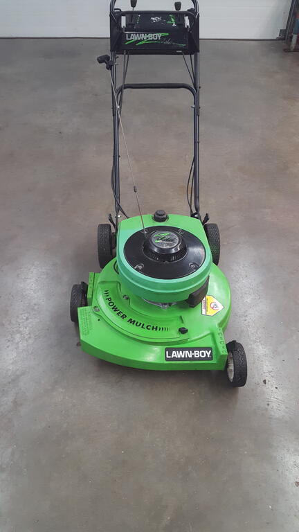

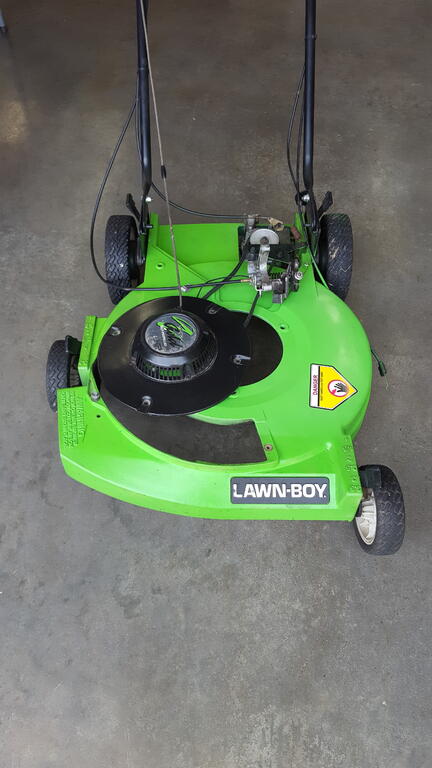

Gregor 4,848 #1 Posted August 31, 2021 (edited) My Lawn Boy model 10515 is a 1994, 4.5 HP, self propelled mulching mower. My wife uses this exact same mower. But this particular one, is one I rebuilt a couple of years ago, and has been in storage, until Sunday, I brought it home. And then ! An acquaintance stops by on Sunday. (not even a friend) His wife came to see my wife. He sees my various Lawn Boys in the garage. I just brought the rest of them home from the storage locker. Apparently he's been looking at mowers, but hasn't bought one yet. He asked about my 10515. I tell him it's been rebuilt, it is self propelled, 21" cut, with a mulching blade on it. He asks if he could take it home and try it out. I agreed. I filled it with gas. He says his yard isn't very big, and won't take long. He brings it back yesterday afternoon. "Something is wrong with it, it's not running right" OK I thought that was a little strange, but we talk for a bit, he leaves, and I start to check things out. He is correct, it's not running right. I have never heard a diesel Lawn Boy before. At this point, I am fearing the worst. I drain the fuel. STRAIGHT GAS ! I call him up. "Did you by chance put more fuel in the mower ?" "Oh yeah. It was going so good, I decided to take it to my mothers house and mow her yard. It's pretty big, and I ran out of gas. " Ya know it's impossible to strangle someone over the phone ! Long story short, (too late I know), I am assessing the damage, but I am not very hopeful. I may have to find me another F series motor. I have not tore it down yet, but it can't be good. And NO. He does not want to buy the mower. I don't blame him. IT'S NOT RUNNING RIGHT ! Edited August 31, 2021 by Gregor 1 10 Share this post Link to post Share on other sites

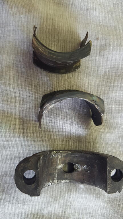

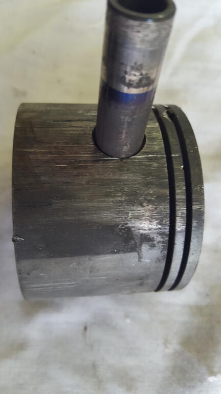

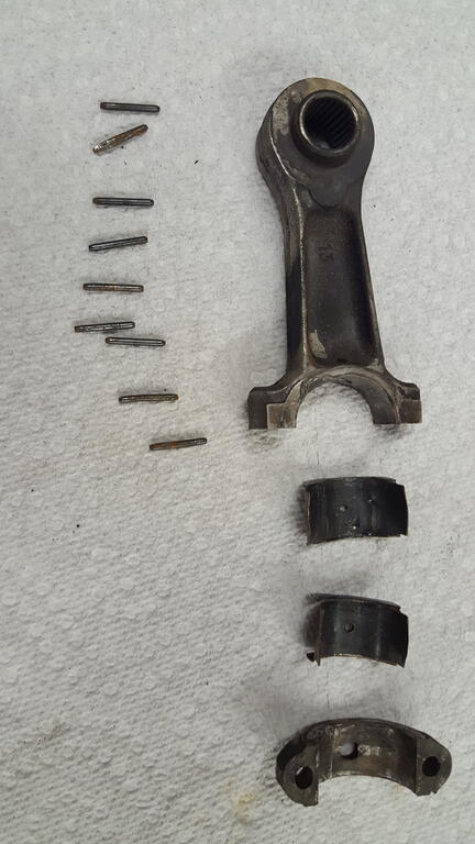

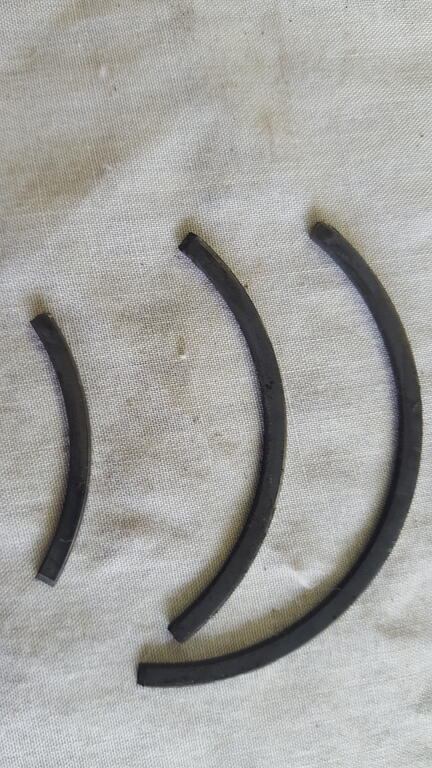

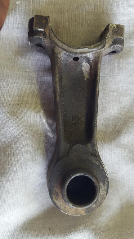

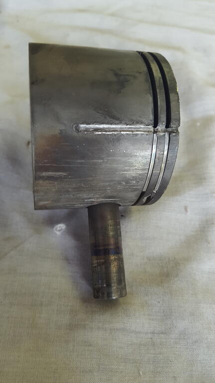

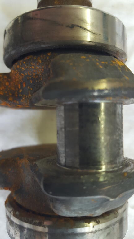

Gregor 4,848 #13 Posted September 1, 2021 Here are some pics I posted last year in a Lawn Boy forum. I cannot say for certain that this motor was straight gassed, but I would just about bet on it. The bearings are stuck. This is from a 6.5 hp Dura Force motor. A VERY good motor. Share this post Link to post Share on other sites
Handy Don 17,490 #14 Posted September 1, 2021 5 minutes ago, Gregor said: Here are some pics I posted last year in a Lawn Boy forum. I cannot say for certain that this motor was straight gassed, but I would just about bet on it. The bearings are stuck. This is from a 6.5 hp Dura Force motor. A VERY good motor. Great pics, thanks! Clearly there was inadequate lubrication and what a mess. Share this post Link to post Share on other sites

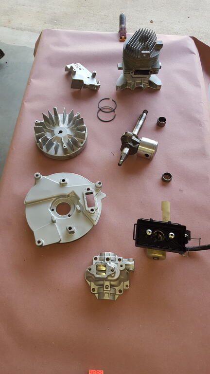

Gregor 4,848 #16 Posted September 2, 2021 My 10515 is back, I hope. New piston and rings, new bearings throughout, and new seals. The cylinder was slightly scored, but not terrible. I honed it as much as I dared. I am suppose to wait 15 hours for the Honda Bond HT gasket sealer to cure. Tomorrow will tell the tale. Share this post Link to post Share on other sites
