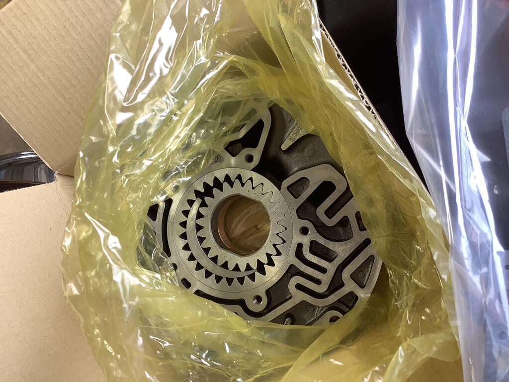

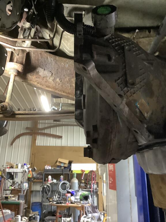

Pullstart 71,119 #104 Posted June 7, 2021 On 6/4/2021 at 6:09 PM, squonk said: Make sure that torque converter is seated! Edited Friday at 06:11 PM by squonk How’d you guess? First time in a long time I didn’t get it fully engaged! Luckily a short motorcycle ride and these guys have what I need... Share this post Link to post Share on other sites
squonk 47,898 #105 Posted June 7, 2021 55 minutes ago, pullstart said: How’d you guess? First time in a long time I didn’t get it fully engaged! Luckily a short motorcycle ride and these guys have what I need... The Shadow (The Squonk) knows! 1 2 Share this post Link to post Share on other sites

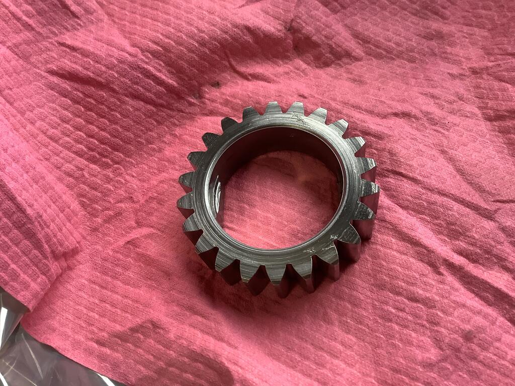

Pullstart 71,119 #106 Posted June 7, 2021 It’s a time setback, but a lesson learned. They didn’t have a gear set, but a new pump body and some seals set me back $116.60. The torque converter bushing (looks like a cam bearing) was toast too from the weight of the transmission riding on it. All better now! 2 Share this post Link to post Share on other sites
Pullstart 71,119 #107 Posted June 7, 2021 There we go @squonk 4 Share this post Link to post Share on other sites

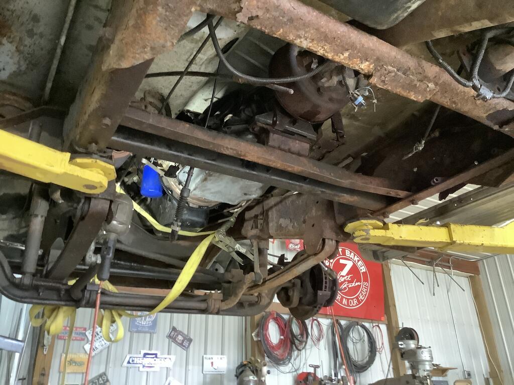

Pullstart 71,119 #108 Posted June 7, 2021 Forward progress. It’s not super hot today, but it sure is sweaty outside! 4 Share this post Link to post Share on other sites

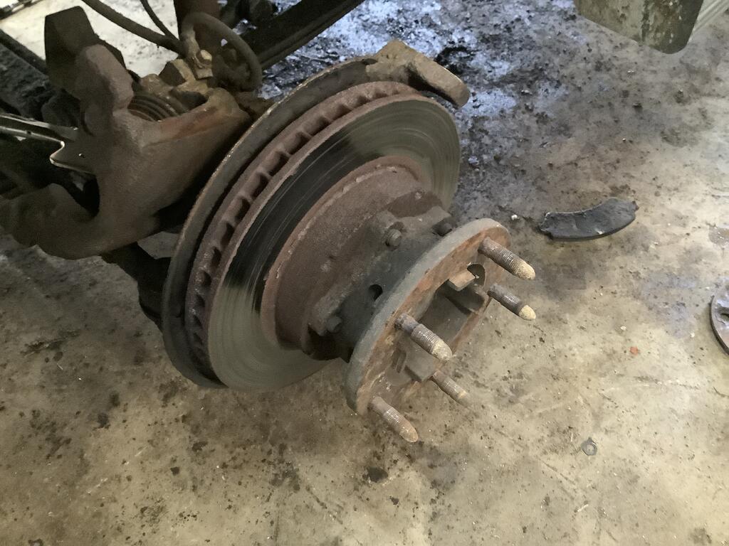

Pullstart 71,119 #109 Posted June 7, 2021 Farm Truck is ready for the road! Well... better stick some brakes on it! 2 3 Share this post Link to post Share on other sites

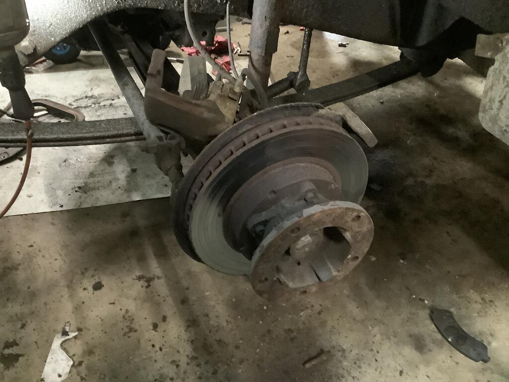

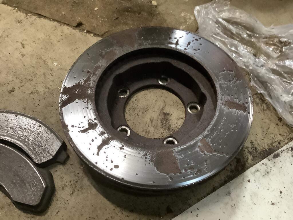

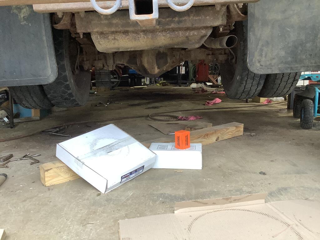

Pullstart 71,119 #110 Posted June 7, 2021 Rear brake pads are done, calipers anti-siezed well enough @Achto and @WHX24 should be able to slide halfway to the Big Show! Fronts are getting new rotors and I’ll pack the bearings while I’m in there. The store will have me some wheel seals in the morning. 1 3 2 Share this post Link to post Share on other sites
Pullstart 71,119 #111 Posted June 8, 2021 Ice Worms. The original drilled and slotted. Share this post Link to post Share on other sites

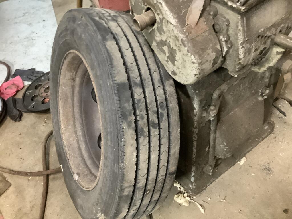

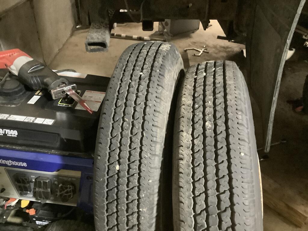

Pullstart 71,119 #113 Posted June 8, 2021 @ebinmaine @Achto @Ed Kennell @8ntruck or anyone with heavy duty wheel and tire experience... what would you say is a better steer tire? The flat, grooved tires were up front. 225/70R19.5. The treaded tires I picked up for spares, but are a bit taller and skinnier. 8-19.5. Both are Load Rated F. I was thinking put the 8-19.5’s up front for the shear fact of universal replacement should I need a spare. The 225/70R19.5’s could essentially go anywhere. What say you? 1 Share this post Link to post Share on other sites
ebinmaine 80,382 #114 Posted June 8, 2021 6 minutes ago, pullstart said: @ebinmaine @Achto @Ed Kennell @8ntruck or anyone with heavy duty wheel and tire experience... what would you say is a better steer tire? The flat, grooved tires were up front. 225/70R19.5. The treaded tires I picked up for spares, but are a bit taller and skinnier. 8-19.5. Both are Load Rated F. I was thinking put the 8-19.5’s up front for the shear fact of universal replacement should I need a spare. The 225/70R19.5’s could essentially go anywhere. What say you? Was it me I would put the lower set where you're showing two tires, on the front. I like to have a little bit of cross tread on my steering tires and the upper tire does not have that. Mind you, that's just a matter of preference for the driving that I do both on asphalt and dirt. 1 1 Share this post Link to post Share on other sites
Pullstart 71,119 #115 Posted June 8, 2021 4 minutes ago, ebinmaine said: Was it me I would put the lower set where you're showing two tires, on the front. I like to have a little bit of cross tread on my steering tires and the upper tire does not have that. Mind you, that's just a matter of preference for the driving that I do both on asphalt and dirt. different reasoning, but my same choice. Like mentioned, I’d like my spare to match the rears, should I need one. 2 Share this post Link to post Share on other sites
Achto 32,362 #116 Posted June 8, 2021 I agree with Eric, the tires in the second picture look to have better siping capabilities. Is the tire in the first picture a regroovable tire? 1 Share this post Link to post Share on other sites
Pullstart 71,119 #117 Posted June 8, 2021 1 minute ago, Achto said: I agree with Eric, the tires in the second picture look to have better siping capabilities. Is the tire in the first picture a regroovable tire? yes, it is. Is there a way to tell if it has been? Share this post Link to post Share on other sites
Achto 32,362 #118 Posted June 8, 2021 (edited) 4 minutes ago, pullstart said: yes, it is. Is there a way to tell if it has been? Looking at the fine cross grooves, I would say that the tire has not been regrooved yet. Most people don't bother with the fine cuts. There looks like there are wear bars down in the groove as well. these would disappear when regrooved. Edited June 8, 2021 by Achto 1 Share this post Link to post Share on other sites

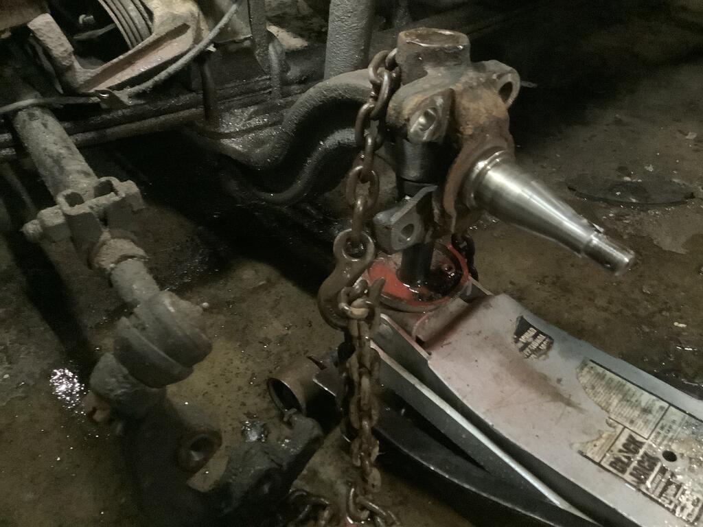

Pullstart 71,119 #123 Posted June 8, 2021 Might just leave it sloppy! axle glowing red with a torch? Yep. Floor jack chained to the axle with a small enough drive socket? Yup. Still hot and jack maxed out and smacking it with a 10 lb sledge? Absolutely. and to think a frozen hitch pin gets some people fired up... Ideas? 1 Share this post Link to post Share on other sites
lynnmor 9,013 #124 Posted June 8, 2021 The jack and chains would still have a bit of give and act as a heavy spring. My idea is to have something heavy and solid under the pin. JMHO. 1 Share this post Link to post Share on other sites
8ntruck 9,226 #125 Posted June 8, 2021 (edited) 1 hour ago, lynnmor said: The jack and chains would still have a bit of give and act as a heavy spring. My idea is to have something heavy and solid under the pin. JMHO. A piece of 3/4 thick plate with a proper diameter round stock welded to it, maybe. As far as tires go, you would want to match sizes in the dual application. Tread style would be personal preference, of which, I don't have any. Lug nut torque is absolutely critical - especially with new studs installed. Improper torque is a contributing factor in failures for this type of wheel. Probably a section on lug nut torque in the owners manual. I'm going to guess that the studs are 1/2". 90 to 100 ft lb would probably be a good place to start. Edited June 8, 2021 by 8ntruck Share this post Link to post Share on other sites
