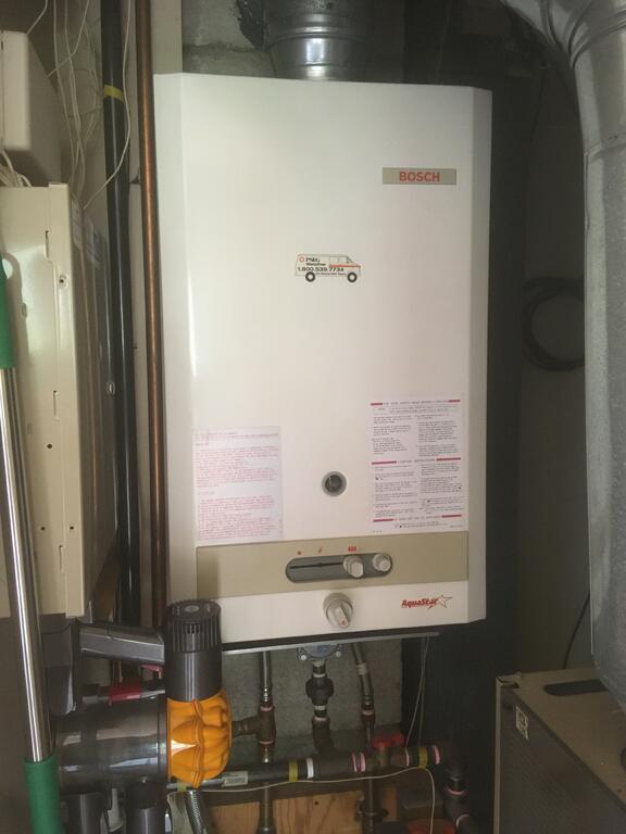

formariz 12,356 #26 Posted April 30, 2021 (edited) About 30 somewhat years ago I had a big mishap here with the water heater while on vacation. The damage was extensive. I was never fond of this type of water heater always heating up the same water when not in use and the fact that when they eventually leak it is usually catastrophic. I went then with an instant water heater such as used in Europe. Peace of mind. Never regretted it. The damage from leaks was eliminated and the gas usage savings was immediately apparent. Also gained lots of space. Still the same heater today. Occasional suggested maintenance on the pilot burner and that is it. Untouched in all of these years. Edited April 30, 2021 by formariz 3 Share this post Link to post Share on other sites

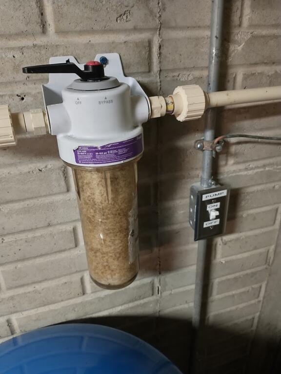

rmaynard 16,910 #27 Posted April 30, 2021 Some other info on the water. We have a well. The water tastes and looks great, but is very hard. So we have a water softener. That keeps the hardness at about <20 ppm. We do have some sediment which is controlled by simple filter. The picture shows the filter after about 30 days of usage. As far as the sacrificial anode, when the last water heater was replaced (2011) the anode was in pretty good shape. But I have been softening the water since 1988. 1 Share this post Link to post Share on other sites

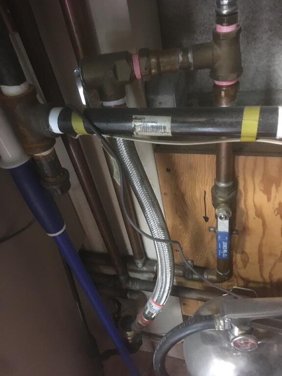

formariz 12,356 #48 Posted April 30, 2021 (edited) 1 hour ago, squonk said: Cas, Hot water recirc pump in that pic? I have a Rinnai tankless. about 8 yrs now. Love it but I wish I went the extra with a recirc pump. The right way is to add a 3 gal electric with it so the main heater doesn't short cycle on low demand. I descale once a year with white vinegar and a little pump. Best thing is I can send hot water to my garage and run my pressure washer all day and have it hot! No recirculation pump. Only learned about it afterwards. I connected the relief valve to a tap outside which is always open. If activated no water inside. Use the hot water outside also by opening the relief valve. Great for wine barrel cleaning, pressure washer and what ever it may be needed on. Edited April 30, 2021 by formariz 1 Share this post Link to post Share on other sites
