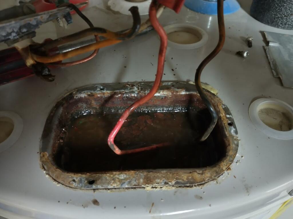

rmaynard 17,589 #1 Posted April 30, 2021 (edited) Well ain't this a fine kettle of fish? Getting ready to leave for Florida tomorrow and I suddenly have a water heater problem. I went to the basement yesterday to check the automatic timer on the water heater so I could set it for vacation. When I laid my hand on top of the electrical cover of the heater it burned me. That's not normal says I. So I removed the screw that holds the cover and heard sizzling. What I found was this. This image was taken after I had pulled the wires out of the water. One lead had corroded so bad that as soon as I touched the wire nut the wire broke. Now bear in mind that I have not had any hot water issues, and the circuit breaker never tripped. I cannot find the source of the water as both the incoming cold and outgoing hot pipes are dry at their connections to the top of the heater. I cannot get to the relief valve due to the foam insulation. So I trimmed back the insulation and put on new wire nuts, cleaned the water out, turned the breaker back on and everything has been fine for the last 12 hours. The water has not returned. Of course I am not leaving it this way. Will kill the breaker while away, and will replace the water heater upon my return, but that still leaves the unanswered question of where did the water come from, and with both leads under water, why didn't the breaker trip? Scratching my head. Edited April 30, 2021 by rmaynard 6 Share this post Link to post Share on other sites
Jeff-C175 7,211 #2 Posted April 30, 2021 43 minutes ago, rmaynard said: Will kill the breaker while away, and will replace the water heater upon my return You better shut the water off too! Don't wanna come home to a flood! Sometimes they start leaking S L O W L Y internally and the water fills between the tank and the jacket. When they used to use the fiberglas insulation, the water would run to the bottom. The foam insulation often stops that and you don't know you have a leak for a LONG time, like you did. Consider a GFCI circuit breaker in your panel. They're $$$ but it would have tripped with that fault. 5 Share this post Link to post Share on other sites
ACman 7,741 #3 Posted April 30, 2021 (edited) Why the breaker didn’t trip I’m with you. Have you pulled one of those plastic caps next to the box to see if the insulation is wet under there.just like Jeff said. Edited April 30, 2021 by ACman 1 Share this post Link to post Share on other sites
Jeff-C175 7,211 #4 Posted April 30, 2021 2 minutes ago, ACman said: Why the breaker didn’t trip Not enough current leakage to trip a 30A breaker. The GFCI would have tripped though. GFCI for many areas may be 'code' now BTW. It is in my area. But 'grandfathered'. If you pull a permit for new WH, you have to also pull electrical to change the breaker. "Permits? We don't need no steeenking permits!" 3 1 Share this post Link to post Share on other sites

ACman 7,741 #6 Posted April 30, 2021 (edited) Thanks for the info Jeff . I haven’t messed with a water heater since my accident 10 years ago . Back then a gas power vent w/h wouldn’t work if it was plugged into a gfci plug or extension cord but that’s . Bob I’d also pry that box up and see what’s underneath. I don’t see condensation doing it , Edited April 30, 2021 by ACman 1 Share this post Link to post Share on other sites

Pullstart 71,325 #8 Posted April 30, 2021 The picture isn’t loading for me, but I agree with @Jeff-C175 that today’s foam is poured in, sometimes to a bag that precisely spills the foam mixture around between the jacket, at just a perfect shot time to completely fill the void from the bottom to the top. With that said, sometimes a leak below the wet spot works it’s way up and out instead of running down the previously “wool” wrapped tank. Last I knew, they have figured ways to seal the jacket holes around the drain valve, t-stat access holes, etc that they don’t need the plastic any longer. Share this post Link to post Share on other sites
rmaynard 17,589 #9 Posted April 30, 2021 33 minutes ago, ACman said: Why the breaker didn’t trip I’m with you. Have you pulled one of those plastic caps next to the box to see if the insulation is wet under there.just like Jeff said. It's foam insulation, but no I have not. Don't have time to do that with less than 18 hours before I go away. The water heater has a lifetime warranty that I bought at the time of purchase, 4/12/2011. I am now fighting with them as they say that they have no proof of my heater having the warranty. I even showed them the paperwork, but you know how that goes, just like any insurance company they will try to find a way to weasel out of paying. 1 2 Share this post Link to post Share on other sites
squonk 48,159 #10 Posted April 30, 2021 I can't see the image. but it didn't trip the breaker because the short to ground wasn't enough to create enough amperage to trip. A GFCI trips on leakage to ground in millivolts so yes a GFCI would trip Reason why a power vent model would trip GFCI is electric motors and GFCI's don't play nice together. You will get many nuisance trips. 2 Share this post Link to post Share on other sites
rmaynard 17,589 #11 Posted April 30, 2021 33 minutes ago, Jeff-C175 said: Not enough current leakage to trip a 30A breaker. The GFCI would have tripped though. GFCI for many areas may be 'code' now BTW. It is in my area. But 'grandfathered'. If you pull a permit for new WH, you have to also pull electrical to change the breaker. "Permits? We don't need no steeenking permits!" I don't pull a permit to replace a water heater, and I sure don't pull a permit to change a breaker. 3 4 Share this post Link to post Share on other sites

rmaynard 17,589 #14 Posted April 30, 2021 12 minutes ago, pullstart said: The picture isn’t loading for me Should be there now. 1 Share this post Link to post Share on other sites
