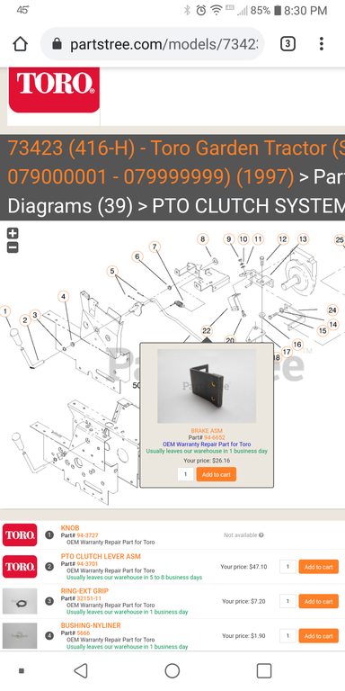

Cee245 853 #1 Posted April 13, 2021 Looking for a PTO brake. I have 2 that are worn to the rivets. Thanks Part #94-6652 Doesn't someone refurbish these? I put a want ad in already. Thanks Share this post Link to post Share on other sites

Cee245 853 #9 Posted April 13, 2021 @pfrederi Anyone know the measurements of the liner? I'm looking at Mcmaster and going to order my own. I have several that I can repair. (Hopefully!) Share this post Link to post Share on other sites

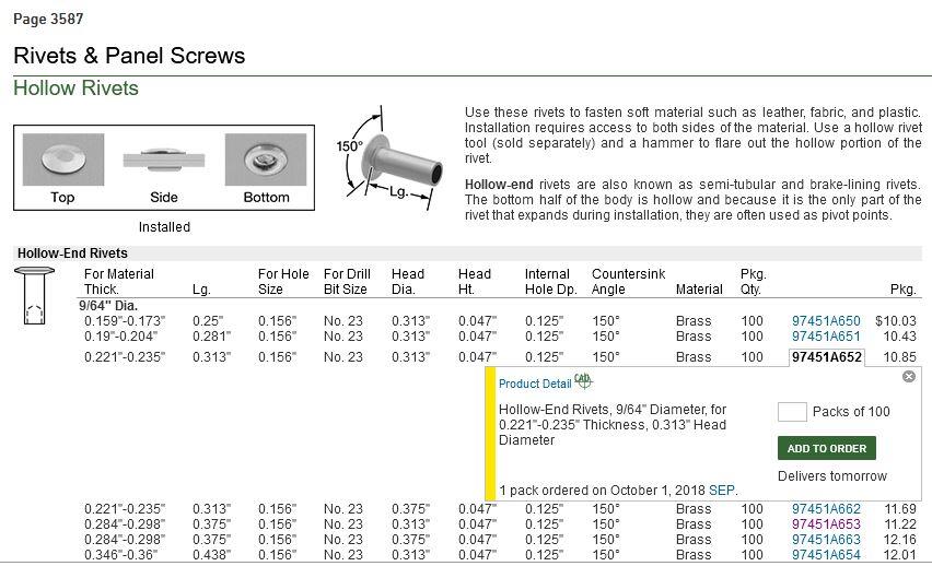

pfrederi 20,625 #11 Posted April 13, 2021 5/8 wide 1-1/2 long 3/16 thick 4-5 rivets 1 Share this post Link to post Share on other sites
Cee245 853 #12 Posted April 13, 2021 Thanks @rmaynard and @pfrederi!!! Share this post Link to post Share on other sites
