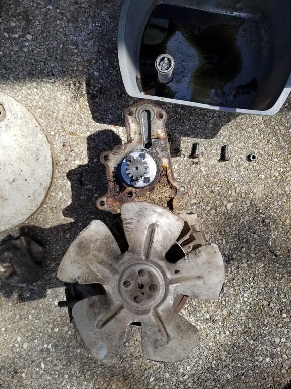

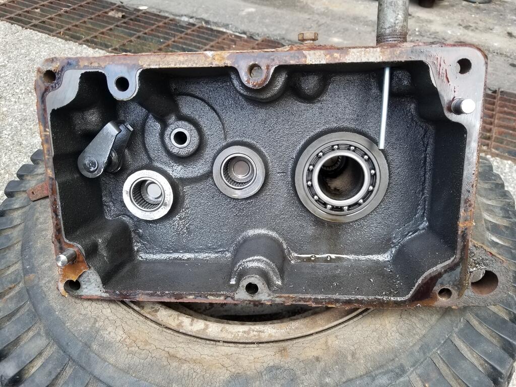

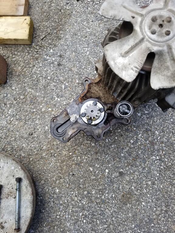

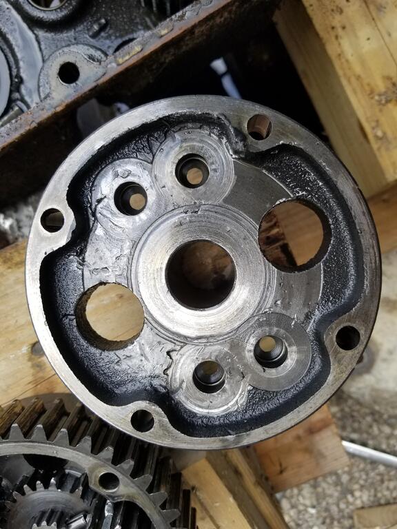

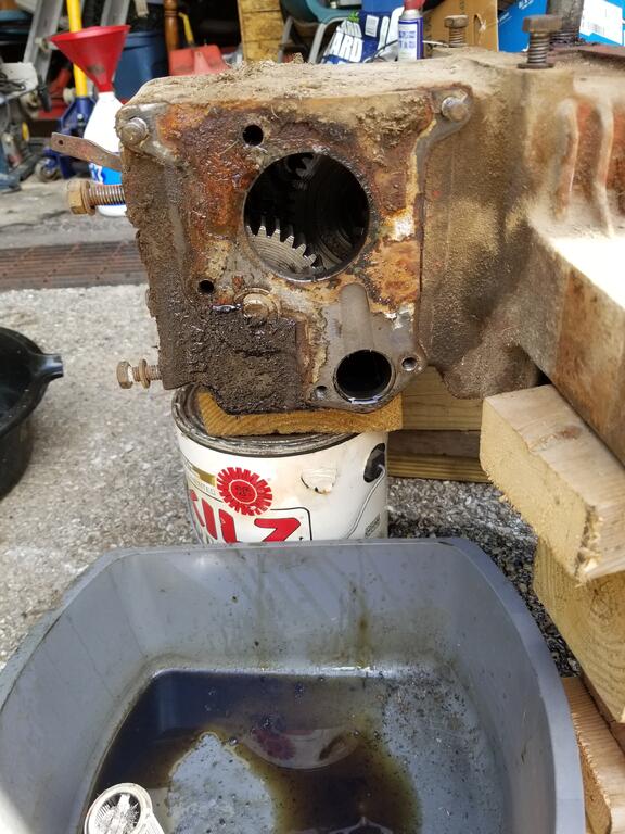

cafoose 3,862 #81 Posted April 17, 2021 I got the hydro separated from the gearbox! 1 Share this post Link to post Share on other sites
pfrederi 21,183 #82 Posted April 17, 2021 Big time Cleanup needed 1 Share this post Link to post Share on other sites

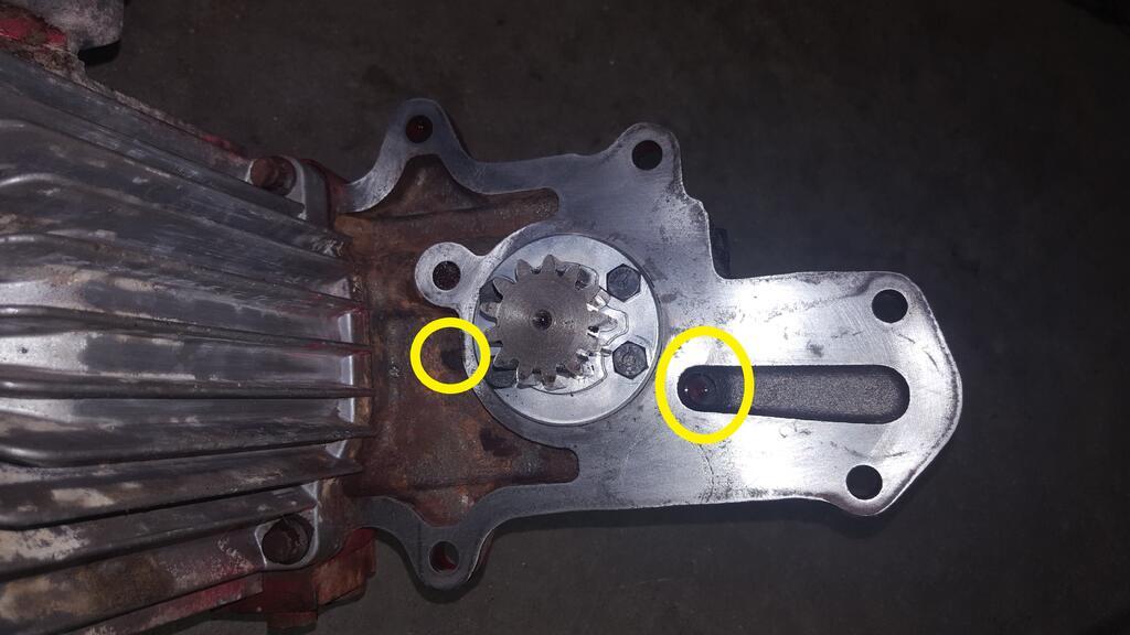

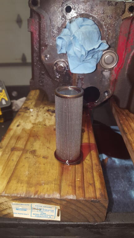

cafoose 3,862 #83 Posted April 17, 2021 @stevasaurus @Ed Kennell @pfrederi I got it apart! I guess when Bob's Outdoor Power rebuilt it they put motor oil in it so I will stick with that @Gregor I plugged the holes you circled with balled up paper towels to keep dirt out 2 1 Share this post Link to post Share on other sites
Gregor 4,848 #84 Posted April 17, 2021 Did anyone mention removing and cleaning the screen? 1 Share this post Link to post Share on other sites

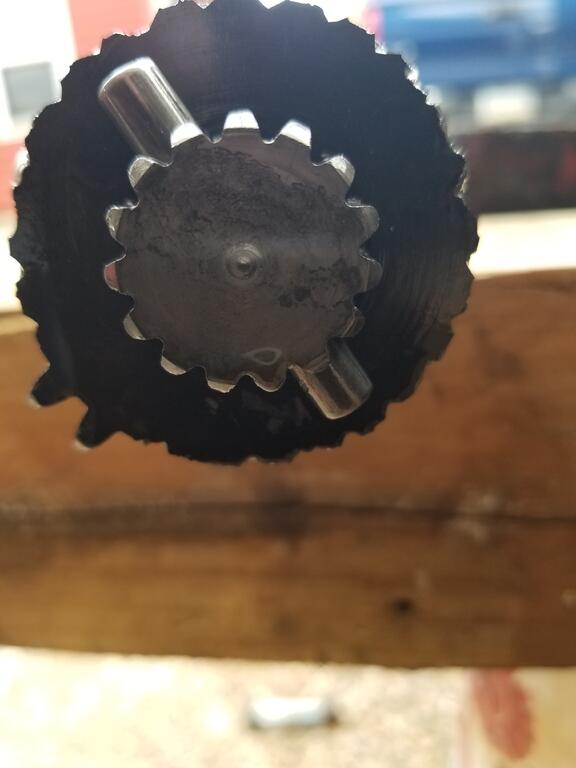

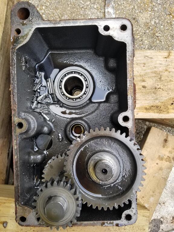

Ed Kennell 47,403 #85 Posted April 17, 2021 (edited) Think ya found the problem Chuck. Looking at the broken gear, is there any difference in color that would indicate the crack developed over time? Edited April 17, 2021 by Ed Kennell 3 Share this post Link to post Share on other sites
WHX?? 58,222 #86 Posted April 17, 2021 Ahhhh little typo ther Ed ... why I just call him 'Foosie Not too bad ... should be easy parts to find. Doesn't look like any collateral damage. 1 1 Share this post Link to post Share on other sites
Ed Kennell 47,403 #87 Posted April 17, 2021 1 minute ago, WHX24 said: Ahhhh little typo ther Ed ... why I just call him 'Foosie All better Jimbo. Tks Not too bad ... should be easy parts to find. Doesn't look like any collateral damage. He should have all the parts in the 8 spd he got from me. 1 2 Share this post Link to post Share on other sites

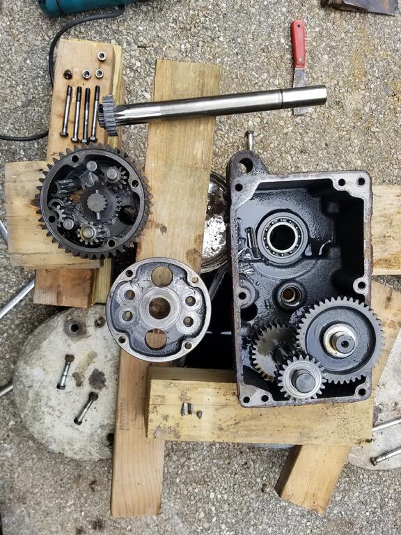

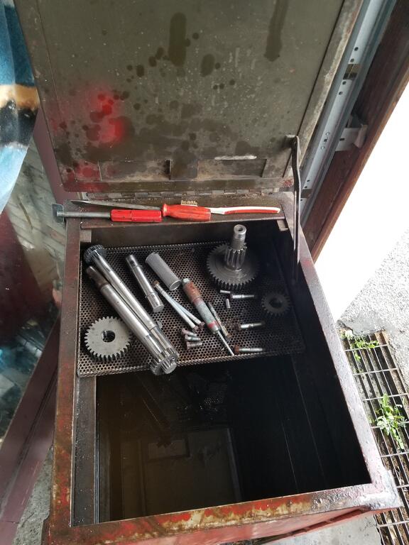

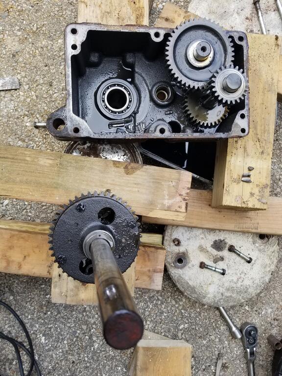

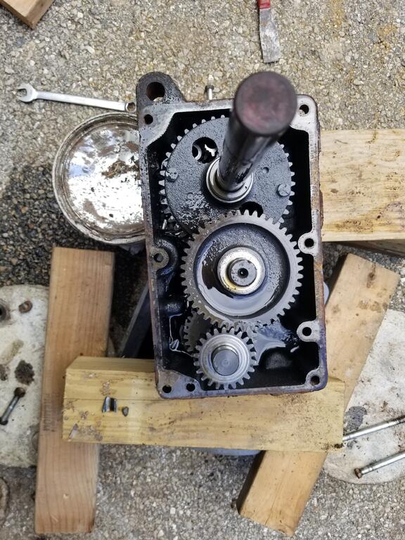

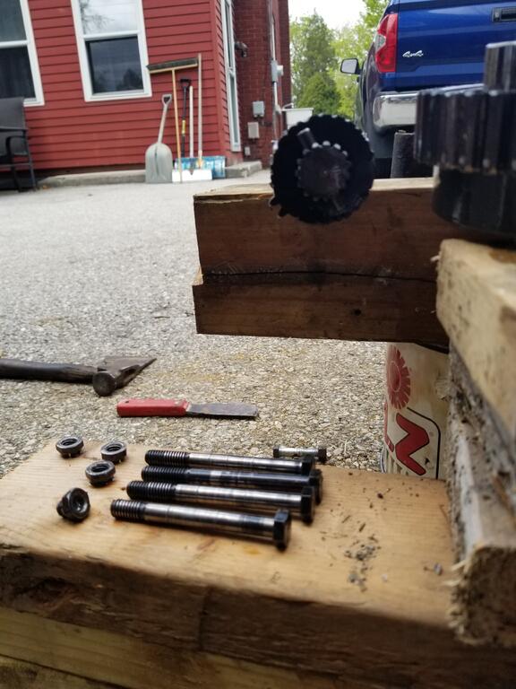

cafoose 3,862 #88 Posted April 17, 2021 Cleaning up parts 4 2 Share this post Link to post Share on other sites
cafoose 3,862 #89 Posted April 17, 2021 1 hour ago, Gregor said: Did anyone mention removing and cleaning the screen? Nope but I'm on it that's self explanatory 33 minutes ago, Ed Kennell said: He should have all the parts in the 8 spd he got from me. Yep and my axles seem good too 38 minutes ago, WHX24 said: I just call him 'Foosie Yer not the first one to call me that 1 hour ago, Ed Kennell said: Think ya found the problem Chuck. Looking at the broken gear, is there any difference in color that would indicate the crack developed over time? I have to check maybe I should bring the broken parts to the Big Show so everyone can inspect them 1 2 Share this post Link to post Share on other sites

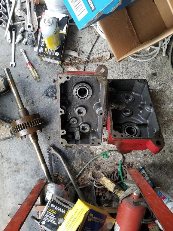

stevasaurus 23,857 #91 Posted April 18, 2021 Just like we figured. Foose...you took it apart upside down. That's OK, but put it together in the shallow side with the differential nuts up. Make sure you use new nylock nuts. Those roll pins come out easily. Also, be sure you alternate your pinions...one up next one down all the way around. When you put the differential back together, check by rotating axles in opposite directions. It is EXTREMELY IMPORTANT to make sure everything is spotless clean. Your hydro will reward you. I would not use any grease on any parts. A little Lucus Oil treatment or just some 10W-30 to lubricate parts. Take some pictures as you build it again. If you run into a problem, you can post a picture and we can take a look. Clean and keep all the other parts from Ed's transmission. If you don't want them, I'm sure @WHX24 would love to take them. 2 1 Share this post Link to post Share on other sites

Gregor 4,848 #95 Posted April 20, 2021 (edited) I don't know that it matters, but Type A trans fluid came out of mine, that's what I put back in. 8 minutes ago, cafoose said: Am I missing anything? Does the list look correct? Paint. Lots of paint Here's a tip. Don't try to put the oil in too fast. You will have it all over the place. Trust me, I know. Edited April 20, 2021 by Gregor 1 Share this post Link to post Share on other sites
pfrederi 21,183 #96 Posted April 20, 2021 (edited) I always replace Differential bolts with new GR8 (Actually Grade 9 in some differentials.) If they fail exceedingly bad things happen.... Was there any sign of leakage around your motion control, easier to address that while she is apart... Edited April 20, 2021 by pfrederi 1 Share this post Link to post Share on other sites
