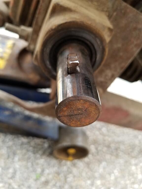

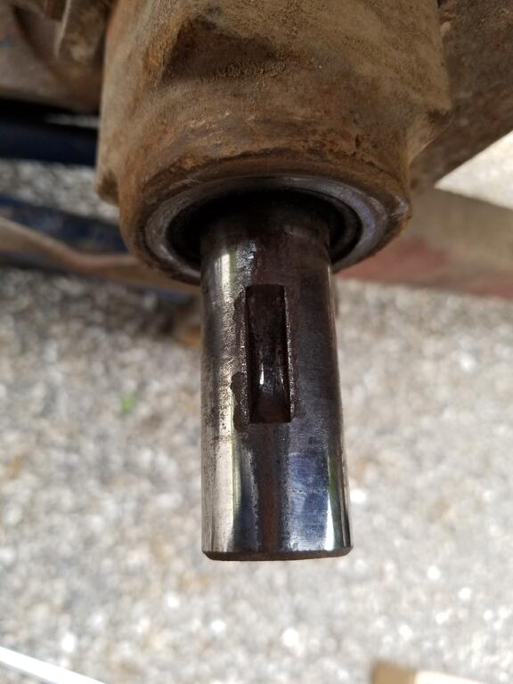

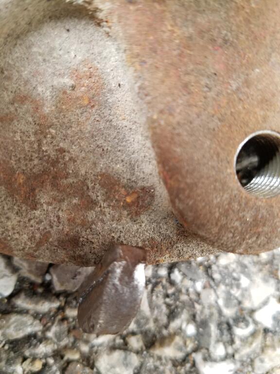

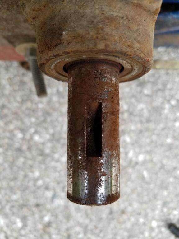

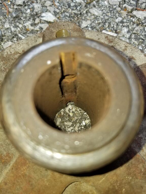

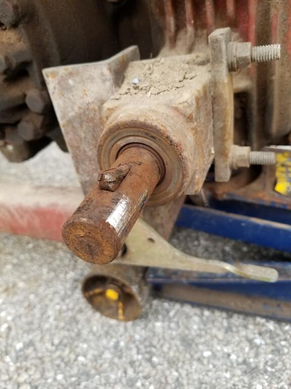

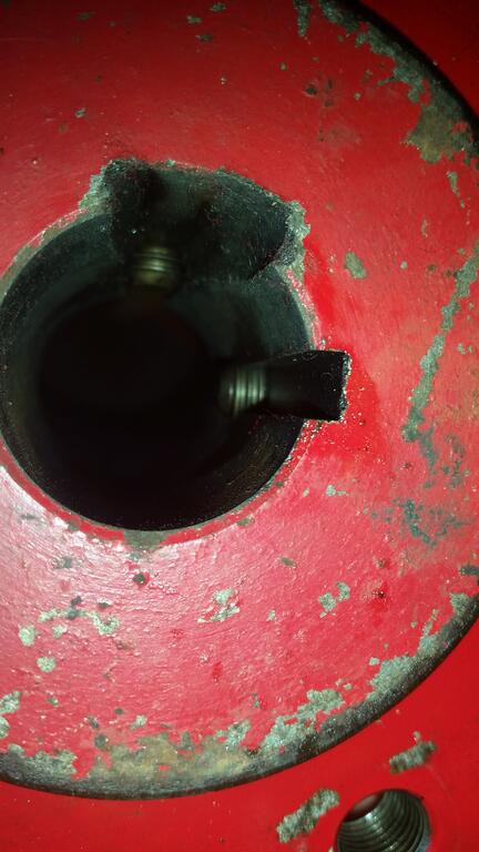

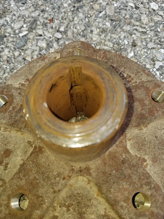

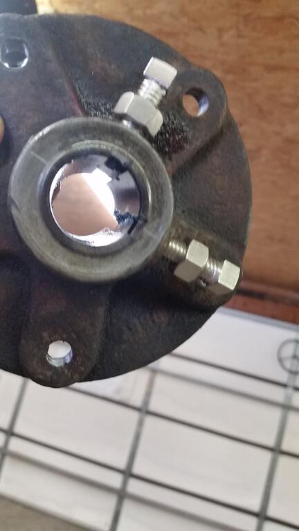

cafoose 3,448 #1 Posted April 12, 2021 I was pulling my big trailer with my 876 and it stopped moving it. It was doing great and all of a sudden it started jerking like sometimes it moved and sometimes not. I drew a line on the hubs and axles and the line moved about 1/8 of a turn. I took the wheels off and the axle keys both look worn but not sheared. When I pulled the wheels the hubs both wiggled and were loose. The hubs both look worn on the inside key-way. I was able to push the tractor by hand easily about 75 feet to the garage without opening the tow valve. If I just replace the keys and hubs will that correct the problem or do I need to open up the trans-axle? The pictures I took are from both sides 2 Share this post Link to post Share on other sites
squonk 43,657 #2 Posted April 12, 2021 Replace the keys and try it. Nothing to lose. I check all my hubs for loosness twice a year 1 1 Share this post Link to post Share on other sites

pfrederi 18,616 #4 Posted April 12, 2021 No sign inside the hub that the axle key was dragged all the way around. Only moved an 1/8 inch I doubt that this was yu r real problem (But you need to rebroach your hubs and get new keys> Pushing 75 ft with Tow valve closed is not a good thing and probably more of you issue... I know you have a wheelamatic and the manual for that is pretty skimpy (WH wanted to repair by replacement) Down load the sunstrand manual and look at diagnostics for can push with tow valve closed. Could have sheared a key in the transaxle also... 1 2 Share this post Link to post Share on other sites
squonk 43,657 #5 Posted April 12, 2021 If the shiny part on this axle is from the hub before you took it off, it turned more than 1/8"! 2 1 Share this post Link to post Share on other sites
pfrederi 18,616 #6 Posted April 12, 2021 (edited) 32 minutes ago, squonk said: If the shiny part on this axle is from the hub before you took it off, it turned more than 1/8"! If the hub had gone more than 1/8" you would see score marks on the hub bore bore still looks rusty to me. Edited April 12, 2021 by pfrederi 1 Share this post Link to post Share on other sites

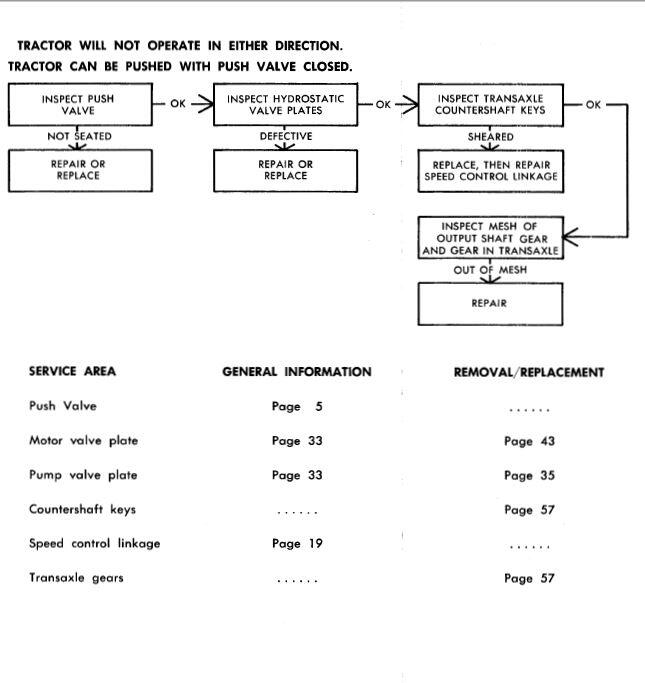

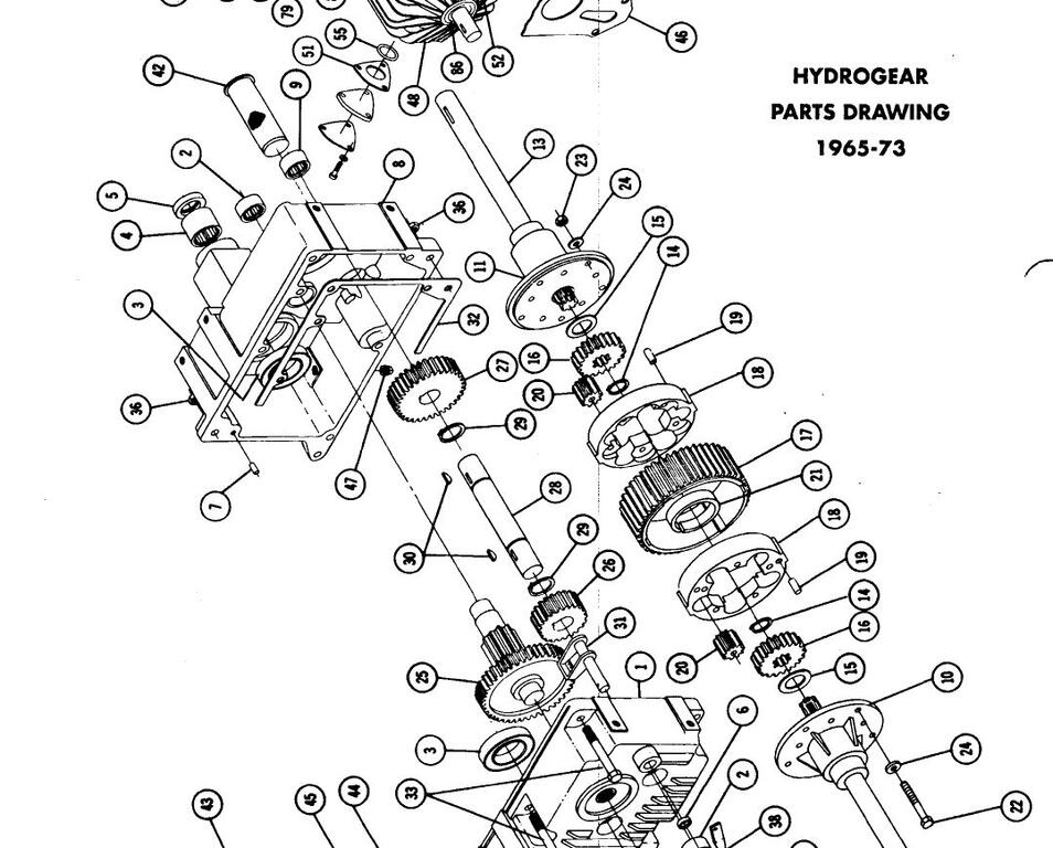

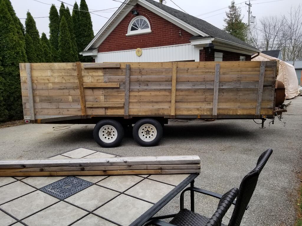

pfrederi 18,616 #8 Posted April 12, 2021 I think #30 could be your problem. How big/heavy was your trailer. 1 1 Share this post Link to post Share on other sites
squonk 43,657 #9 Posted April 12, 2021 3 minutes ago, pfrederi said: If the hub had gone more than 1/8" you would see score marks on the hub bore bore still looks rusty to me. Kinda why I wondered if the hub is so rusty, why is the axle so shiny ? Unless he filed or sanded it. Share this post Link to post Share on other sites

squonk 43,657 #13 Posted April 12, 2021 When you posted:"I was pulling my big trailer " I thought "oh boy"! 2 1 Share this post Link to post Share on other sites
cafoose 3,448 #14 Posted April 12, 2021 9 minutes ago, squonk said: Unless he filed or sanded it. Nope I did replace an axle key a few years ago maybe it's from that. The key was completely broken at that time. Share this post Link to post Share on other sites
stevasaurus 23,274 #15 Posted April 12, 2021 I don't think it is #30. It's in your differential...either an axle gear or pinions or both. The keys in #30 have nothing to do with the axles not turning in opposite directions. Either way, you have to open it. 1 Share this post Link to post Share on other sites

cafoose 3,448 #17 Posted April 12, 2021 Just now, stevasaurus said: I don't think it is #30. It's in your differential...either and axle gear or pinions or both. The keys in #30 have nothing to do with the axles not turning in opposite directions. Either way, you have to open it. How difficult is that? Would it be easier to replace it? Share this post Link to post Share on other sites
squonk 43,657 #18 Posted April 12, 2021 Lots of Hydrogears at the show usually. 1 Share this post Link to post Share on other sites

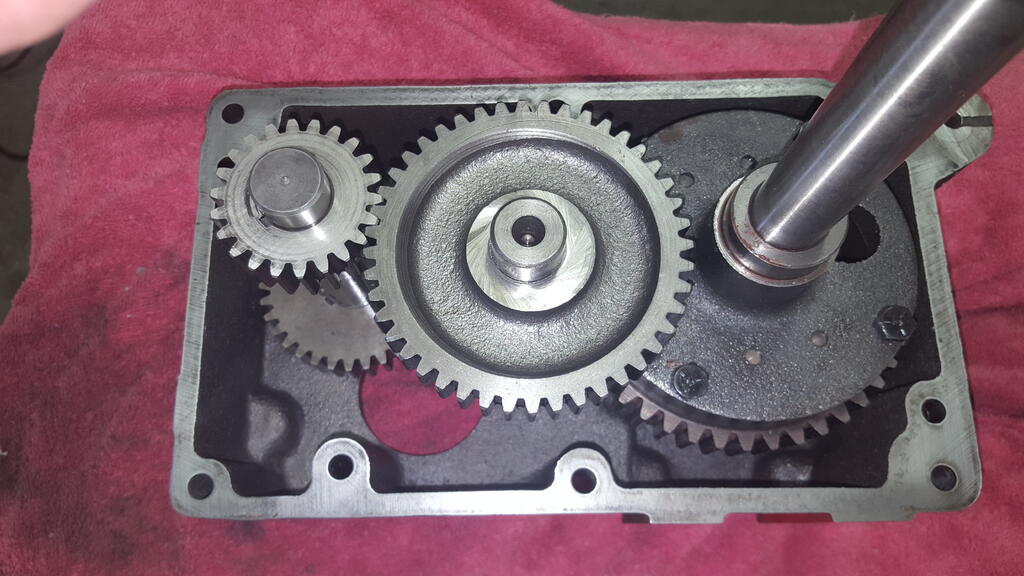

stevasaurus 23,274 #19 Posted April 12, 2021 No, it is easier to fix...just don't cause anymore damage. Paul and I love to guess what is wrong, but I got him this time. Axle gear and/or pinions...the videos show that. Paul . Once you drop the trans and open it...shallow side down. You can just pull out the differential and the axle gears and pinions are inside. A-Z Tractor parts should have what you need. 1 1 Share this post Link to post Share on other sites

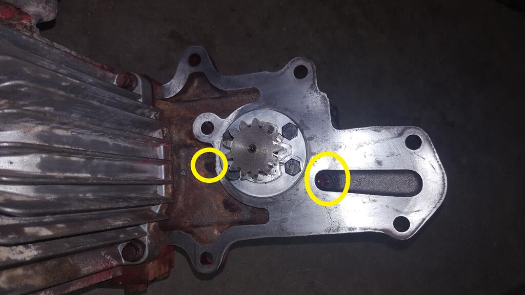

Gregor 4,847 #22 Posted April 13, 2021 They are pretty simple once you get inside. There really isn't much there. If you pull off the hydro pump, which I did, and would do again, be careful of getting dirt and debris in these holes. They are oil ports. Check you parking brake lever for wear, and repair if needed. May as well order a gasket and seals now. You are going to need them, if you open it up. I made it through, with a lot of help from this forum. 5 2 1 Share this post Link to post Share on other sites
