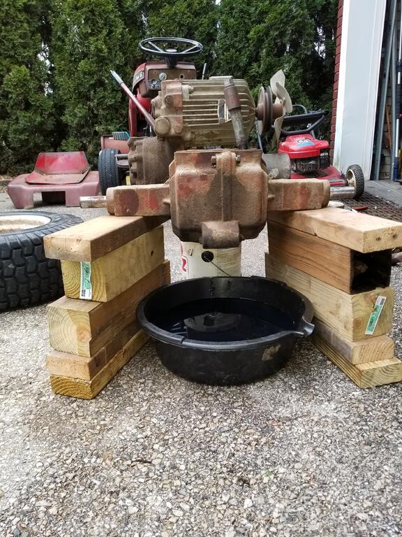

cafoose 3,862 #53 Posted April 14, 2021 (edited) 2 hours ago, stevasaurus said: Is that a ball bearing on that 11/44 toothed gear??? No ball bearings that I saw 2 hours ago, stevasaurus said: You are going to take the differential apart...right Didn't plan on it, it's working fine and I learned long ago to leave well enough alone. Based on how everything else looked inside I think it looks fine. I got the 876 apart and the oil is draining I even raised up the front and loosened the fill plug so it drains more efficiently. The roll pin came right out I used a small flat blade screwdriver with light taps after soaking it for five minutes Edited April 14, 2021 by cafoose 1 2 Share this post Link to post Share on other sites

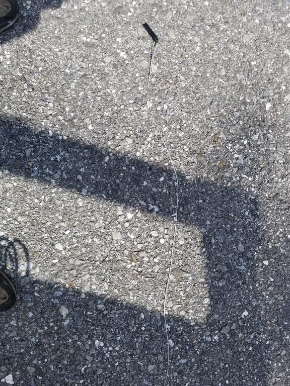

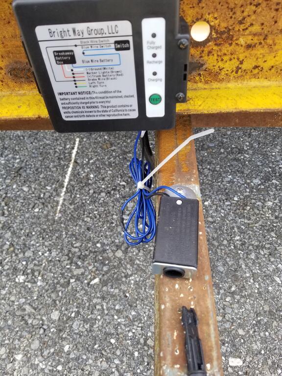

cafoose 3,862 #72 Posted April 16, 2021 I think I found what caused the problem. It was Sunday night after dark, I just unhooked my trailer from my truck after coming back from a long trip, I was tired, it started raining, I needed to put the trailer in it's tight parking space quickly so I could get some rest and out of the rain, I hooked up the 876 and started pulling the trailer, it stopped pulling, today I found this wire in the following picture where the 876 was hooked to the trailer, it's the emergency breakaway for the trailer brakes, I noticed when I moved the trailer with my truck an error light was on at the brake controller inside, I bet the brakes were applied on the trailer and the poor 876 couldn't pull it without breaking something! 6 Share this post Link to post Share on other sites
Ed Kennell 47,403 #73 Posted April 16, 2021 I'm still surprised she didn't spin or do a back flip. How much weight do you have on the trailer tongue? I back flipped my Commando 8 pulling my 6000 lb boat that had 400 lb on the tongue. It was pulling it out of the barn easily on the level blacktop until a back wheel on the trailer bumped a 2X4 block. The only thing that broke was my dignity.. Now I only use the front hitch to move heavy loads and I keep the trailer tongue wheel down for support. Like you said, you may have had some long term damage due to the bad hubs. 3 Share this post Link to post Share on other sites
