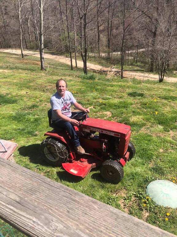

The Tuul Crib 7,354 #5 Posted April 6, 2021 (edited) T😎 Good lookin tractor! The motor oil l use is rotella 30w w T1 .The trans filter wix 1410 you can get at NAPA. Check the color of your trans fluid if it's Amber use 10W30 if it's pinkish color use ATF. Dex Merc you can also get at NAPA.Dont mix what is in the trans. Edited April 6, 2021 by The Tuul Crib 2 1 Share this post Link to post Share on other sites

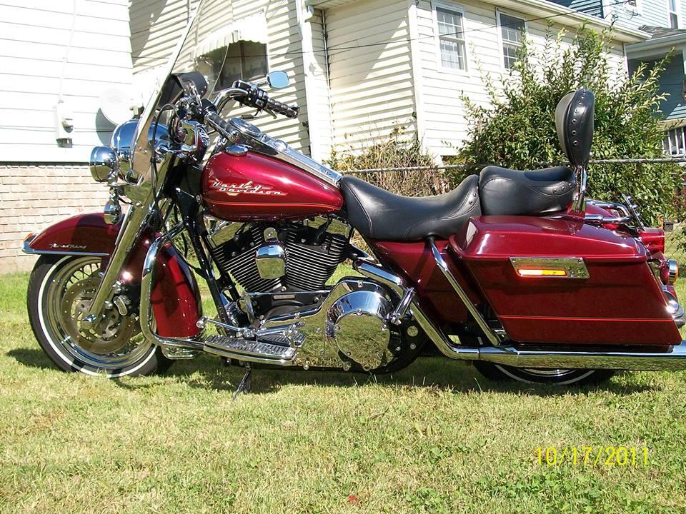

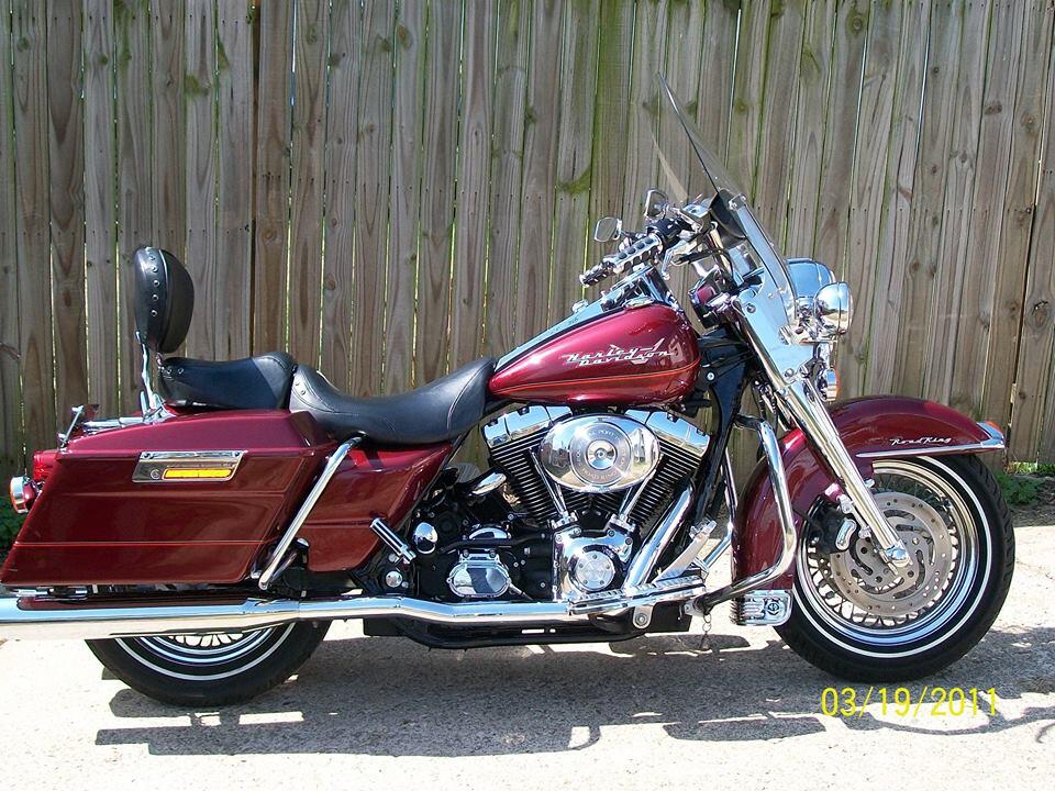

cat man 137 #21 Posted April 6, 2021 this is my last ride 02 harley road king 6 speed gear driven cams 1 2 1 Share this post Link to post Share on other sites
