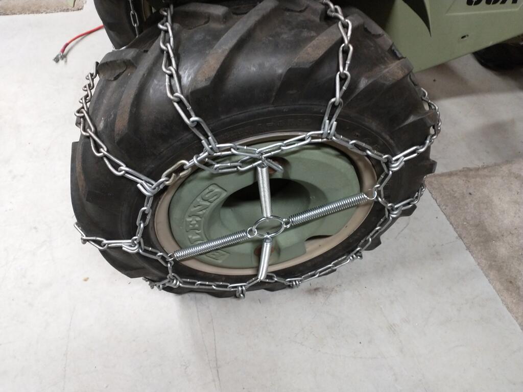

ebinmaine 80,974 #184 Posted January 13, 2022 BBT put the tire chain tensioners on... 1 3 1 Share this post Link to post Share on other sites

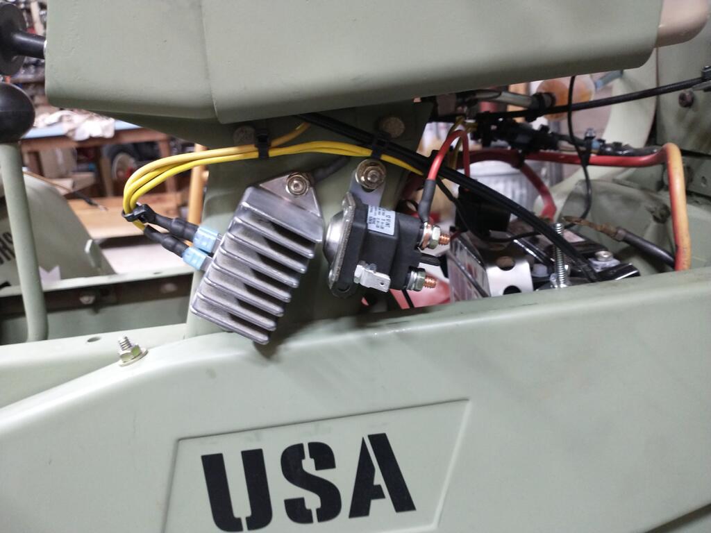

ebinmaine 80,974 #190 Posted January 16, 2022 Got the VR and starter solenoid mounted and wired. Swapped in a new positive cable. 2 4 Share this post Link to post Share on other sites
Maxwell-8 4,371 #191 Posted January 19, 2022 A very nice and clean install. 1 Share this post Link to post Share on other sites

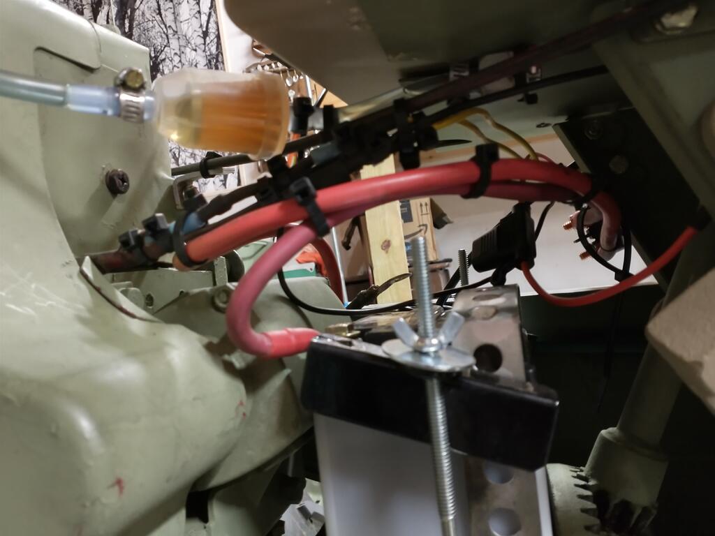

ebinmaine 80,974 #192 Posted January 19, 2022 4 minutes ago, Maxwell-8 said: A very nice and clean install. Thank you Sir. If you zoom in on this picture You'll see what appears to be an excess of zip ties holding things together. Some previous owner decided to cut or possibly pinch off one of the alternator wires and also the kill wire for the magneto. The kill wire I was able to shorten up and put a plug on which disconnects at that point and runs up to the ignition switch. The alternator wire I didn't want to mess up too badly... I had JUST enough wire to install a crimp connection with shrink tubing. Each of those has their own set of zip ties. Both alternator and one kill wire are all bundled, plugged in, and zip tied end to end so they won't come undone. Then there's everything holding the battery cables up out of the way and the other harness wires... It's kind of meticulous but I really don't want things coming undone in the middle of work. 1 1 Share this post Link to post Share on other sites

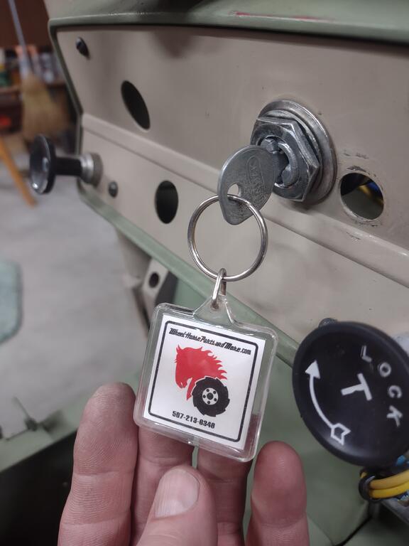

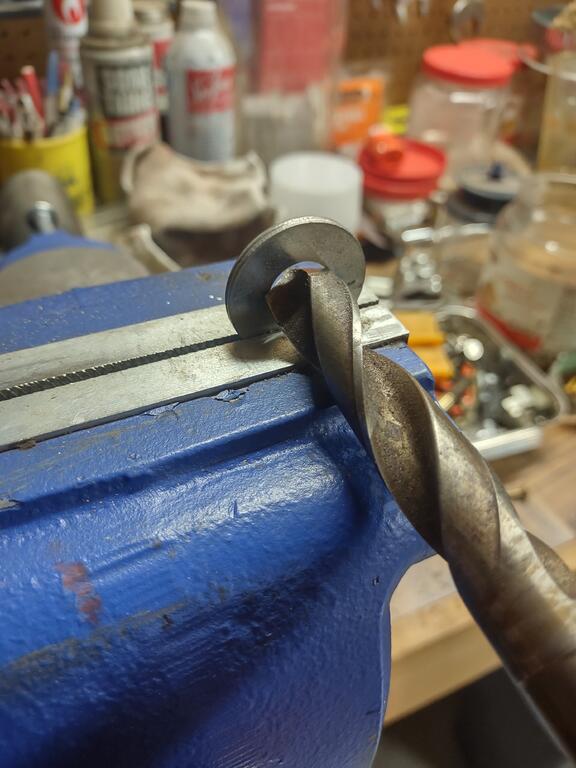

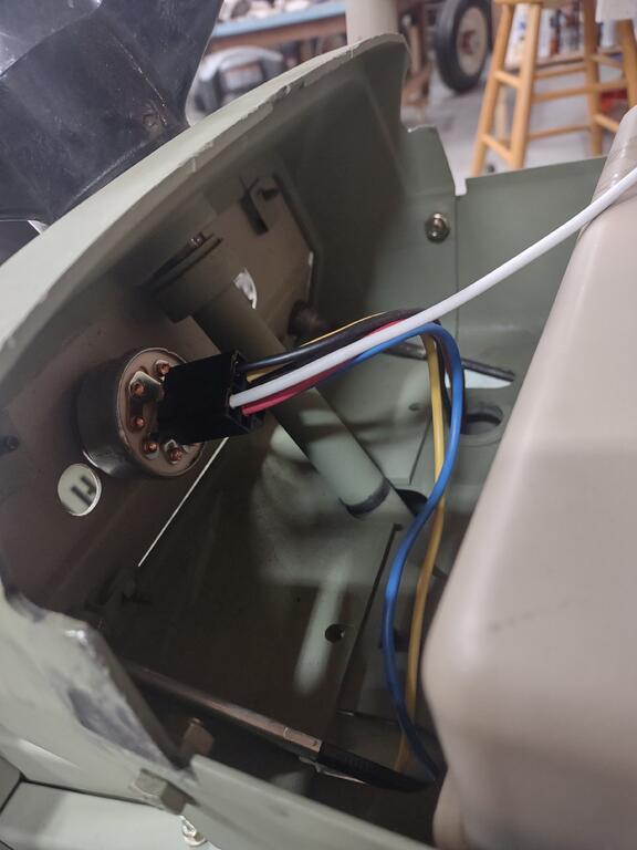

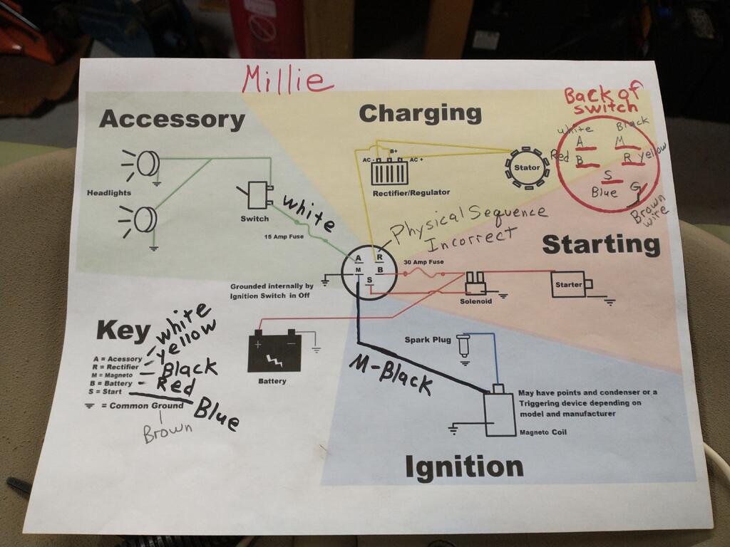

ebinmaine 80,974 #199 Posted January 21, 2022 I got an ignition switch from @76c12091520h Brian Badman. Because it's a change from OE and my custom wiring harness I modified the schematic diagram BBT had printed out for us the other day. Finished up the wire installation using a 5 prong replacement holder @953 nut had mentioned awhile back. One of the ingenious PO modifications was to drill the original switch hole way too big instead of finding the correct switch. I found a couple thin washers and drilled them out a bit so they would hold the new switch snugly. New switch is set right in nice and happy with a keychain from @wheelhorseman Lowell at Wheelhorse Parts and More. Last known thing to do is make up a wiring harness for some nice LED lights and mount those in pre-existing holes. 7 2 Share this post Link to post Share on other sites

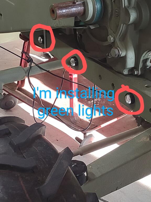

ebinmaine 80,974 #200 Posted January 22, 2022 Got the headlamps mounted and wired to a plug behind the hood. Been experimenting with attachment of very small wires today because I'm adding some frame hole mounted LED lights. Green 🟢 round 3/4" diameter. 1 Share this post Link to post Share on other sites
