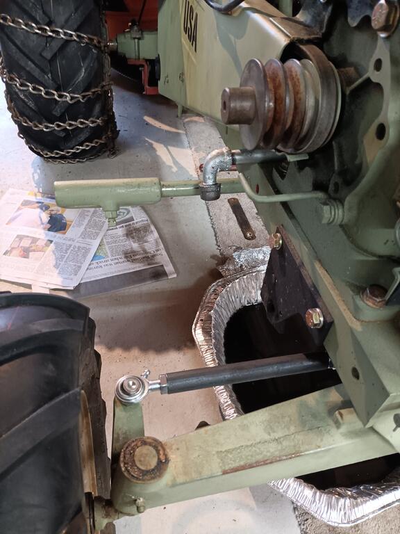

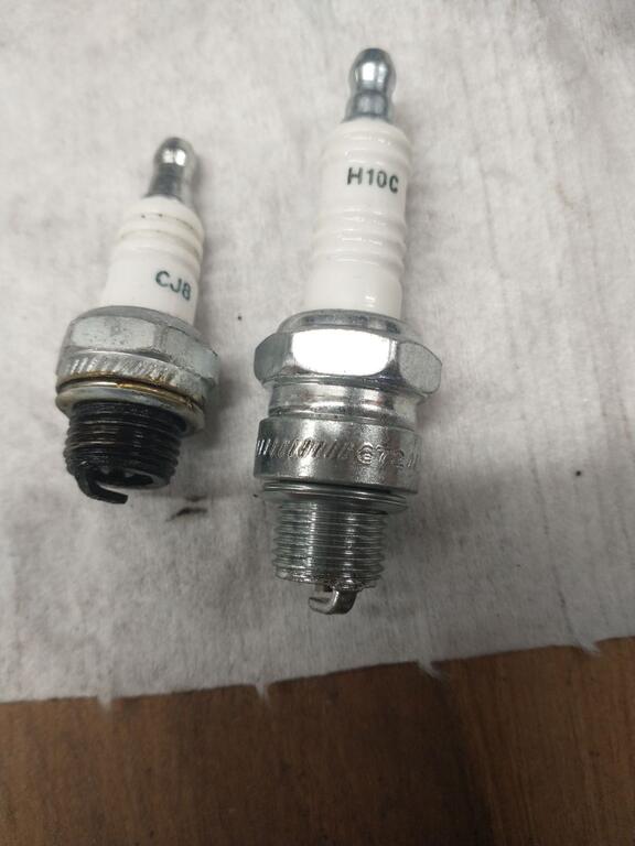

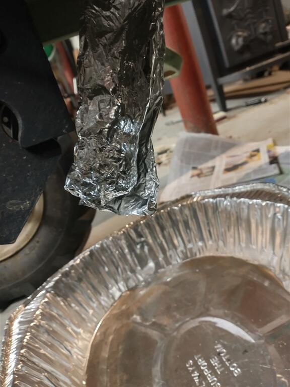

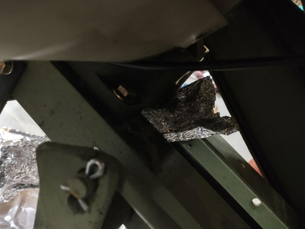

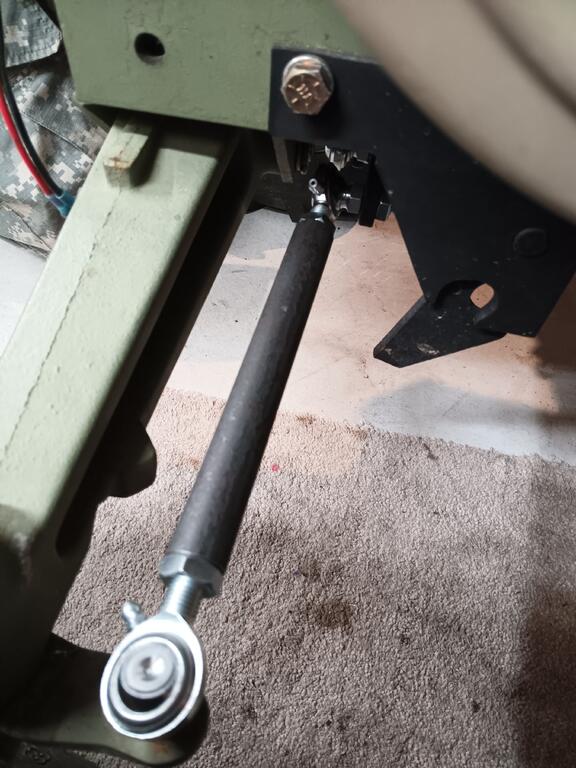

ebinmaine 80,974 #351 Posted January 23, 2024 Also got the no start condition assessed and repaired. Spark plug. Trina made and installed new super wicked heavy duty Heim Joint tie rods. She drilled out all four holes to 29/64 to accommodate the 7/16 studs. She also made up this super wicked incredible high tech oil director tool. 1 3 2 Share this post Link to post Share on other sites

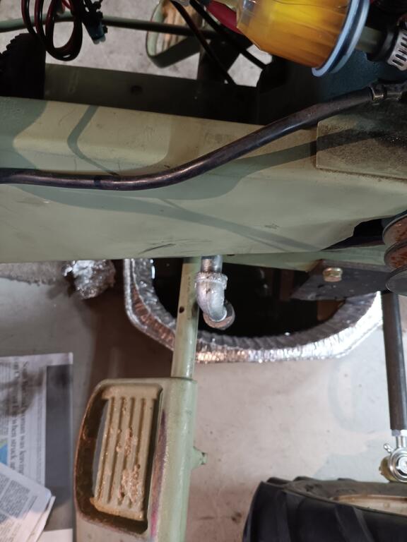

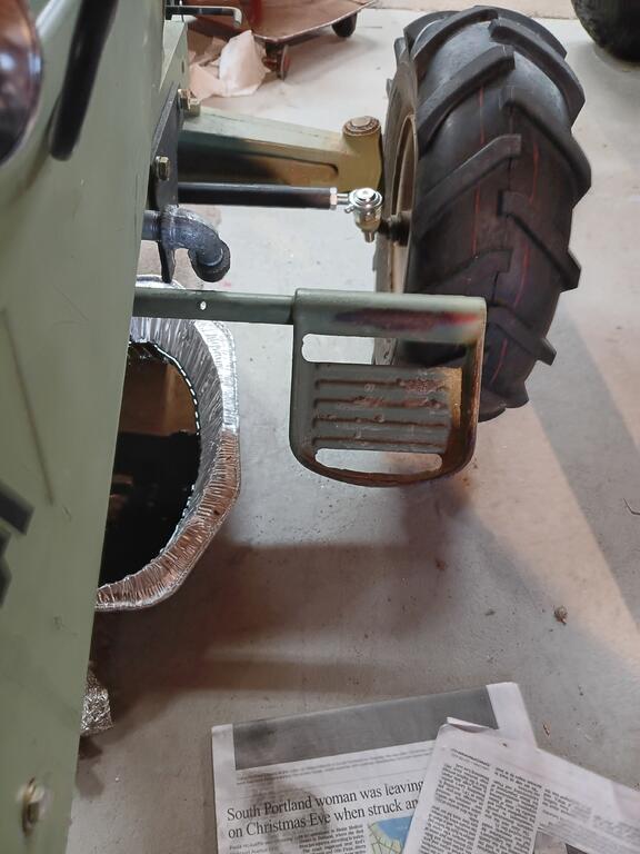

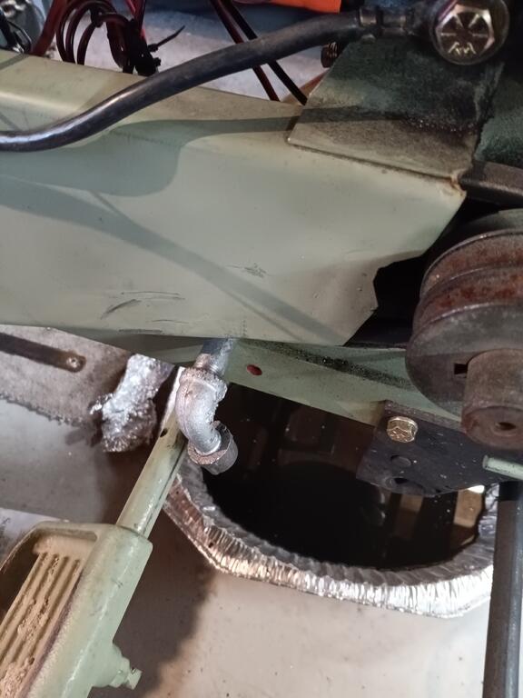

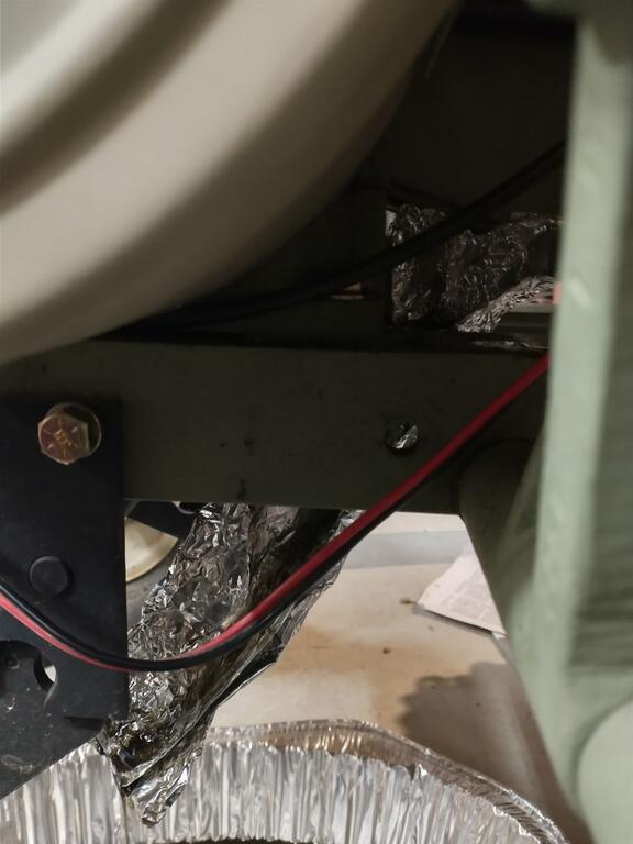

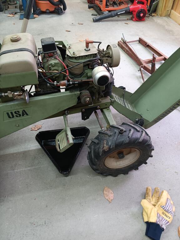

ebinmaine 80,974 #355 Posted January 25, 2024 I did get the proper ish engine oil drain pipe on. It exits the opposite side from normal but I'm limited to space here. If it doesn't clear the plow control I'll modify as needed. 1 2 Share this post Link to post Share on other sites

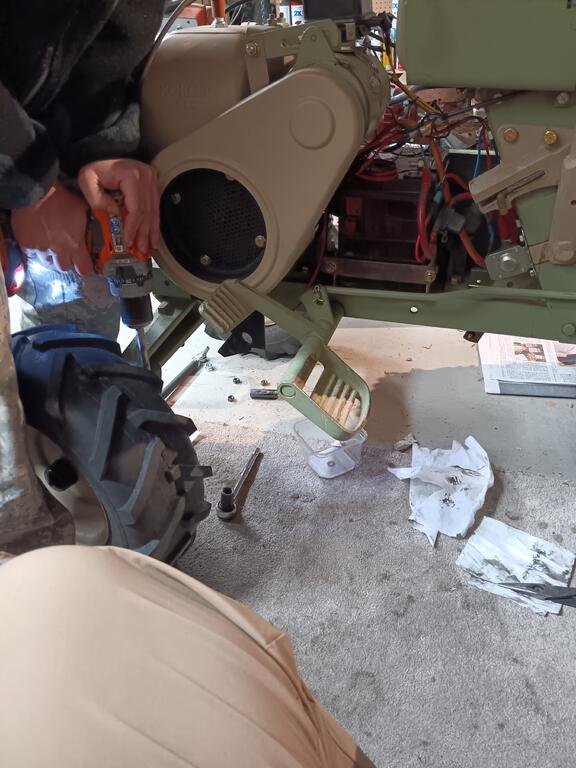

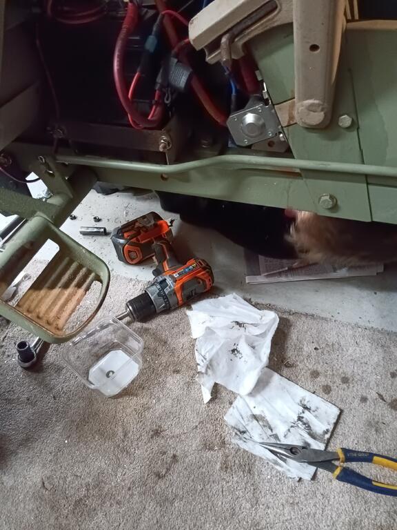

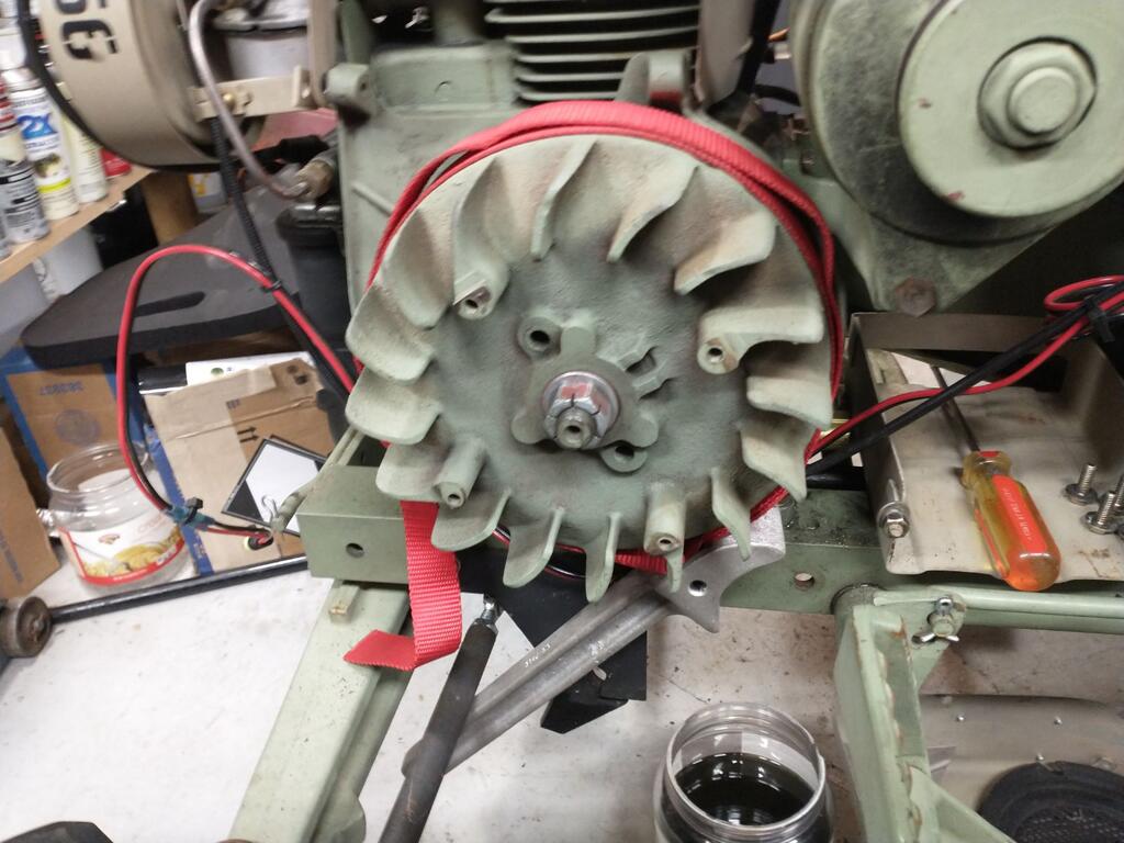

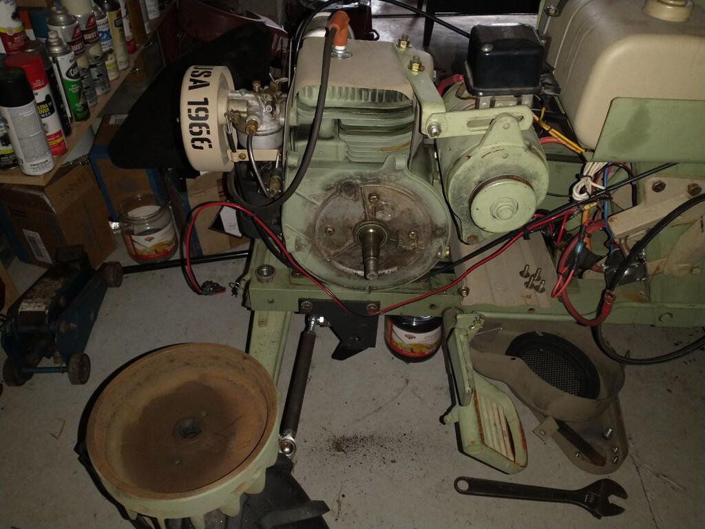

ebinmaine 80,974 #360 Posted April 7, 2024 On 1/31/2024 at 12:00 PM, ebinmaine said: We got the old girl out and plow hooked up the other day. Millie tractor was running fine. Trina started to move snow and got one pass before the engine made a noise and stopped. I'm hoping it has a sheared flywheel key. Several weeks ago we took a quick look at the engine. With of us were thinking and hoping that the flywheel key was the culprit. This morning Trina removed whatever was needed to get the flywheel off. We have the rare but undesirable two piece flywheel key. While in there I noticed that the 4 bolts holding the engine half around the crankshaft were loose. 2 were leaking. We found some new Grade 8 bolts, installed them, and torqued to spec. We'll pop in a crankshaft seal on that end before reassembly. 3 Share this post Link to post Share on other sites

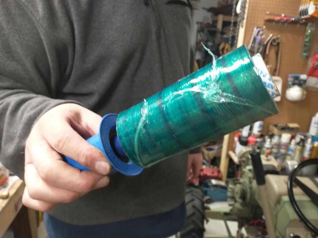

ebinmaine 80,974 #361 Posted April 8, 2024 This should look familiar. Do you know what this is? It might look like shrink wrap on a roll but in reality that is not true. This is a small block Kohler crankshaft seal driver. Got the flywheel cleaned out. It wasn't bad. Just a little dusty really. Hand wire brushed the threads. Oiled them too. Installed the nut and torqued it to 90 ft lbs. 3 Share this post Link to post Share on other sites
Tractorhead 9,217 #362 Posted April 8, 2024 Great to hear it was just the flywheel key. it shouldbe happen, that you take a closer look on the loosen screws. That confirms my Statement once more: „nothing is for less, it allway’s have its reason.“ 👍 1 Share this post Link to post Share on other sites

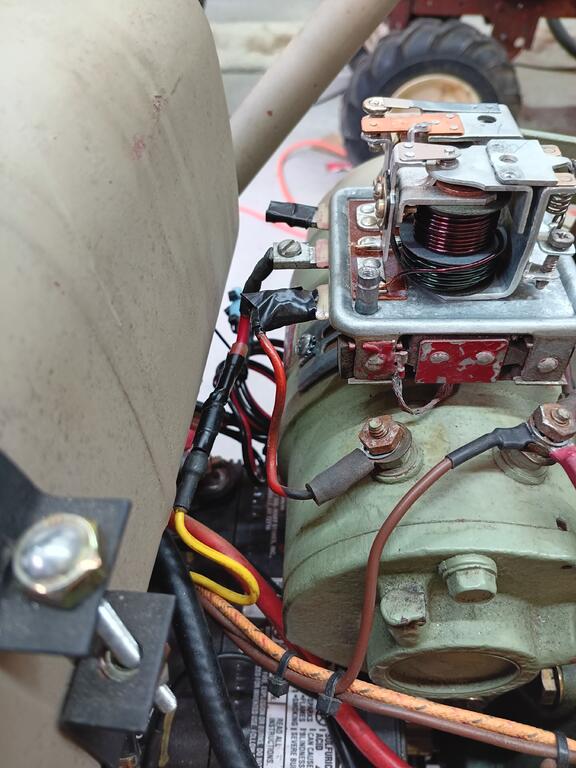

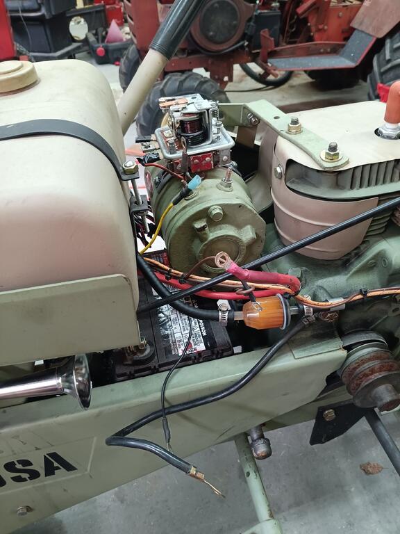

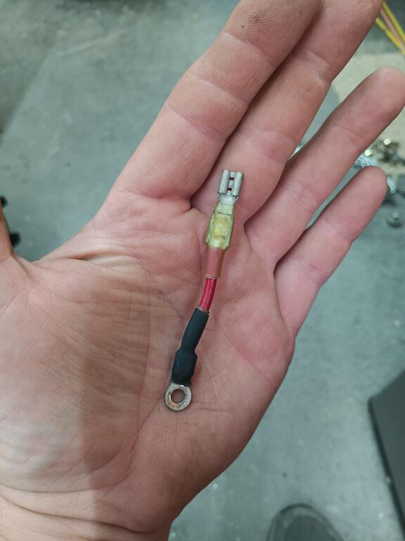

ebinmaine 80,974 #364 Posted August 24, 2024 I could use a little help with a diagnosis on the electrical system. This tractor runs and drives fine but isn't charging the battery. Can you folks give me some initial points to check and where to go from there? @squonk @953 nut @pfrederi Share this post Link to post Share on other sites
squonk 48,231 #365 Posted August 24, 2024 Make sure the little wire from the bottom of the regulator to the genny " A " terminal didn't fall off or burn. 1 Share this post Link to post Share on other sites
953 nut 69,839 #366 Posted August 24, 2024 I don't remember where I copied this from years ago but it is a good starting point for testing the charging portion of a S/G unit. Troubleshooting Charging: 1. With the engine running more than half throttle, measure the voltage at the A terminal, it should be 13 to 14.5 volts. If it is 12.5 or less, ground the F terminal, if the voltage goes up to 13 to 14.5, most likely the problem is the regulator. Other possibilities are the wire from the F terminal to the voltage regulator, and the ground on the regulator not being good. If the voltage at the A terminal is 14.5 to 17 volts when you ground the F terminal, the regulator cut-out section is probably not connecting the A terminal to the battery. If the unit is measuring 13 to 14.5 volts at the A [without an external ground applied to the F terminal] terminal, the voltage measured at the battery should be within .1 or.2 volts of the voltage measured at the A terminal, if it is the system is working correctly. 1 Share this post Link to post Share on other sites
ebinmaine 80,974 #367 Posted August 26, 2024 I did some reading. I did some learning. I did some checking. I did some testing. I did some cleaning. Been fiddlin' around with Millie a lot of the day. The S/G is "starting" and "generating" separately from the voltage regulator. The VR ground is good. It appears all wiring is OK. I disconnected the dash light to retest making sure the fault wasn't in the lamp somehow. I pulled the regulator from Trina's 857. They test DIFFERENT across the resistance. I can't honestly say I knew what the readings meant but one of them had a 78 to 80 and the other one had a 4... something. One of the YouTube channels said that the max was about six to seven and it was the higher one that was in the tractor. So I finished cleaning up the one from the 857 and put that in. Success!! After just a couple minutes at full throttle the battery had gone from 12.2 or 12.3 up to 12.8 ish. The charge light on the dash is out. I'm gonna call that a win for now. Only thing I had to change in the wiring was make this little jumper cable. I wrapped it right up on both ends and I'm hoping it'll be all right. Should be. 4 Share this post Link to post Share on other sites
ebinmaine 80,974 #368 Posted November 3, 2024 After changing the VR back in August the BBT ran the tractor about for a few weeks. Then the battery went dead... I had checked the output at 12.5 to 12.8 volts back then. I found an old thread about adjusting the mechanical regulator. Now it's putting out a nice healthy 13.8 to 13.9. 3 Share this post Link to post Share on other sites
Handy Don 17,571 #369 Posted November 4, 2024 22 hours ago, ebinmaine said: Now it's putting out a nice healthy 13.8 to 13.9. Sensitive little fellows to adjust, though, aren’t they! 1 Share this post Link to post Share on other sites
ebinmaine 80,974 #370 Posted November 5, 2024 23 hours ago, Handy Don said: Sensitive little fellows to adjust, though, aren’t they! I read the stuff. I looked at the things. I twisted that sucker MAYBE 3/8 of a turn. Went from 12.2, 12.3 all the way to 16!!! So I backed it down most of what I turned it and it seems pretty happy there. Share this post Link to post Share on other sites
Handy Don 17,571 #371 Posted November 5, 2024 12 minutes ago, ebinmaine said: I twisted that sucker MAYBE 3/8 of a turn. Went from 12.2, 12.3 all the way to 16!!! So I backed it down most of what I turned it and it seems pretty happy there. Yep. I did the same, thinking what would ¼ turn do? From 12.1 (the battery voltage at the time) up to 17 (and a little hit on the governor!) Yikes! Like you, in the end probably only a few degrees from the original setting. I also learned that it must be allowed to “settle” in the new adjustment through a few slow idle-to-WOT-to-idle cycles over a few minutes to be sure of the setting. 1 Share this post Link to post Share on other sites

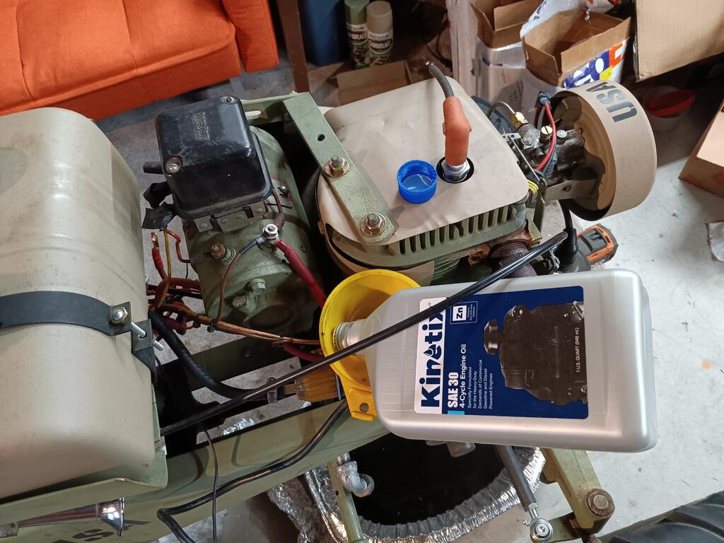

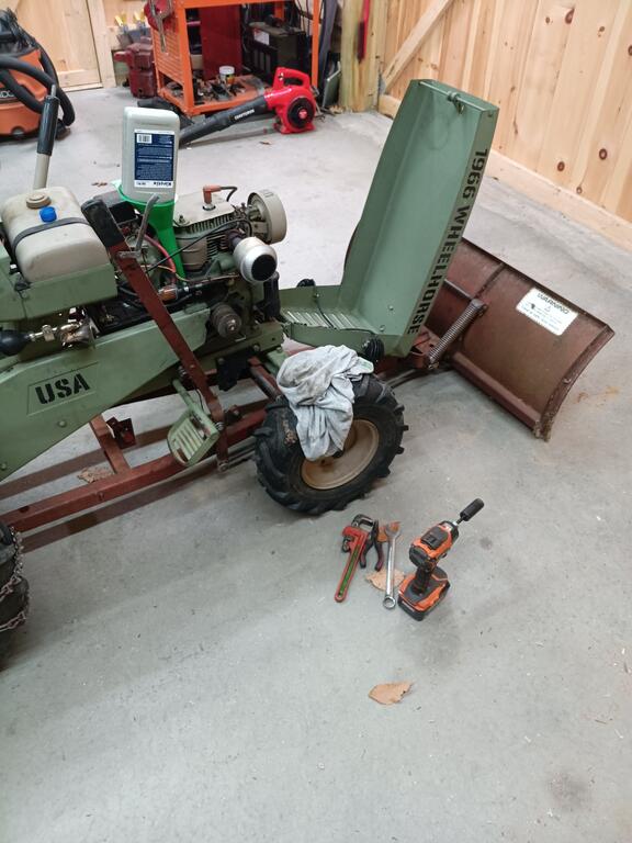

ebinmaine 80,974 #372 Posted December 1, 2025 Millie has been called up to Active Duty for snow removal this year. 25/26. Today I changed the engine oil and installed the snow plow. 5 Share this post Link to post Share on other sites
