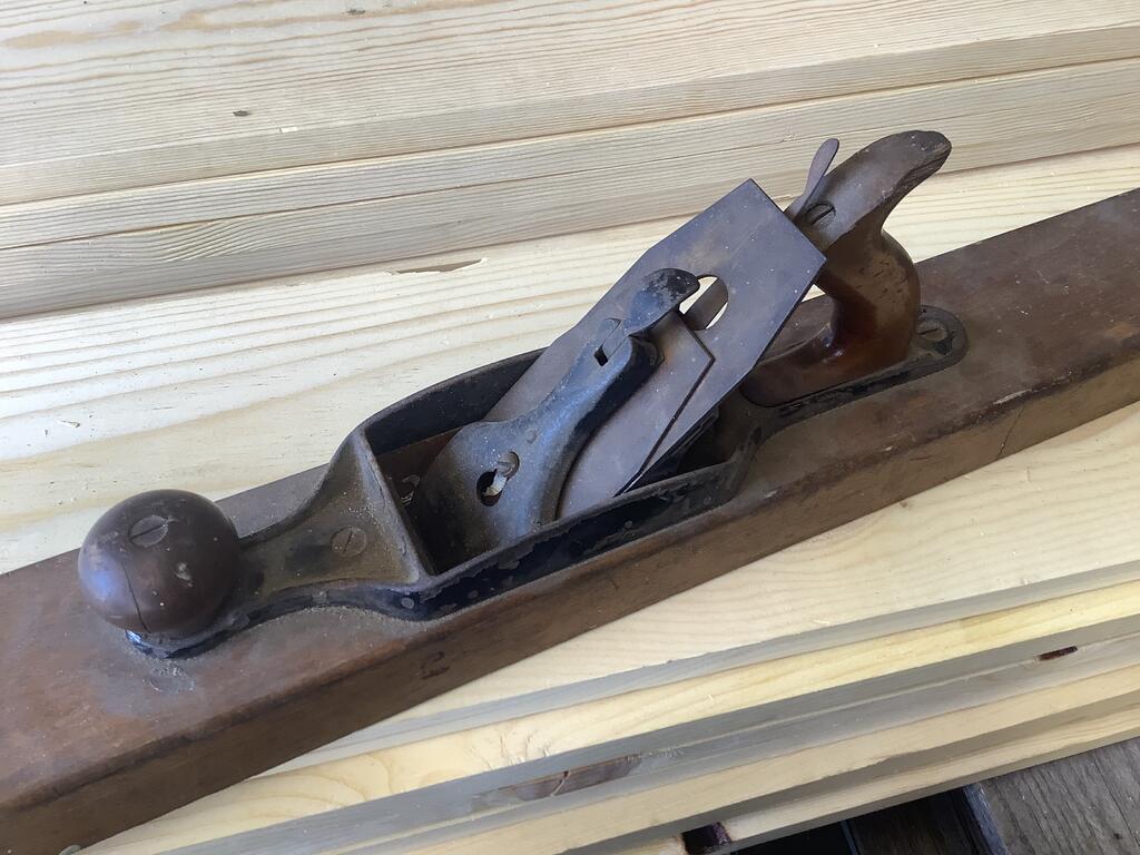

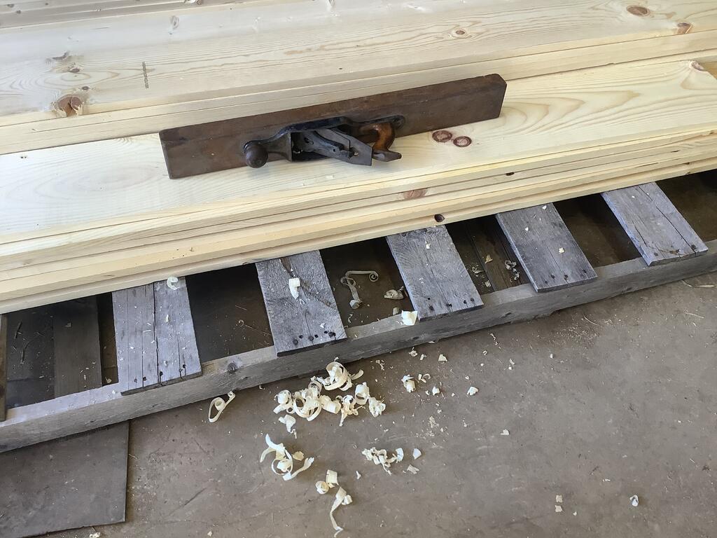

Pullstart 70,695 #1 Posted March 2, 2021 I don’t see any identification marks on this plane, but I honed it with my flat plate and some 600 grit. It’s adjusted to barely take wood and is working. I don’t know if I’m right or wrong... I’m only massaging the edges to take up less gap before glue and clamping. @formariz @The Tuul Crib 8 4 Share this post Link to post Share on other sites

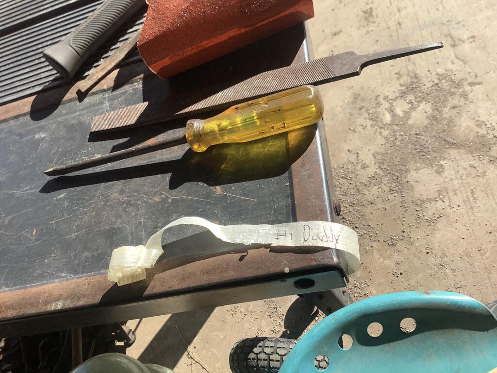

Pullstart 70,695 #2 Posted March 2, 2021 Rylee got new paper out of the deal. 4 8 Share this post Link to post Share on other sites

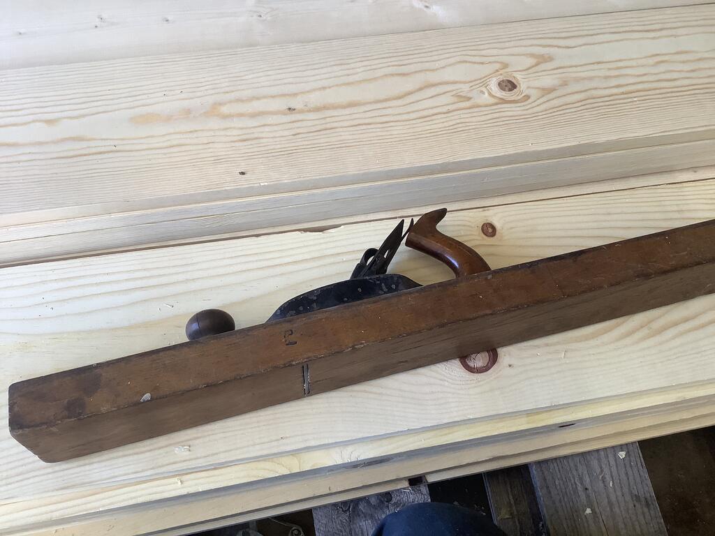

formariz 12,379 #5 Posted March 2, 2021 (edited) Markings on that plane are in the front end grain. Cutter should also be marked at top. It is either a Stanley 28 or a 29. It is called a transitional plane. What it means is that it was the ones that started making the transition of wood planes to metal. It combines the advantage of a wood plane along with the ease of adjustment of a metal plane. Yours is a Foreplane which was the one between a Jack and a Jointer. That is a great plane, in my opinion that type of plane is perhaps the best type there is once one considers all of its advantages over others and how well balanced they are. If your intention is to smooth the face of those boards, although you can use it, but it is the wrong plane. It is too long. It will ride over the low spots and cut the high ones. That plane is really intended to straighten a board (on face) or straighten the edge of board. If you use it to smooth faces of board make sure you have that board on a very straight table along length of board or it will drive you nuts by just cutting at ends or center of board. Seems that you are using it to straighten board edges to glue them together. You have then the right plane. Start at end putting pressure on front of plane. as plane is fully on board adjust pressure so it is even on front and back of plane. As you exit on other end put the pressure on the back of plane only. Once plane takes a continuous shaving from beginning to end , board should be relatively straight. Hardest part is to keep edge square. Takes lots of practice so don't be discouraged. Most woodworkers today cannot do that by hand with such a tool. Not that they would not be capable, but they just never learned or had enough practice. Trick to having a good joint on those boards is to also have board slightly hollow in middles so edges touch with no clamping pressure. You may be better off gluing two boards each time if you never did that before. It is less of a panic. Clamp also a straight edge across face of boards to keep them straight that way. Again, don't get discouraged or frustrated. You are doing something that few carpenters are able to do properly. I will make a short video so you can refer to it and post it in a little bit. Edited March 2, 2021 by formariz 5 3 1 Share this post Link to post Share on other sites

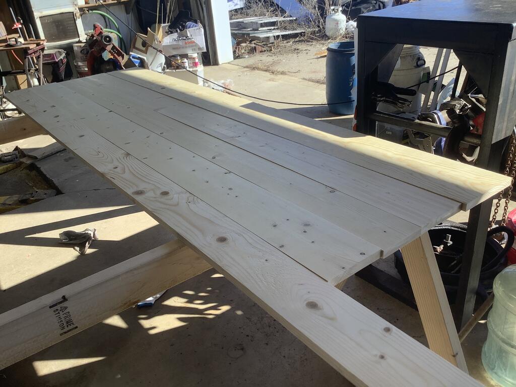

formariz 12,379 #23 Posted March 3, 2021 56 minutes ago, pullstart said: Wow, thanks for so much to soak up, y’all! I am building barn doors for closets, doorways, etc for my house and a customer’s project as well. I was surely thinking of doing two glue ups per door, then joining the halves together. I’ll make sure my growth rings are alternating and there will be some decorative/supportive second layers too. Good project. This is the last one I built. It was a bit bigger at 6x8 1 1 Share this post Link to post Share on other sites
