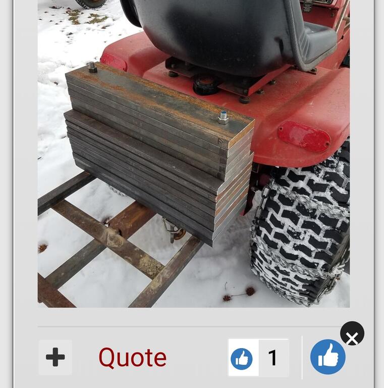

moe1965 774 #1 Posted February 13, 2021 I was just wondering how much these rear ends can handle . I have heard more is better but I don't want to crack the cast rear end with to much. I have 300 lbs stacked on the back and I think the wheel weights are 25 ea. I use the tractor primarily for snow blowing. Am I overkill with the weight. Thanks I advance 5 2 Share this post Link to post Share on other sites
squonk 45,492 #2 Posted February 13, 2021 You got the weight close to the axle centerline. That's good. Too much farther out will not only stress the trans and frame,but take weight off the front for steering. I run loaded tires and wheel weights. 5 Share this post Link to post Share on other sites

AMC RULES 37,254 #4 Posted February 13, 2021 Now that's a cool stack! 7 Share this post Link to post Share on other sites

ebinmaine 77,309 #7 Posted February 13, 2021 4 minutes ago, Lee1977 said: I also have my receiver hitch braced down to the transmission hitch so the axle housing doesn't support all the weight. That would be a good safeguard. Spread the forces around. I have a hitch that bolts front to back around the square of the axle. No other supports currently. I've pulled some rugged loads out the forest. No issues. Nice pile o steel there. Share this post Link to post Share on other sites
moe1965 774 #8 Posted February 14, 2021 (edited) Lee1977 I like your added support to the trans hitch better than my bolt that I have touching the lower hitch for some weight transfer off the axle I think I have a project for tomorrow. Edited February 14, 2021 by moe1965 Share this post Link to post Share on other sites

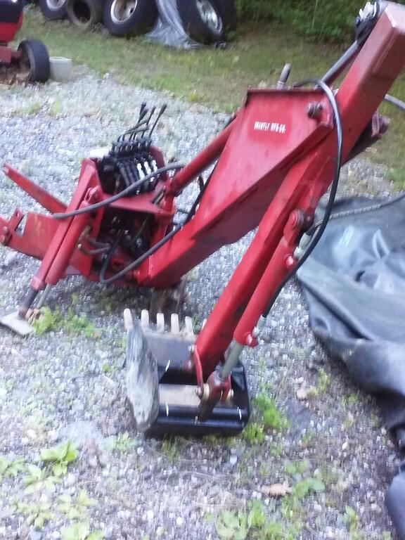

roadapples 6,987 #14 Posted February 14, 2021 Don't know what this weights, but I couldn't pick it up with the loader before it was installed. But I could pick up my 2 stage blower and carry it. I think the blower is about 380lbs... 3 3 2 Share this post Link to post Share on other sites

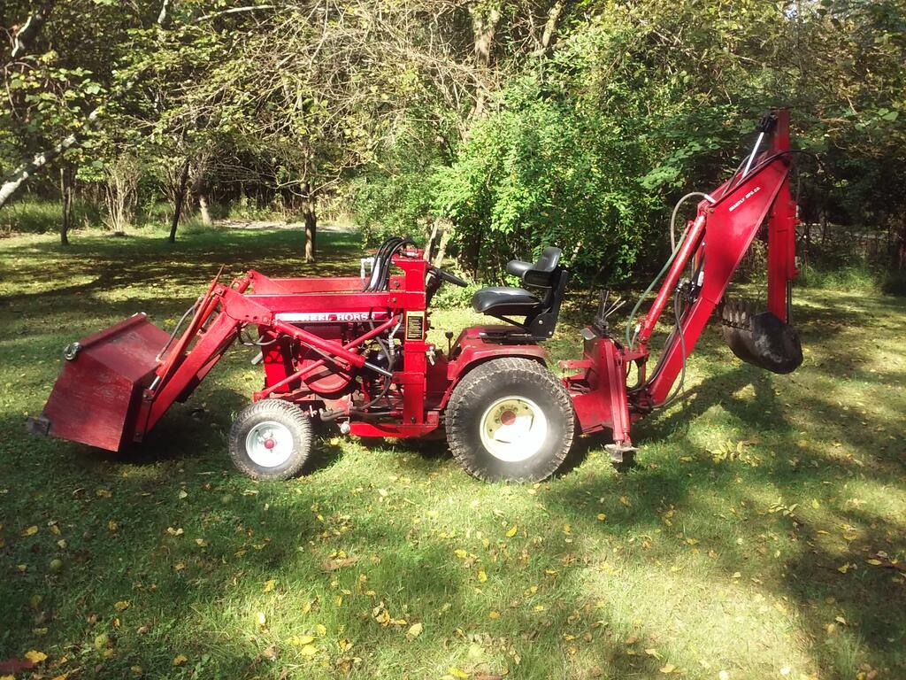

Skipper 1,790 #16 Posted February 14, 2021 Ok, so I should obviously have said IMO. Sorry. I regularly have 600+ lbs hanging on mine, + a heavier engine and front weights to hold it down. Also have somewhere about 1000lbs in the wheels. When it is heaviest, it weighs in at 1.25 ton. I would estimate 1.1 ton on the rear axle + driver. That all needs to bump around, and be stopped and started + the added traction of all that weight. + the added stress from running wildly oversized wheels. All good so far. If the trannies were prone to cracking, I would think we would have heard a lot more cases of it, especially if you take into consideration what they are put thru all the time. Roughly same setup on heavier D series, tractors with backhoes and FEL. Puller tractors. heavy things dangling in 3 pt. hitches. Blades and graders, mounted directly to the tranny arms, and slammed into something. And a whole host of other ways to beat the crap out of these little machines. So no, I'm sorry, but I do not buy it. 300lbs extra load, if mounted right, will in all likelihood be of no concern. IMO that is, so take it with a grain of salt. But, of cause it matters how you attach the weight to your machine. Also one could imagine that a tranny could have a one in a million week spot from the forging process, making it crack. So the best option when ever you can, is of cause to let the frame work take the load............... 5 2 1 Share this post Link to post Share on other sites
Maxwell-8 4,370 #17 Posted February 14, 2021 5 minutes ago, Skipper said: Ok, so I should obviously have said IMO. Sorry. I regularly have 600+ lbs hanging on mine, + a heavier engine and front weights to hold it down. Also have somewhere about 1000lbs in the wheels. When it is heaviest, it weighs in at 1.25 ton. I would estimate 1.1 ton on the rear axle + driver. That all needs to bump around, and be stopped and started + the added traction of all that weight. + the added stress from running wildly oversized wheels. All good so far. If the trannies were prone to cracking, I would think we would have heard a lot more cases of it, especially if you take into consideration what they are put thru all the time. Roughly same setup on heavier D series, tractors with backhoes and FEL. Puller tractors. heavy things dangling in 3 pt. hitches. Blades and graders, mounted directly to the tranny arms, and slammed into something. And a whole host of other ways to beat the crap out of these little machines. So no, I'm sorry, but I do not buy it. 300lbs extra load, if mounted right, will in all likelihood be of no concern. IMO that is, so take it with a grain of salt. But, of cause it matters how you attach the weight to your machine. Also one could imagine that a tranny could have a one in a million week spot from the forging process, making it crack. So the best option when ever you can, is of cause to let the frame work take the load............... Those trannys are just beast! 3 1 Share this post Link to post Share on other sites

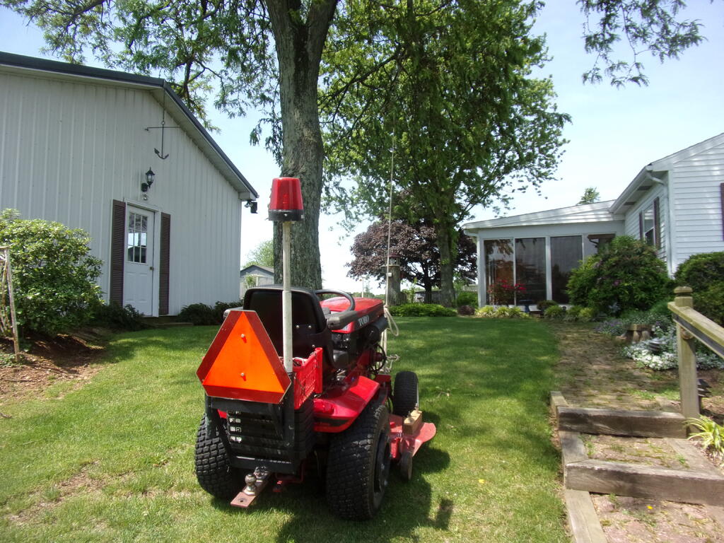

Ed Kennell 44,845 #18 Posted February 14, 2021 Never a problem with mine. 3 Share this post Link to post Share on other sites
JoeM 9,606 #19 Posted February 14, 2021 (edited) @Ed Kennell I dig that light. I thought about putting one on after the goofball neighbor just about ran me over plowing the drive. Are those tires 9.50's on the back? Edited February 14, 2021 by JoeM Share this post Link to post Share on other sites
Ed Kennell 44,845 #20 Posted February 14, 2021 1 hour ago, JoeM said: Are those tires 9.50's on the back? Yep, 23X9.5 6ply Deestones. 1 1 Share this post Link to post Share on other sites
