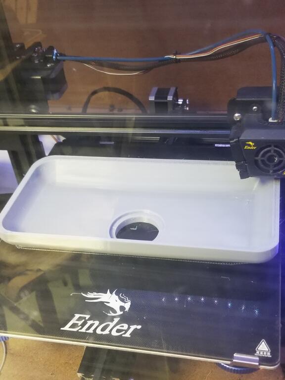

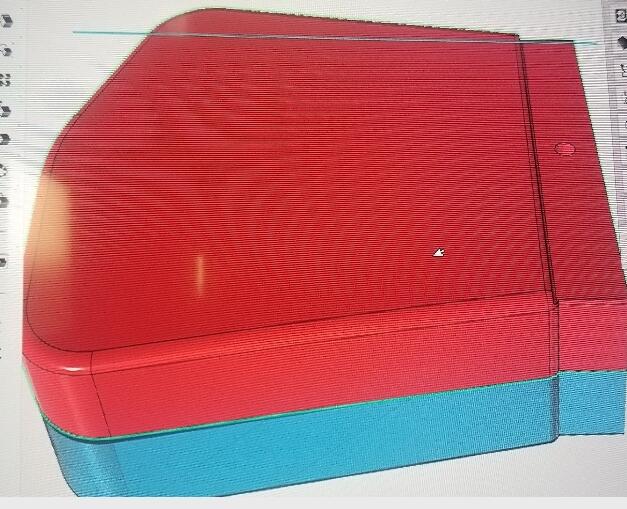

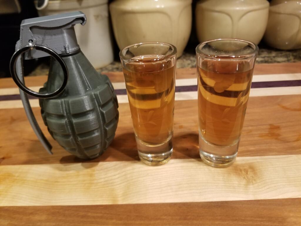

5 hours ago, 8ntruck said:
Just out of curiosity, have you filled the bottom half of the tank with water to check for leaks?
This was a few years back, but a couple of the younger engineers at work made a print with maybe 20% infill.  When it was done, they mixed up some resin and poured it into an opening they had left in the print.  There were enough leaks that they had a had a real mess on their hands, and table, and floor......
I did do a shot glass once at about 40 percent infill and regular walls and it did leak. Did it again at 100 percent and extra walls and it worked fine. Also the M2 pineapple grenade flask is 100 percent and extra walls and is water tight.

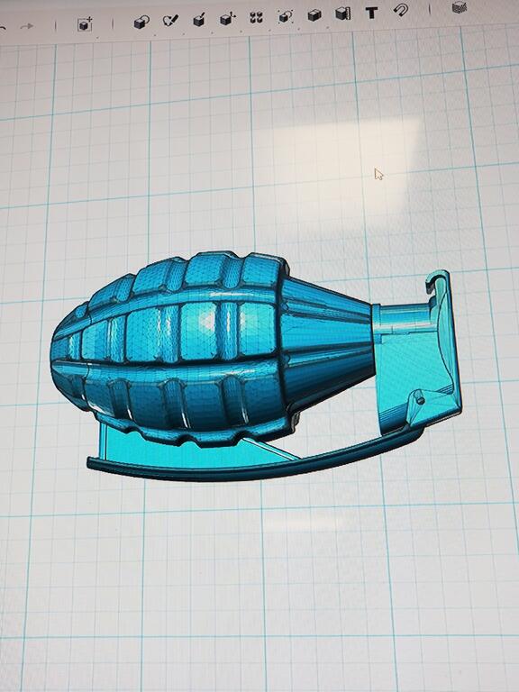

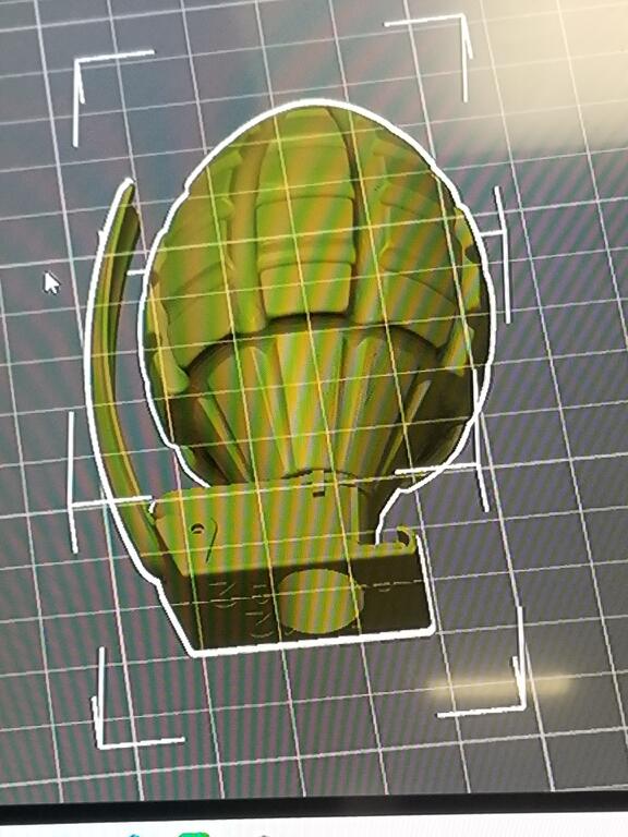

Is there a way to add  little filler spot(s) between the thin handle and main body?
That's the part that was delicate.
ebinmaine
Just now, Wheel Horse 3D said:
This one is saved at the scale we did. I think it was 75% of original grenade size.
That sounds about right
Wheel Horse 3D
Do we need to modify in any way? Add handle support?
Wheel Horse 3D
Lol jinx! Lemme add a ridge to support the handle.
  • Thanks 1
ebinmaine
I'd say we should.
Durability should be better even though physical accuracy won't be quite on.
Wheel Horse 3D
2 minutes ago, ebinmaine said:
I'd say we should.
That looks good.
Can you please make a couple when you get a chance and ship em out?
Lemme know the price.....
Wheel Horse 3D
I have to run some grenades here in a day or 2 so I'll run a couple if these for ya at the same time.

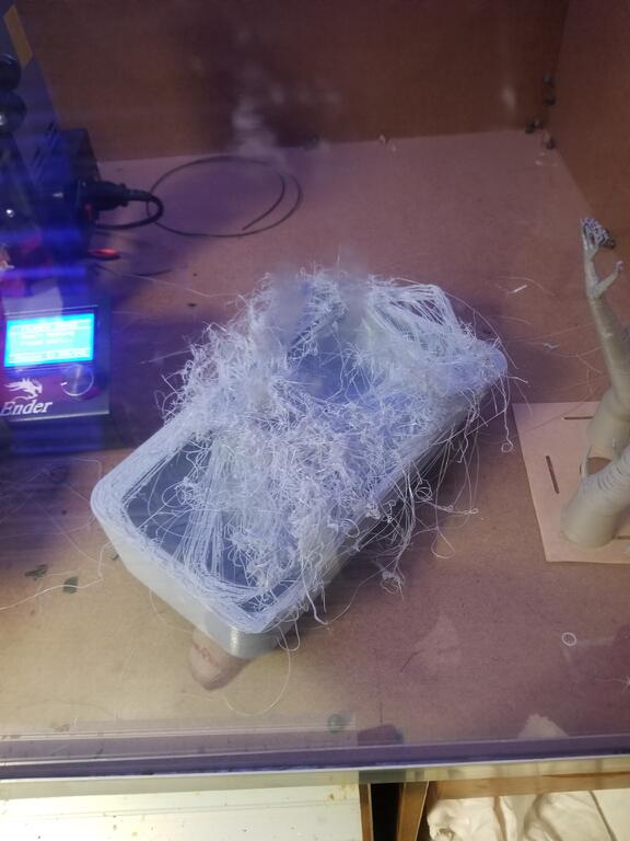

Wheel Horse 3D
Oh yeah.. great fun going in here!
  • Sad 2
ebinmaine
Uh oh
Handy Don
Add “custom bird nests” to your list of offerings? :unsure:

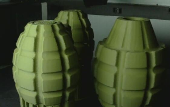

On 12/11/2023 at 8:00 AM, ebinmaine said:
You still got the program handy for the shifters we got for Millie?
Almost done! Loving this new matte OD green.

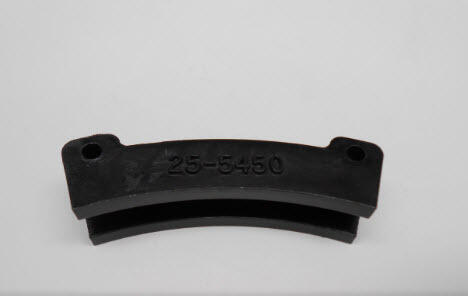

How about some of these for a Tall Chute Snow Blower Part #25-5450 Retainer-Chute It Takes 3 of these,
Edited by HorseFixer
Wheel Horse 3D
I dont see why not! Anybody have a busted one for a model???? We could even make them a little thicker and heavier depending on the failure point.
