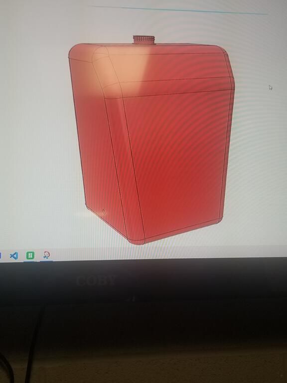

Sorry one of the pictures was blurry so I edited it :hide:
Wheel Horse 3D
4 hours ago, cafoose said:
Man i think that would have to be at least a 4 part deal with the printers I have. Biggest dimension I have is about 11.75
cafoose
If you think it's doable and it will work I'd say go for it :banana-wrench:
Wheel Horse 3D
Is there any dimension under 12"?
If that's the case, I could make stackable rings. If not it will have to be quartered at least.

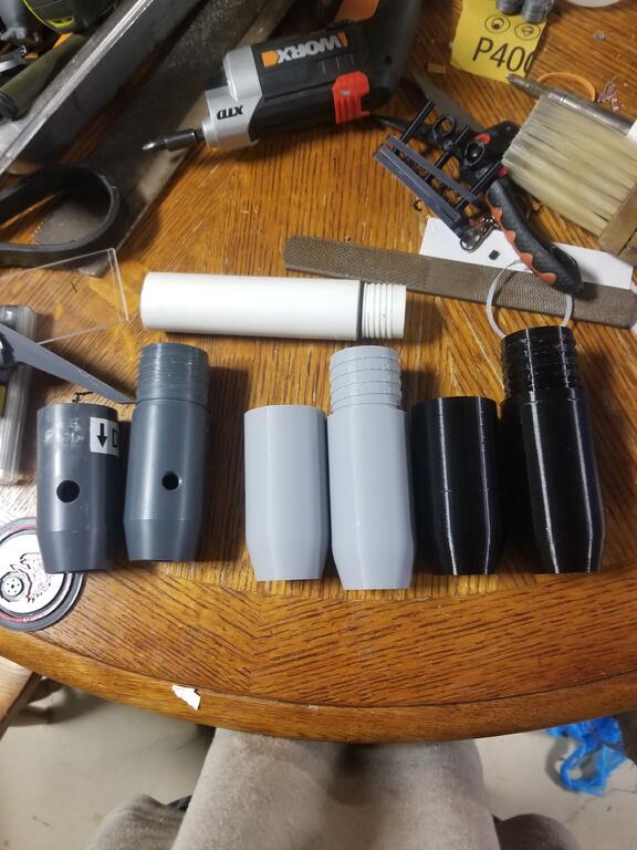

Just finished up this project! Pretty proud of it. 4tpi well pipe to 8tpi well pipe adapters. Original on the left, draft center, and final done in a higher temp chemical resistant filament at full density. Thread design worked out well with a couple drafts to get the female sizing just right.

I asked Grey if he could 3D me some specialty pipe adapter parts. They are not available off the shelf.
He took on the challenge with doing the threaded parts and knocked them out very quickly. Impressive and done at a fair price.

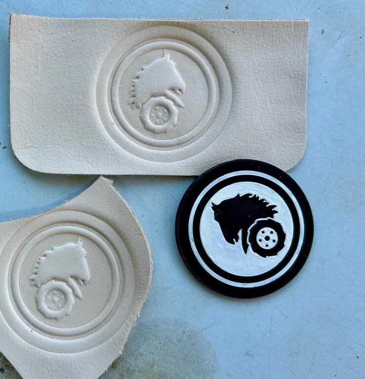

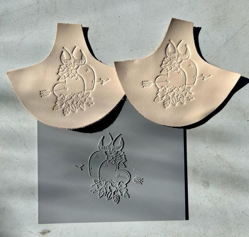

Another use for the printers!.....custom leather embossing! Just a quick test on the click press...some really interesting stuff

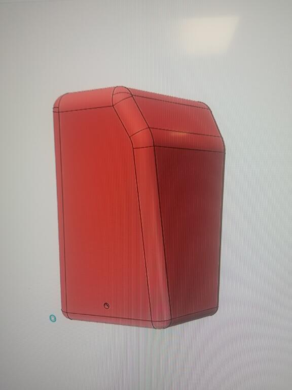

Preliminary GT14 gas tank model!

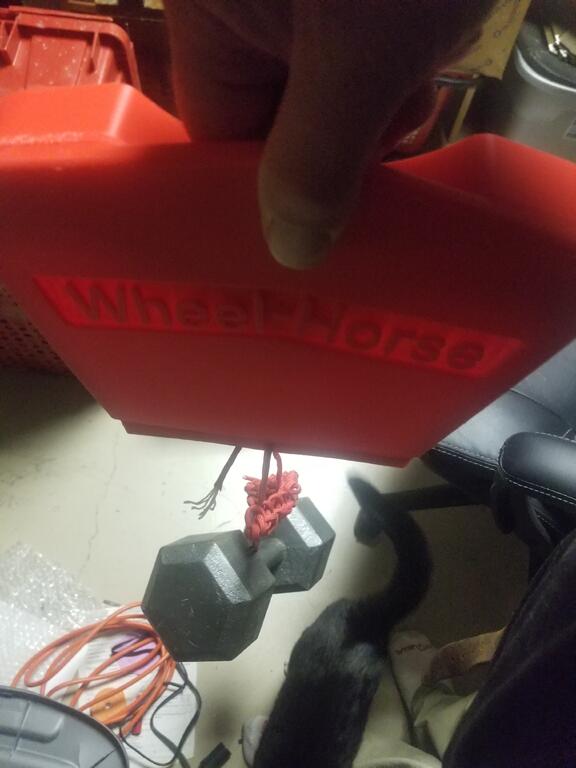

Confirmed tombstone handle on one half of the heavy duty version can handle at least 25 lbs!

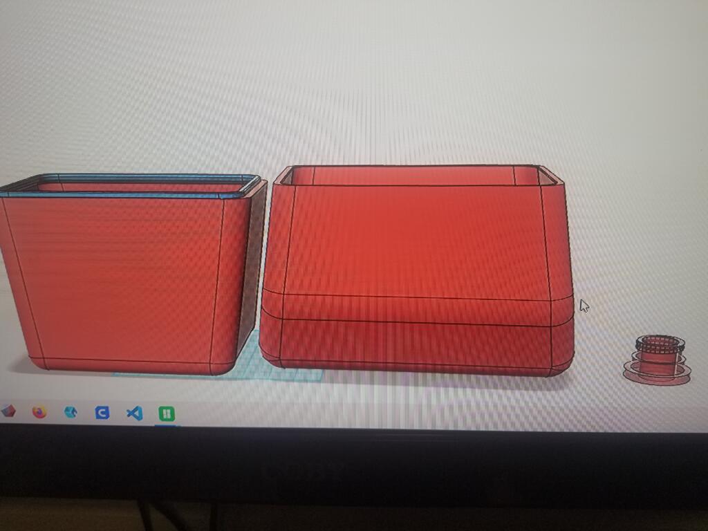

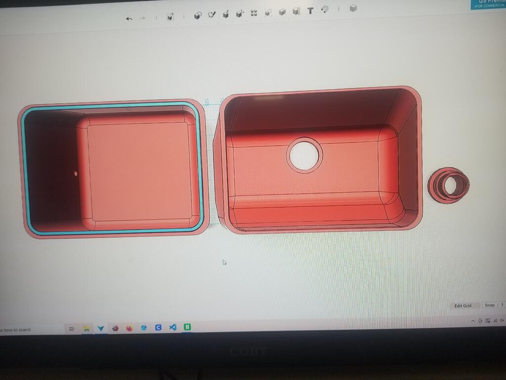

Tank parts split up for print.
Wheel Horse 3D
Each half will be 4 DAYS of printing and 1.5 spools of filament! Gonna have to find some inexpensive filament to keep cost down.

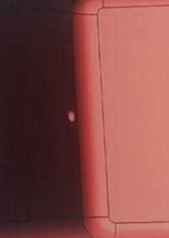

On the GT14 gas tank are you printing them with the original bottom outlet nipple, or are you putting a heavy boss at the bottom for a rubber gas bushing ?
Wheel Horse 3D

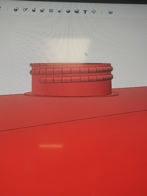

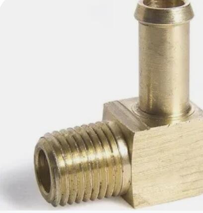

If ya look closely, there's an outlet right hand bottom. I was figuring ya could tap and insert a brass fitting, perhaps a 90 degree 3/8 or 1/4 NPT hose barb?
Edited by Wheel Horse 3D
Wheel Horse 3D
The tanks will still have some DIY to do.
Epoxy and seal the 2 halves together, maybe do a coat of gas tank sealer, and add your outlet fitting.
Next to do is design the cap and be sure to incorporate the vent hole.
