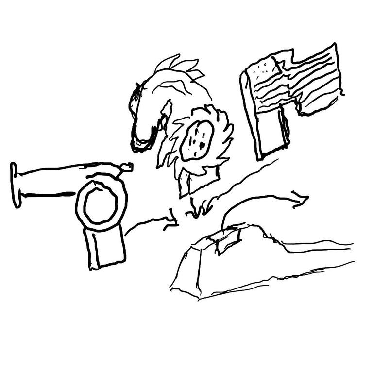

K new plan....The new and improved SWAP-A-THEME hood ornament!

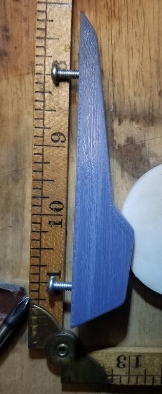

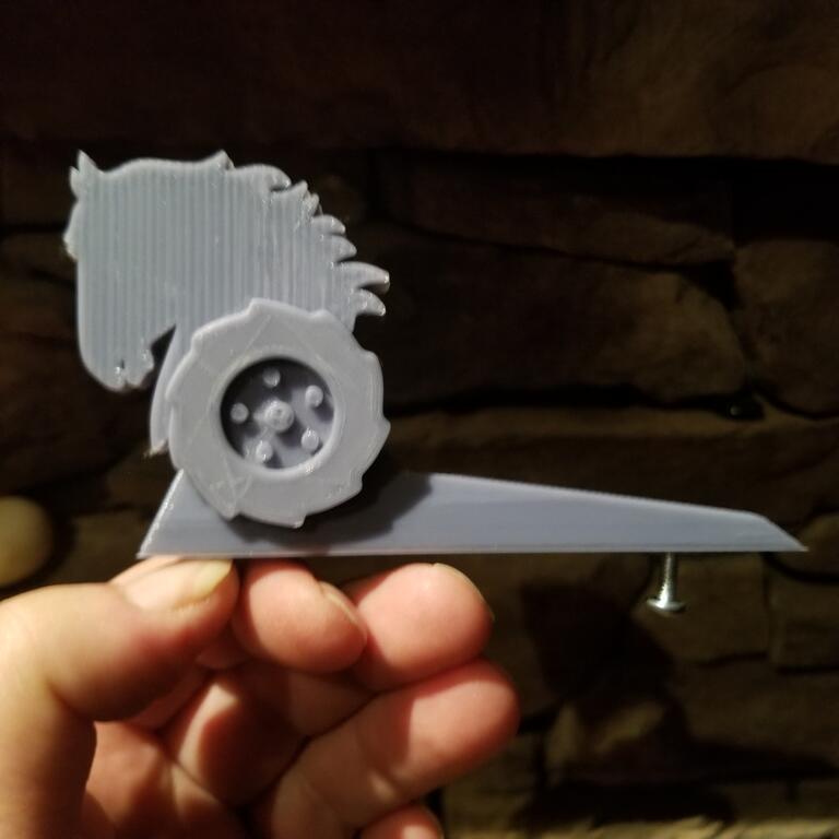

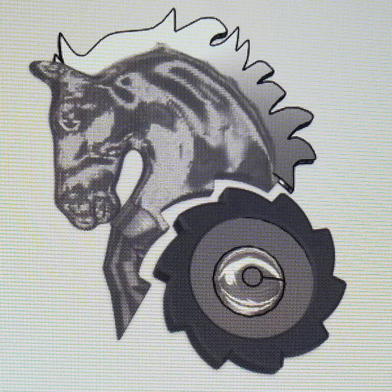

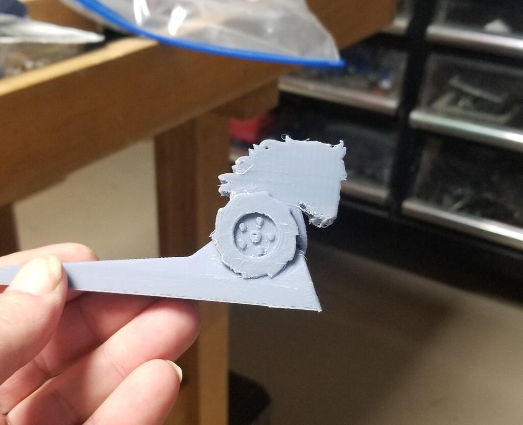

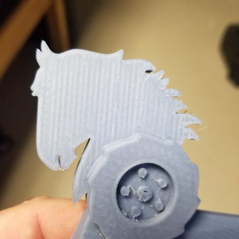

As detail keeps getting lost when printing the head,(note the nose and parts of the mane no matter the supports i put inplace, im gonna have to print that horizontally in 2 halves.
However printing the base in two halves brings problems with the screw pockets as that would put them on seam, so the base will be printed just like the original style, i like how the original feels, looks, so it has to stay vertical.
So well have a standard keyway that you can either insert a cover that hides the keyway, or swap in whatever topper you need for the occasion.(4th of july, a one finger message, 2nd amendment, military insignia, etc. Etc.
Secured by a simple screw through the base.
So ill be running the headlight frame print while i go back to the drawing board.

Example of better horizontal detail
  • Like 4

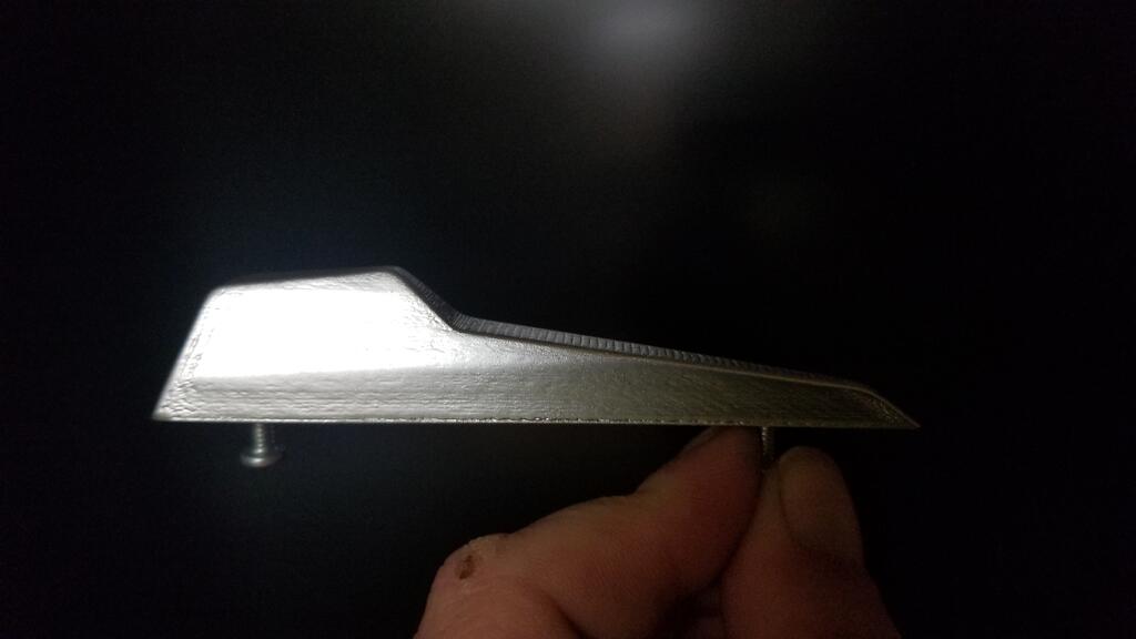

On 2/7/2021 at 9:49 AM, Wheel Horse 3D said:
I'm pretty pleased how these came out, but you can definitely see the need for a little spray filling primer to completely remove the layer lines. Used duplicolor color match chrome.
  • Like 1

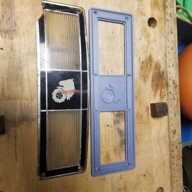

Wheel Horse 3D
Almost there! Still a little tweaking on the outer frame, then to work on the lenses once i get some clear filament.
  • Like 6

953 nut
Could those lines be sanded and polished out?
  • Like 1
Wheel Horse 3D
I did a quick hand sand on that with 150 then 300 and the final finish is very smooth to the touch, but just a couple light coats of filling primer should really be easier, and I should do primer anyway for the absolute best finish then go on to 600 grit. Those layers are about .005 inch or 0.15mm(about the thickness of a piece of paper) they then get acetone smoothed and then sanded, so what you see there is even less than that,
Its really amazing how small of a detail you can feel, then how much smaller of a detail you can see.
Edited by Wheel Horse 3D
  • Like 2

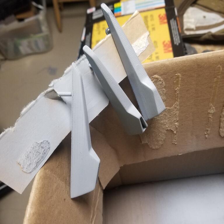

2nd primer coat drying.
Nothin quite like watchin paint dry!
