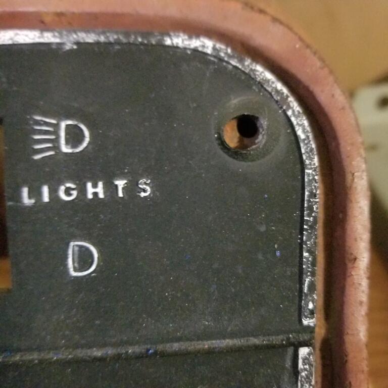

What about hole sizes and text sizes?
Any chance you got a scale factor hidden somewhere between your cad model, the slicer, and the printer?
Wheel Horse 3D
The holes, size, and edges all  line up with the dash I modeled from.
I do all adjustments, scaling etc. In the cad program and leave all others 100 percent or 1:1.
You are indeed correct that rounding errors can creep in from each time something is scaled or adjusted(usually around the nearest 1 hundredth or so). That's why I like to do all adjustments in the original cad model. If I need to double the size for one print or something like that I'll do it in the slicer, but all my master cad files are where I create and make all permanent adjustments.

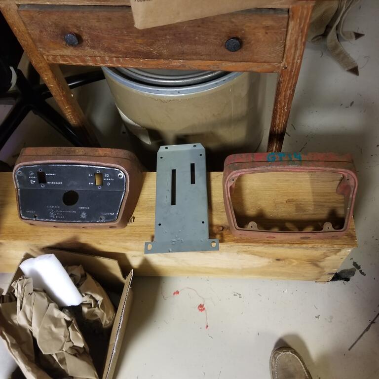

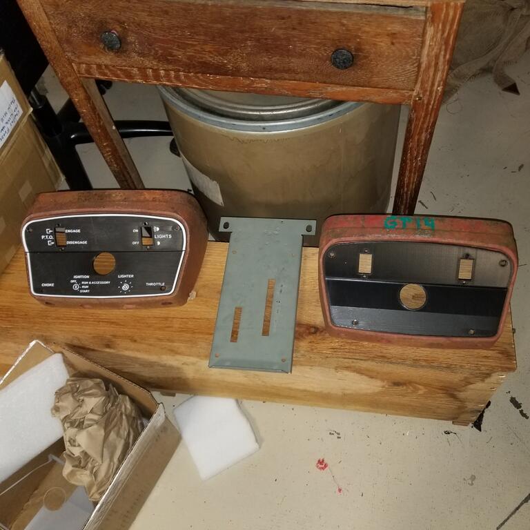

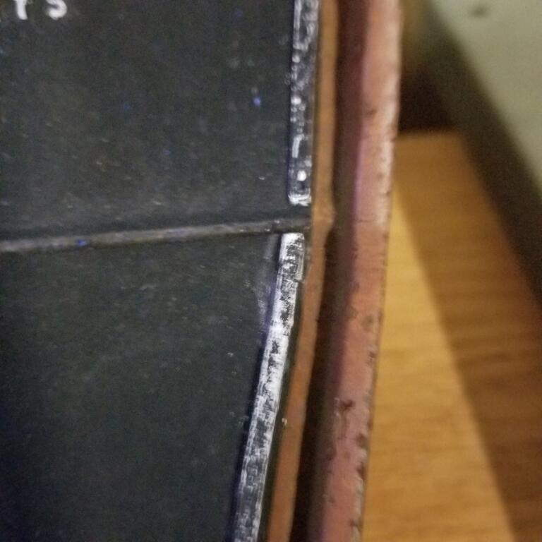

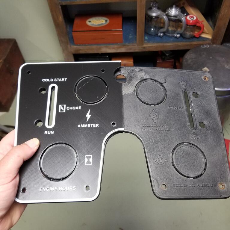

New GT14 dash printing! I checked the new dash sent to me and I believe it may have been beginning to shrink. It's about 5mm short side to side, and if you align the holes on one side, the ones on the opposite side are crowded. Maybe a tension builds up and then once released they snap inward like a rubber band?
The shrinkage seems in direct relation to the length in each axis.(the ratio of length to height is identical to the ratio of the amount short on each side!) Looking at the existing holes in this example dash tension has been pulling against the outside edges of the holes. The console plate showed similar shrinkage ratios.

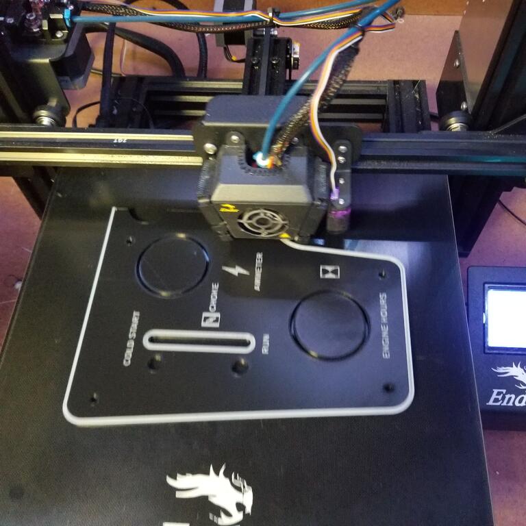

Almost done!

So very close! One corner was a little too tight, and the finish wasn't where I like it, so I trimmed a tiny bit and made a couple setting adjustments, and were printing again!

Small 4mm adjustment of the lower mounting holes.

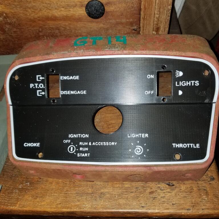

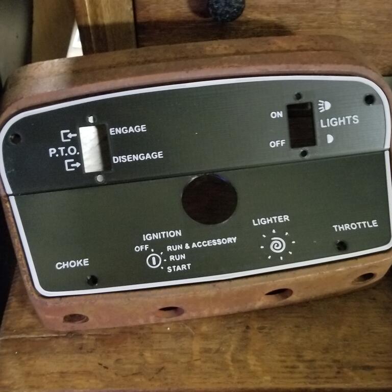

Wheel Horse 3D

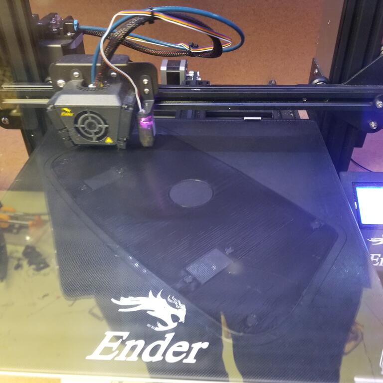

Text is printing on hopefully final version if GT14 dash..have new pic here in a bit!

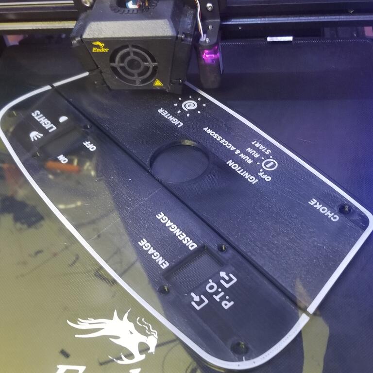

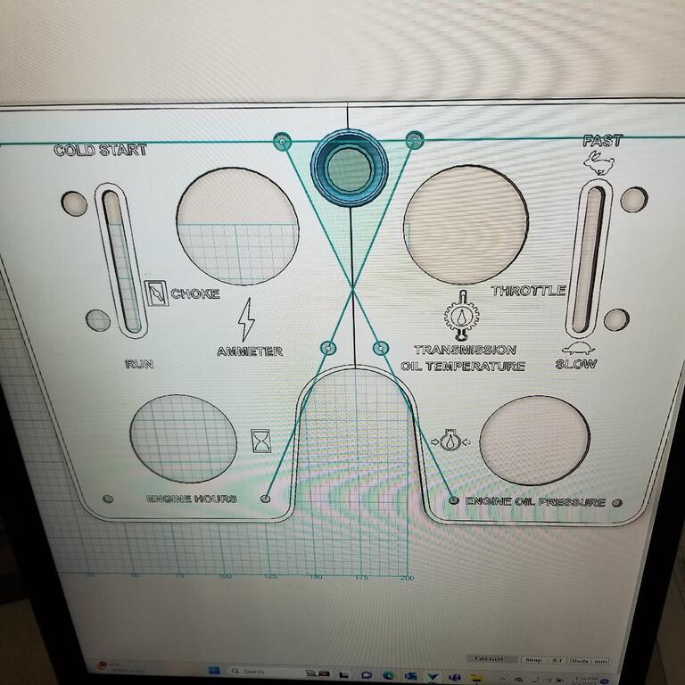

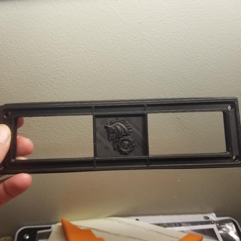

D dash is next! Re-engineered with a purposeful split in the middle to alleviate the splitting issue. Two additional mount holes in either side as shown in the layout. A custom lamp washer that gives a clean look, captures both halves, and allows the lamp to not have to go through an additional thickness. New cutout design for gauge holes that leave top surface completely smooth, but allows you to go in from the back and cut easily through and equip whichever gauge holes you need!

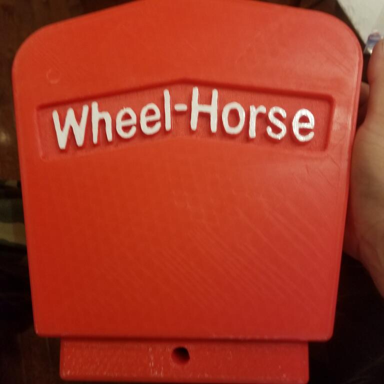

20230518_212251.jpgfull 4mm thick with just over 1mm raised lettering.

Need a small adjustment to lower holes on console. By tomorrow night we should be ready to list both in the store!

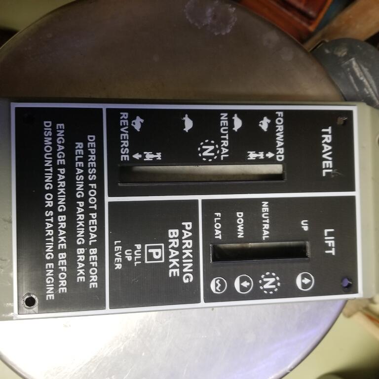

Final version of shifter console plate! Puttin packages together for @buckrancher and @cafoose!

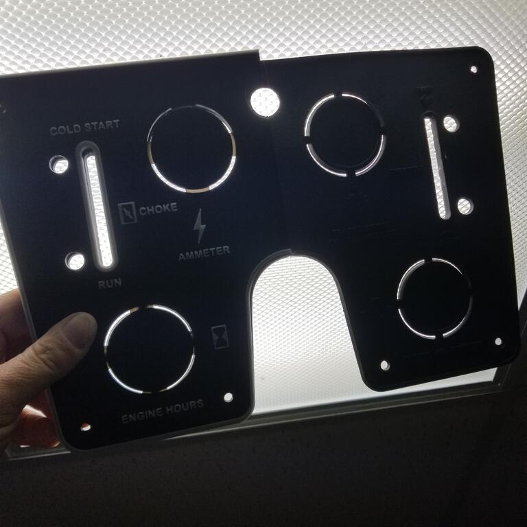

Left half of D dash!
And a custom tombstone ....container??? Canteen???Flask??? Maybe mini bar set!!!!???
  • Like 1
Wheel Horse 3D
Alignment looks good! On to the other half!
Wheel Horse 3D

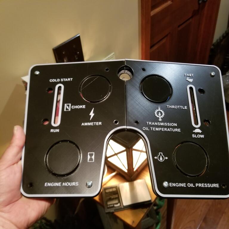

Both halves done. Light bezel printing now!
Alignment good.
  • Like 3
  • Excellent 1
Wheel Horse 3D
And with light bezel!

Wheel Horse 3D
Ok were gonna have to try a different filament with the GT14 dash. A severe heat test on my south facing deck easily flattened out the dash "fold" and started to warp the plates. The description is still up in the vendor section,  but the listing has been paused in the shop.
