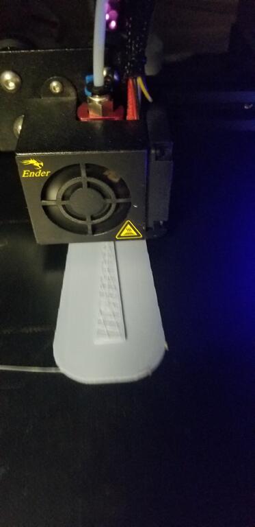

2 hours ago, Wheel Horse 3D said:
Gonna have to check out the ASA filament. Looks like it may be the same temperature resistance as ABS and works about the same with all the same print issues, but better weathering. I need to find some strength figures.
MORE GEEK SPEAK:
On further review, looks like ABS is still my best option. ASA is more expensive by half, is almost impossible to find in more colors than black and white, and is not available in clear. It also has a tendency to crack in cold weather and requires even hotter extrusion temp( which is even more wear and tear on my machine) ABS is our best option. Some stuff that doesn't require the higher temp i'll do out of PETG(thinking that would be excellent for the side decal replacements) but ABS should be the goto for dash plates, shift plates, headlight covers etc.

Wheel Horse 3D
14 minutes ago, Jeff-C175 said:
@Wheel Horse 3D
Might it be possible to light the hood ornament internally?
Dude what a cool idea!
ABS might be able to print with thin enough walls and still be strong enough. I bet if we used a silver filament we could stash one of those remote control multicolor setups in it!
ABS can be painted, but beware that it doesnt like acetone! So no spraying with automotive paint thats been thinned down to run well in the gun!
  • Like 1
Wheel Horse 3D
Might also be able to print in a translucent or clear ABS or PETG and then paint.
Imagine a glowing red head and white hubcaps!
  • Like 1

Lol... usually just like any other project,
1.sand
2. Clean and tack(dont clean or tack with acetone) soap and water and or alchohol
3. Did i mention Sand and clean?
4. Primer, a good spray primer will work, LIGHT coats and let dry for a good while you can even use the kind with the filler
5. Paint. LIGHT coats with plenty of drying on between...avoid runs!
6. Seal with a clearcoat. Again light coats plenty of dry time.
7 wax and polish as needed!

Wheel Horse 3D
3/4 scale standard ornament...test test!
