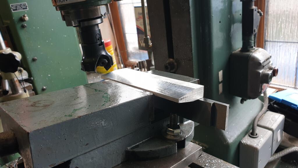

I decided to have a go at making an ornament from scratch out of aluminum, aluminium, amulinimum. Whatever...
Started out with a biggish piece so I could grip it on the milling machine.

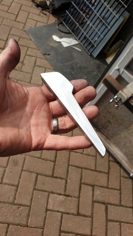

20210320_110512.jpg.94e61e0b741d0de369addf897c72235a.jpgMachined the taper on both sides, then milled the angled faces, then did a lot of abrasive belt work to blend and polish.
20210320_141856.jpg.68877860bd9242fd980ccf6031842158.jpgLooks pretty decent scale wise and im happy overall for a mornings work.

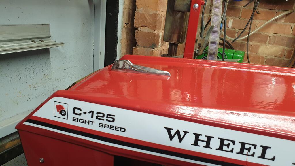

Very Nice! And I like that shop floor too!

I will polish it with special metal protecting wax. Never had much success with clear coat or layering.
Like an Airstream! Love that polished almulinamum look!:ROTF:

Mickwhitt
Looks really good.

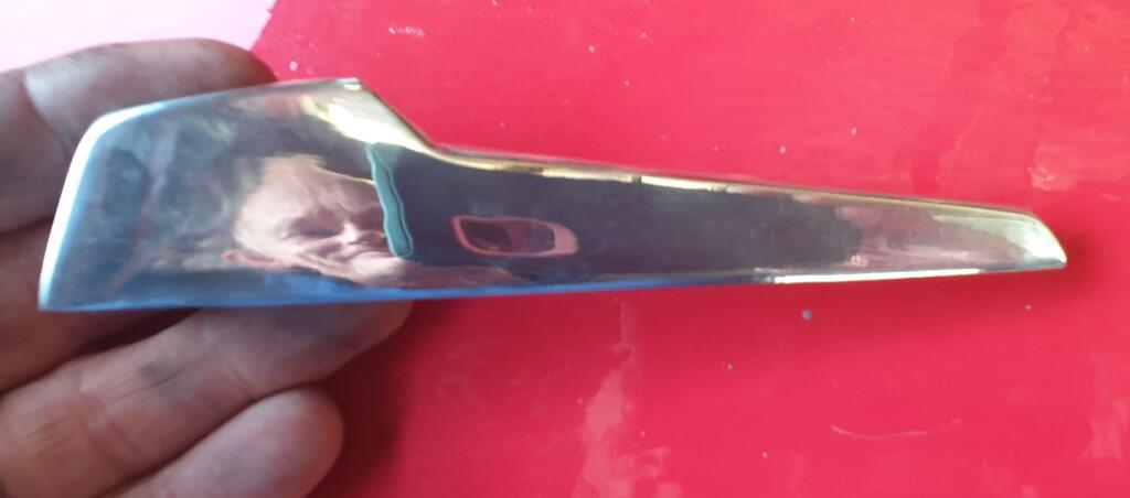

Mine is 5 and 3/4 inches long, 5/16 wide and an inch tall.
Its a complex shape of angles and curves to get it looking right.
Might be bigger than the original but it does seem to look ok.

Mickwhitt
Thats the knifemaker in me, you can see my ugly mug in the reflection lol

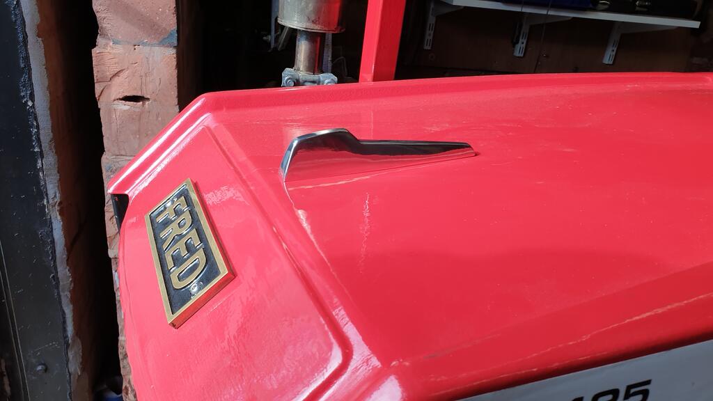

Drilled and fitted with M5 bolts.
Looks the Mutts nuts.
