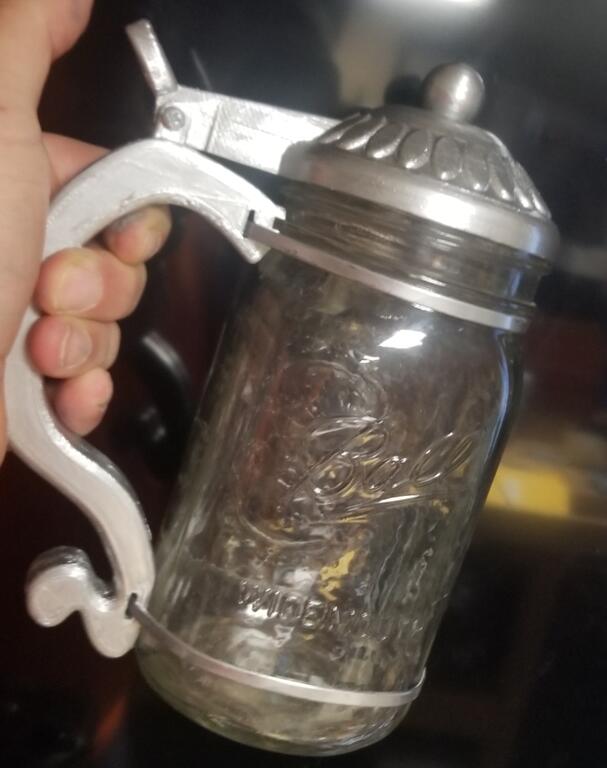

On 2/16/2021 at 9:26 PM, ebinmaine said:
Pic available?
SmartSelect_20210221-144910_Gallery.jpgyou asked about this much earlier @ebinmaine somehow I missed it.
Edited by Wheel Horse 3D
  • Excellent 1
Wheel Horse 3D
Since that pic I started painting the zip ties too.
Jeff-C175
Think about using the metal ones?
Maybe printing a 'pocket' for the zip tie head to fit into?

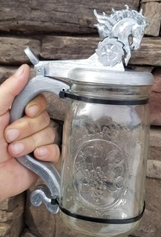

If could find a suitable thin metal solution that didnt have the hose clamp type screw id try those. Heres a different style with the hand painted ties.

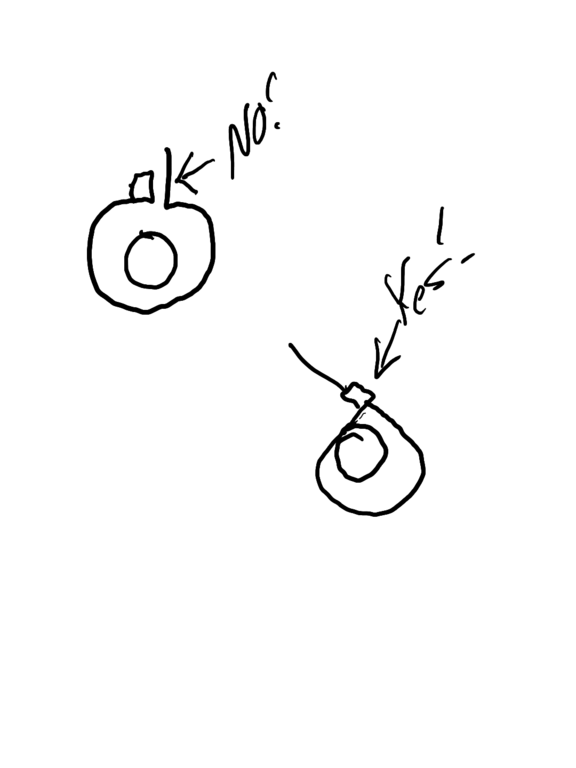

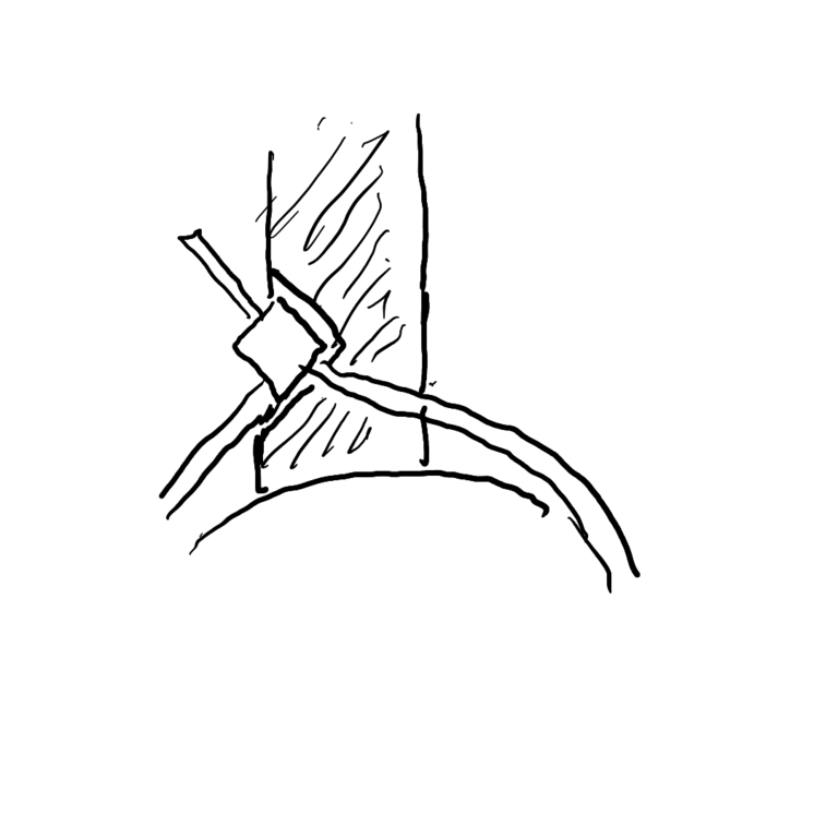

If i did a pocket, id need to actually imbed it between the handle halves. If i just did a side square its hard to torque the tie down  firmly.
The square head likes to be at a 45 rather than 90 if that makes sense.
Wheel Horse 3D
Wheel Horse 3D
I suppose i could do a kinda 45 degree half pocket.

Jeff-C175
Panduit makes thin metal zip ties and the head is smaller than the plastic ones.  Also it goes straight in, no 90* bend.  But boy are they X spendive!!
The generic metal ones on Amazon are WAY WAY cheaper!
Zip ties can also be had in a wide variety of colors.
Edited by Jeff-C175
  • Excellent 1

Wheel Horse 3D
I was just using what i have available lol. I even have the wider heavy duty ties that look good, size wise but the head of those is rather large.
Ideally, id like an option that the end user can install simply on their own jar, (jars are heavy and breakable! More expensive to ship, and possible breakage in shipment)
