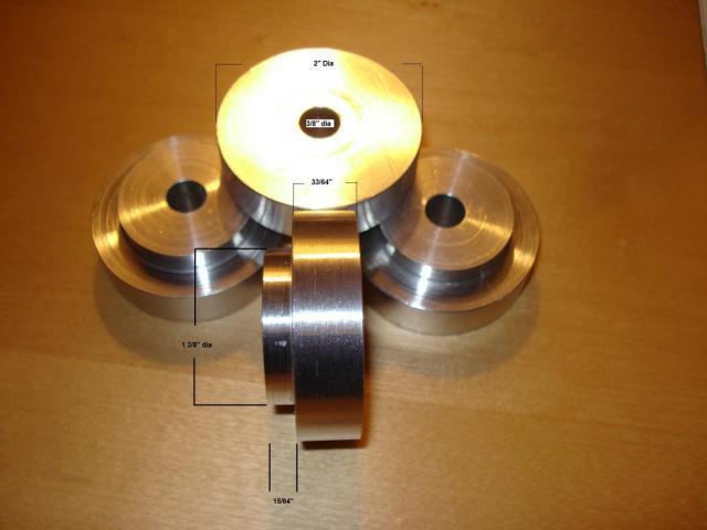

There are lots of ideas of things you could make for our Wheel Horses.
Is there a filament that would make good replacement rubber engine mounts?
Something that would be firmer than the rubber, but maybe absorb a little vibration better that the solid mounts.
Could they be made at a lesser cost that Zacks $45 solid steel mounts?
https://www.zkbrmachine.com/product-detail/wheel-horse-solid-engine-mounts-pt-num-1099--551

8 hours ago, oliver2-44 said:
@Wheel Horse 3D
Replacement rubber engine mounts?
Ya know that's a great idea. I had been wanting to eliminate the shaker mounts on Dug due to too much flex and my brain was fixated in machined ones, but I dont know why good solid plastic ones wouldnt work.

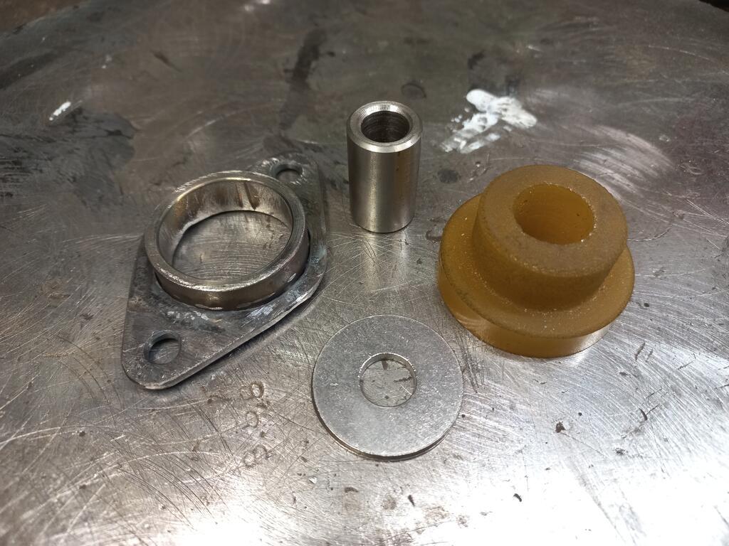

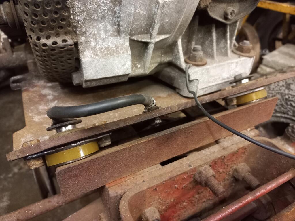

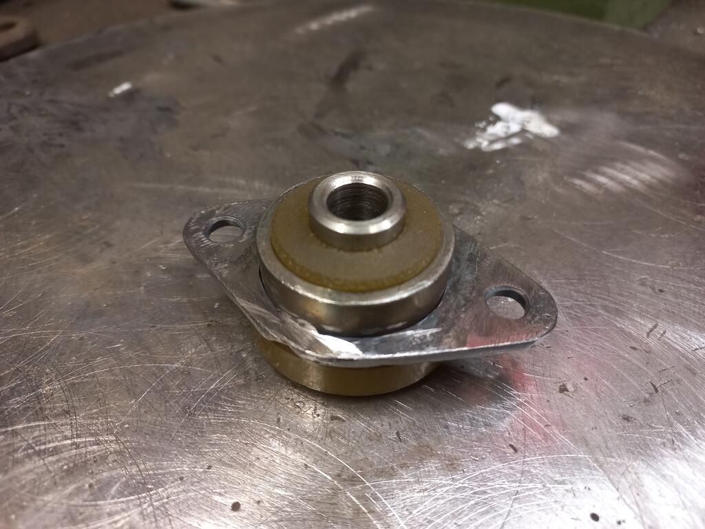

Here's what I made for my 512-D. Made from polyurethane and scrap steel.
More durable and a bit harder than rubber but more forgiving than solid mounts.

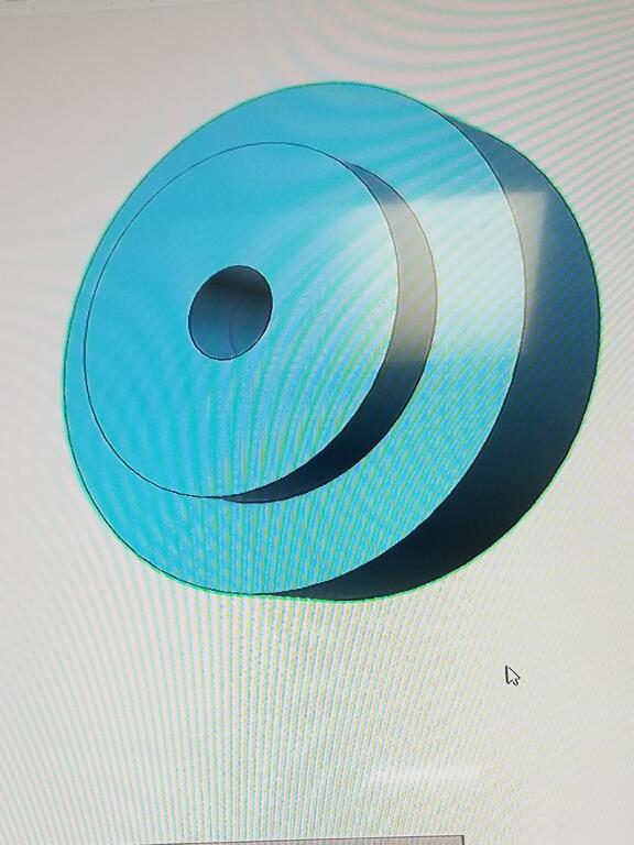

Engine mounts modeled! This is of course to eliminate the rubber shaker mount. It'll have a little flex  but not much. We could find a nice 3/8 ID hose to put in the center and expand our center hole to accommodate.

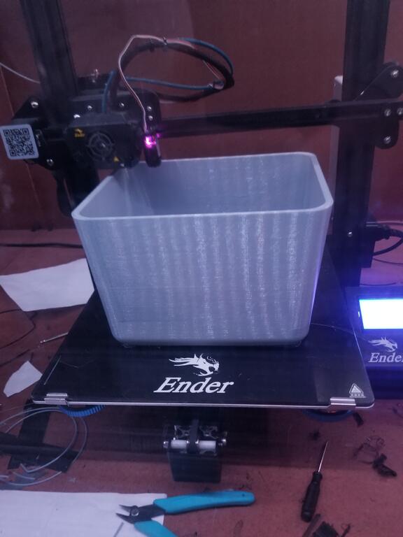

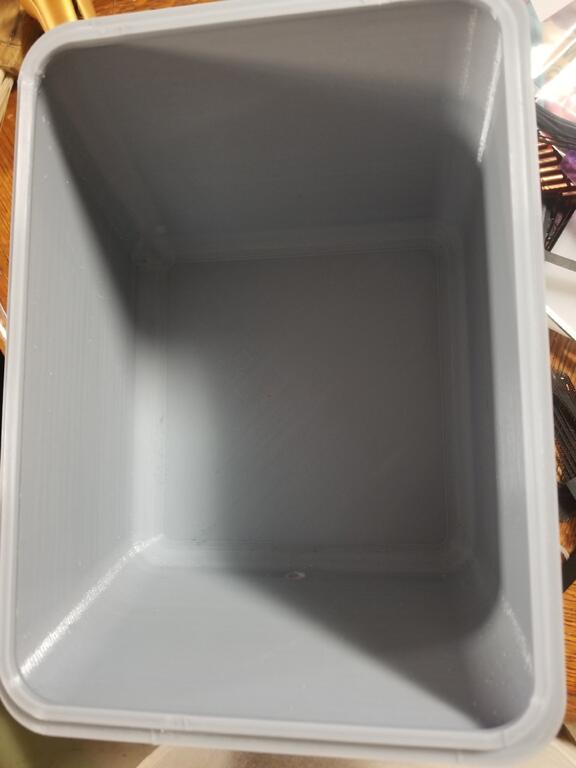

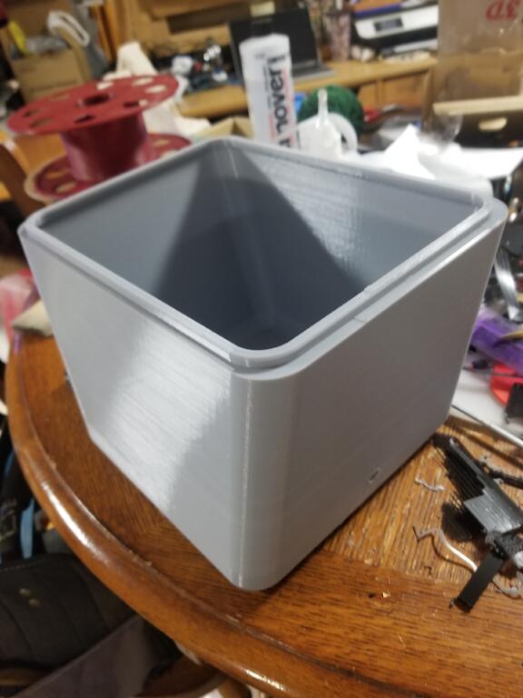

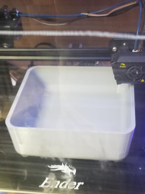

First gt 14 tank bottom half! About halfway done.

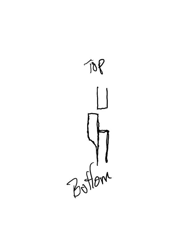

8ntruck
What kind of joint between the tank halves are you planning on?  Half lap?
Wheel Horse 3D
Pretty much. I added an inside rib that sticks up above the joint. The top then nests down onto the base.

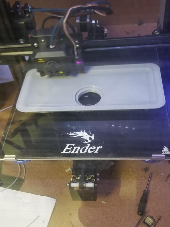

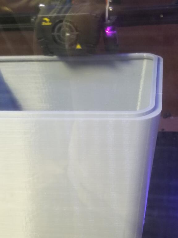

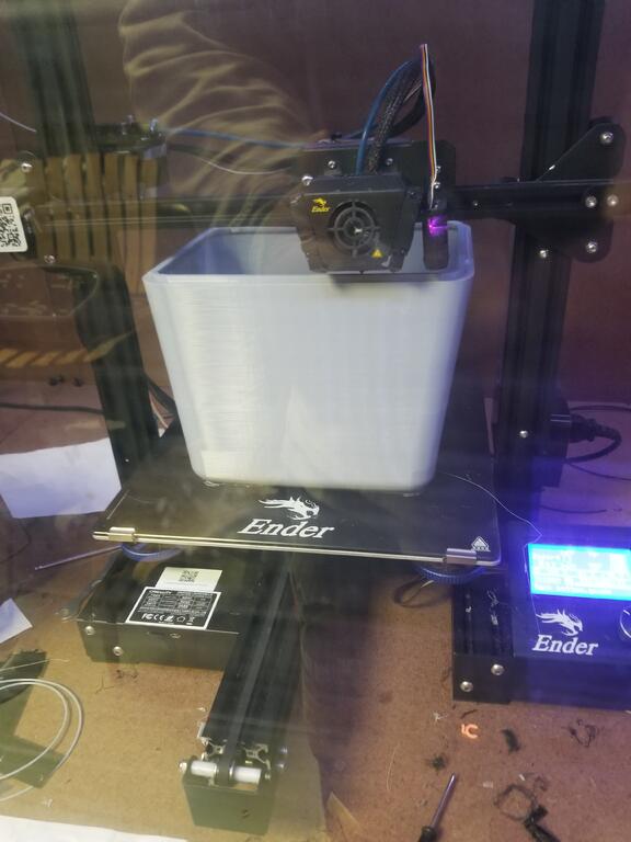

Wheel Horse 3D
Still going!
gt14rider
How many hours pur tank?
8ntruck
Mucho mas, lots and lots and lots.
Wheel Horse 3D
To this point machine says 3d 6h 42min
  • Confused 1
Wheel Horse 3D
Ok bottom done! Top starting!
  • Excellent 4
Wheel Horse 3D
And you thought watching paint dry was fun!...1 day later.
  • Haha 3
Wheel Horse 3D
I did make one change to the bottom. I shifted the outlet down a little more. So future bottoms the hole is right down level with the inside bottom surface.
8ntruck
Just out of curiosity, have you filled the bottom half of the tank with water to check for leaks?
This was a few years back, but a couple of the younger engineers at work made a print with maybe 20% infill.  When it was done, they mixed up some resin and poured it into an opening they had left in the print.  There were enough leaks that they had a had a real mess on their hands, and table, and floor......
Wheel Horse 3D
Lol. I haven't checked yet. This was done at 100 percent infill, but I would still recommend a tank sealer. Just knowing how these layers lay down even with extra wall layers etc.i'd still use a tank sealer.
