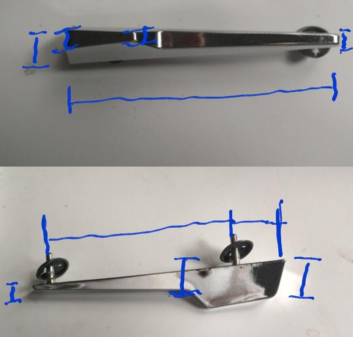

Can anyone get me the exact dimensions of the stock hood ornament? I have access to the off branded fin shaped one, but not one of the originals. I have models already made up for the bare original style, one similar to rg854 s wooden one, and the speedy one i did, but i need to get the hole spacing, hole size and other dimensions correct.
I thought you had the measurements in the pictures I texted you:confusion-scratchheadyellow:
rjg854
Can I call you @ 6pm

Wheel Horse 3D
@rjg854
Sure can! I didnt have a pic come through:(

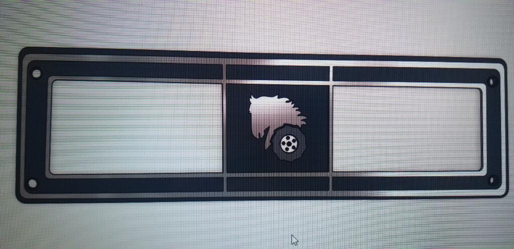

Wheel Horse 3D

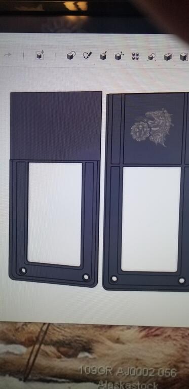

Almost there, just have to design the lenses.
  • Like 2
  • Excellent 4

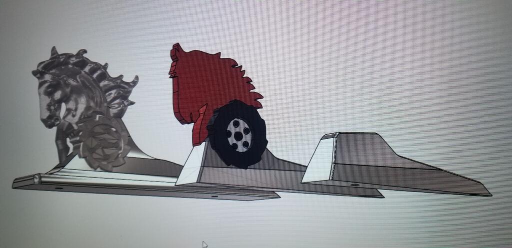

Wheel Horse 3D
Divided for printing with my "fancy horse"

Wheel Horse 3D
The headlight frame and lens models are ready for printing, (once i get some clear filament)
And i finalized the dimensions on the hood ornaments so they are set to print!

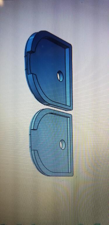

Wheel Horse 3D
WH key fob and matching key hook, @Shaun turner
Includes a second hook for the key for some sort of lesser vehicle, or more than likely for your other Wheel Horse!
I know some of yall need a whole row of hooks just for WH keys!

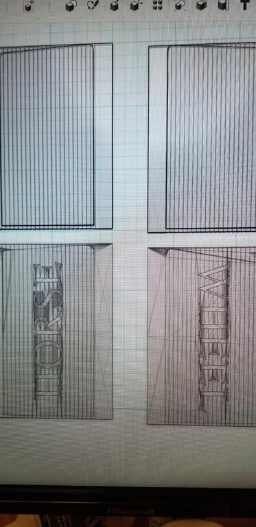

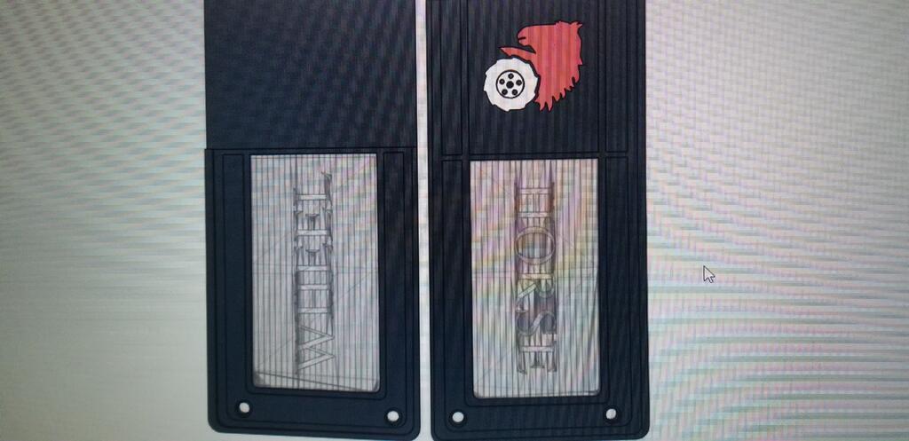

Wheel Horse 3D

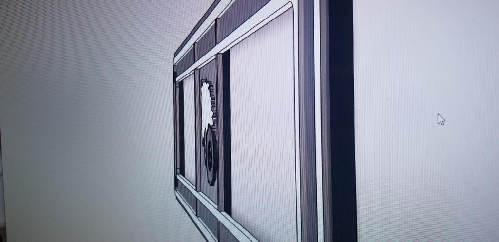

I realized the previous pic of headlight lenses didnt show well, heres one a little better.
Have the plain, and one set with WHEEL and HORSE that should show through the diffuser.
  • Like 1
ebinmaine
Will the headlamp assemblies have an arc to them or will they be flexible enough to conform to the hood?
Wheel Horse 3D
Theyre 4mm thick, so they should curve ok. Ill be trying a set on a buddy's c161, if they dont curve well, ill add a slight arch in the print, or make a forming jig that i ply a little heat to to form the arch

Getting back to the keys for a minute bet you could make the little black plastic pieces and sammich a regular old indak in it?

The little key covers should be easy. Again, ABS. I could slot the back so the key slides in and when you put the ring on it stays, or I could acetone weld 2 halves together.
