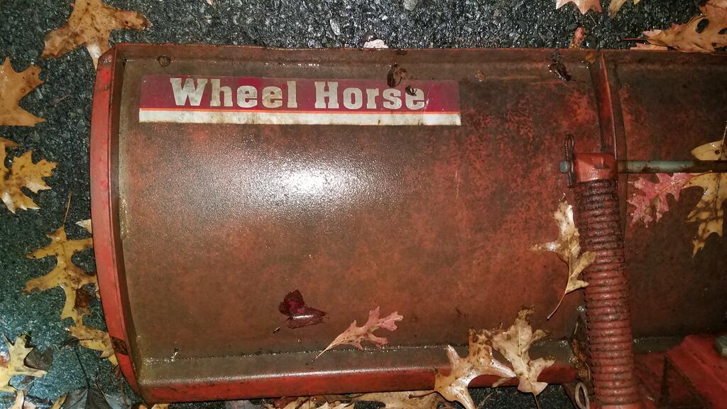

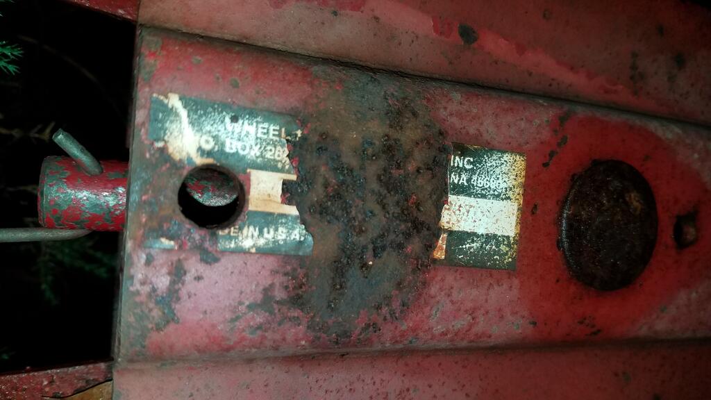

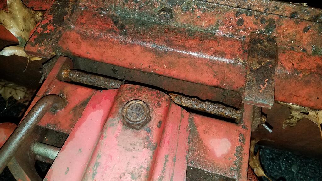

Inspectorjoe 473 #1 Posted December 1, 2020 I recently bought this plow. I don't think I did too bad for $60. I don't know the model number. The rod that connects the blade to the frame is not long for this world. I've come up dry in an online search for a replacement. Does anyone know where I could find one? 3 Share this post Link to post Share on other sites
ebinmaine 80,767 #2 Posted December 1, 2020 You did great at $60! I bought some 1/2" rod at Lowe's and made them up for one of mine. 3 2 Share this post Link to post Share on other sites
953 nut 69,558 #3 Posted December 1, 2020 As you become more familiar with your you will appreciate the fact that they were built with standard hardware store materials and can be serviced easily. Please click on this Introduction link https://www.wheelhorseforum.com/forum/47-introductions/?do=add and tell us a little more about your Wheel Horse and yourself. 1 Share this post Link to post Share on other sites
peter lena 10,076 #4 Posted December 1, 2020 JOE, while you are at it , good opportunity to service that steering quadrant , your second photo shows' a pop off cap to access lubrication area, also good time to washer up the angle movement rod , typically a sloppy fit , causing mount hole wear. use long needle nose plyers to remove Kotter pin and add washers to firm up that swing area. all that surface rot and more can easily be stopped with a LUBRICATION SOAK DOWN , thoroughly grease the quadrant internal swing arc mount and spring pin lever mount. also if you want to make this easier, set the plow up on a bench or milk crates for better access , that's what I do , correct problems and verify movement function off the tractor , that ease of function , is exactly what you will mount back on . pete 1 Share this post Link to post Share on other sites
WVHillbilly520H 10,379 #5 Posted December 1, 2020 (edited) As Eric @ebinmaine said hardware store 1/2 inch diameter, get a 3 or 4 footer and you'll have yourself some spares. Edited December 1, 2020 by WVHillbilly520H 3 Share this post Link to post Share on other sites
Inspectorjoe 473 #6 Posted December 1, 2020 12 hours ago, ebinmaine said: You did great at $60! I bought some 1/2" rod at Lowe's and made them up for one of mine. Thanks, Eric. I was bummed out because I missed the one the guy had at $150, but then he said he had one that needed some work for $60. I expected it to be in much-worse condition. I'm not one to nickle and dime someone who prices an item fairly, so I gave him his asking price. The only thing that was missing on it was the very thin rod that runs from the hand-operated release lever to the triangle. I picked one up at Lowes for $2.63. I was figuring that I might end up having to make my own rod, but I don't have a drill press to make the two holes. I might grind a little flat spot to start the hole, or look for a jig that would keep the bit from skipping off. 2 Share this post Link to post Share on other sites

peter lena 10,076 #9 Posted December 1, 2020 JOE, while you are at it , good opportunity to service that steering quadrant , your second photo shows' a pop off cap to access lubrication area, also good time to washer up the angle movement rod , typically a sloppy fit , causing mount hole wear. use long needle nose plyers to remove Kotter pin and add washers to firm up that swing area. all that surface rot and more can easily be stopped with a LUBRICATION SOAK DOWN , thoroughly grease the quadrant internal swing arc mount and spring pin lever mount. also if you want to make this easier, set the plow up on a bench or milk crates for better access , that's what I do , correct problems and verify movement function off the tractor , that ease of function , is exactly what you will mount back on . pete Share this post Link to post Share on other sites
peter lena 10,076 #10 Posted December 1, 2020 JOE , that 14 horse hydro should easily get it done , look up plow frame mounting pictures , on site to help with installation tricks . those rear brackets , have small swing arms, get a couple of 1/8" spring clips at your local h/w store in the small pull out drawer section , to secure the arms , the holes are there , prevents the back of frame from dropping . let us know how you make out, pete 1 Share this post Link to post Share on other sites
gwest_ca-(File Mod) 12,489 #11 Posted December 1, 2020 46 minutes ago, Inspectorjoe said: I was figuring that I might end up having to make my own rod, but I don't have a drill press to make the two holes. I might grind a little flat spot to start the hole, or look for a jig that would keep the bit from skipping off. I suspect you have a hand drill. Get a split point drill bit which is the most common now and you will be pleasantly surprised. They don't skate around. Garry 4 Share this post Link to post Share on other sites
ebinmaine 80,767 #12 Posted December 1, 2020 47 minutes ago, Inspectorjoe said: Thanks, Eric. I was bummed out because I missed the one the guy had at $150, but then he said he had one that needed some work for $60. I expected it to be in much-worse condition. I'm not one to nickle and dime someone who prices an item fairly, so I gave him his asking price. The only thing that was missing on it was the very thin rod that runs from the hand-operated release lever to the triangle. I picked one up at Lowes for $2.63. I was figuring that I might end up having to make my own rod, but I don't have a drill press to make the two holes. I might grind a little flat spot to start the hole, or look for a jig that would keep the bit from skipping off. Joe you can get around not having a drill press particularly if you have a vice. The good thing about making a rod like that is it isn't precision engineering so just get it as close to centered as you can for the clips to go through. Get a hold of a good sharp center punch and make a nice neat impression where you want to put the drill bit. Start small like 1/16-in. 2 1 Share this post Link to post Share on other sites
Inspectorjoe 473 #13 Posted December 1, 2020 9 minutes ago, ebinmaine said: Joe you can get around not having a drill press particularly if you have a vice. The good thing about making a rod like that is it isn't precision engineering so just get it as close to centered as you can for the clips to go through. Get a hold of a good sharp center punch and make a nice neat impression where you want to put the drill bit. Start small like 1/16-in. I'm probably overthinking this. Rod stock isn't that hard. I'll pick up a brand new bit to do it. I've spent enough time on the internet. I promised the wife I'd replace a bathroom sink today. It's quarter after 4, and so far all I've done is think about it. That ain't gonna get it done. 5 Share this post Link to post Share on other sites
ebinmaine 80,767 #14 Posted December 1, 2020 9 minutes ago, Inspectorjoe said: I'm probably overthinking this. Rod stock isn't that hard. I'll pick up a brand new bit to do it. I've spent enough time on the internet. I promised the wife I'd replace a bathroom sink today. It's quarter after 4, and so far all I've done is think about it. That ain't gonna get it done. She will learn to accept the tractor and everything that you do to it. One possible method of convincing is that if your significant other has even so much as 1% of a mechanical blood cell you can "get them" a tractor.. 1 Share this post Link to post Share on other sites
WVHillbilly520H 10,379 #15 Posted December 1, 2020 @Inspectorjoe here is some help when I fixed up a couple that was missing parts... even though I did a lot of it in the factory's machine shop I worked at it can be done at home with a bench vice , hand drill , a 4-4 1/2" angle grinder , a MAP gas hand torch ect... 1 Share this post Link to post Share on other sites
Inspectorjoe 473 #16 Posted December 1, 2020 8 minutes ago, WVHillbilly520H said: @Inspectorjoe here is some help when I fixed up a couple that was missing parts... even though I did a lot of it in the factory's machine shop I worked at it can be done at home with a bench vice , hand drill , a 4-4 1/2" angle grinder , a MAP gas hand torch ect... Wow, interesting thread. You've got some great shkills, there! Share this post Link to post Share on other sites
