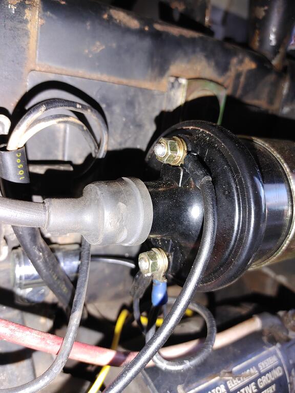

A cheap spark indicator may tell the tail. Point spark is erratic, another bad condenser? I see the arc jumping off the contact areas. Put the old coil on and try?  .018 gap seems to be were I alway ended up

Old coil wrong 1 to begin with... I will regap and double check my condenser/wiring also this was a graveyard tractor and trying to resurrect it for my 16yo.

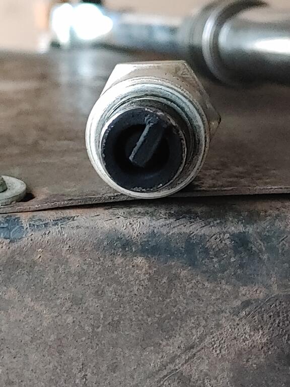

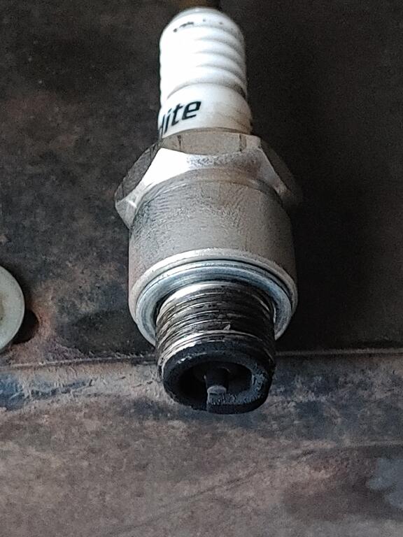

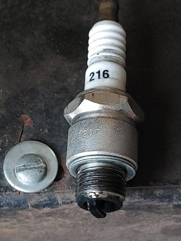

Got home changed out the Autolite 216 plug for Champion H10C (pics of Autolite looks rich to me dry black not white lean) and tried tightening up the point gap to .018" made it worse, went to .022" much better only about 5min run time and was able to go from idle to WOT no sputtering but spark is erratic at the points and not so much governor hunting as yesterday, so tried to go a little farther .024" back to governor hunting spark even more erratic, checked voltage at the coil while running 13.5-14 volts that should be good and the battery is staying charged, so either the points and condenser are iffy or there's a ground issue with this shaker plate engine cradle tried an inline spark tester it was bright from idle thru WOT so the coil seems very good (couldn't fine my adjustable one just to see how big a gap it could jump fire).  I suppose I might need to try genuine Kohler points and condenser next and check the rest of the wiring but I definitely had the coil wired correctly.   I am all ears...

Looks to be the right Autolite ..... a 216  I don't think the plug brand is the issue. Perhaps the the black is coming from some worn valve guides or rings? Just thinking out loud did you check the governor adjustments? Try different spring holes? About what year is this Billy?

next thing would be to stick an old ballast resistor in line with the coil +12v and see if it helps. Even if the box says ‘internally resisted’,  don’t trust a dang thing these days.
