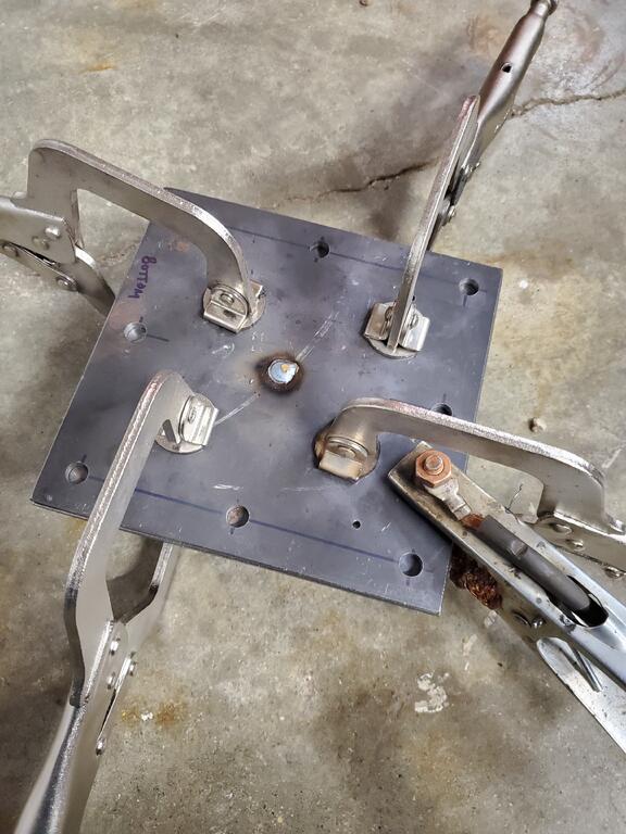

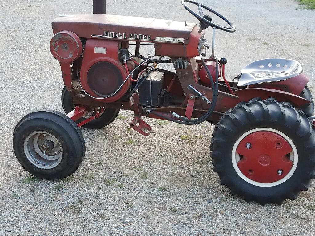

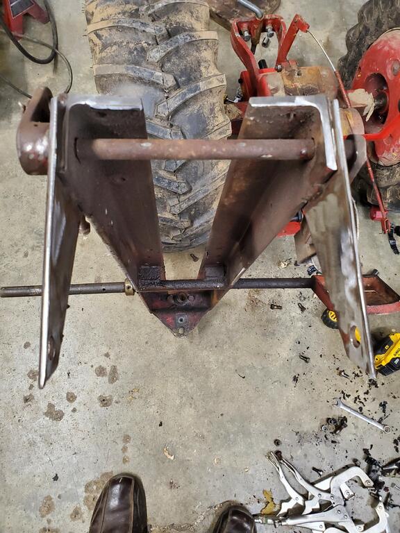

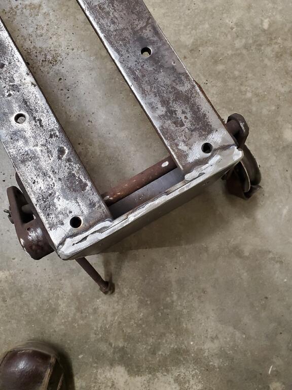

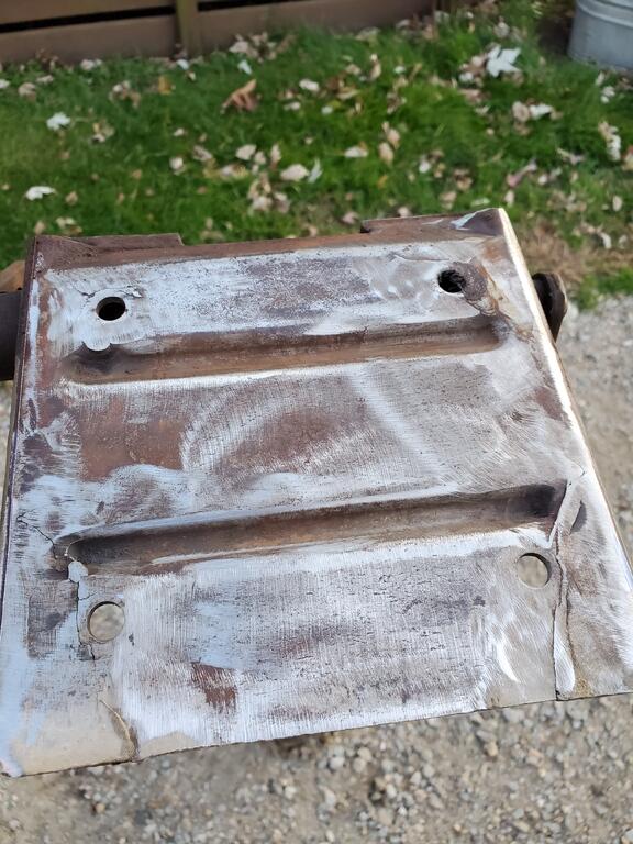

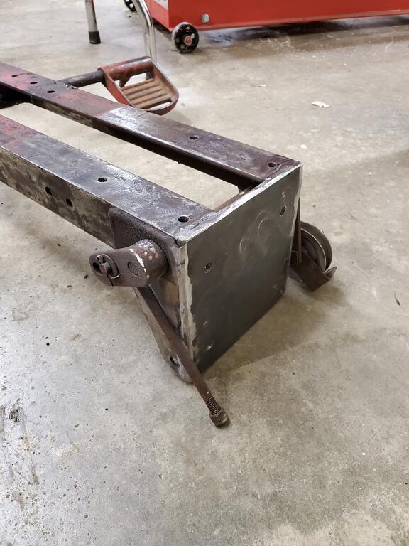

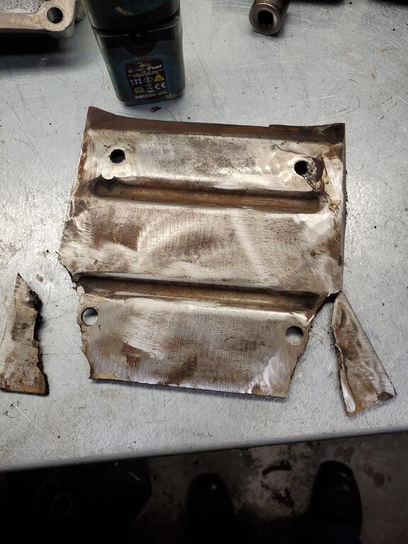

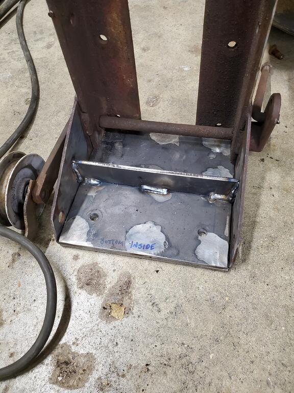

prondzy 3,891 #1 Posted November 8, 2020 (edited) @WHX24 @Achto @PeacemakerJack @Shynon @Mikey the Monkey @Coulter Caleb my plan is to have everything fixed before i put it away for the winter that way I can rock n roll next season. My plow tractor. It has seen many upgrades over the last 6 years, this year at Jims Plow Day i found the next weakness after years of use and abuse the gusset plate on my tractor was shot. When i lifted the plow off the ground my hood stand would flex to the left about 1/2inch and the frame/transmission mount would buckle up and down i couldnt hold a furrow to save my life. So i cut out the bad parts, you can see all the cracks I couldnt not find a solid 3/8 plate without ordering one online for big $$. So i welded two 3/16inch plates together dimensions 7in x 6-3/4in to make my new gusset plate. I drilled my pilot holes through one plate and added 9 extra 3/8 holes for spot welds to hold the plates together. Then drilled out the transmission bolt holes through both plates Tacked the new plate into place and added another gusset to stiffen the twist at this plate under load. Then finished burning it in and cleaning up welds Next im going to add a skid plate to the underside to prevent trash buildup. Edited November 8, 2020 by prondzy 5 12 Share this post Link to post Share on other sites
8ntruck 9,368 #2 Posted November 8, 2020 Nice wields. Using MIG? 1 Share this post Link to post Share on other sites
WHX?? 58,324 #3 Posted November 8, 2020 I like it Mike ... thoughts on running struts from the bottom of the F plate to the frame? 2 1 Share this post Link to post Share on other sites
PeacemakerJack 11,080 #4 Posted November 8, 2020 Mike—thanks for tagging me on this one! That is going to be a great upgrade. When you have this finished, if you are willing, I’d like you to do a write up in the plowing thread. Once again, I want to pool the plow dog resources there in one spot for those who would follow us and join in this craziness to see the strong and the weak from our beloved horses. We push them to the MAX when furrow plowing (I.E. guys, think of a tractor pull that lasts for hours instead of seconds🤔😉) and we discover things that were done well from the factory and things that were fine for normal use but not for active furrow plowing that we expect of these dedicated plow mules! I’ll sit back and enjoy this thread. It is something that I’ll likely have to consider for GhostRider soon... 2 1 1 Share this post Link to post Share on other sites
prondzy 3,891 #5 Posted November 8, 2020 20 minutes ago, 8ntruck said: Nice wields. Using MIG? Yes sir Share this post Link to post Share on other sites
prondzy 3,891 #6 Posted November 8, 2020 16 minutes ago, WHX24 said: I like it Mike ... thoughts on running struts from the bottom of the F plate to the frame? Thats exactly what my plan is to stiffen the chassis more. Have a few ideas in my head we'll see what happens then attach a skid plate to those struts to see if i can reduce trash buildup. 3 Share this post Link to post Share on other sites
Lee1977 7,807 #7 Posted November 8, 2020 (edited) Here is a picture of that.. I have done it to two of my tractors. My rear frame plate was not broke so I didn't add a full plate. I did grind the edges to they would fit flat against the plate. Edited November 8, 2020 by Lee1977 7 6 Share this post Link to post Share on other sites
ebinmaine 81,048 #8 Posted November 8, 2020 VERY nice work. I'm looking forward to seeing what you do for the reinforcing/trash reduction plate. Forgive my lack of knowledge here. Why do you get muck in there? Mowing? Mud from fields? Share this post Link to post Share on other sites
Herder 2,356 #9 Posted November 8, 2020 9 hours ago, prondzy said: @WHX24 @Achto @PeacemakerJack @Shynon @Mikey the Monkey @Coulter Caleb my plan is to have everything fixed before i put it away for the winter that way I can rock n roll next season. My plow tractor. It has seen many upgrades over the last 6 years, this year at Jims Plow Day i found the next weakness after years of use and abuse the gusset plate on my tractor was shot. When i lifted the plow off the ground my hood stand would flex to the left about 1/2inch and the frame/transmission mount would buckle up and down i couldnt hold a furrow to save my life. So i cut out the bad parts, you can see all the cracks I couldnt not find a solid 3/8 plate without ordering one online for big $$. So i welded two 3/16inch plates together dimensions 7in x 6-3/4in to make my new gusset plate. I drilled my pilot holes through one plate and added 9 extra 3/8 holes for spot welds to hold the plates together. Then drilled out the transmission bolt holes through both plates Tacked the new plate into place and added another gusset to stiffen the twist at this plate under load. Then finished burning it in and cleaning up welds Next im going to add a skid plate to the underside to prevent trash buildup. This is a great thread!! Thank you. But I have to say, I love the look of that plow rig. 3 1 Share this post Link to post Share on other sites

prondzy 3,891 #11 Posted November 8, 2020 2 hours ago, ebinmaine said: Forgive my lack of knowledge here. Why do you get muck in there? Mowing? Mud from fields? EB its not muck or mud, we call it field trash. Basically its the mower grass clippings equivalent of soybean plants after harvest. Sometimes you can roll without issue and other times it balls up right in front of this plate like a pushblade and you have to get off and clean it out or you will high center the transmission on it. Im gonna try to add a skid plate to see if it will minimize the trash collected. 3 2 Share this post Link to post Share on other sites
prondzy 3,891 #12 Posted November 8, 2020 (edited) 7 hours ago, Lee1977 said: Here is a picture of that.. I have done it to two of my tractors. My rear frame plate was not broke so I didn't add a full plate. I did grind the edges to they would fit flat against the plate. Lee, my frame never had those thats part of the reason it broke the way it did. The struts we are talking about will run from the bottom holes on the outer gussets (visible from the side of tractor) to the foot stirrup bars to aid the gusset plate strength Edited November 8, 2020 by prondzy 4 Share this post Link to post Share on other sites
ebinmaine 81,048 #13 Posted November 8, 2020 5 minutes ago, prondzy said: EB its not muck or mud, we call it field trash. Basically its the mower grass clippings equivalent of soybean plants after harvest. Sometimes you can roll without issue and other times it balls up right in front of this plate like a pushblade and you have to get off and clean it out or you will high center the transmission on it. Im gonna try to add a skid plate to see if it will minimize the trash collected. Oh oh oh oh oh ok I see. Me woods Bear. Not field Plow Dog. That's a new one to me. 1 4 Share this post Link to post Share on other sites
WHX?? 58,324 #14 Posted November 8, 2020 Real good idea. Be interesting to see how you plan to access the tranny to plate bolts. 2 Share this post Link to post Share on other sites
ebinmaine 81,048 #15 Posted November 8, 2020 1 minute ago, prondzy said: Lee, my frame never had those thats part of the reason it broke the way it did. The struts we are talking about will run from the bottom holes on the outer gussets (visible from the side of tractor) to the foot stirrup bars to aid the gusset plate strength So that'll enable mounting a nice long low trash deflector as well. Nice idea. And the deflector could be part of the rigididididity. 4 Share this post Link to post Share on other sites
ebinmaine 81,048 #16 Posted November 8, 2020 1 minute ago, WHX24 said: Real good idea. Be interesting to see how you plan to access the tranny to plate bolts. Deflector to be a bolt on? 1 Share this post Link to post Share on other sites

prondzy 3,891 #18 Posted November 8, 2020 2 minutes ago, WHX24 said: Real good idea. Be interesting to see how you plan to access the tranny to plate bolts. Gotcha covered thee Jim, but yoir gonna have to wait for the next posts 1 Share this post Link to post Share on other sites

Lee1977 7,807 #20 Posted November 8, 2020 (edited) I ran my braces with the belt guard as I still use a 48" deck on the tractor. Where the bars cut trough the frame is the weakest part of the frame. If you are going that far I would go under the bar and bolt to the frame in front of the bar and weld another piece to the brace to bolt behind the bar. While you are fixing the frame you need to fix the elongated hole for the front axle pin. Most likely a lot mort work up there. Edited November 8, 2020 by Lee1977 1 Share this post Link to post Share on other sites
PeacemakerJack 11,080 #21 Posted November 8, 2020 1 hour ago, ebinmaine said: Agreed. Maybe should be in Instructionals? @PeacemakerJack because of the constant use like you mentioned above I'm using a complete separate subframe on the big wheel tractor. Exactly! It is hard to describe what constant bull work does to garden tractors. They were built heavy enough initially to keep on going through whatever was thrown at them...however if that is done long enough, things are going to break. As my dad taught me so many years ago, “If/when you break something under hard use, time to build it stronger and then put it back into service!” Eric—if you look in the plowing thread, I know we covered field trash in it pretty extensively. It is crazy how the smallest protrusion will grab “stringy” soybean trash and collect it like Mike indicated until it lifts your rear axle up and leaves your tires spinning! All stuff we flatlander plow mules have learned about the hard way😂😂😂 2 1 Share this post Link to post Share on other sites
